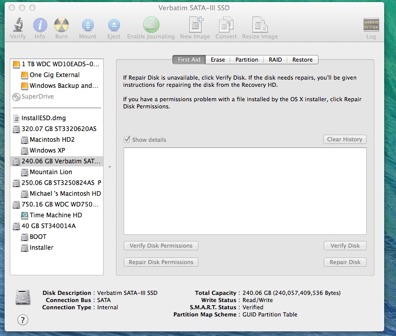

Your drive is formatted as MBR isn't it? If so then OS X can't boot from it natively. What's happening is the boot loader can't find anything to boot when you point it at your Mavericks install and so it is switching to the next thing it can find, Chameleon.
Only the Chameleon Drive is MBR. The Maverick Drive (which its still called Mountain Lion in my system) is GUID Partition Table
Verify the disk then. Pop open Terminal and post the results of the following command:
Code:
bless -info /Volumes/Mountain\ Lion
