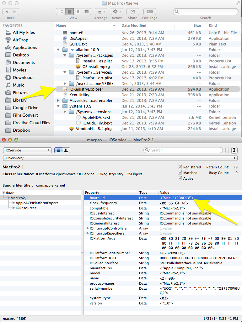

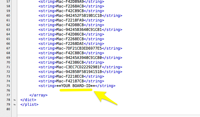

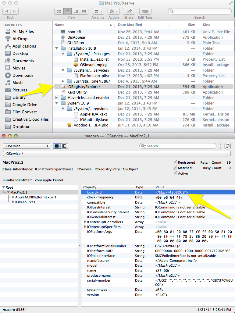

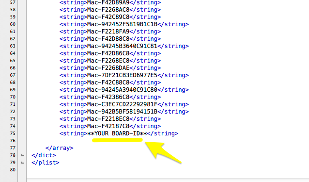

Go ahead and download the zipped file and you will get a folder with everything you need except the actual Tiamo EFI which you will download via the link in the instructions.
As for the board ID it looks something like this when you open the IORegistry Explorer application. Your board ID will be different(?) Also, I think you can open the .plist file with Text Wrangler to paste that in and save. I hope I'm being clear. Please correct me if I'm wrong.

Hey that's pretty darn clear! I just ordered a new hard drive so I can have a nice fresh install.
I didn't realize that there was an app in the download that allowed me to pull my board ID.
I understand that I need to use Text Wrangler to update the plist file.

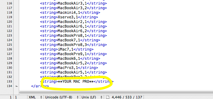

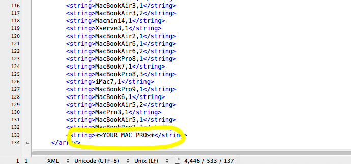

In your other image where it says "Your Mac Pro" circled, what the heck is that file? What input do I stick there... "MacPro1,1"?
Dumb question but, is there a walkthrough in the download package? Lol... if so, that might answer some of these questions.
If you follow the 3 or 4 steps on Tiamo's post on the other thread you can create a bootable USB or DVD installer that will be able to install Mavericks on your 1,1. It took me about 5 mins to prep the files and make a disc image that I burned to a DVD. That disc image could have been restored to a USB drive too.

For some reason, I thought that I was changing these files on my current hard drive. I didn't realize that I would be changing the files within the boot drive. That makes a lot more sense now.
The boot.efi file also in the drive... not my current OSX installation, correct?
