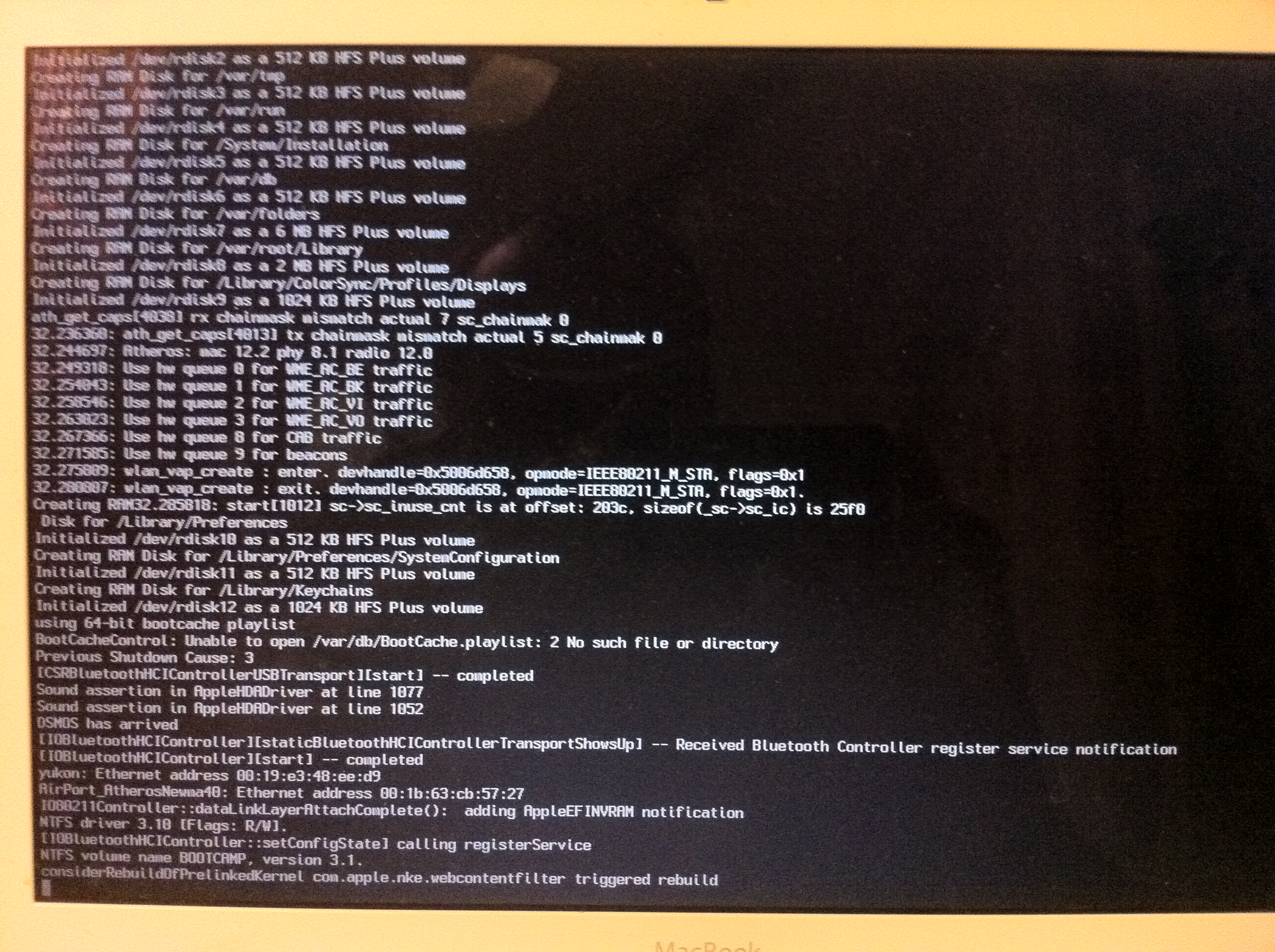

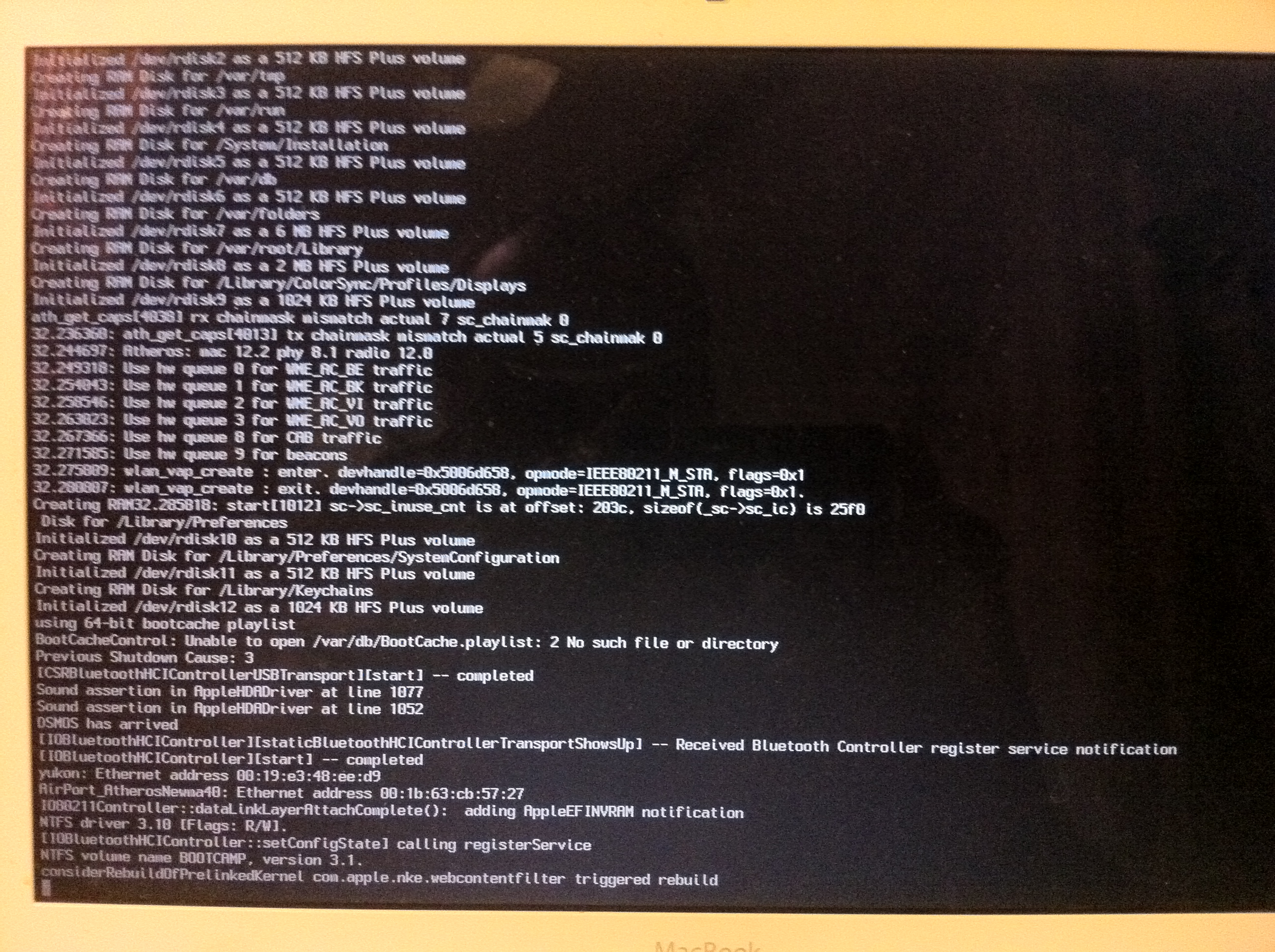

Hmm after 20 minutes
wait for at least 20 minutes. If doesn't work, boot in verbose, start up by holding CMD+V
After 20min nothing chanfed :(
CMD+V
It stop on this screen:
(Bootcamp = Win7, planning to install 10.8 instead of Win7)
CMD+V
Seems like a GMA 950 issue to me. Wait for the other forumer who successfully get it booted to write his guide or use Stevo's method post #322.
