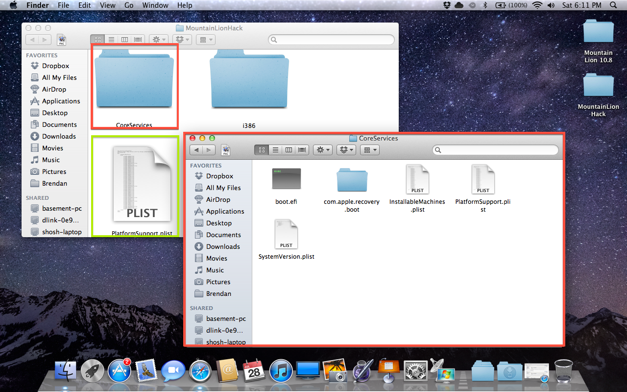

There are two PlatformSupports in the zip file. One in the root MountainLionHack and one in the CoreSupport folder. Following the instructions, I merged that CoreSupport with the one in the flash drive I created, replacing the files when prompted. Is there something I should be doing with the second PlatformSupport file in order to install successfully?

There are two PlatformSupports in the zip file. One in the root MountainLionHack and one in the CoreSupport folder. Following the instructions, I merged the that CoreSupport with the one in the flash drive I created, replacing the files when prompted. Is there something I should be doing with the second PlatformSupport file in order to install successfully?

You havent replaced every PlatformSupport file then. Its this file that dictates which models that ML can install on. Re-check your work against #22
7. Open up the ZIP file. You should get a folder called MountainLionHack, and it contains 2 folder, which is CoreServices and i386. Open up the 8GB thumb drive, navigate to /System/Library and MERGE the patched CoreServices folder in, when it ask about files replacement, click replace. Next, on the same 8GB drive, navigate to /usr/standalone and MERGE the patched i386 folder in. Replace files when asked.
8. Reboot your Mac and hold down "Option" while booting. Select the thumb drive and hit enter. Once you're at the installation screen, click next till you reach the destination drive, click show all drives and select the 20GB partition you made for Mountain Lion, hit next to install. Once installation is completed system will restart, DO NOT try to boot into Mountain Lion. While restarting, hold down "Option" and boot back into Lion 10.7. Bring up Finder, open Mountain Lion drive and navigate to /System/Library/CoreServices and replace PlatformSupport.plist with the one in MountainLionHack folder.
I have followed up to step 7 precisely. The PlatformSupport and InstallableMachines in CoreSupport were merged onto my flash drive, replacing the 'legit' ones. The PlatformSupport outlined in green hasn't been moved. Looking to step 8, it would indicate this is supposed to happen post-installation.
Btw, just a little note, both PlatformSupport.plist are the same file. The reason why i included twice is to avoid confusion.
