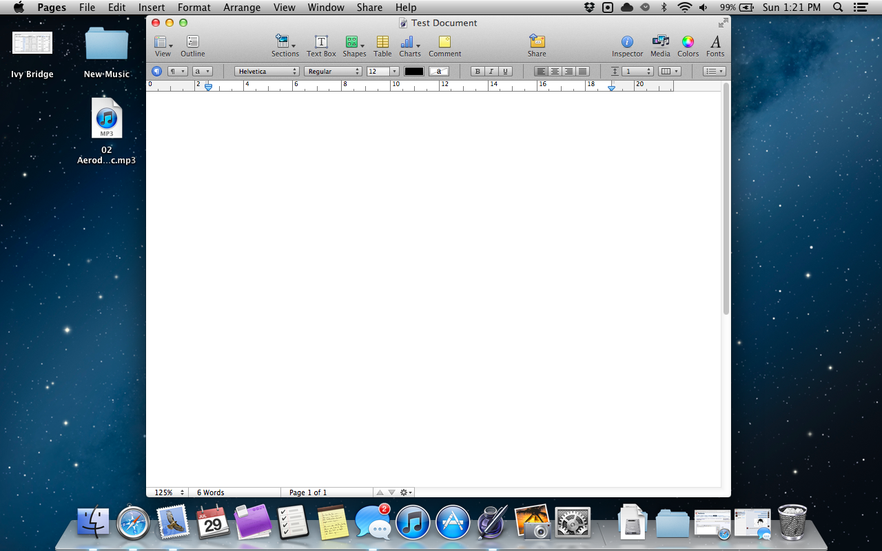

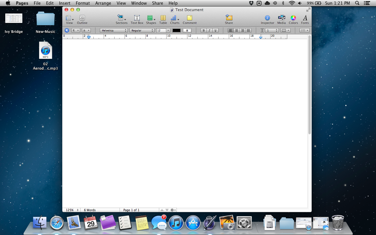

No iWork. Documents open fine but then nothing is displayed. I'm assuming this is the OpenGL 4 issue hackerwayne mentioned? I'm getting full acceleration on X3100.

I think it should be qe/ci issue. I tried 10.6.2 driver on lion and got same issue. So it may not OpenGL 4 issue.
QE/CI is working, if its not you won't be able to watch YouTube videos and stuff.
No, you shouldn't have used it for everyday work. The hack method is still in "beta". FaceTime *does* work but you have to register a FaceTime Apple ID else where (e.g: on iPod Touch 4). iMessage works but you have to use Migration Assistant, and graphics is slow because your X3100 does not support OpenGL 4.0 which is required by Mountain Lion.
