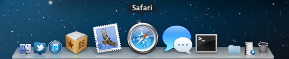

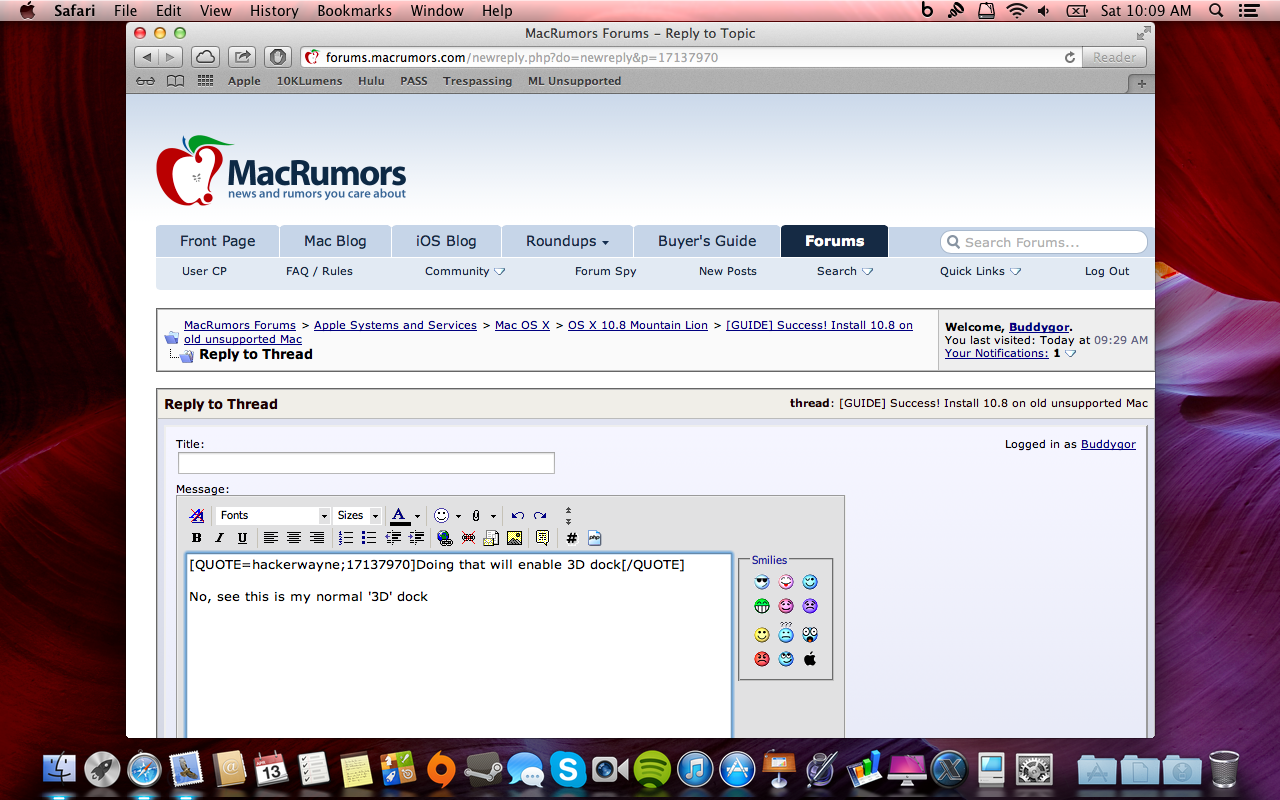

No, see this is my normal '3D' dock, which is messed up.
https://forums.macrumors.com/attachment.php?attachmentid=407605&stc=1&d=1365862186
and this is what he wanted me to do-
defaults write com.apple.dock hide-mirror -bool yes
This changes it to the 2D dock- not fixing the 3D one.

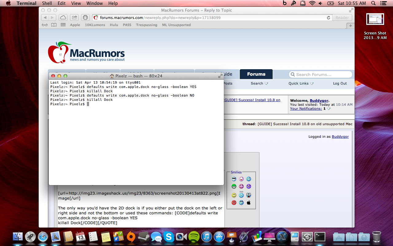

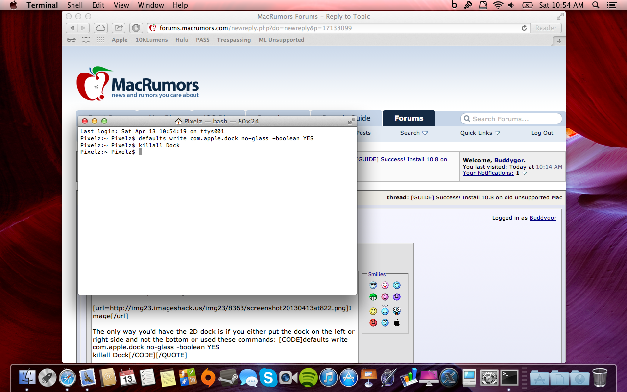

Ok, here's proof- te first image is using the command you gave me, and see it turns the dock 2D.
The second is changing the last command to 'NO' which turns it into the broken 3D dock.

Huh. Wierd. You can try typing in:
Code:
defaults write com.apple.dock no-glass -boolean NO
killall Dock
That should turn off the 2D dock and reenable the 3D dock
Code:
killall Dock
Ahah! Thanks, but the original command you gave me enabled the 2D dock- you never gave me that one before! Sorry for the misunderstanding.

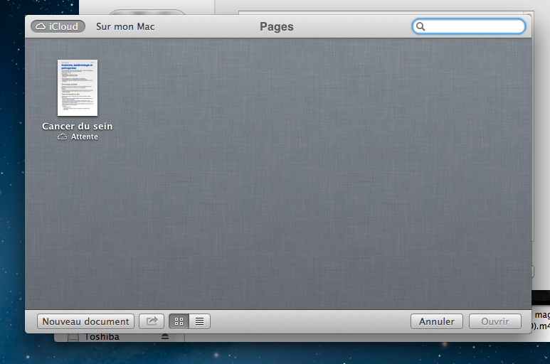

Icloud document and data - no sync
Hi Hackerwayne
First Ty for all! you roxx man !
Mountain Lion 10.8.3 is running fine on my macbook 2,1 with MLPostfactor v.0.2.2 but i only have a little issue with icloud:
I cannot upload and download my documents (pages/text edit/keynote...) on the cloud.
When i put it on the windows, i have a "waiting" status ("Attente" in the picture)
https://forums.macrumors.com/attachment.php?attachmentid=407635&stc=1&d=1365875284
I tried many things from other post (Uncheck and check "document and data" in icloud preference; deleting Ubiquity, Mobile document, GlobalPreference.plist) but nothing works
What may be the problem?
