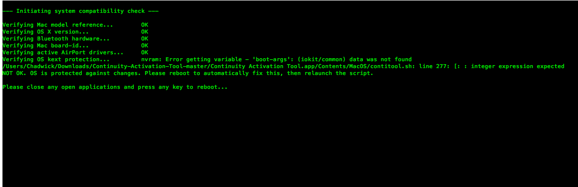

The script did not work at first.
I received an error that something was locked for editing, and that I needed to press any key to reboot. When I pressed a key the system appeared to freeze.
I saw the same an error on another post, this was it:
attachment.php
I was able to get around this buy first running the command "sudo nvram boot-args="kext-dev-mode=1", then running the tool. The tool then didn't ask for my password, the diagnostic finished, so I hit activate.
It ran through all of the sequences, and said it needed to reboot which it did successfully.
I think something corrupted the kexts when the system "froze", I would put back the original kexts using these instructions.
