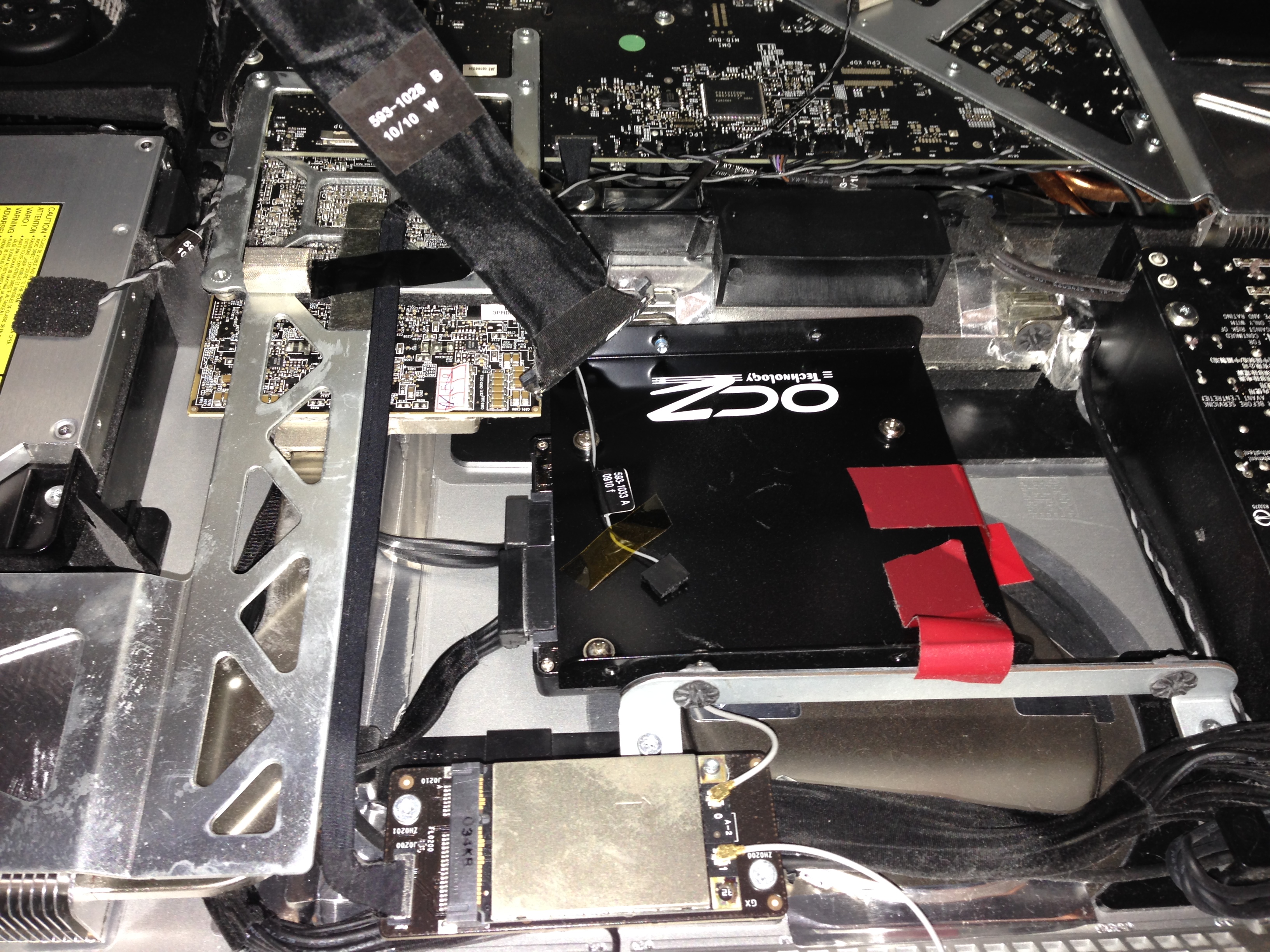

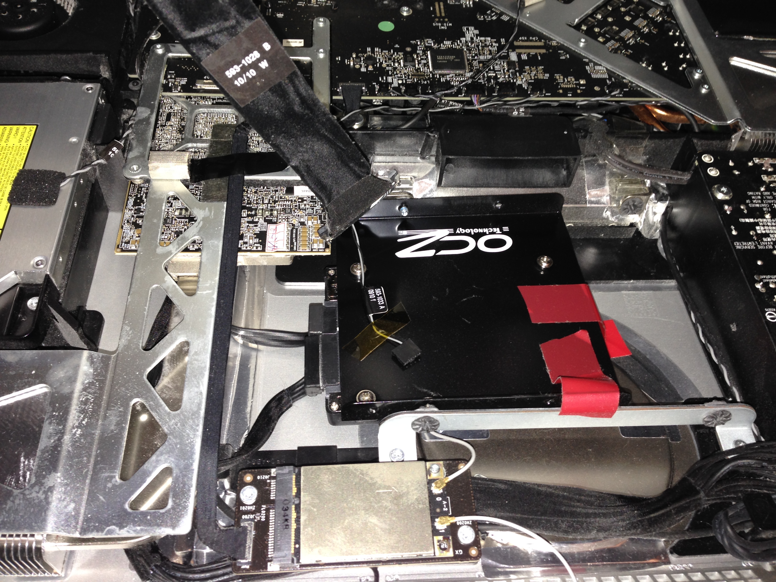

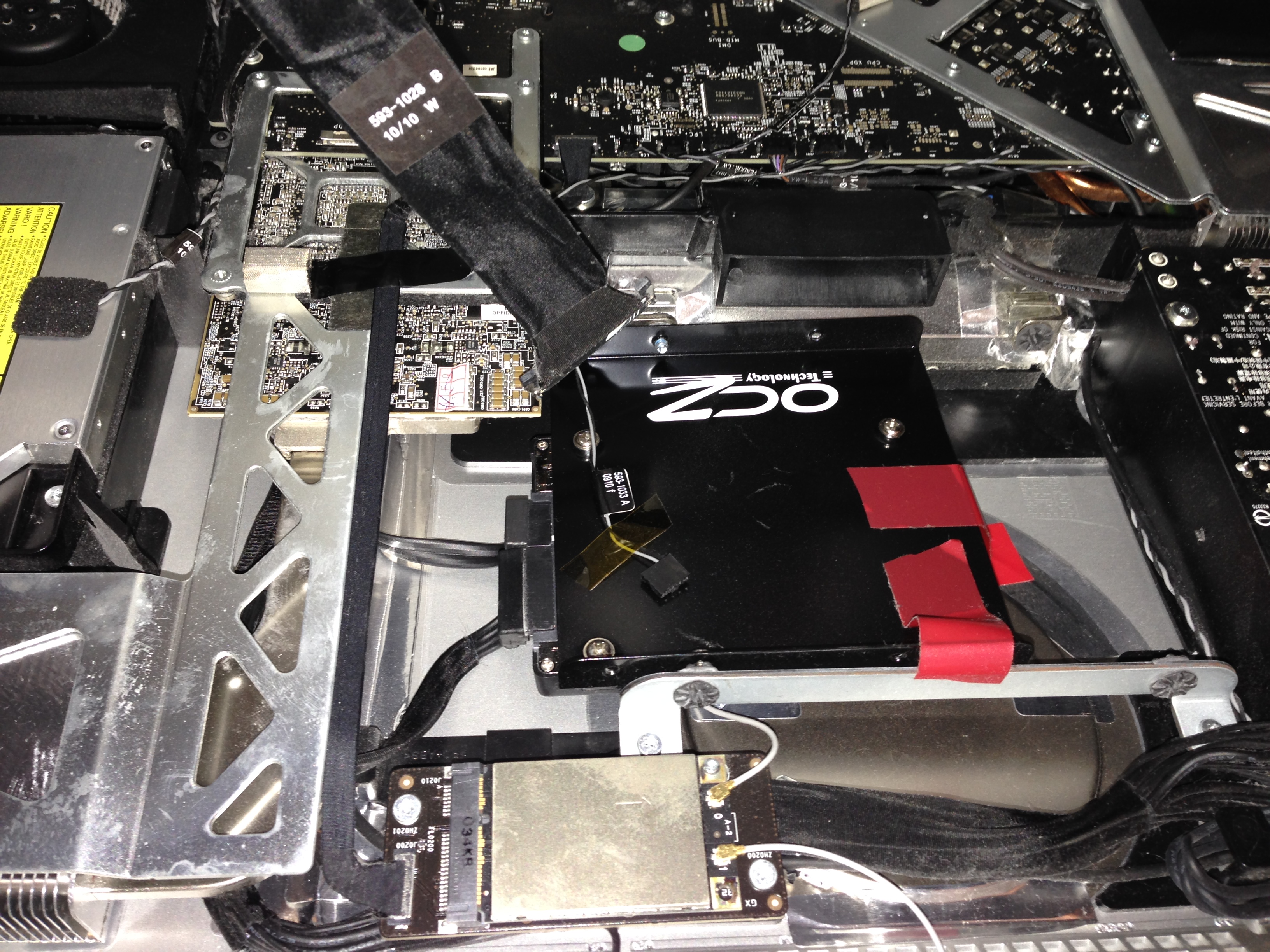

How would we know if there is USB circuitry there? This is a photo of the inside of my late 2009 iMac 27" Core i7 2.8GHz. The AirPort card is near the bottom.
P.S. What of the fact that the AirPort card currently connects with only two antennae? It looks like the Apple Broadcom BCM94360CD requires three AirPort antennae and one Bluetooth antenna.
View attachment 507961.
Unfortunately you cant really tell from looking at it, with that its truly try and see.
Not using all the antenna clips is fine. I know you can buy extra antennas from places if you really want to fill all of them but you would need to find a place to mount it (much easier for mac pros, not so easy in iMacs)
