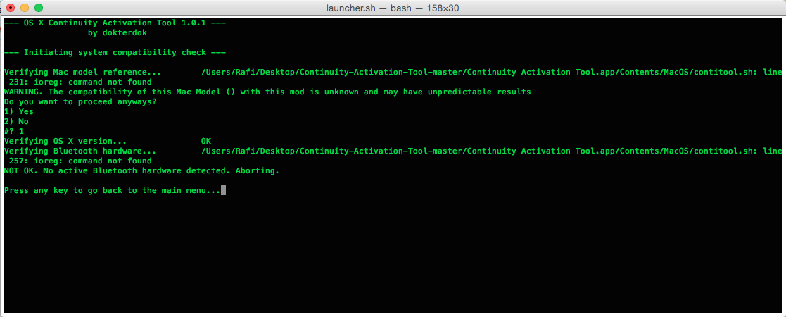

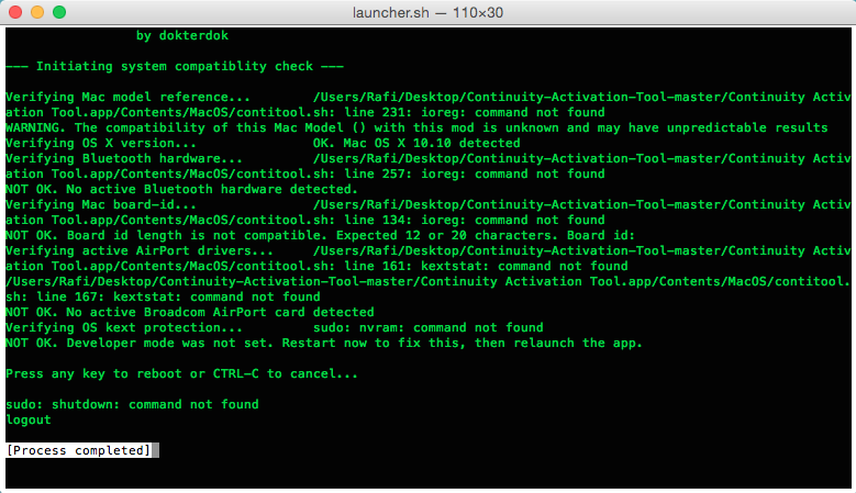

It's the first time I see this, thanks for the report. Your system appears to be missing a key utility, called ioreg.
The immediate workaround is to find an up-to-date copy of it (I'm not at my comp) and place it in /Continuity Activation Tool.app/Contents/MacOS/
other workaround that should work: download and install Xcode from the Mac App Store, reboot, re-run the app.
Thank you for your reply. Unfortunately installing xCode and restarting did not help and i continue getting the same error. The diagnostics also give some additional information, but in general i guess i need to exchange the wifi card.
Your wifi card has nothing to do with this. You have a software problem, maybe small, maybe large. Either your PATH is set wrong, and dokterdok's script isn't smart enough to set it properly, or something else is seriously wrong with your shell's environment, or your OS is totally messed up.
In the first two cases, you can work around this by creating a new administrative user and running the script from that login. But if that doesn't work, chances are that you'll have to reinstall the OS to solve the problem. As long as you're getting messages like "ioreg: command not found" you know it's your software and not your hardware that's messed up.
