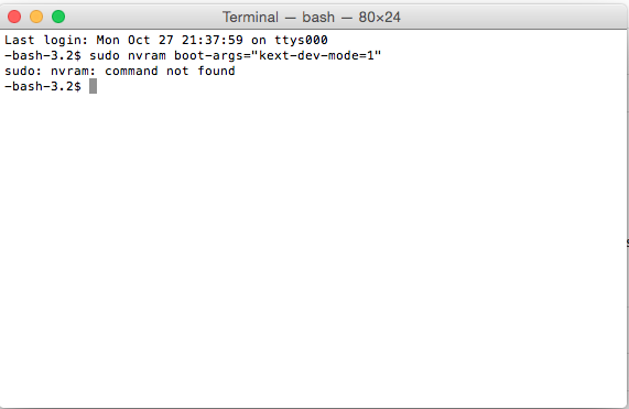

old-fashioned. I don't have skype. give your icloud id, make sure you have the same icloud id in iCloud, Messages, iMessage and Facetime on both ios and Yosemite.
Terminal this command and reboot :
Code:
sudo nvram boot-args="kext-dev-mode=1"
Also install free Path Finder trial. Once its done tell me, l'll join you with Messages screen share fonction and see what i can do.
Code:
