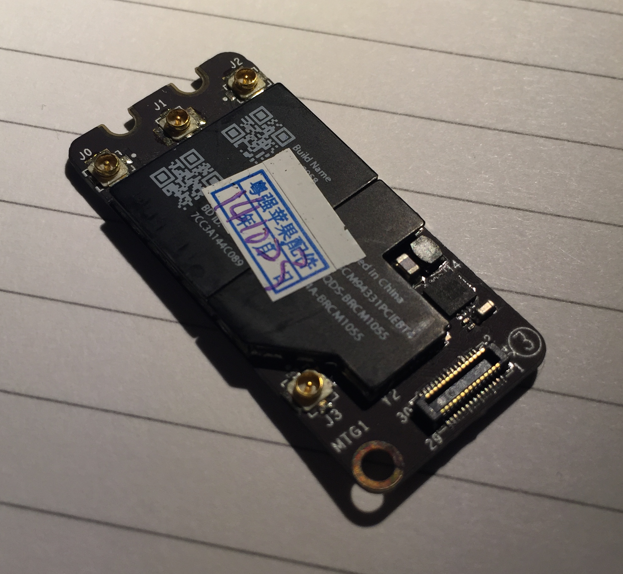

As expected, I had to change my built-in wireless card to the model mentioned many times in this thread: BCM94331PCIEBT4CAX. I found a decent listing on eBay for a card that had been pulled from a mid-2012 13.3in model.
I was able to follow the instructions in the iFixit guide for my model: https://www.ifixit.com/Guide/MacBoo...2010+AirPort-Bluetooth+Board+Replacement/3040. I was also reminded that sometimes Apple’s assembly plants are generous with their blue screw locking goo, because I stripped one of the screws holding the plastic card housing 🙁 Be careful!
As noted in other threads, the CAX card is not a drop-in replacement for this model MacBook Pro. Although the card is the same size, there is an extra antenna connection on the CAX. The cable connection socket is also in a different place.
Some things I learned:
- The shortest antenna cable connects to J2
- The middle antenna cable connects to J1
- The longest antenna cable connects to J3
- The additional connection point (J0) can be left empty.
I had to really cut away a lot of plastic from the plastic card housing in order to keep the CAX card in the same orientation as the original card. I had to trim the ‘top’ (near the 3 antenna connectors) in order to plug in the J2 socket. I also had to cut away a good chunk in the middle to expose the new location of the cable connection socket AND to leave enough room to actually re-connect the cable. I finally had to trim a small amount near the J3 connector to properly route the cable and allow the connector to fully seat.
All of my trimming meant that I was unable to actually screw the new CAX card into the plastic card housing. I used a small amount of very thin double-stick poster tape to lightly join the new CAX card to the card housing. Basically, I wanted to tack it in place so I could re-assemble everything. After reinstalling the card & housing assembly, it was pretty easy to connect and route the various antenna cables.
One last ‘gotcha’ was that the cable socket placement on the CAX card means that the existing cable is now too long to fit flat and snug along its path. I didn’t see any way around it, so I creased the cable as cleanly as I could, creating a z-fold that took up the excess. Everything seems stable so far, but I’m sure the stress I’m putting on the cable isn’t a good thing for the long-term.
After an open case boot test to make sure everything was reinstalled properly, and that I was receiving the proper wi-fi signal, I made a trip to System Information to see if the new Bluetooth portion of the card was working. Success!
Running the Continuity tool and following the post-install instructions gave me a hiccup-free install of the modified kexts. Thanks again for the scripting and installation package work—it made that portion of the install a dream!
Continuity seems to be working properly (2-way) between my iDevices and the MBP. Mail, Messages, Safari, Pages all worked right away. I haven’t spent time getting Numbers or Keynote working, but I understand they make take some fiddling with.
Hope this write-up helps other folks with mid-2010 MBP models!

Card connectors
Hi, I am new to the forum!
I just got one question. The new WiFi/Bluetooth card has 4 antenna connectors. In my mid 2011 27 inch iMac, I have 3 antenna connectors on the WiFi card. I presume with the new WiFi/Bluetooth card I have to figure out which ones belong to the WiFi. Am I correct that the fourth and last antenna connector belongs to the Bluetooth??
In that case, do I have to reroute the bluetooth antenna cable from the (old) bluetooth card to the new WiFi/Bluetooth card and connect it to the remaining connector? Or can I just leave it on the bluetooth card.. If not, there is a good chance that the bluetooth cable isn't long enough and needs to be extended...
And apparently, the adapter card needs data from 2 cables. Can someone explain me what this is and how I do it to get my WiFi/Bluetooth card up and running. I presume the 2 data cables are necessary..

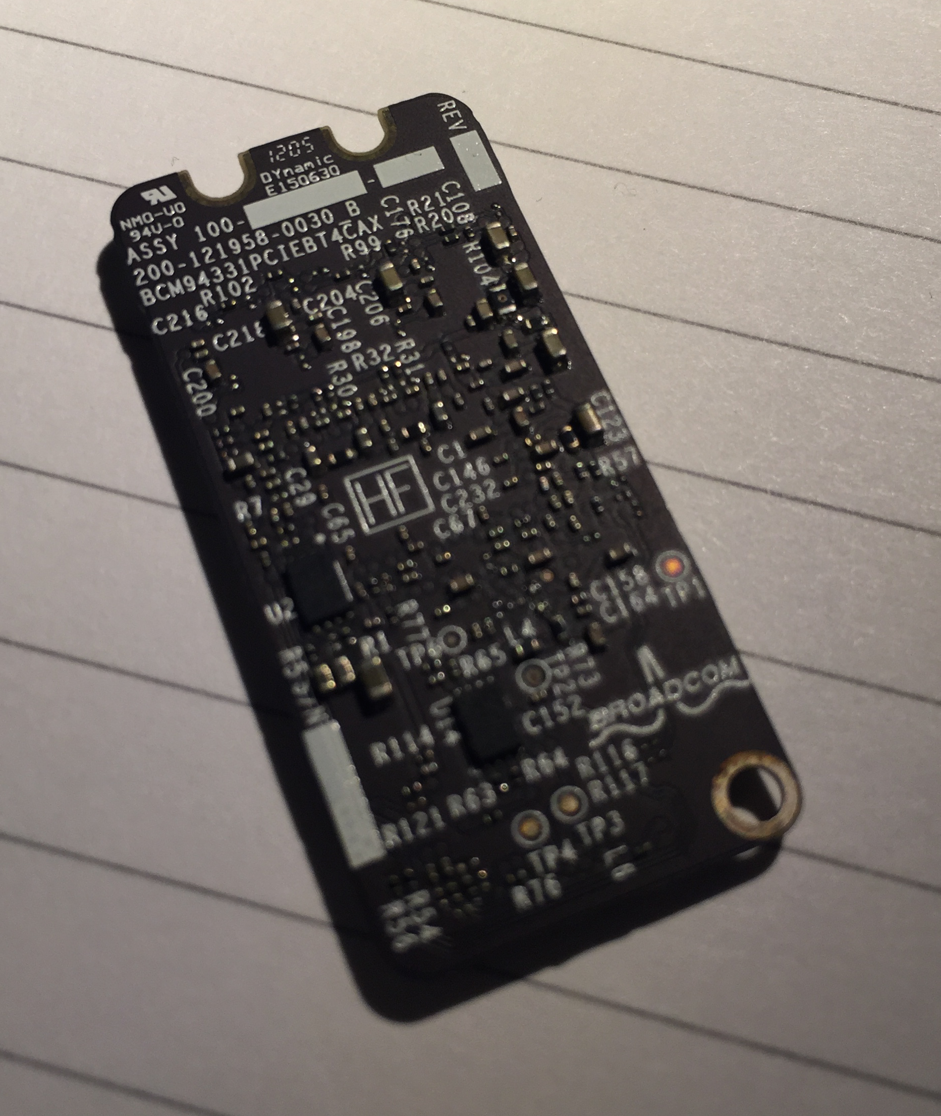

- Alright. So I received the card today, purchased from this seller, and I can confirm that it is indeed the correct CAX card (see my photos below).
I won't have the time to tinker around with installing it the next few days, but I hope to be able to this weekend at the latest. 🙂
