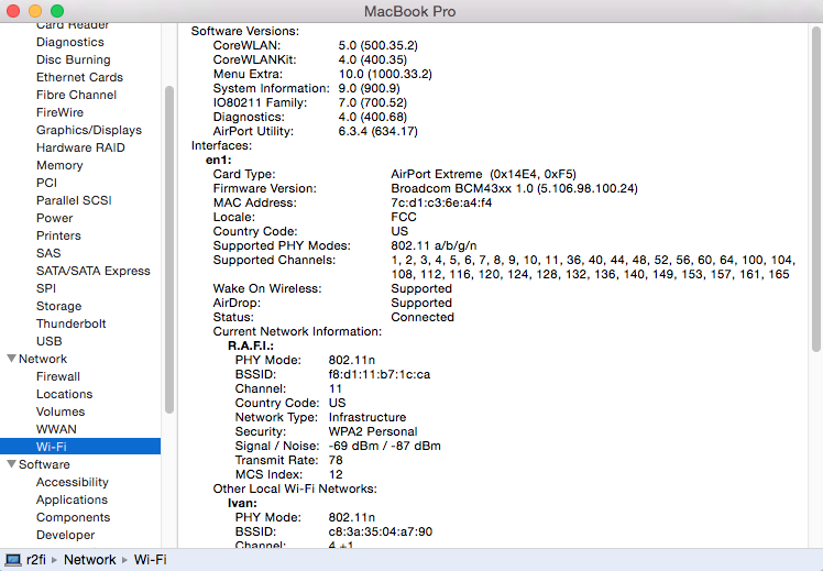

Using an early 2011 MBP here, bought the CAX card and installed.
WIFI works on boot but no recognition of any bluetooth hardware. Has anyone encountered anything like this? Did I just get a faulty card? Can't run the Continuity tool due to hardware mismatches.
TIA
Does anyone have anymore insight on this? I've checked and re-checked the wiring.... Must be a faulty card? Appears it has happened to another individual on this forum as well.

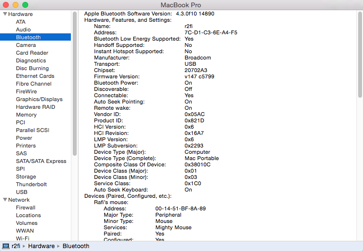

Card finally arrived

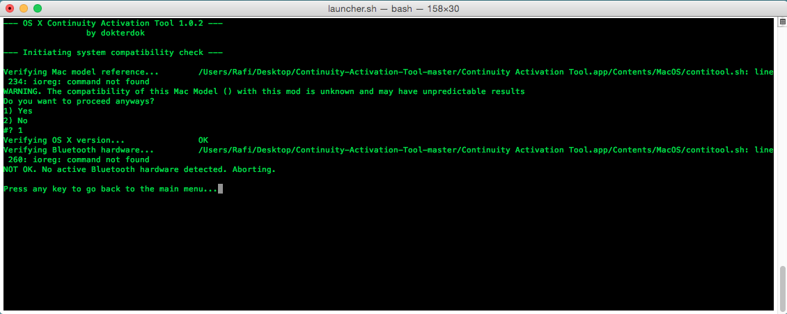

Hey Guys and Girls,
I'm back. Finally received the BCM94331PCIEBT4CAX card, ordered it from aliexpress (Link). Took about 2 weeks to arrive.
Prerequisites: I've got a Late MBP 15inch exact model is A1286. The card i got looked exactly like the one that was already in my Macbook so i figured the cables would go on the same spots (correct me if i'm wrong here).
Basically after installing the new card (which took me about 15 minutes tops) i booted up my MBP, wifi connected immediately to my router and the bluetooth icon was active. I quickly took my Apple bluetooth mouse and tried to connect pair it - worked flawlessly. So far so good, i was excited and getting ready to start Continuity Activation Tool.
Downloaded the latest release, started it up, gave it admin permissions pressed 1 > 1 and baam ! Nothing !

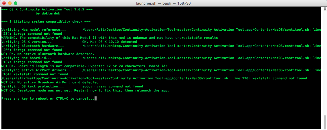

Decided to run the diagnostics:

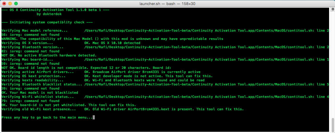

After that i decided to download the latest beta and run the diagnostics there as well:
I can't figure out whether there is a problem with my Yosamity or whether the problem is with my hardware. Everything seems to work fine though, mouse connected fine and wifi works flawlessly... really not sure where to look right now. Any suggestions... ?
Hi Rafaelo, you've put your finger on a rare issue, where your system can't find the tools needed to get the job done. I've uploaded a fix at the moment, right here. Could you please check it out and report back? Thanks
Wow, thank you! That actually made some progress but i'm still getting one single error:
Thanks a lot for your efforts to help me. Really appreciate it.

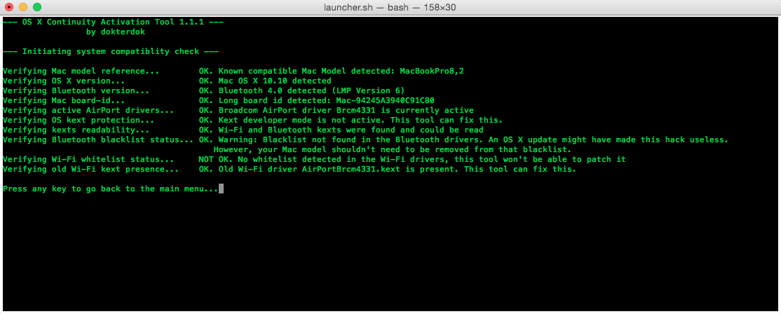

Could you please try the following steps:
  1. Download CAT v1.1.1 (updated 1 hour ago)
  2. Rename any KextsBackup and KextsBackupBeforePatch folders in /Users/yourusername/ (e.g. KextsBackupBeforePatch_old)
  3. Run CAT and uninstall. Fresh kexts from the OS X recovery image will be installed.
  4. Reboot
  5. Run CAT and Activate
  6. Provide feedback
Thanks

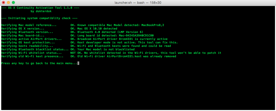

Hi, well i did as you said and followed the steps exactly as you wrote them. Everything went fine but after the restart i have no more Wifi. When it tries to search for networks it ends up with nothing. When i tried to activate with the tool, i get the exact same error like before. Diagnostics give a different result. I'm currently using my iphone as a hotstop so... helping me fix wifi would be appreciated lol :rolleyes:
Update: I got wifi working again. I renamed the kext folders back to what they were (without the _old part) and started the Uninstall process again from the Activation Tool. Wifi is back to normal phew :)
Update 2:
I actually got it to work!!! Summary of everything i did since the beginning:
I have a Late 2011 15inch Macbook Pro
1. Bough CAX card from Aliexpress for 30 bucks link is a few posts back.
2. Exchanged the card without any problems (really quick 15 mins tops)
3. Wifi and Bluetooth were working fine but the tool was giving me an error with the whitelist
4. Downloaded CAT v1.1.1
5. Renamed the KextsBackup and KextsBackupBeforePatch folders in /Users/yourusername/ to e.g. KextsBackupBeforePatch_old
6. Ran CAT and uninstalled. Fresh kexts from the OS X recovery image were installed.
7. Rebooted
8. After reboot i had no more WIFI and Bluetooth. Diagnostics gave a new error.
9. Restored the Kext folders that i previously renamed back to what they were.
10. Ran CAT again and selected Uninstall
11. After reboot i had WIFI working like normal again.
12. Ran CAT and ran diagnostics. Everything turned OK
13. Ran Activate, and the process completed Successfully!
14. Donated to the project <- Recommended step!
Thank you guys for all your efforts. Everything runs smoothly now. Amazing work, and congrats on your success and for the amazing tool making our lives a lot easier. Keep up the great work!
