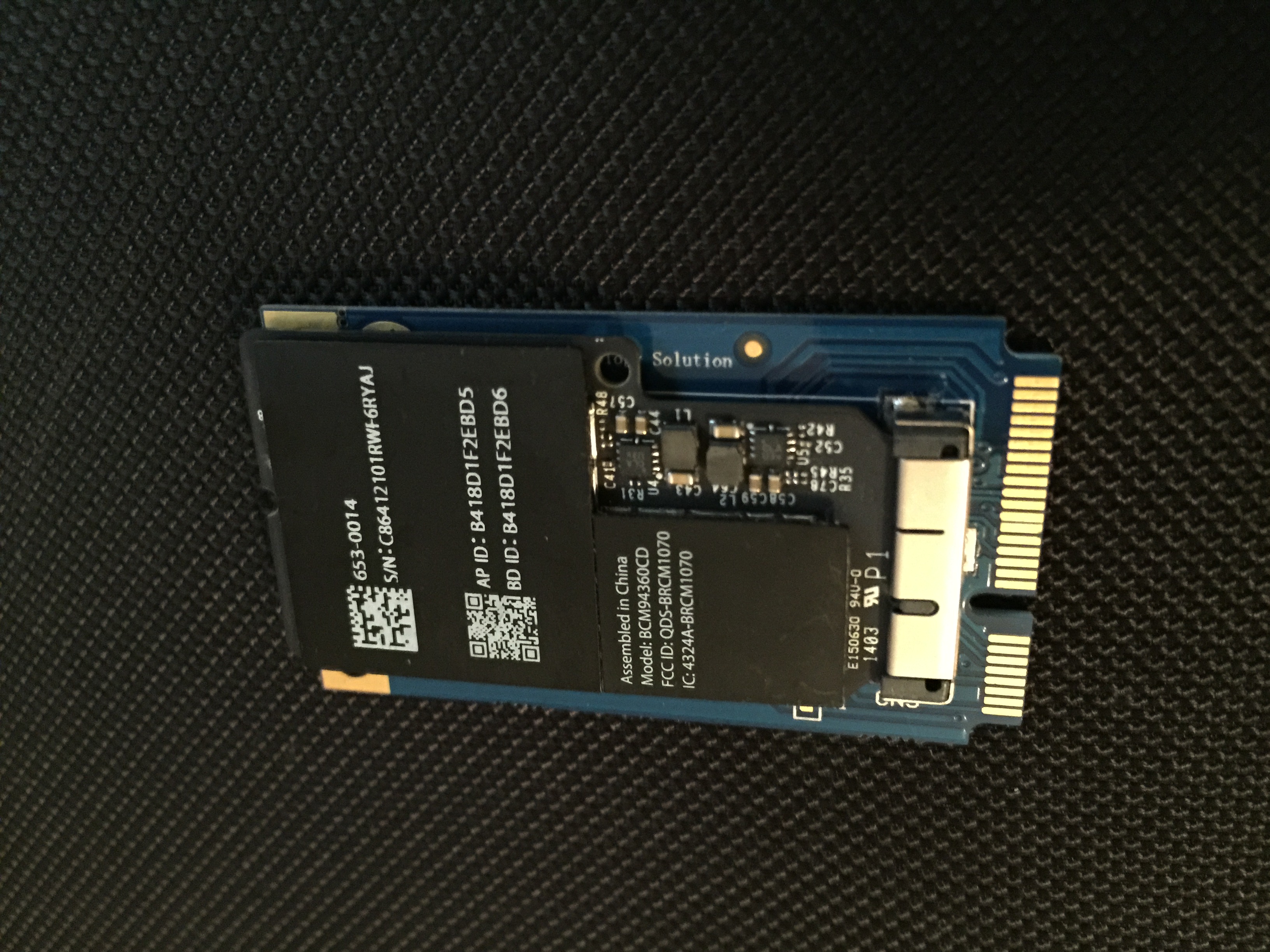

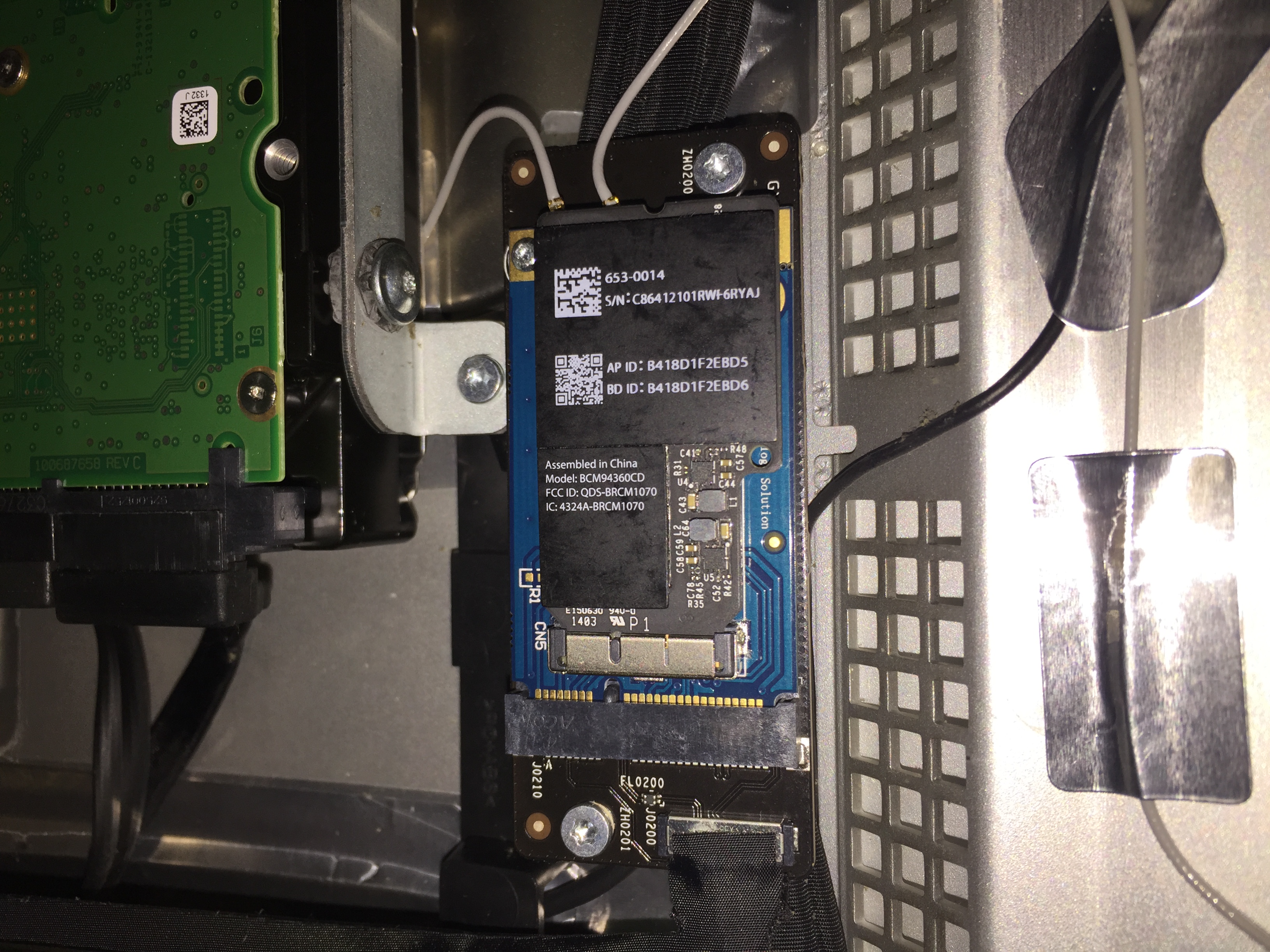

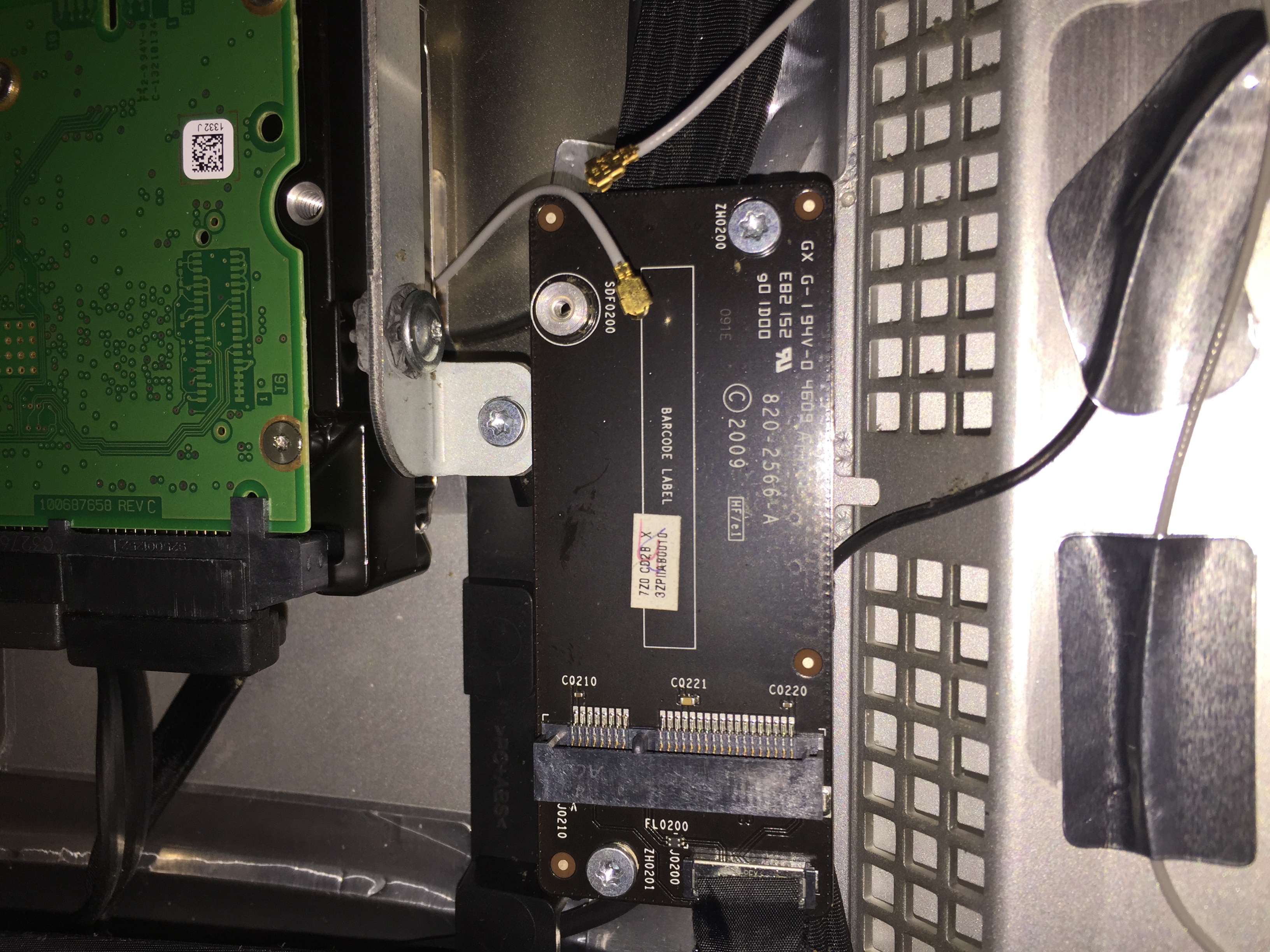

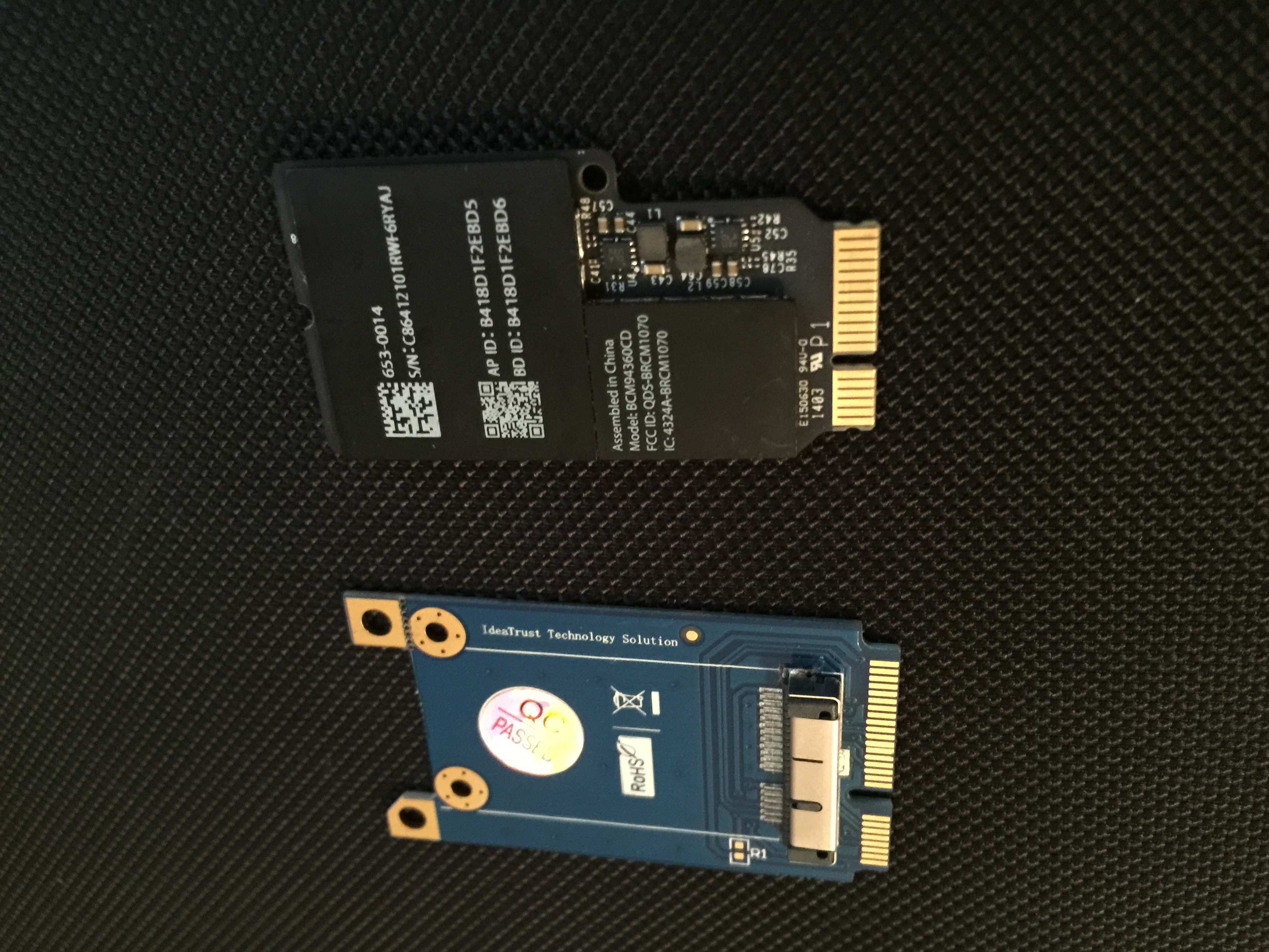

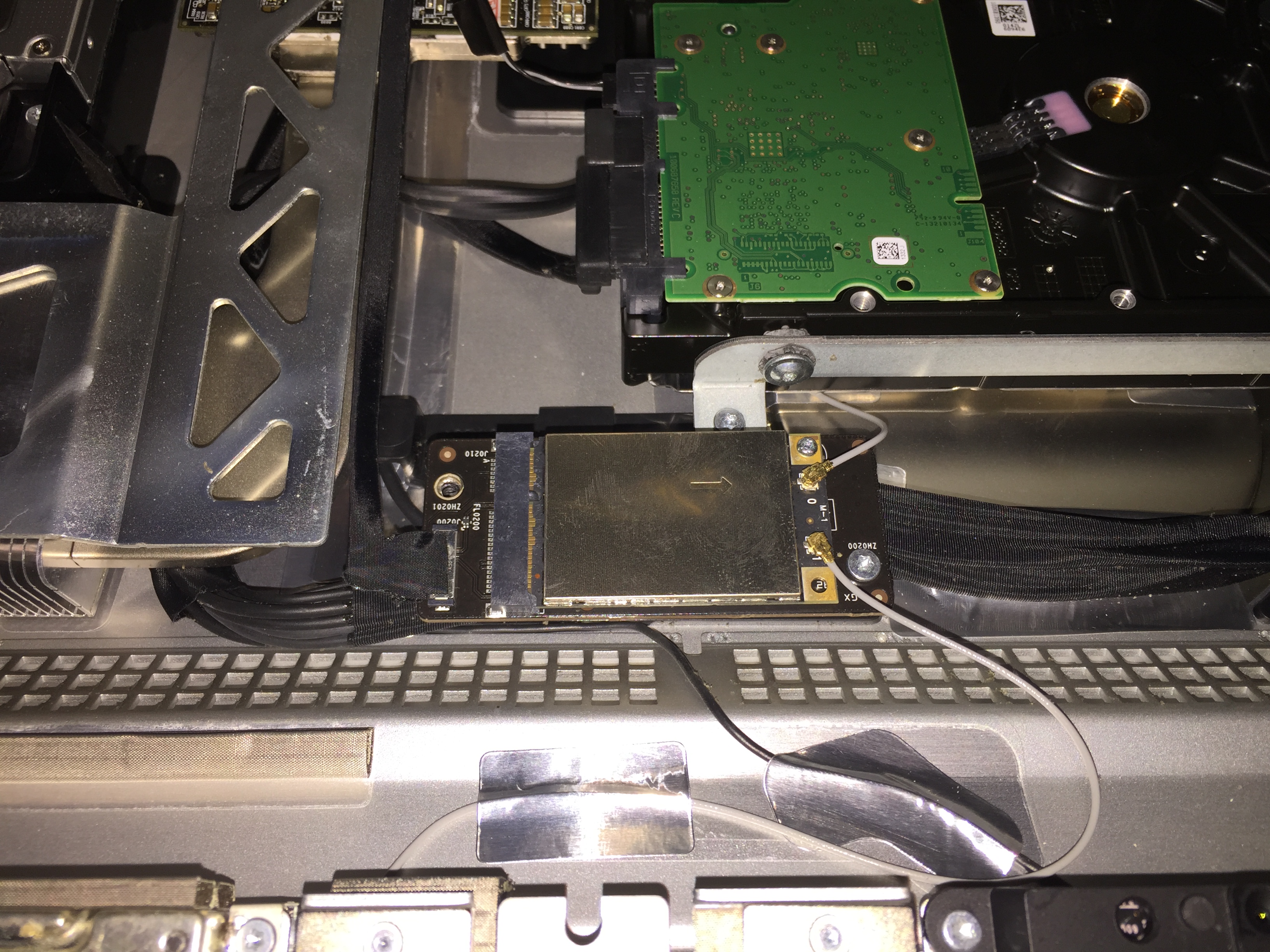

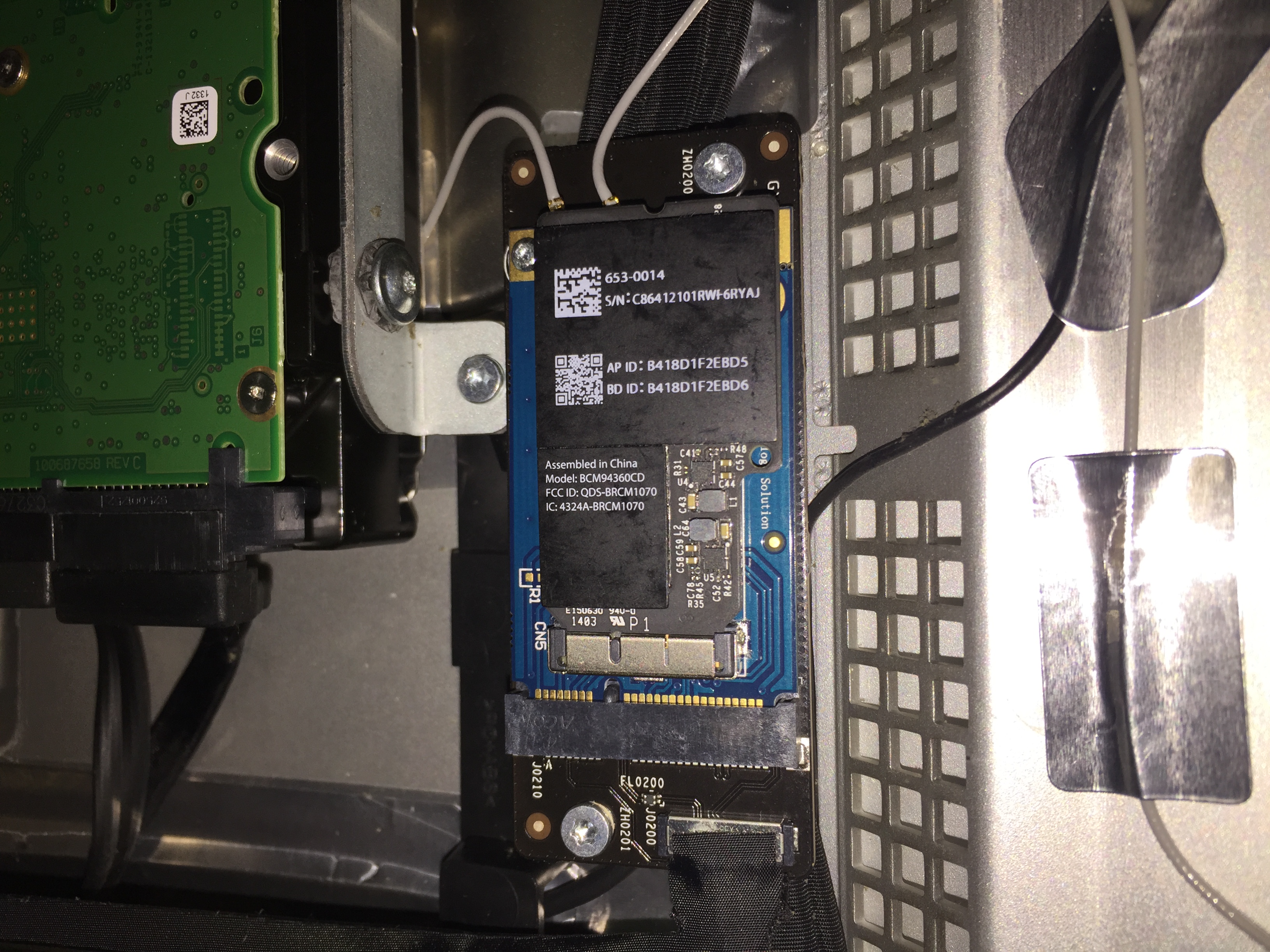

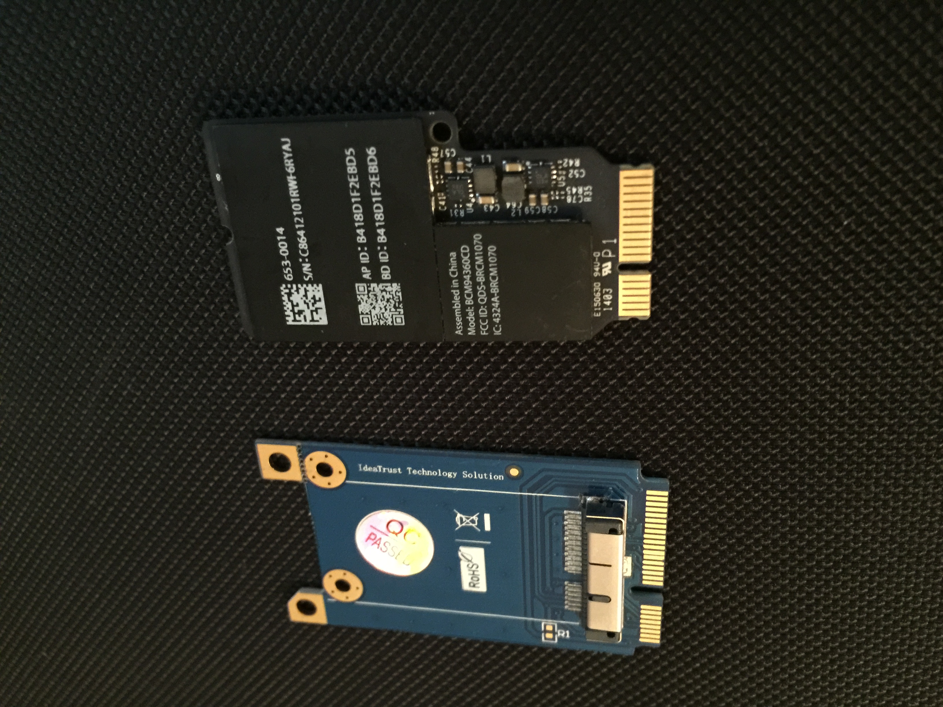

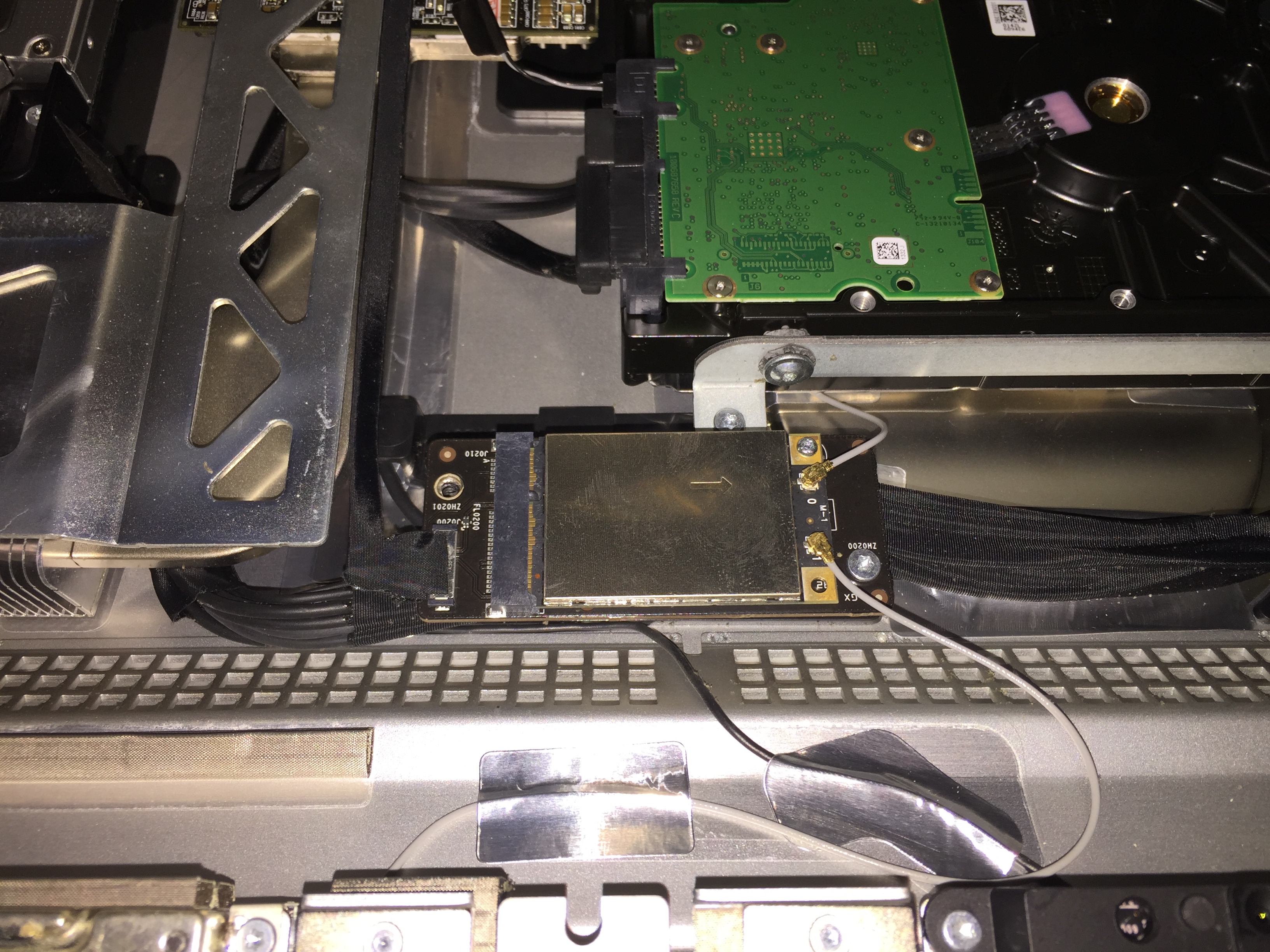

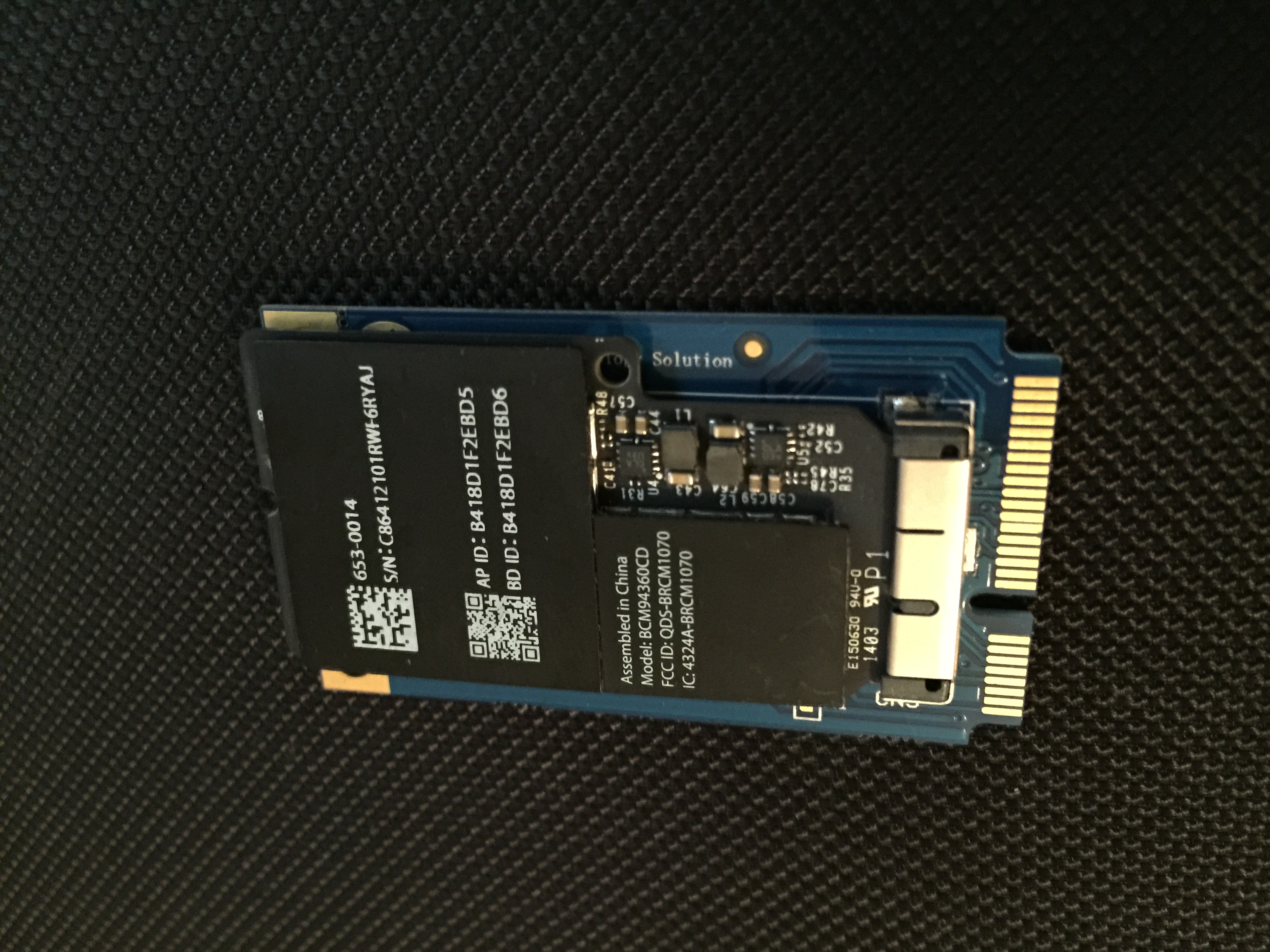

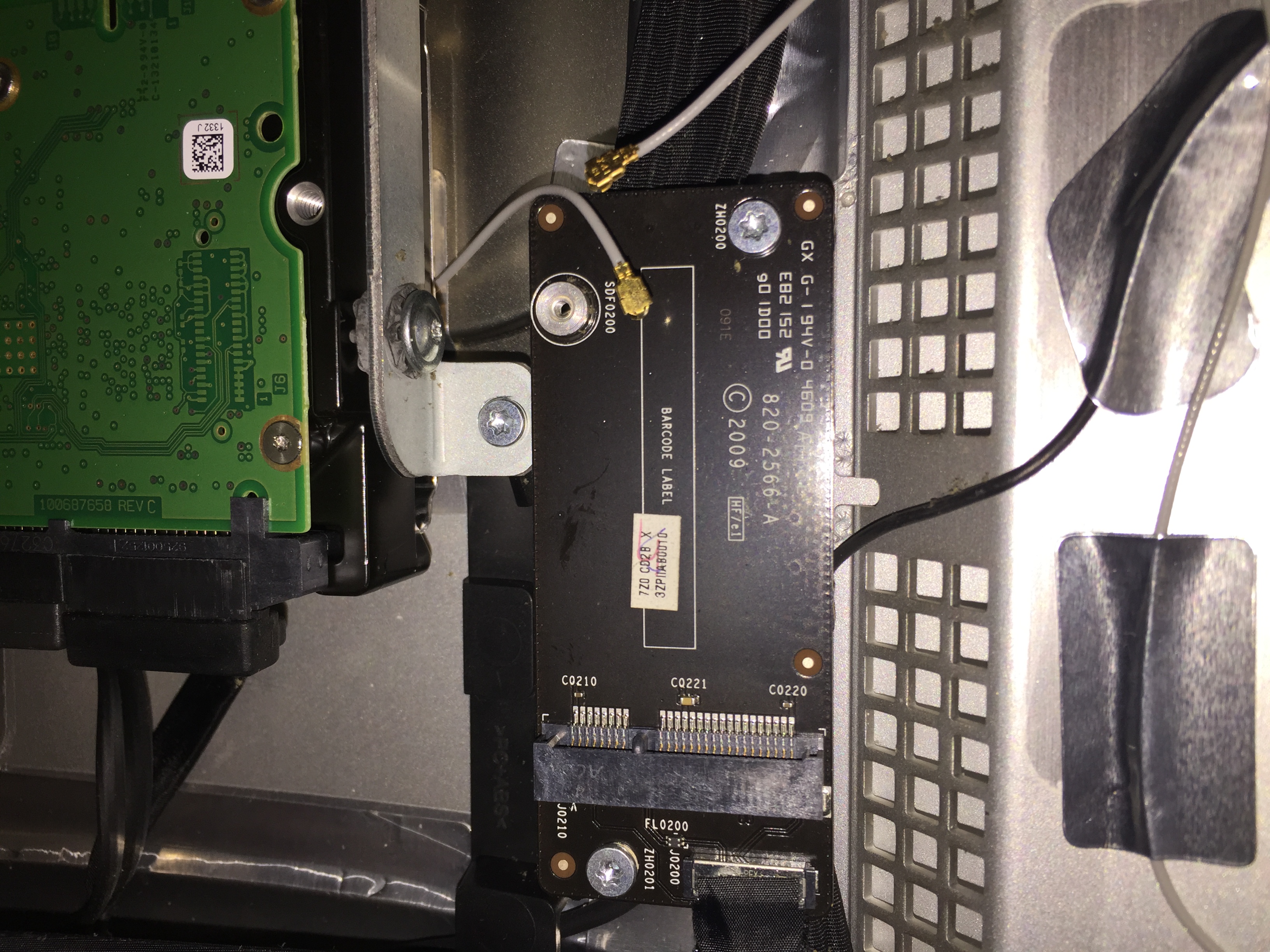

I have a Late 2009 iMac 27" i7 model. I already purchased the Broadcom BCM94360CD. I just ordered this adapter from eBay. It says clearly that this it the adapter for this Braodcom card.
Once it arrives I'll try the install and see how it goes.
So, I finally received the Mini PCI-e adapter. The BCM94360CD fit into the adapter perfectly, and the old wifi module's two cables fit onto J0/A0 and J1/A1 connections. With swapping the old wifi module for the new wifi module, I have 802.11AC wifi that works flawlessly.
Now the BLE 4.0 is a different matter. I have to get an extension cable, and try to connect the current bluetooth antenna with the new wifi module.
Has anyone with a 2009 iMac had any success with the BLE 4.0?

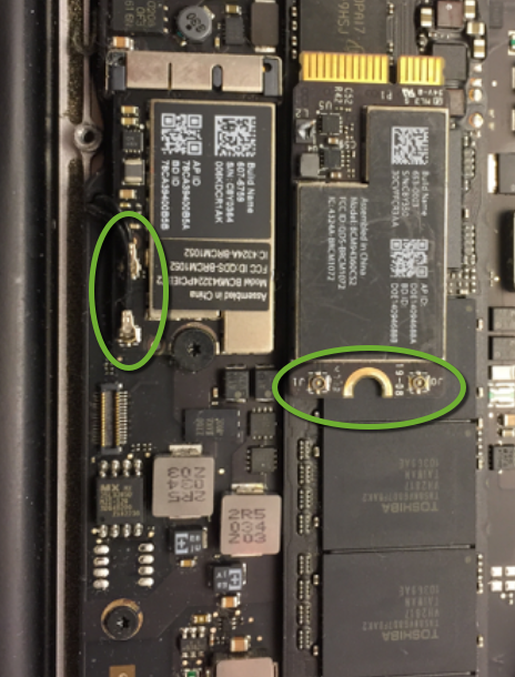

I got the BCM94360CS2 for my 2010 Macbook air the other day and I've run into a few problems
- The card is longer than the original one, so the screw mount doesn't line up (not terribly critical, I don't think that card is going anywhere) and the antenna cables don't reach.
- WiFi works...kind of. I get poor signal reception and it drops off all the time, probably because the antenna aren't hooked up.
Any thoughts or ideas? There is not enough slack for the antenna to reach, so I'm not sure what to do...
That's awesome! Thanks for the excellent pics too. Really helps to answer a lot of questions. I've got the same Late 2009 27" iMac. I have parts on order from OSXWIFI for about two weeks. Hopefully they'll be here any day.
Hopefully all you'll need is an antenna extension. I've seen a few for sale online and probably have some links somewhere I could dig up. Question is: how long of an extension do you need? Did you happen to measure that when you had your iMac apart?
Is this what you're seeing?
The new card they sent me have a busted component, so it's going back anyway.
The antenna length is a big problem. Don't know if anyone make an extension. Maybe you can put in new antennas?
