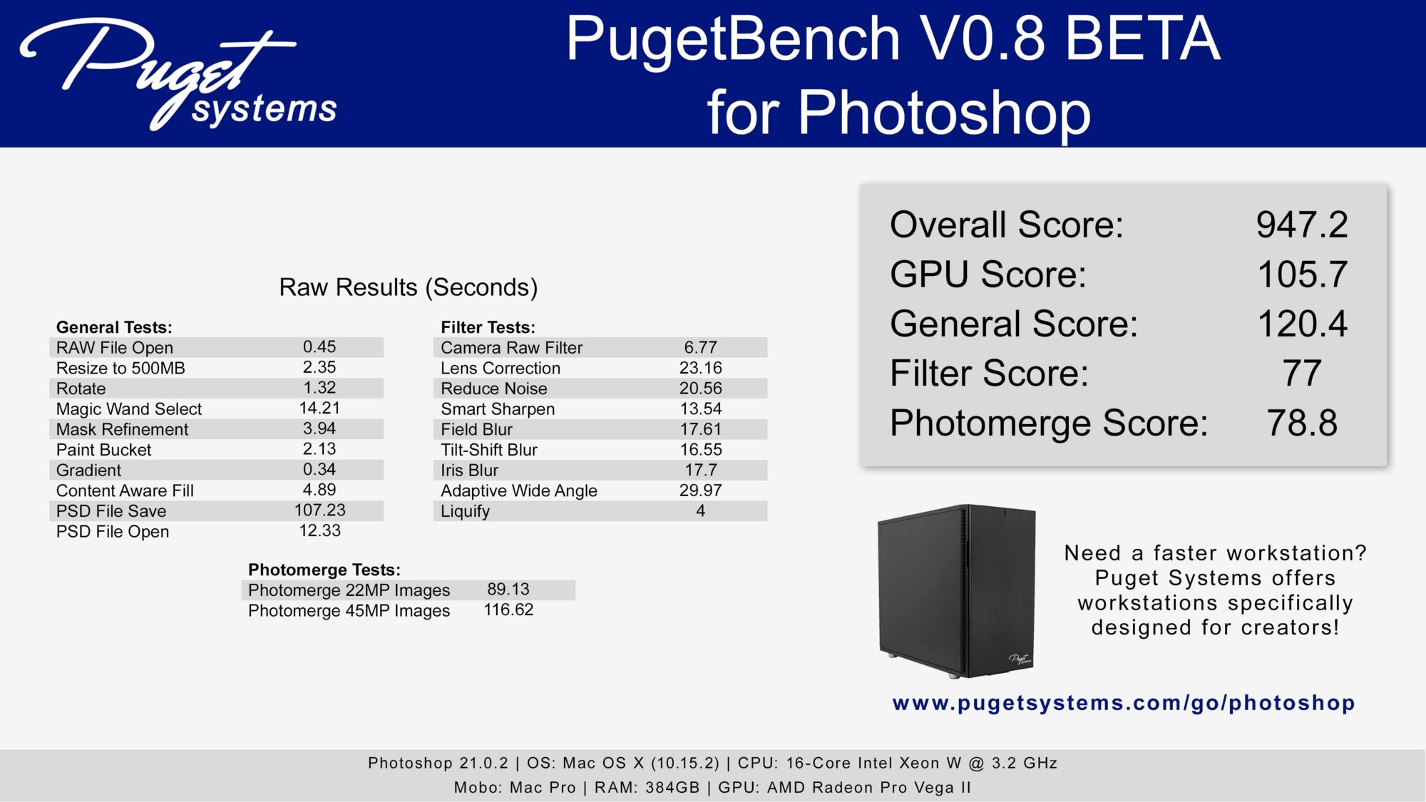

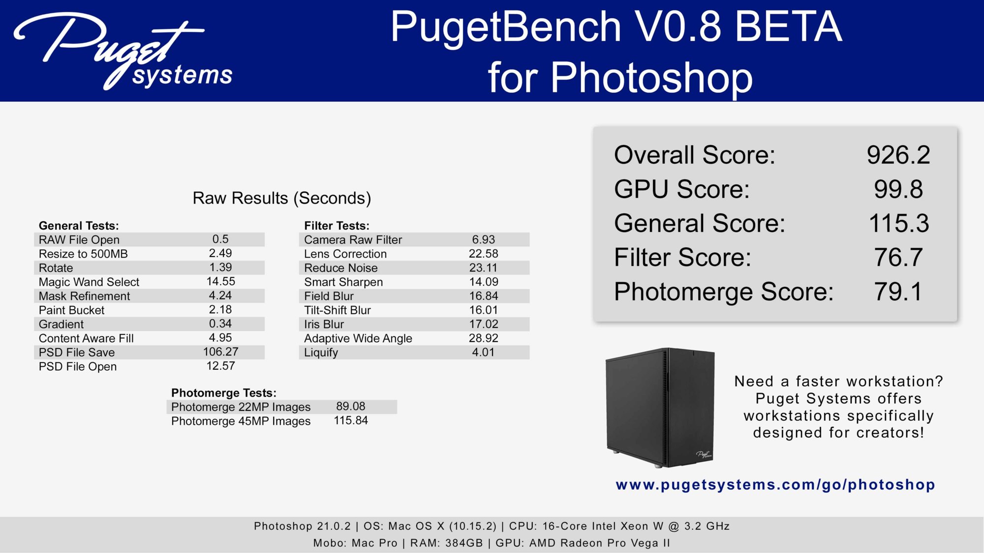

I finally have my Mac Pro updated to where I want with the extra RAM I ordered so this morning I ran the Puget Systems Photoshop benchmark. At the moment, it's the only "use case" benchmark vs. synthetic benchmark that I could find that a) works cross-platform and b) has recent data from other systems to compare to. My results in the graphic attached, Puget's most recent data at the following link:
A few points of comparison: My overall score of 926.2 is less than 5% lower than the highest overall score which went to one of the newest AMD processors, the AMD Ryzen 9 3950X 16-core. Impressive performance for the AMD at it's price point but it's also a consumer chip and not entirely comparable (there are limitations in consumer chips). On the other hand, given that it has a almost 10% higher base clock speed, almost 7% higher turbo clock speed and 92% more cache (73MB vs. 38MB), one could argue that the only 5% total performance increase is a bit underwhelming. But the price! Very inexpensive, so kudos AMD (and a very low TDP, thanks to that 7nm).
On the "General Score" my system actually gets the highest score of any of the Puget Systems: 115.3, vs the top score of 110.3 for the AMD TR 3960X 24-core--and with 33% fewer cores, too boot.
On the filter score, I only got a 76.7, only good enough for 5th place, but the top score is only 81.1, so a little less than 6% different--and the top score in that category goes to an Intel 9900K 8-core anyway, not an AMD chip. The best AMD chip is the Ryzen 9 3950X 16-core, at 79.9, or just about 4% better than my system.
The Photomerge score I am getting is bizarrely low. In fact, without that being so low my system may have been the top overall performer. I suspect something is wrong here as it scores a 79.1, so low it's off the bottom of the chart. On the bright side, I never use Photoshop to merge photos, although I don't know if this is actually a Photoshop issue or something in Puget's benchmark, which is still listed as a "beta."
Finally the GPU score; they use the same Nvidia RTX 2080 Ti card with 11GB of GDDR6 memory vs. my system, which has the Radeon Vega II with 32MB of HBM2 memory. Scores are tight there, not surprising. My 99.8 score is the third highest behind an Intel 9900K and an AMD Ryzen 7 system, but not sure we can read much overall into this score. The differences across the top ten scores are negligible and of course Photoshop doesn't leverage the GPU as heavily as many other applications do.
Some caveats: It seems that they may have run all of their benchmarks on version 20 of Photoshop; I am on version 21.0.2. I could downgrade just to run the tests, but the oldest version I can install is actually 20.0.8, so I'm not sure what difference it would make. It could be why the photo merge score is odd though. Also, Photoshop is not very good at all in terms of using multiple cores/threads. That means the raw speed of the CPU and overall CPU/system architecture have a greater impact than core number. This was obvious as I ran the test as the CPU monitor showed the system barely doing anything....CPU usage rarely spiked to more than 50%, and typically was way down in the 10% range. Same with turbo boost, it mostly sat at the base Ghz and I only saw it spike as high as 4.1Ghz briefly.
So, a real world benchmark of a sort. Performance of the Mac Pro seems to be excellent, on par with the best systems Puget lists, with the exception of that off Photomerge score. I'm going to email Puget about that, as it seems like it has to be bug. Would an AMD processor be cheaper? Yes. Are they "40-50% better" as we've seen claimed here? Certainly not in this benchmark.
Meanwhile, if you intend to use Photoshop heavily with your Mac Pro, these results might be interesting and useful to you.

Just to update...it occurred to me that I hadn't yet launched Photoshop to check all of the settings, and I know that Camera Raw has it's own performance settings and the Photomerge test uses a bunch of RAW files so I checked the settings and sure enough, it was set to "Auto" for the graphics acceleration in Camera Raw so I set that to use full GPU acceleration just like Photoshop is set up, and ran it again. New results are better across the board, but the Photomerge score is oddly unaffected. Something is not right with that benchmark I think.
The new overall score is now 947.2, only 2.4% off the top score. The general score has jumped to 120.4, putting it 9% above every other system Puget has tested to date. The filter score of 77 is still good for 5th place, but the differences between systems on that measure is very small--it's only 5% off the top score (held by Intel i9 9900K). Then the anomalous Photomerge score, which actually went down by 0.3--probably just random variation, but clearly something odd there. Finally the GPU score jumped to 105.7, now good enough for first place in that category as well.
Given that the Photomerge score is fully 20% of the total score, if I am right and there's a bug in that test then this system could see a big boost in it's already high total score. I'm going to contact Puget and see what they say.
[automerge]1577820290[/automerge]
Oh, and BTW...those Adobe scores on Photomerge, if accurate, show how behind Adobe is on some things. I use Helicon Focus for focus stacking images. On my new Mac Pro I can load 30 61-megapixel DNG files and Helicon Focus will align and stack them in 6 seconds flat. Its really uses the processors to the max as well the GPU compute engine. On the processor side, it leverages the AVX-512 instruction set which has been shown time and again to be extremely helpful.
While running these tests I continued to watch the results, and my Mac Pro was basically snoozing through them. Max CPU spiked to 4.1Ghz, and rarely. Watching the cores, it basically ran everything on the first three cores, with the fourth getting less use and the fifth even less. All of the other 11 cores were basically flatlined all of the time doing nothing, except for brief spikes of 10-15% use. With the Activity Monitor processor window open, none of the virtual cores ever saw *any* use. Max RAM use was very minimal. It never got beyond 40% of the GPU RAM and never more than 10% of the GPU processor use. It would be nice if Adobe actually put some effort into performance optimizations. While many tasks don't parallelize well, many do. It was fine in the past, but it's been obvious for years now that multiple cores are the future, and now we're seeing 32 cores in *consumer* level processors like the Ryzen.

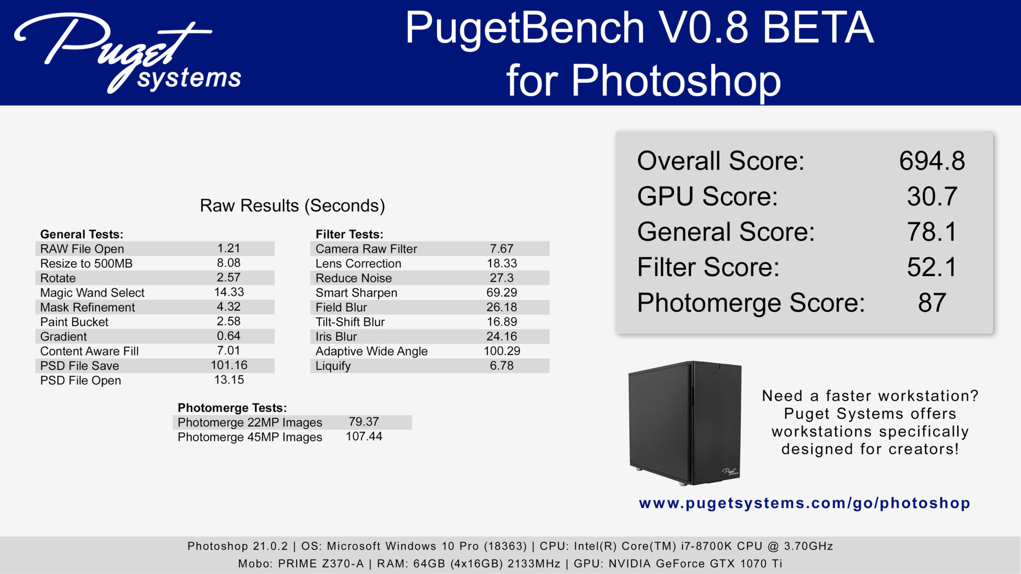

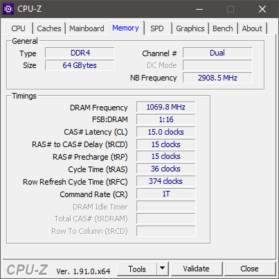

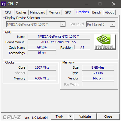

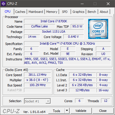

Thank you for posting your PugetBench score. Finally, some baseline comparisons! Can you also post up your full configuration?
Something is kinda weird about your Photomerge 45MP number, but I doubt it's Photoshop itself. I ran the test on my work PC using the latest version of PS (21.0.2) and got the results below. As you can see the Photomerge score comparison between our computers just doesn't make any sense, given the other score deltas.
It can't be a GPU issue since Puget's testing shows that GPU has no bearing on the result: https://www.pugetsystems.com/labs/articles/Photoshop-CC-2018-NVIDIA-GeForce-GPU-Performance-1139/
Maybe someone else with a 7,1 MP can run the bench and see if it's reproducible.

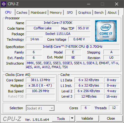

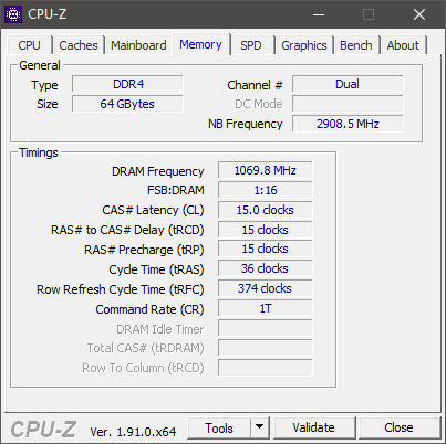

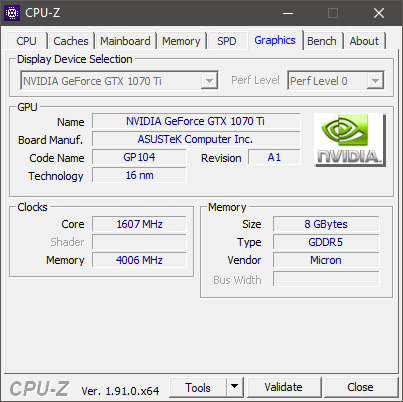

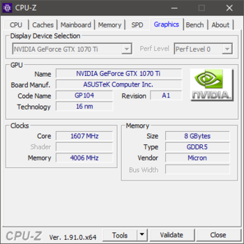

(I built this thing for about 2300 CAD [1770 USD] two years ago from consumer parts and it's been serving me well.)
(I built this thing for about 2300 CAD (1770 USD) two years ago from consumer parts and it's been serving me well.)
Yes, I personally suspect it might be an error in the scripts of the Mac OS version of their test. I can't find any way to report the results or give them feedback though.
As for the full configuration, it's actually embedded in the results image.
