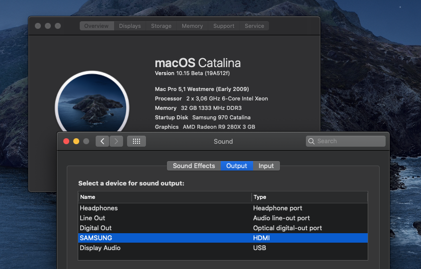

So, can report that this HDMI Audio fix still works in Catalina DP4 with R9 280X and my LE40B620 TV. I just had to update the components
Notes: I didn't put NightShiftUnlocker in Lilu/Contents/Plugins again since this is handled by the current @dosdude1 patcher 1.0b11 already, and works fine. Should probably mention I'm also using this .plist in Library/LaunchDaemons by @ASentientBot to get read/write permissions, you can read more about it here.

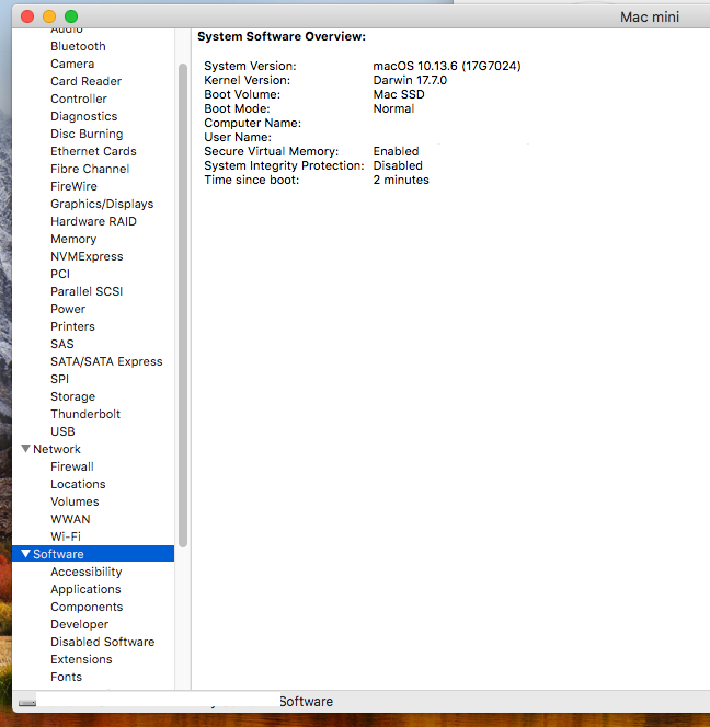

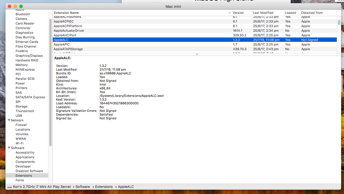

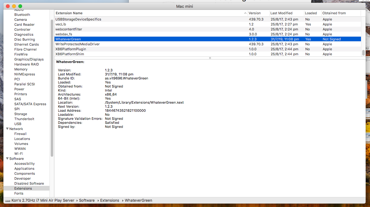

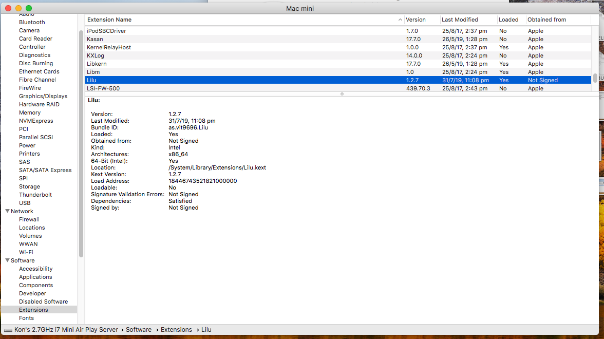

Hi there all...
after some mucking around & tinkering I finally got my eGPU to work with my Mac mini 2011 model...
eGPU enclosure is a Mantiz Venus
nVidia GTX 680 4GB GFx Card
Mac mini mid 2011 2.7GHz i7
Mac OS X 10.13.6 (17G7024)
eGPU enabled using the PurgeWrangler method (works perfectly fine but no HDMI Audio Passthrough)
I have followed the steps outlined at the beginning of this thread but no success....
anyone have any ideas what I may be doing wrong?

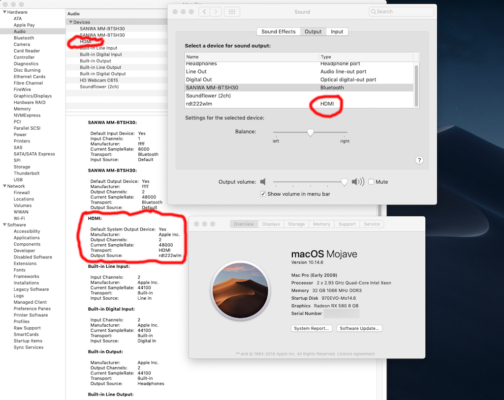

Out of curiosity - not that I need HDMI Audio - I connected my ( Japan market only ) Display port to HDMI adaptor to my RX 580 8gb's DP port - then from the Adaptor to HDMI cable to an old Mitsubishi monitor's HDMI port.
I'm in Mojave 10.14.6 HFS+ ( full, clean install ) - no 3rd. party kexts installed.
I now see HDMI listed in my Audio output.
My T.V. is too far away from my cMP at the moment so I haven't tested yet.
Since 10.14.4, HDMI and DP audio is natively enabled for the RX 580.

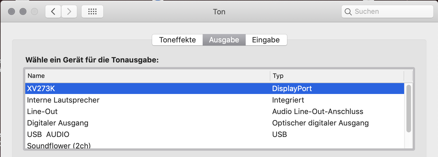

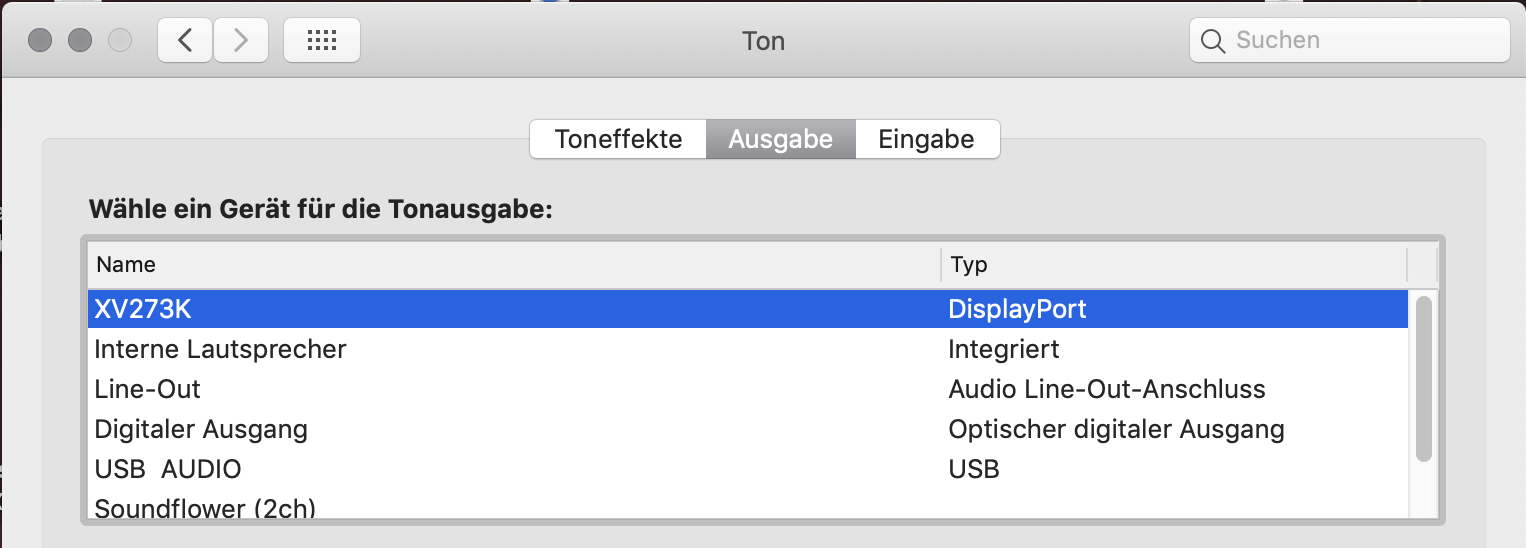

What I find surprising here is that macOS sees the audio output type as "HDMI," even if the connection to the video card is DP. I just tried this myself with a DP to HDMI adapter and the output type is "DisplayPort." I wonder if this has to do with how different models of the RX 580 handle audio. Have you tried connecting the monitor directly to the HDMI port of the video card?
My monitor audio with DP connection is indicated as DisplayPort.

Yes, it's connected DP to DP.
Yes, I like the Acer XV273K. No Mini-DP, two normal DP 1.4 and two HDMI 2.0b ports: https://www.displayspecifications.com/en/model/407f14c5 It was around $1000.-.
I use all monitor ports: One DP for the Mac Pro, one DP for my PC with GTX 1080 Ti, one HDMI for the Mac Mini 2018 and one HDMI for the Raspberry PI 4. Audio working with all ports. The monitor supports Nvidia G-Sync and AMD FreeSync, and has no fan.

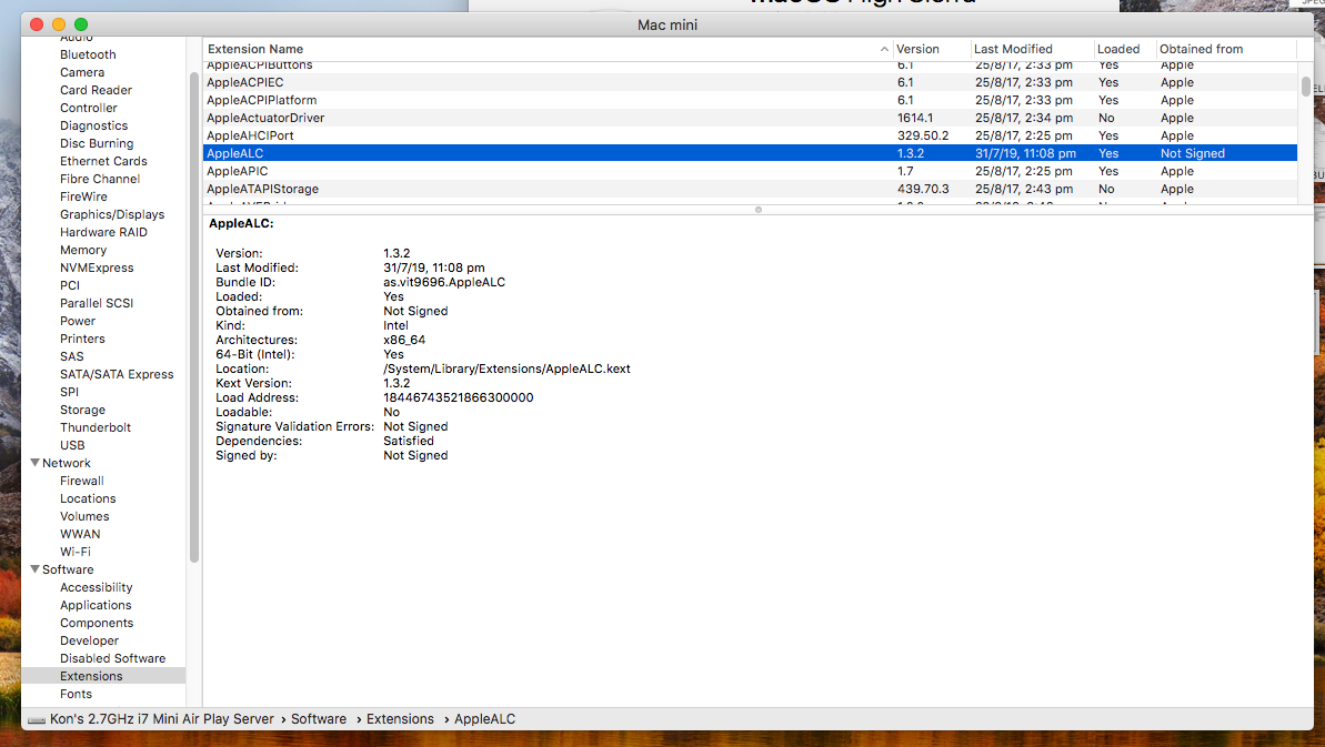

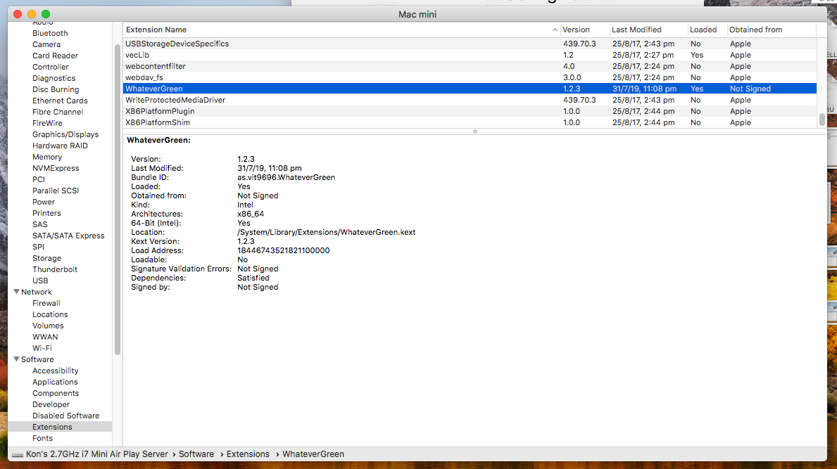

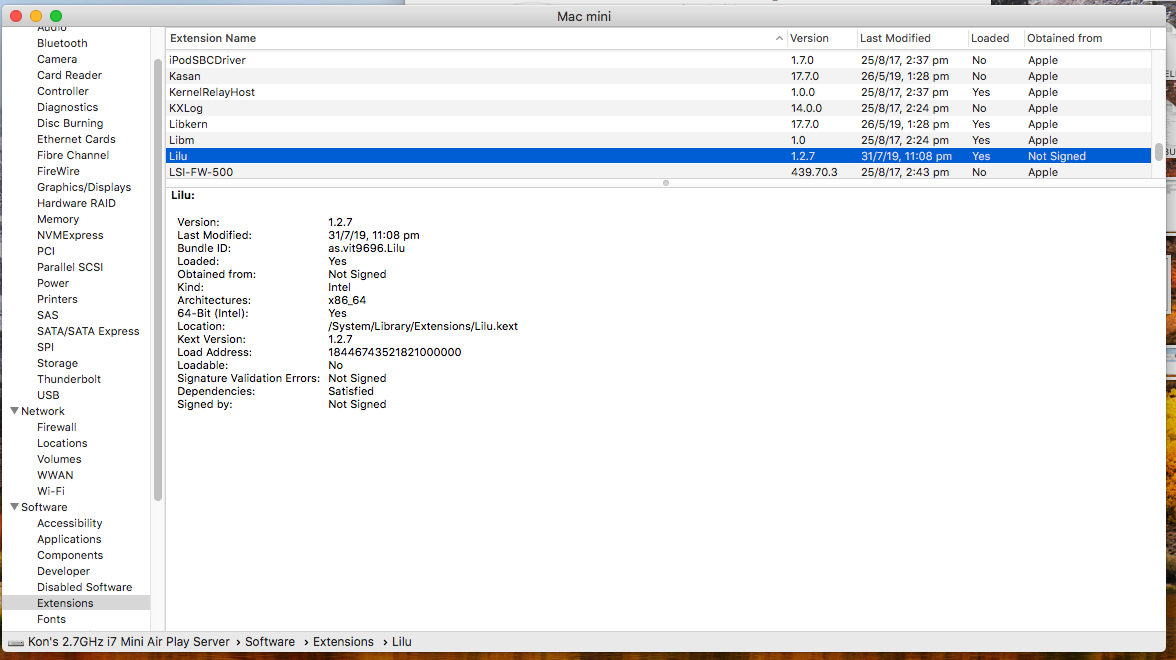

Hi there all...
View attachment 850931 View attachment 850932 View attachment 850933 View attachment 850934
So after some mucking around etc, i swapped the GFx card to a Radeon Vega Frontier 16GB & for some reason audio passthrough works perfectly on Mac OS X 10.13.6, couldnt get it to work with 10.14.6 but i guess thats another issue...
Overall i am very pleased that my eGPU works & my mid 2011 Mac Mini has been restored back to life
