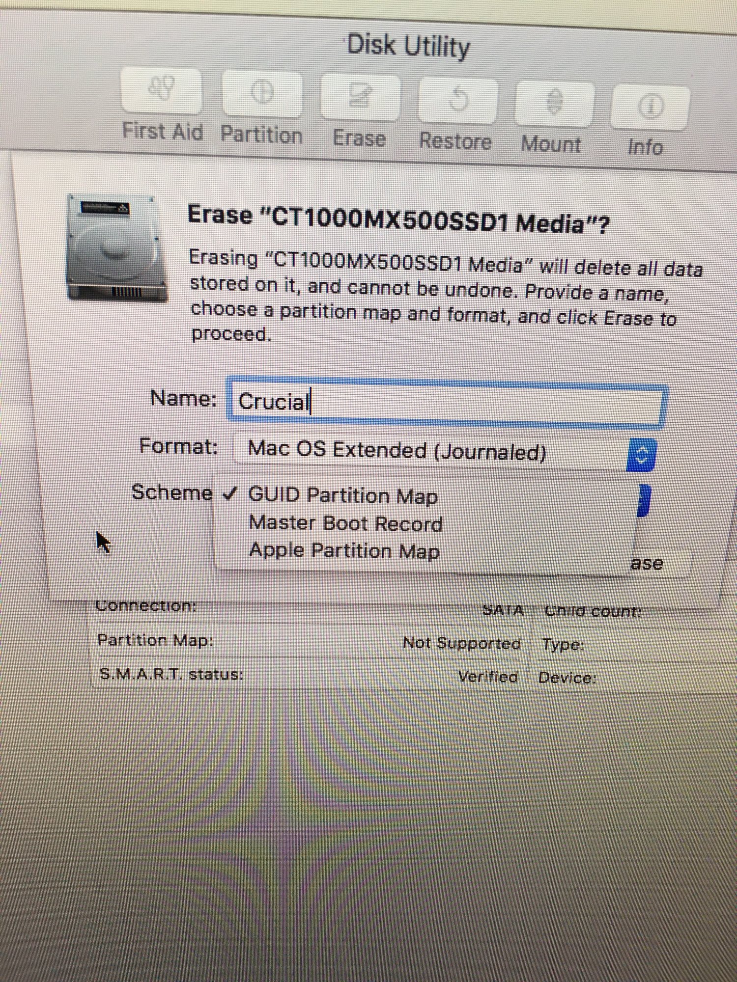

What happens when I hit erase?
It will format it at HFS+. HFS+ would work fine for High Sierra, but APFS is preferred.

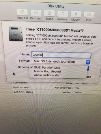

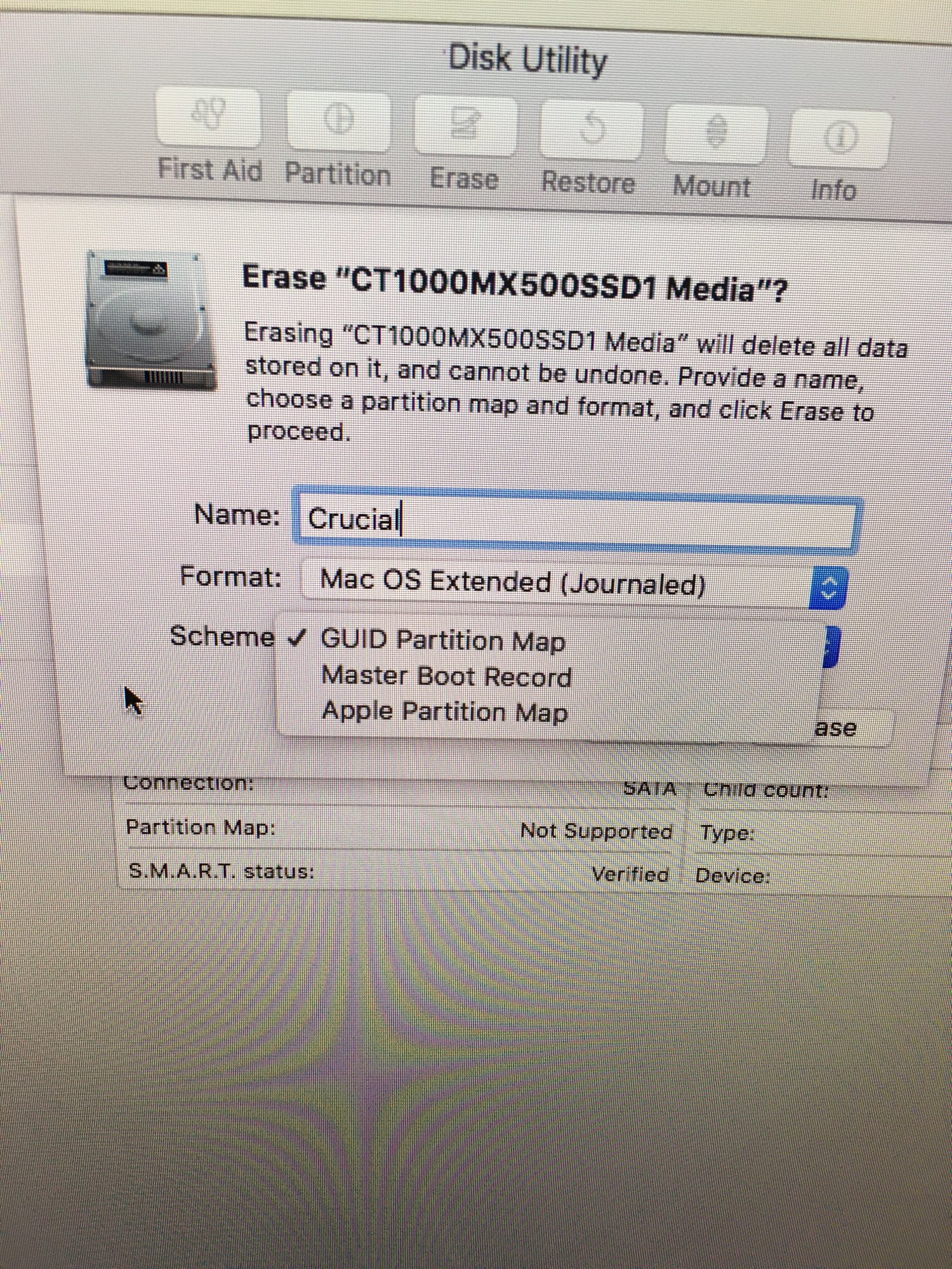

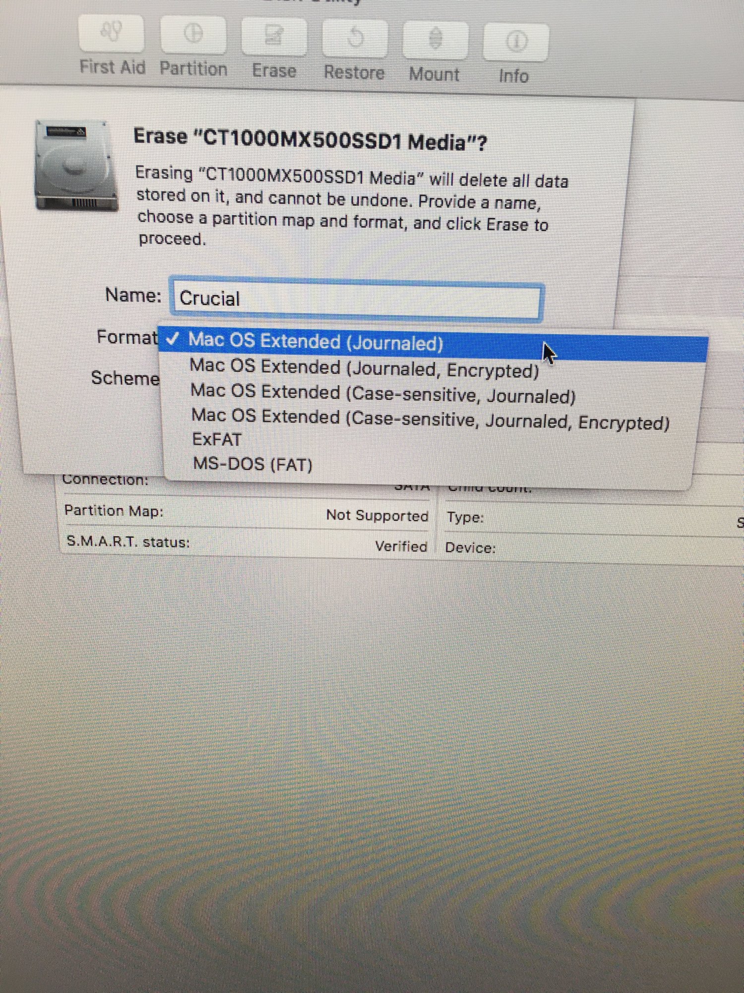

under format: Mac OS Extended (journaled, encrypted)?
under scheme: Quid ?

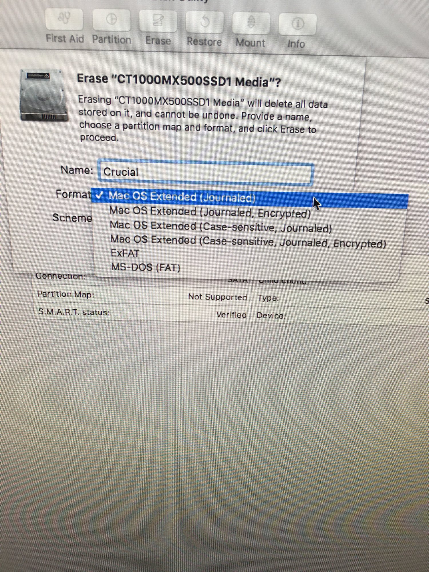

Journaled yes. Encypted not necessary unless you really want that.
GUID (not QUID).

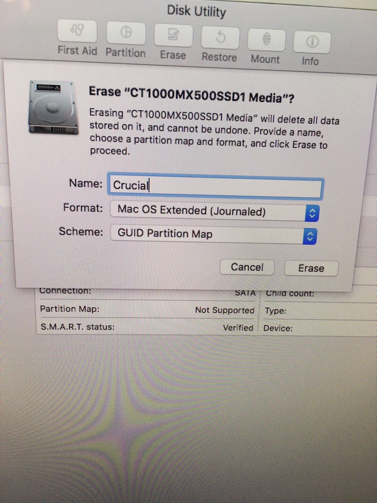

3) disk utility: choose ssd, name it, choose Mac OS Extended (journaled, encrypted), choose GUID

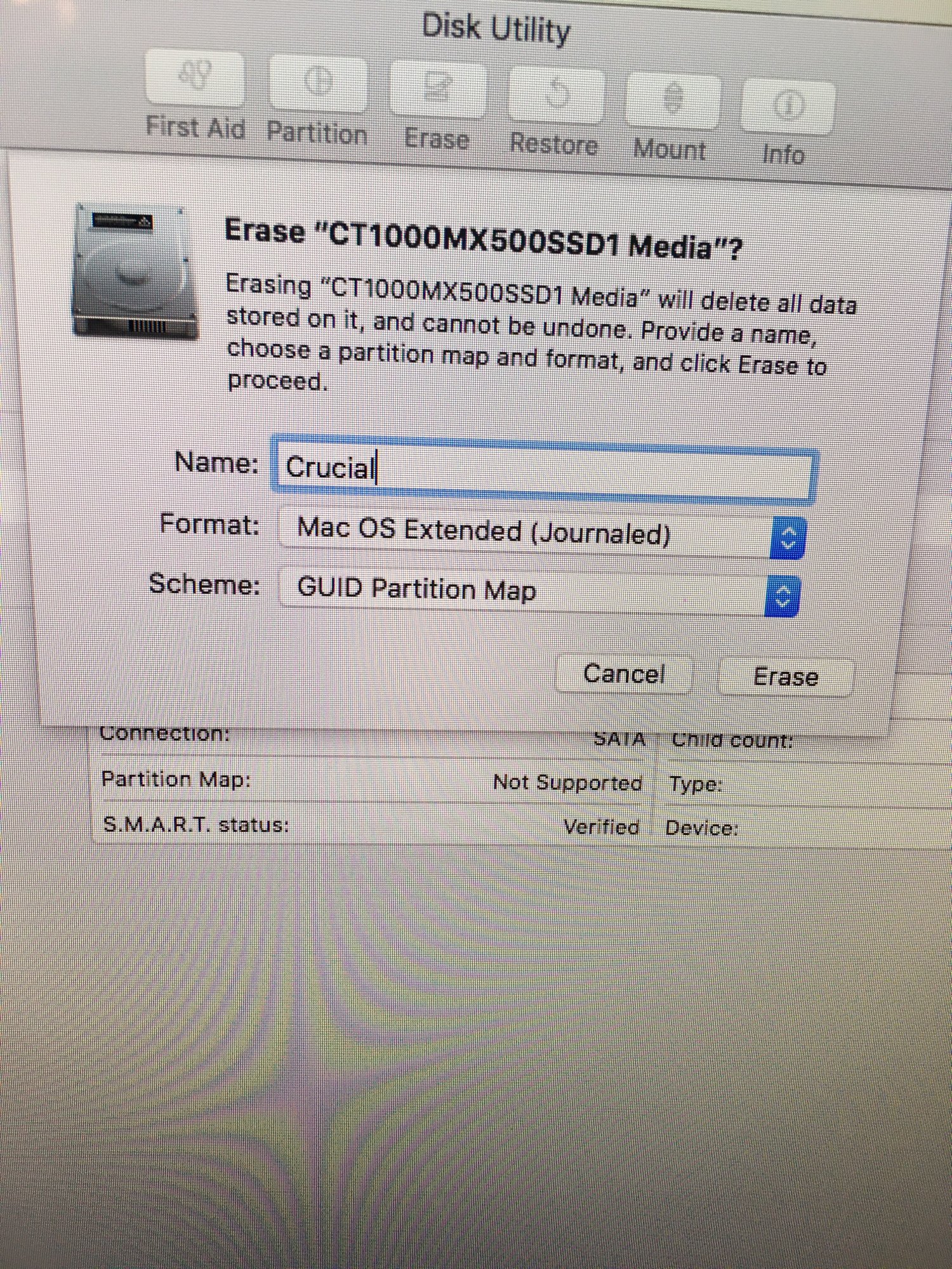

4) Open Disk Utility and format the iMac Crucial SSD as GUID, Mac OS Extended Journaled.

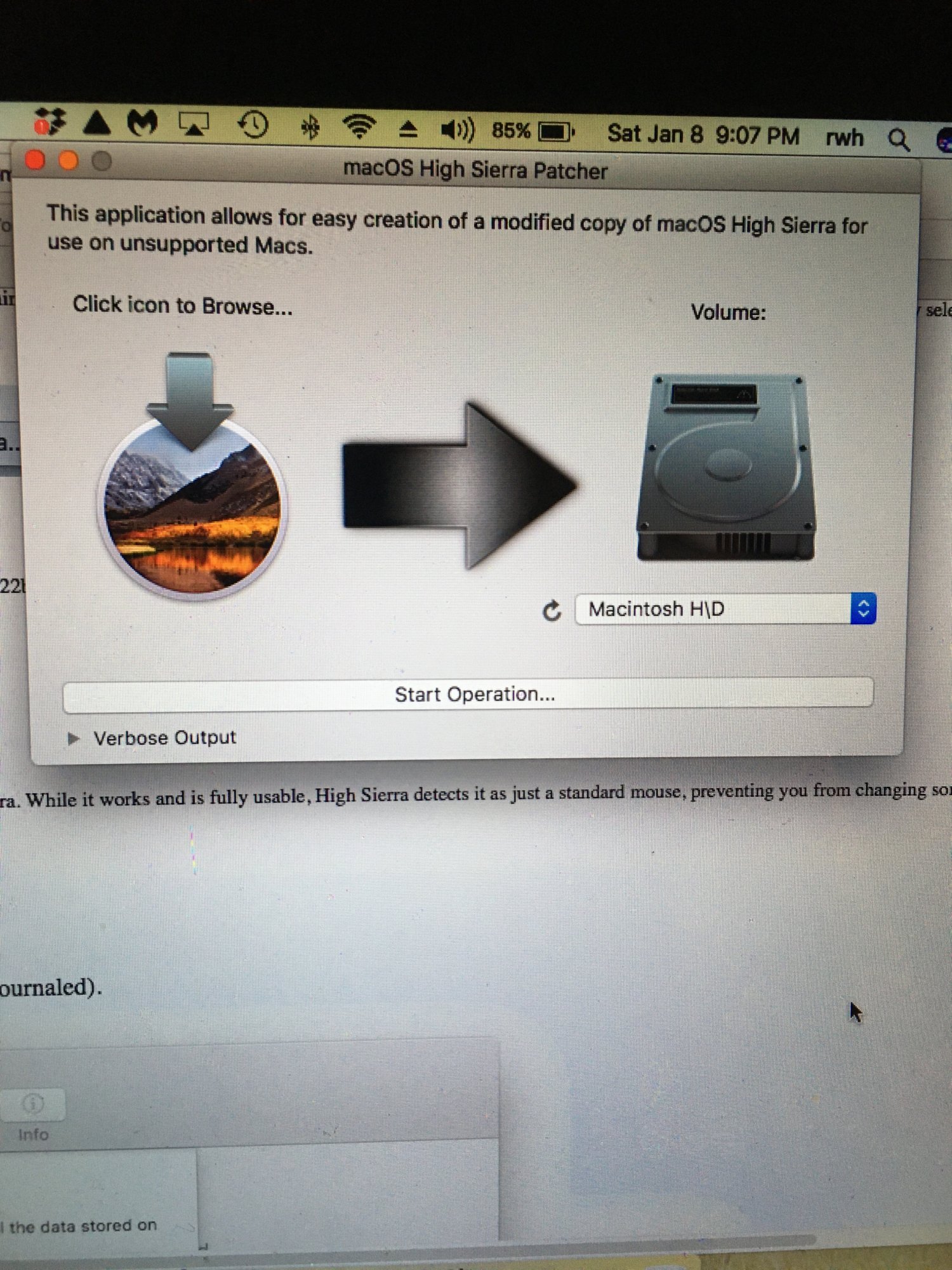

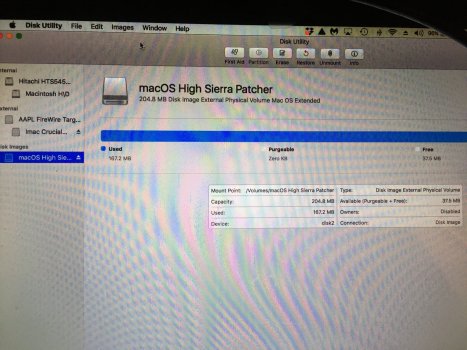

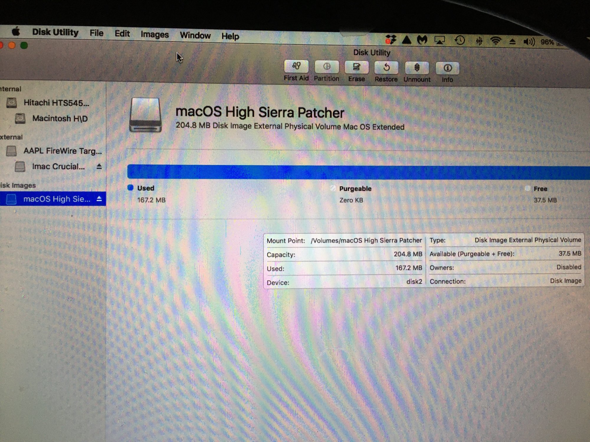

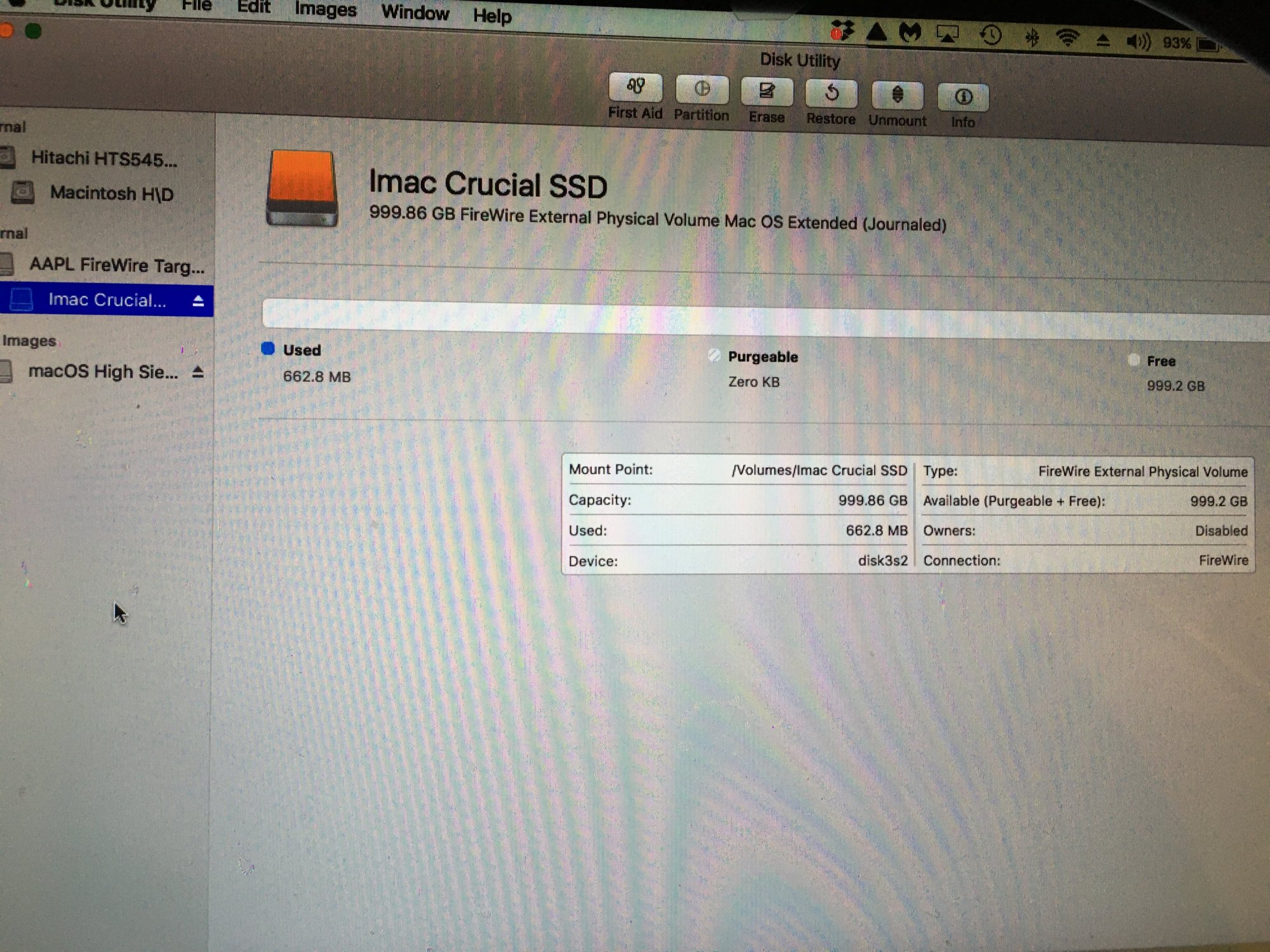

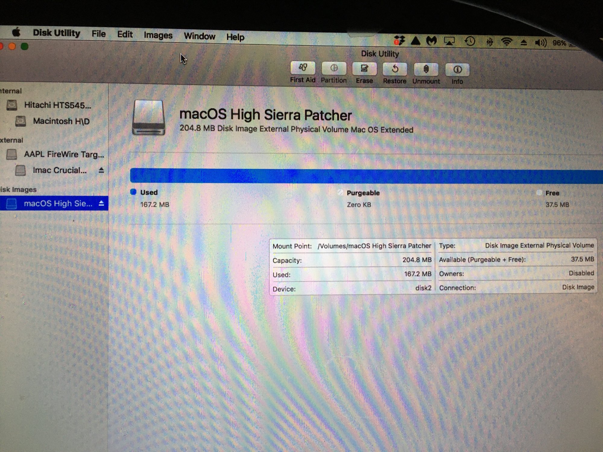

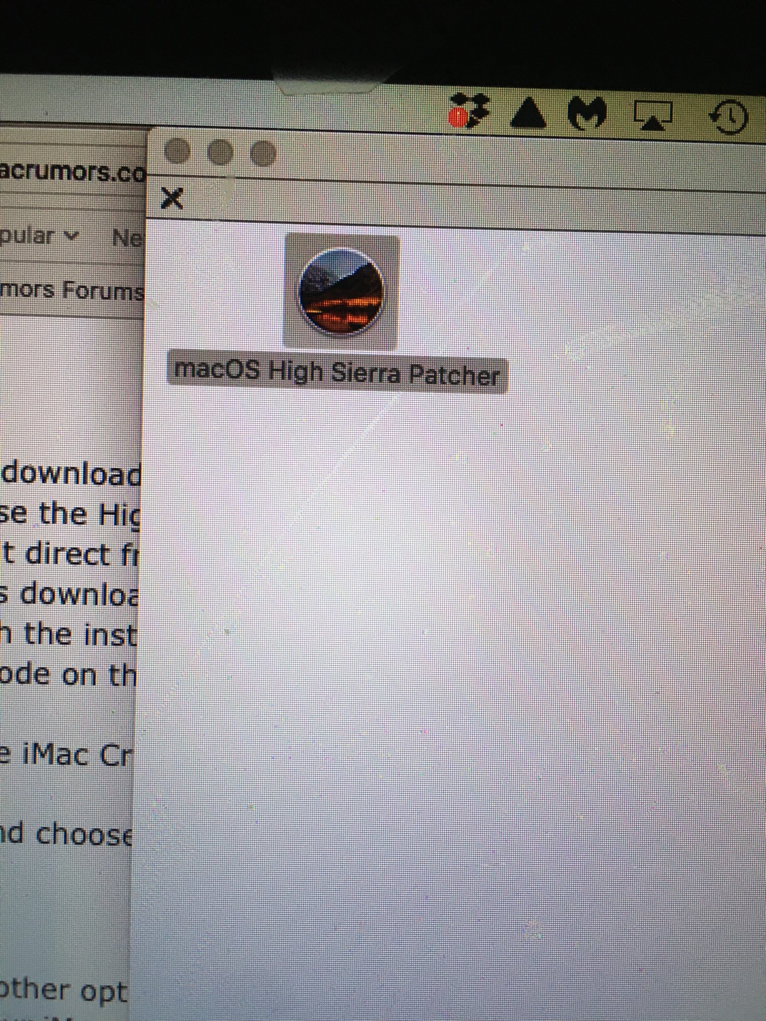

Decided to give this dosdude method a try. Is next step “start operation”? As you can see, the patcher right now is listed in the disk utility.

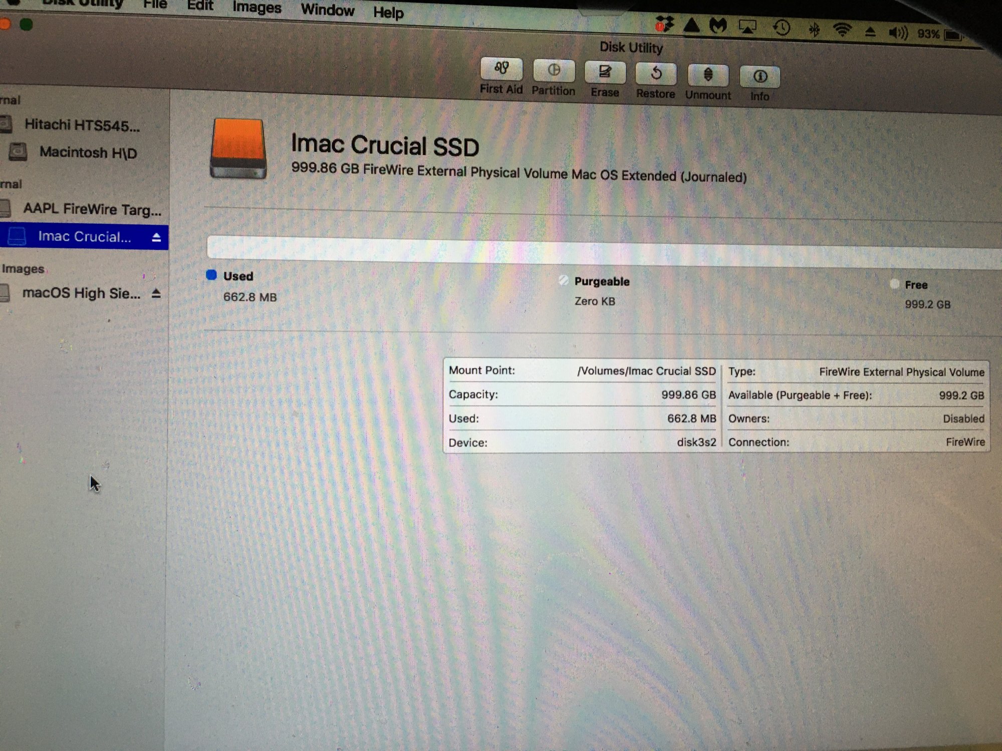

And, I named, journaled, guid, and erased the crucial ssd.

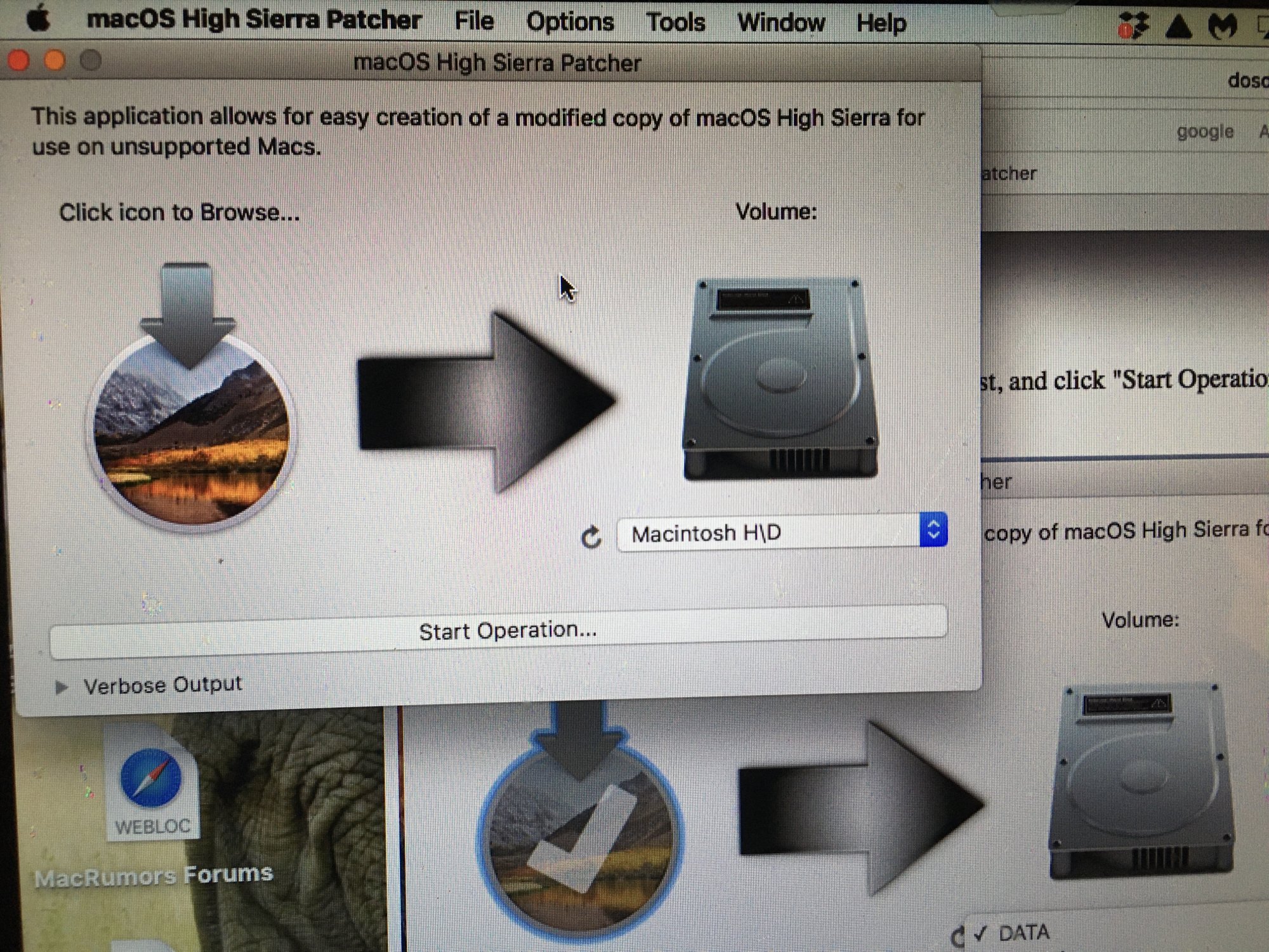

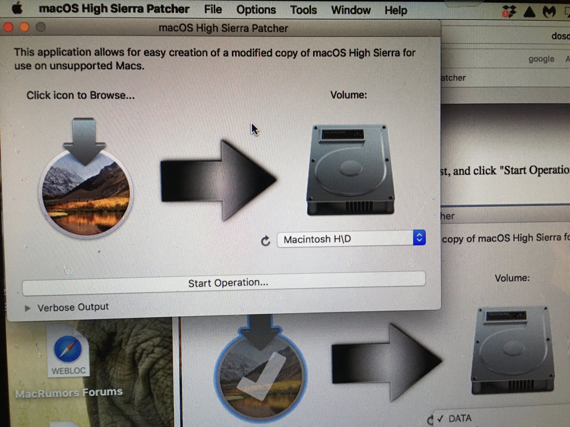

No! As mentioned you do NOT want to patch the downloaded installer. Once you have the downloaded the installer (with the built in command in the patcher application), you can just run the installer. Make sure you choose the iMac SSD as the target for the install.

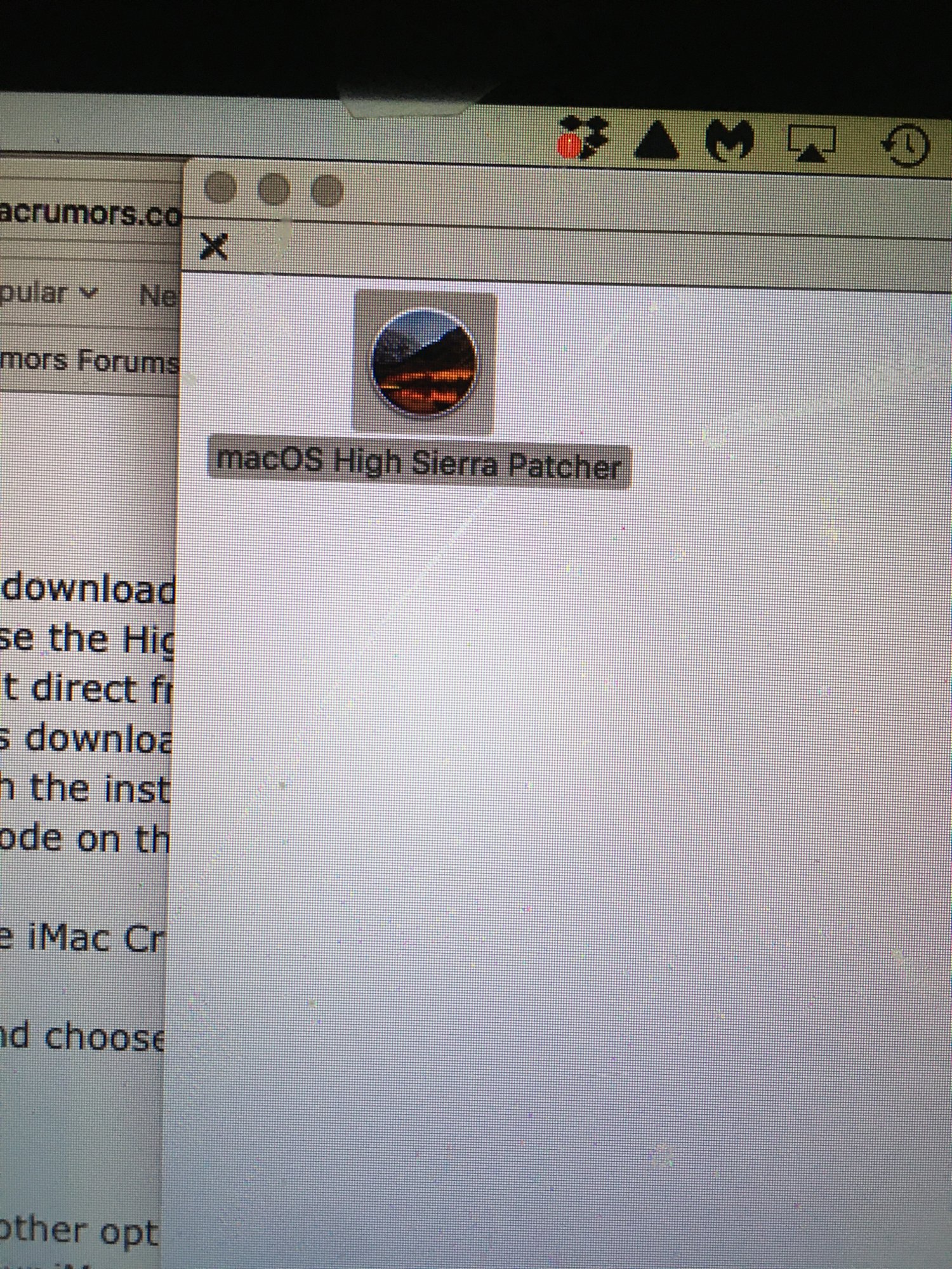

I did not press continue, after seeing the patcher in disk utility. However, the process has not been crystal clear so far.
I downloaded the patcher, as instructed. I click on it, this is what pops up.
