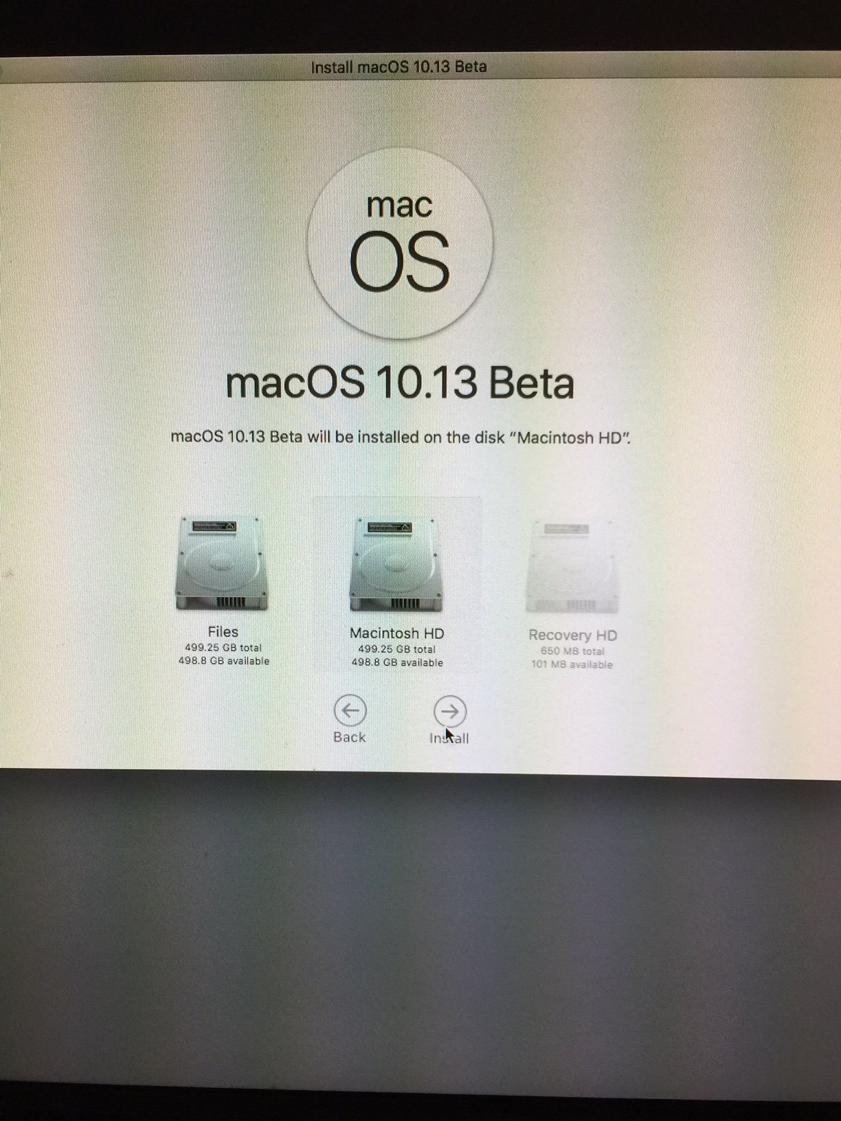

Oh good... so you can command-option-r boot then get the spinning globe then the recovery screen?
Was everything working fine before you started playing around with the beta?
Yes I can do the command-ctrl-r thing and it was running fine with the beta. I wanted to wipe it and do a clean setup. and then it all fell apart

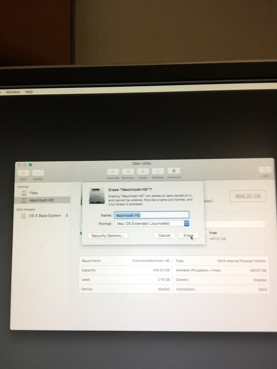

Once you get to the recovery screen in Internet recovery, can you use Disk Utility to erase the entire disk. You can do that by going to the erase tab and selecting the the drive itself at the top of the left column, then erase to Mac OS Extended (Journaled). After doing that, quit Disk Util then reinstall.
Trying that now

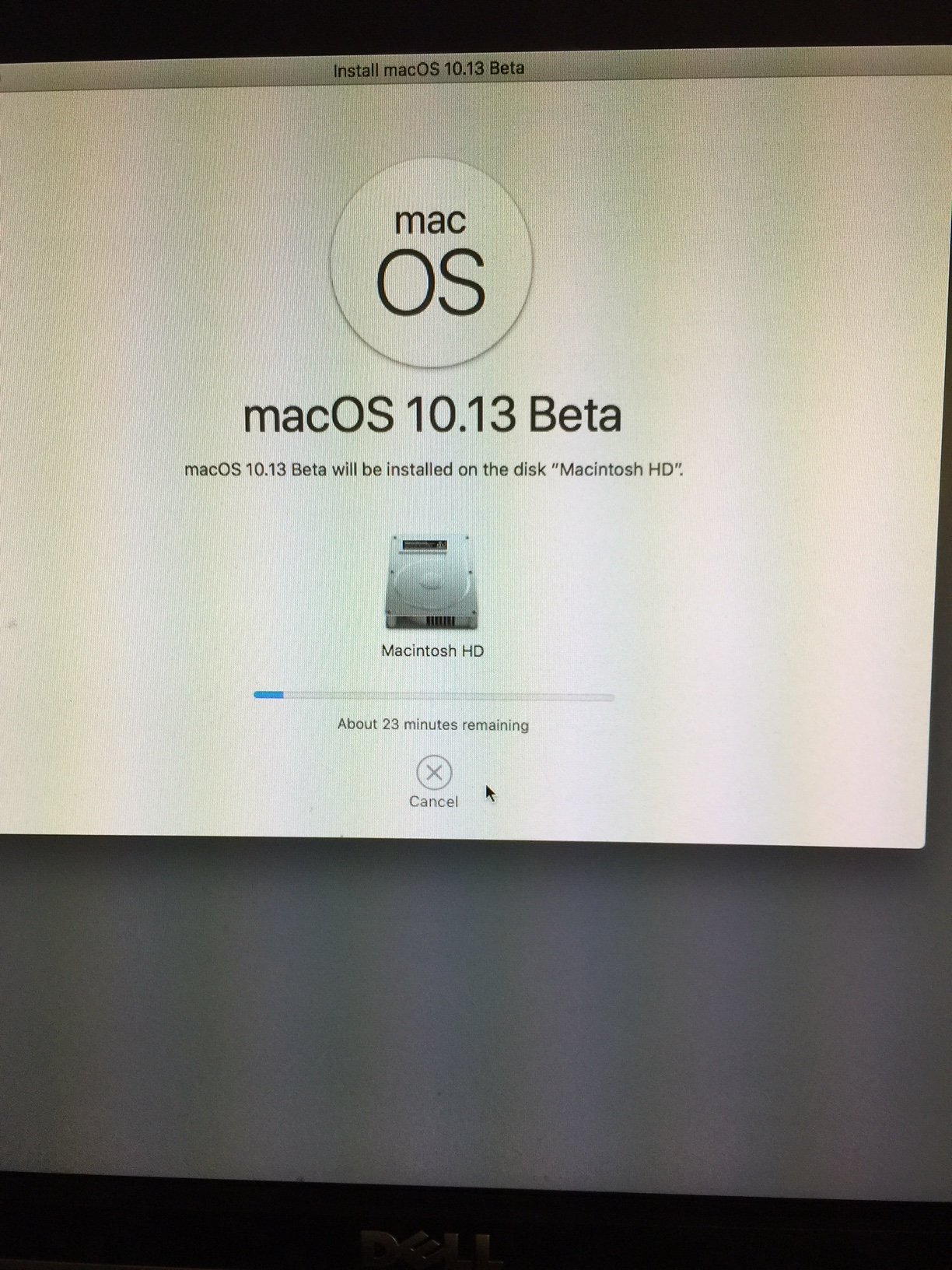

It has gone up to 26 minutes remaining and is just staying there.
Yeah... maybe give it another hour and see if it progresses though. What is your Internet download speed like?
The wireless is pretty quick. That device is not the only thing on it but I would think that after a couple of hours something should have happened. Are there other options if it just stalls out and never completes?
Other than the USB key, not really.
I came in today and it is still at 26 minutes remaining. What can I do to get past this?
Was everything working fine before you tried to install this beta? No problems at all?
You can follow this to make a Sierra USB installer, then option key boot to that and erase and install.
I had been running the Beta version of Sierra on it for a while and all was fine. I decided that I wanted to wipeit and do a clean install and that I when the trouble started. I will try the process you sent me
Installation now progressing. Thanks for the help
