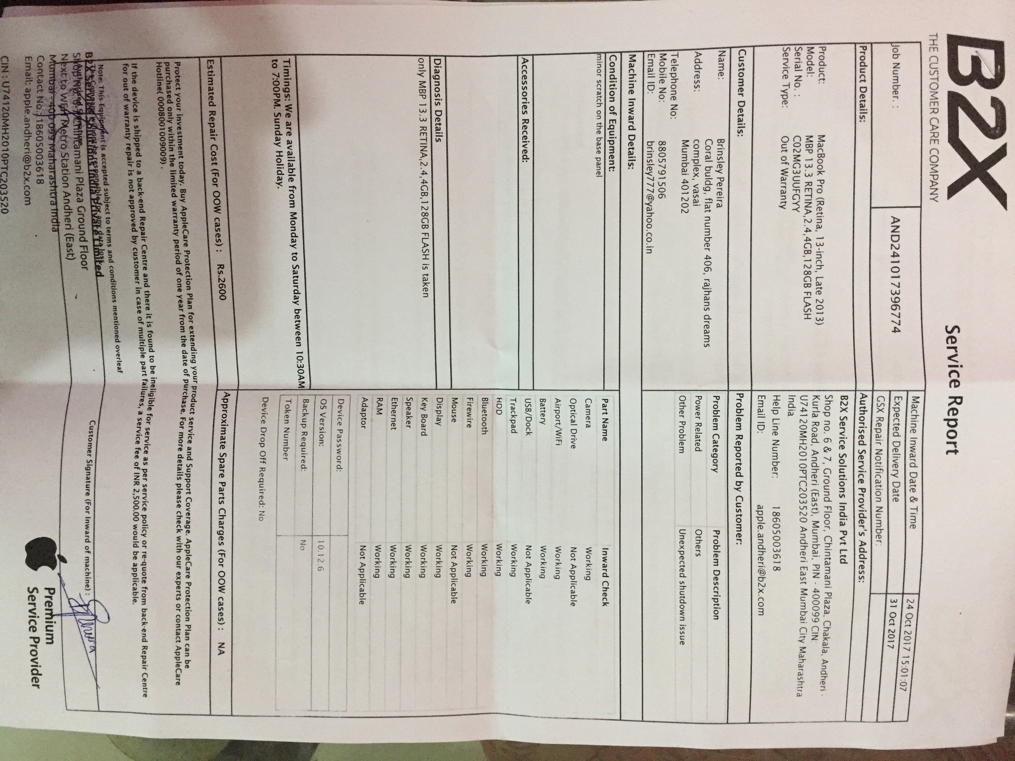

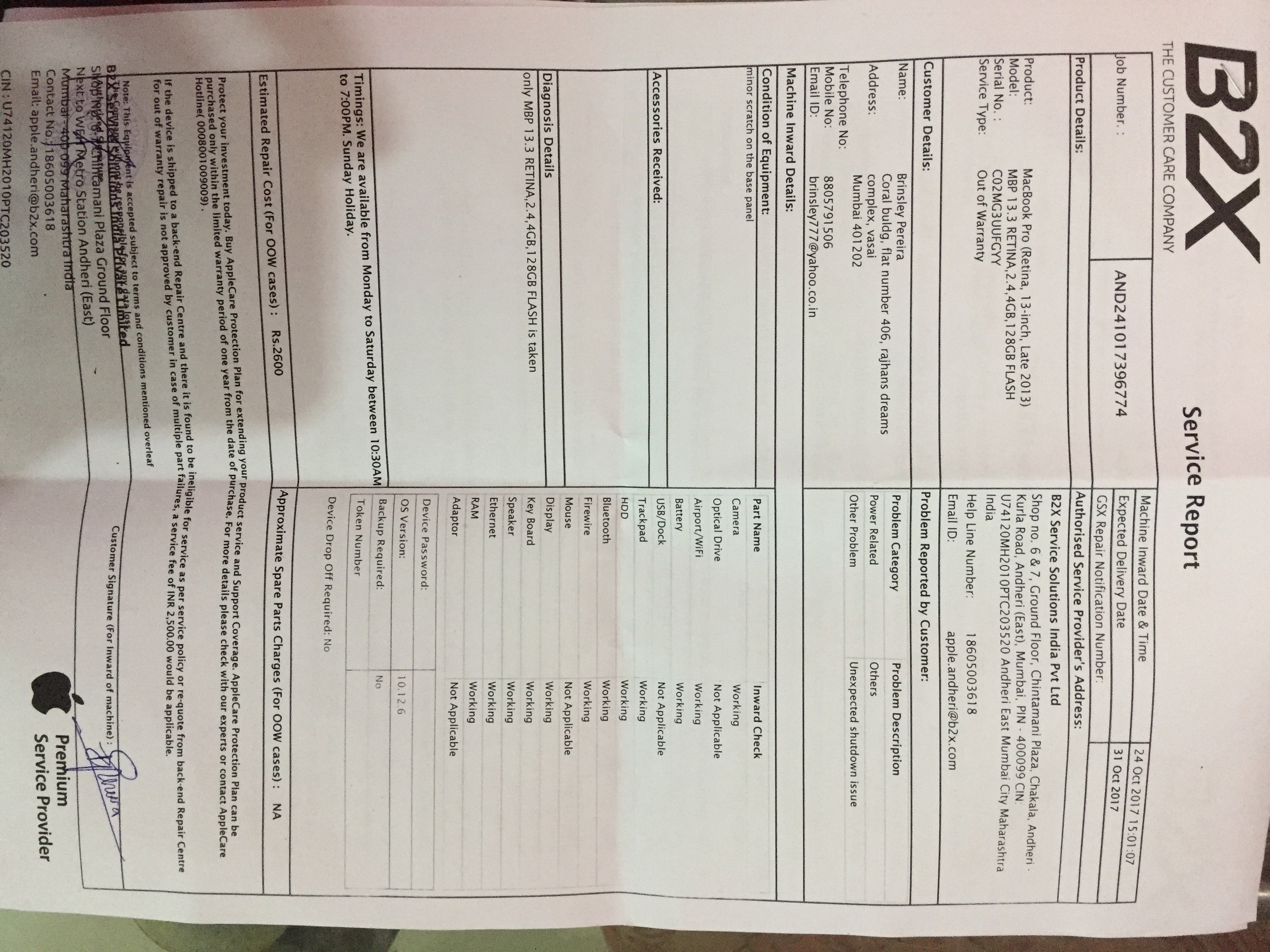

Hello guys, am facing the same problem as most of you are :-
MBP 13 inch (late 2013)
2.4 ghz Intel core i5
Now the problem am facing in detail :-
This actually started after I upgraded to Sierra 10.12.6, I remember upgrading it and then shutting the Mac down, after a few days I used it again but it was normal and if I remember exactly after 1 week of the upgrade when I turned it on to do some work it unexpectedly shut down, I initially thought it must be my finger which hit the shut down button and went on to turn it back on and bang again it shuts down on its own, since then it’s been 6 months the problem hasn’t left me alone.
Now an update after looking for help online and my location being Mumbai, India some ppl suggest the weather being too hot and dust problems so they advised me to install macs fan controls, so I did just that and it seemed to solve the problem about 2 weeks I use my Mac and it works perfectly fine until again a couple of days ago it starts to shut down, this time I went online and had a chat with apples engineeres , they asked me first turn on the Mac on safe mode and browse etc and see if it still happens and for about 15 mins nothing happens plus they asked me to open a lot of apps and use the mac at this Max limi the Mac was on my bed and I was multi tasking it, and my mac literally turned hot all over so then I thought the problem is resolved just then the engineer asked me to deleted a few files from Library etc and I did just that but all of this in safe mode. After all the hassle as I was about to say good bye to the engineer band the Mac shuts down again so this time the engineer asked me to take it to a Apple service center.
Now being in Mumbai that actually scared me to bits as customer service here in India sucks. However I took my Mac to a authorised Apple service provider just today and they asked me to leave it there for them to undertake various hardware and software checks.
And also they’ve charge me rupees 2600 just for doing these checks.
Now I am currently awaiting their response they said they will let me know within 2 days
Now coming to my main issue:-
Unlike others my Mac usage isn’t that much as I am a chef by profession I actually literally don’t use the Mac for long period of time, I always make sure I shut down the Mac once am done browsing etc. I usually would check my mails, browse or check photos dats it and on top of that I travel a lot and I don’t always carry my Mac along with me And so there have been instances where the Mac hasn’t been used for weeks literally but I always made sure the charge was over 50percent.
Now more then anything what I am worried about is that the Apple center here in Mumbai telling me that I have a crashed logic board etc which completely makes no sense because for something to breakdown there has to be usage. So is there a way I can actually check if what they claim is 100 percent true ? As here in India it’s always about money.
And also just the upgrade to Sierra and this happening I have a feeling it has got to do with something going on in the upgrade.

Ive also attached a receipt from the Apple service center here in Mumbai. I never knew they actually charge for checking what the problem is strange!!

@Brinsley: In my experience it is better to go to an Apple store directly. Service partner always charge you as soon as you are out of warranty. Your receipt suggests there are also no hardware issues. So it might be the same issue we all have here. Can you also solve your problem using the python script?

Hi there l, well I did visit the Apple store and they said we only sell products and asked me to contact a apple service provider and about the phyton script well I haven’t tried that yet, and at the moment my Mac is with the service center
About the service center not mentioning anything about hardware well all she did was put my Mac in a slip-on bag with a Apple logo on it and dats it, she didn’t even check for any hardware issues, all she did is check for any physical damage and all she found was a minor scratch. I will keep you guys posted about any update from the service station.
However I feel even I have the same problem as you all on here and am afraid I won’t be able to use my Mac every again after spending that amount of money wow apple needs som explaining to do. I’ve used dell laptops before and this is the first time I switched to mac.
