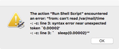

I'm trying to run that Python script, but seem to be something wrong. I've downloaded Python 3.6.3 and followed the instructions in the pdf I got from your dropbox link (thanks, by the way!). When I restart my MBP, the attached error window pops up. Any suggestions what I might be doing wrong?
try to open python (you can use python in terminal):

Thanks for the Python script and all the help everyone. Managed to get it to work by changing the Shell: to the Python script... hope that's right? Is there a way to close the Shell window popup automatically on startup?
