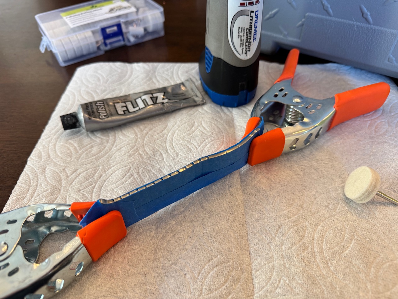

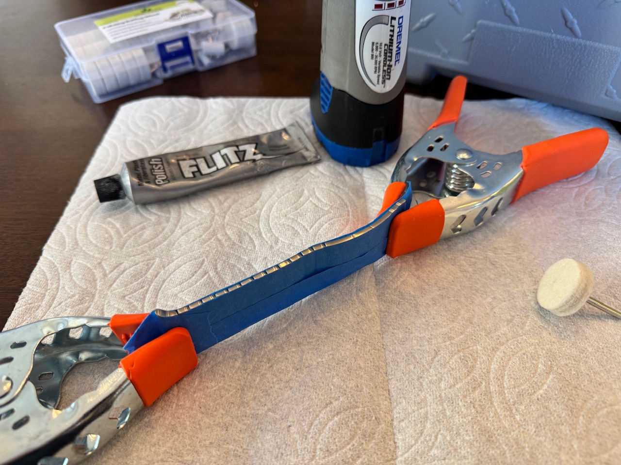

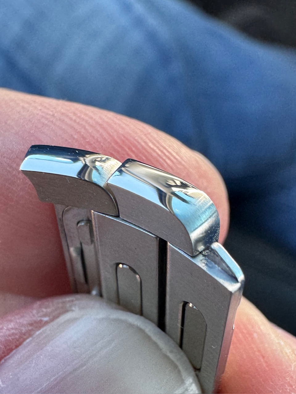

Might I ask how you polished it? I asked a local jeweler today and he said that it’s a rather time consuming thing to do and it’d cost around $150 (roughly converted).
Yeah, I wouldn‘t spend $150 lol.
I first attached all of my spare links back onto the bracelet, then separated half of the links and set them aside before masking the remaining half of the bracelet with painters tape. I used two clamps to hold the exposed edge of the bracelet upright and used Flitz polish with my Dremel and a polishing wheel. I repeated this process three more times for the rest of the bracelet.
Having never done this before on the link bracelet, I took a lot of meticulous steps and everything took about 90 minutes. I wanted to ensure I didn't screw anything up so I took my time.

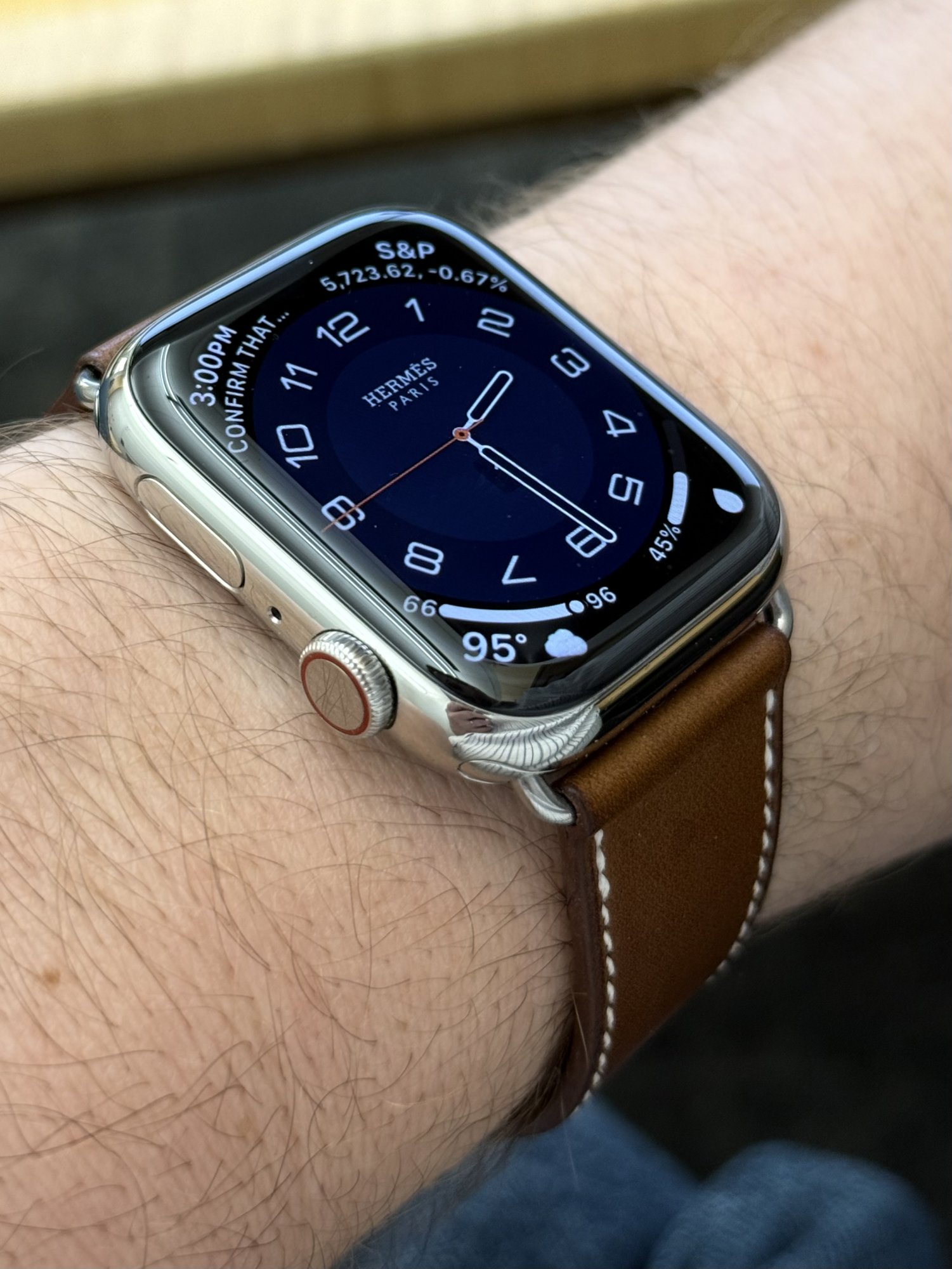

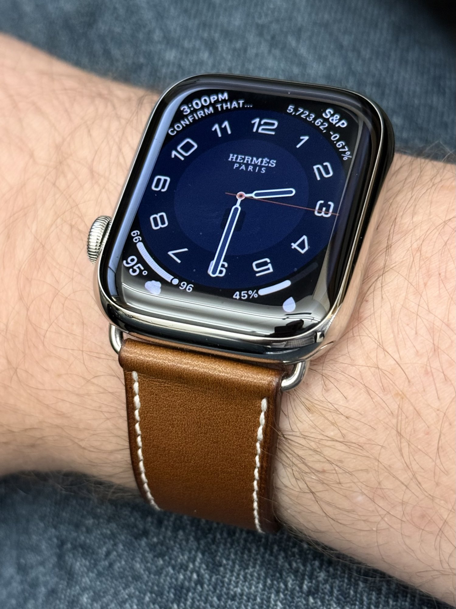

The Fauve barénia is still my favorite band to pair with the watch. Mine has the attelage lugs, but I swapped the tang-style buckle with the deployment clasp from my ébene band, which I don't wear as often. I love pairing it with the indigo Circulaire face. It's my usual go-to face for the weekend.
Yep Fauve paired with the indigo Circulaire face is hands down my favorite look for the watch. I’m wearing that combination right now actually. I’ve had my Fauve strap since the S6 and it has aged beautifully.

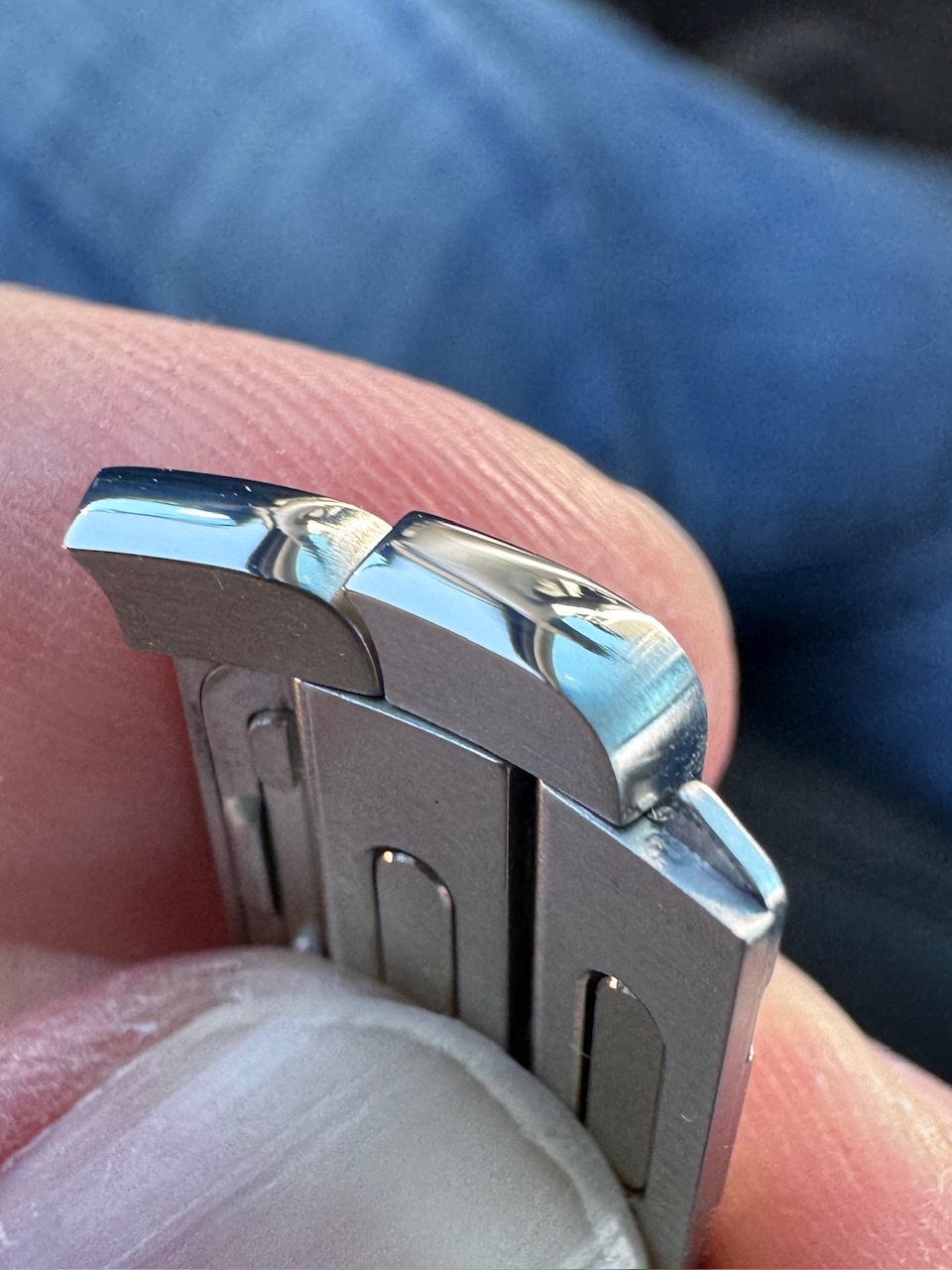

I see you masked off the brushed edge, which was something I'd considered. Did you at all find that polishing the edges rounded the hard edges of the bracelet? I'm also wondering how the edges of the links appear as they start to curve inward - still brushed, or did the polishing make it all the way down?
On closer inspection, the polish didn't make it down the curve. I suppose I could separate the links individually and polish them all the way down, but when zoomed out they look consistent and are not noticeable.
The edges are kind of an optical illusion, at least to me. They *appear* rounded and softer, but when you lay the bracelet flat and look top down, the edges remain just as sharp as before.
The way I did it (thin discs) worked surprisingly well for this as it got into the crevasses between links. I also didn’t tape off the front and back, which may have helped.
Because of that, I made sure the direction of the spin was back to front so if it did start polishing the back, it wouldn’t matter as it couldn’t be seen while worn. Thankfully it didn’t and everything came out very clean!
However, this is most likely luck and a steady hand speaking.
