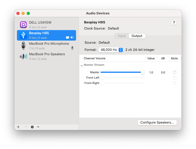

I don't know that I'm making a specific argument, I'm more just curious about how these devices are built and why they have the limitations they do. Thanks for bearing with me and instructing me-- I'm learning as I work through this. So, you were right in the sense that, even if you got a digital usb > lightning connection the Mac would see that the DAC of the APM is only capable of 256kbps and would downsample that lossless audio accordingly (via Core Audio).
I guess I wouldn't have guessed that the DAC in the APM would have that limitation. I do see others saying this is the case, however. I wonder if it has to do (aside from the limitations of bluetooth) with the sheer amount of calculations the H1's DSP is performing and how much data it can keep up with. Again this is just me wondering out loud because I don't know much about the math that goes into what's happening on the APM. If that were the case... it's possible we would later see an H2 chip or something that could handle a higher bitrate.
In another thread, someone said the HomePod had the same DAC limitation, but from what I can find from iFixit's teardown, the DAC in the HomePod (original) is rated for 24 bit 192kHz (again, I'm a relative novice with this info, this is just what I'm seeing on the manufacturer's product page). There probably is some practical explanation for why its limited, I'm sure.
For the H95, it is telling me that my max resolution is 24-bit, 48kHz.

However, I still wonder if the DSP might be a bottleneck on these as well. I know earlier Beoplay bluetooth headphones were designed differently and could be driven passively, as was your experience. I also recall reading that the sound signature on some of these headphones (not just Beo, but other brands as well like B&W, etc) would vary quite a bit between when ANC was in use and when it was not-- or maybe it was between BT+ANC and when driven passively.
My best guess is that, by only having one path to the drivers ( DSP > DAC > drivers), it keeps the sonic performance consistent (and provides noise cancellation regardless of input), even if limited by the electronics in the headphones that standard analog headphones do not have. I could be wrong, however.
Anyways. I've been enjoying the APM and the H95 for what they are purpose-built to be-- wireless headphones. I wouldn't mind if there was some headroom for SQ, but I'm not really hurting for it. They've got me listening to music a lot more than I had been in many years, so I can't really complain.

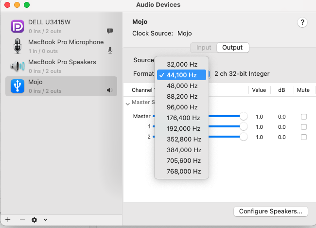

(For fun, I dusted off my Chord Mojo and plugged it in to see what Audio MIDI setup told me about that device capabilities ? This is kind of sad-- I honestly do not have any headphones that are worthy of this DAC.)
