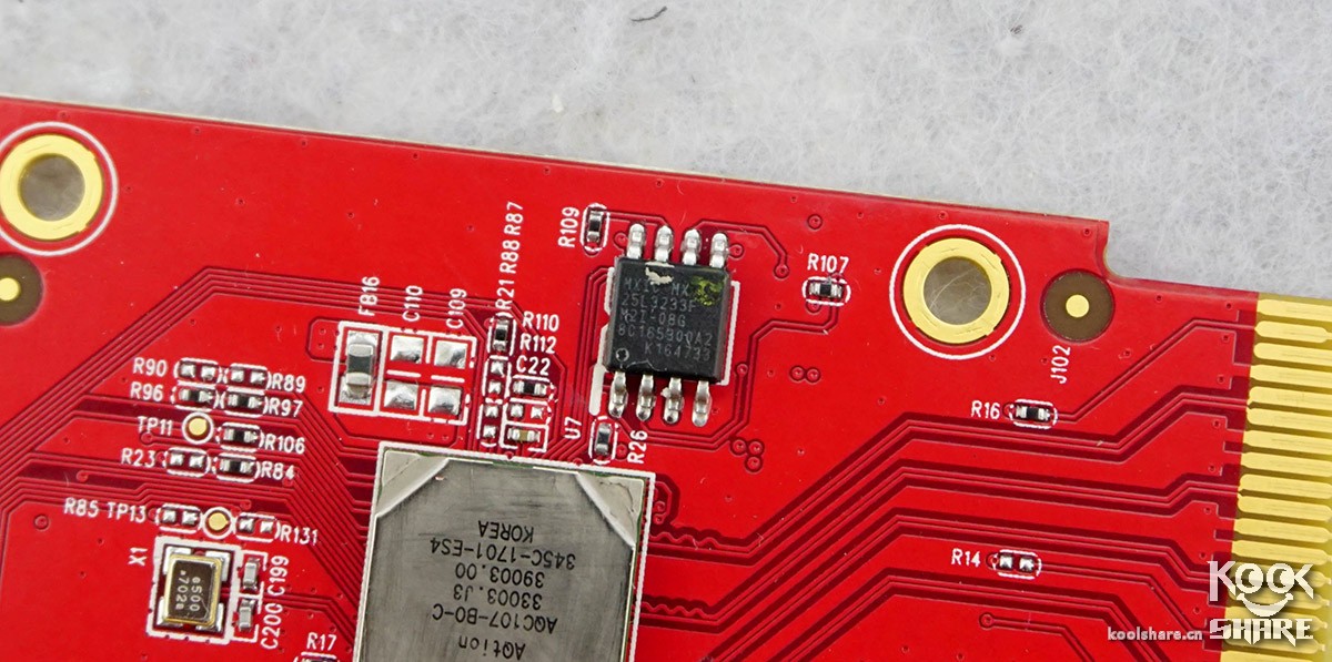

Kris, you could try to short pins 4+5 of the EEPROM while powering on the Mac Pro. this will prevent the system from reading out the ROM of the network card. back in the time when I was flashing EFI ROMs to PC graphics cards, this allowed me to boot the Mac Pro even if it played dead because I really f***ed up the ROM of the card...

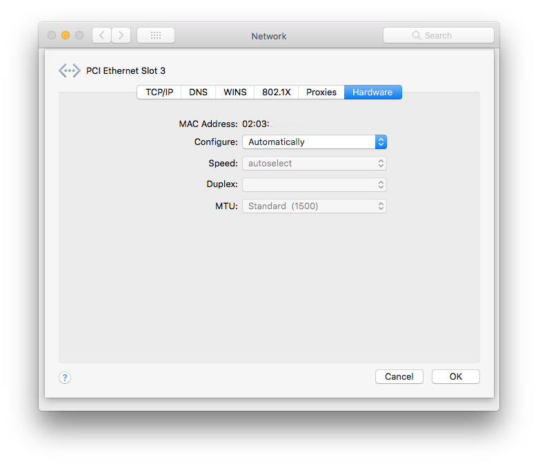

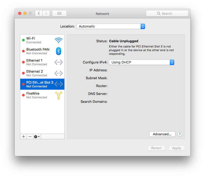

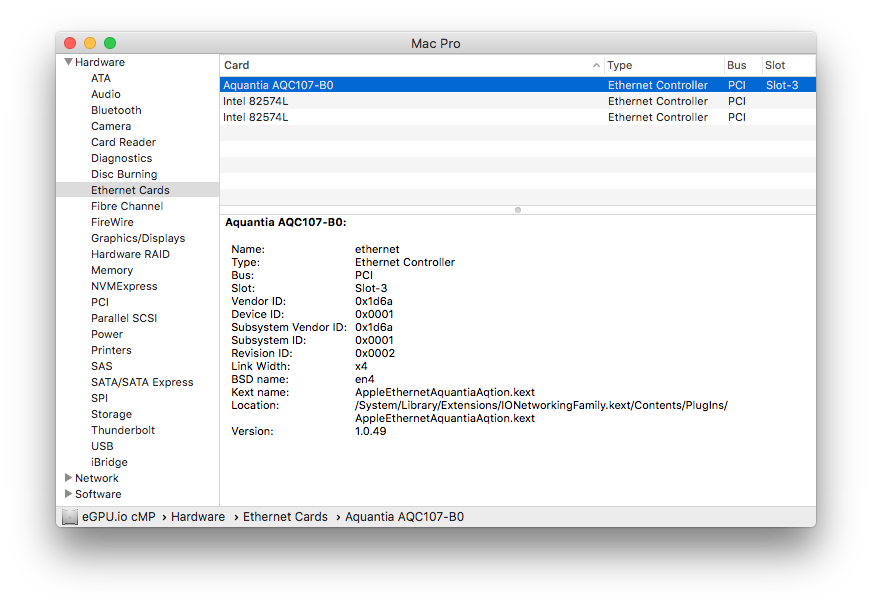

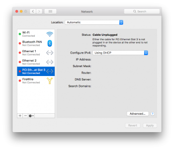

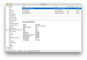

You're a legend dude. I located the EEPROM [MX25L3233F] and confirmed pin 4 & 5 orientation prior to soldering. A small piece of thin wire did the job. As far as software, I mounted the NIC in a Thunderbolt enclosure first to install 10.13.3 combo update to make sure the firmware gets flashed. Here's what I'm seeing in a Mac Pro tower [ASUS XG-C100C (AQC107)].
Screen Shot 2018-01-26 at 10.53.56 PM.png Screen Shot 2018-01-26 at 10.54.05 PM.png
Screen Shot 2018-01-26 at 10.54.58 PM.png Screen Shot 2018-01-26 at 10.55.20 PM.png
Great job! Did you leave the wire on after booting? Does that mean one could just remove the EEPROM chip to make the card work in a Mac Pro tower? Were you successful in establishing an Ethernet link?

yes, removing the EEPROM chip altogether should give you the same result. shorting these pins completely blocks the ROM from being read out.
The soldered wire shorting out pin 4 & 5 stays put during operation. I wanted to test first prior to doing more evasive operation on the NIC. Next step is to remove the EEPROM completely per @mikeboss' confirmation.

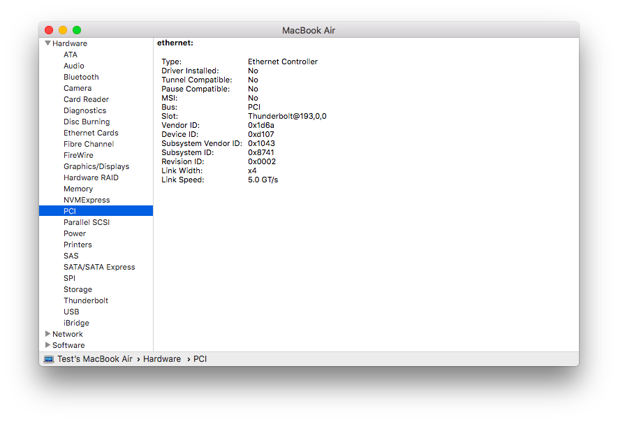

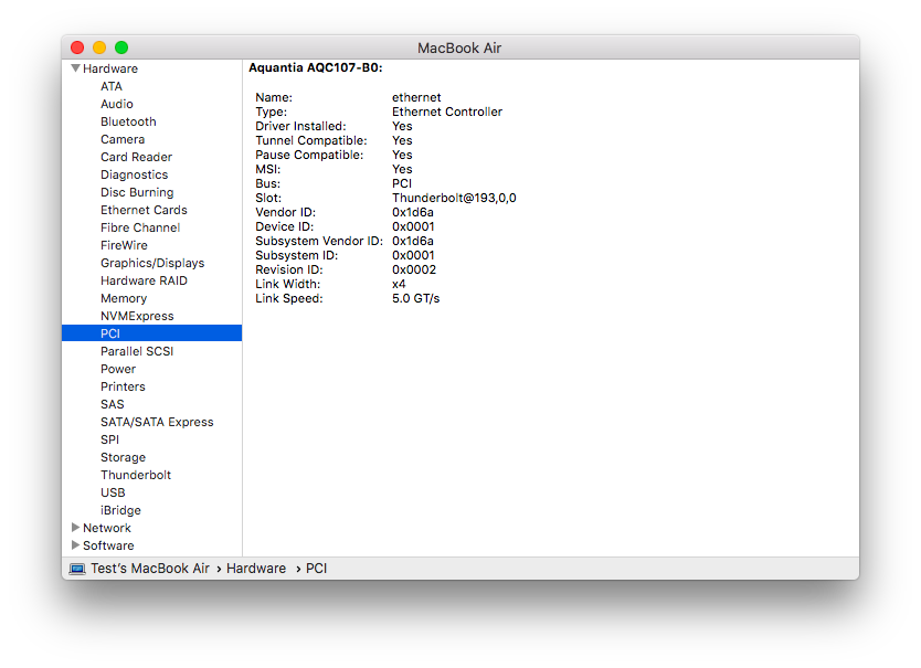

I took a couple of screen captures to show the difference in macOS' detection of this card (10.13 on the left, 10.13.3 on the right):
10-13-thunderbolt-2-pcie-10g-nic.png 10-13-3-combo-update-thunderbolt-2-pcie-10g-nic.png
In macOS 10.13.3, there's a new kernel extension called AppleEthernetAquantiaAqtionFirmware.kext in /System/Library/Extensions/IONetworkingFamily.kext/Contents/PlugIns/.
That might mean that AQC107 cards installed into a Mac running 10.13.3 will be upgraded automatically (not just during the 10.13.3 upgrade).
theitsage, were you able to give this a shot yet? Any chance of a photo of the chip before and after? Does the red heatsink on the ASUS card need to be removed first or is it located on the back?
