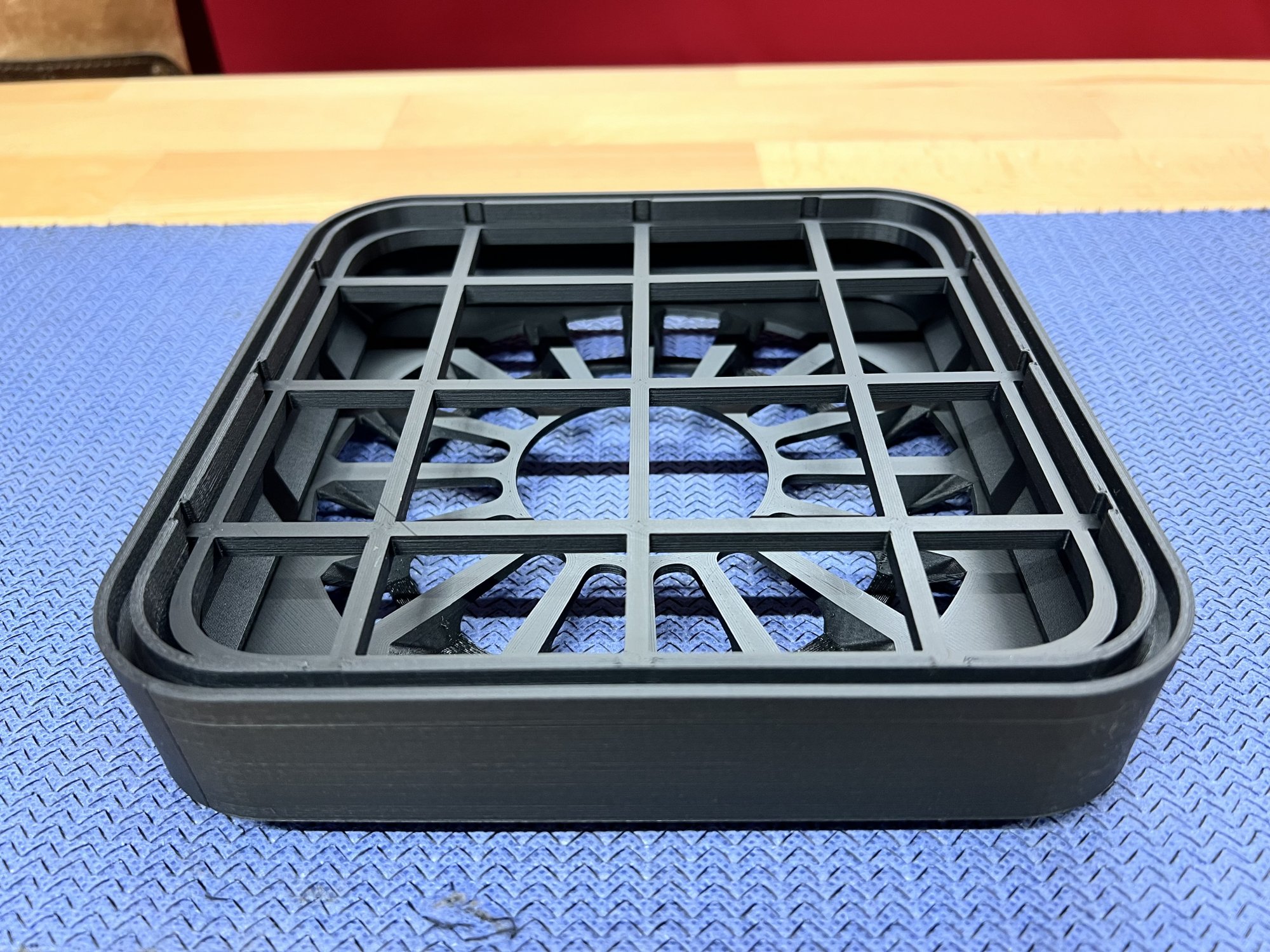

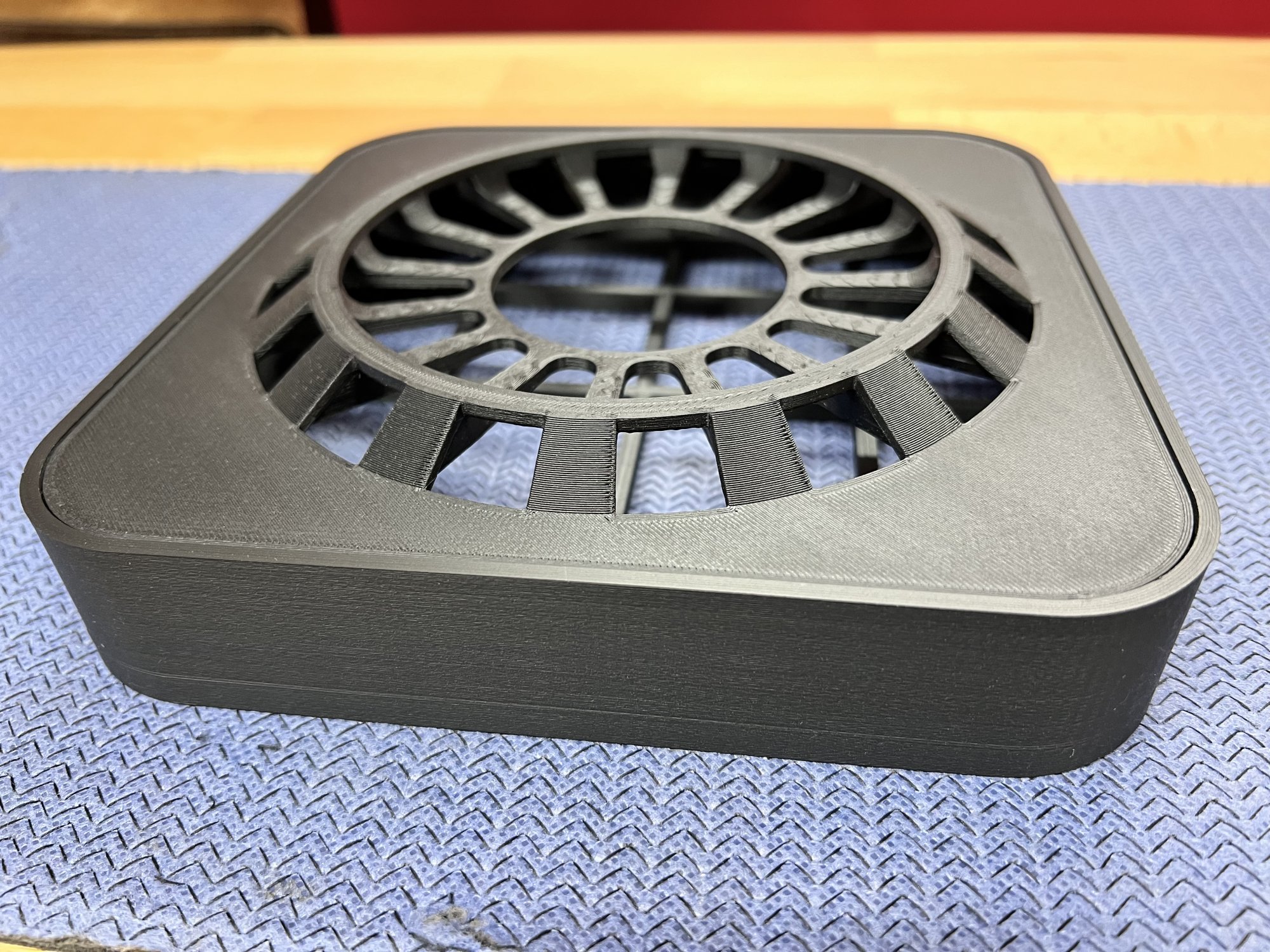

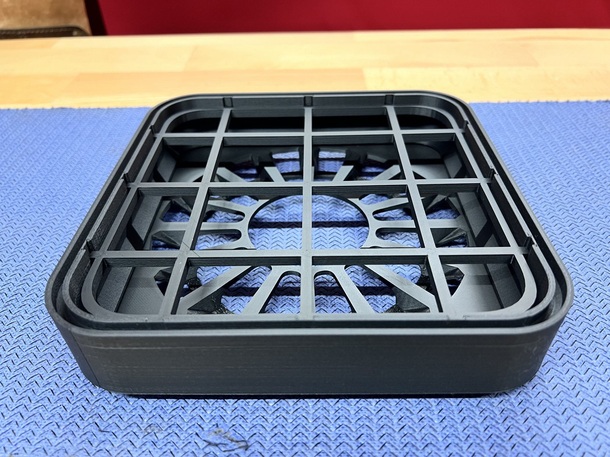

Yes. I asked the printer first for his recommendation and he definitely favored PLA. This item is the first thing I've ever had printed 3D and am hugely impressed with it.
I was concerned with the Studio getting hot and PLA possibly warping.
Thanks for bringing this up. This is my first experience with buying 3D printing, so I researched that.
Warping might occur about 50°C/122°F. Given that heat rises and there is a constant airflow upward I doubt that would happen. I definitely would not leave the item in a closed car on a hot day in the sun though.
Excess humidity can cause PLA warping. Keeping a consistent room environment is important.
Another issue is UV exposure which will change the material color over time and also cause it to become brittle. Some recommend coating the exterior with a UV-resistant varnish.

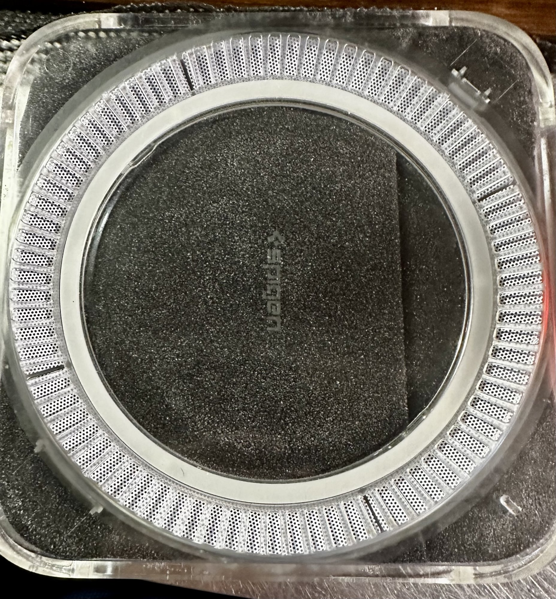

Let me point out that dust particles common in the home range in size from 1 to 100 microns.
The filter holes in the Spigen stand are 0.77 mm or 770 microns. Dust is passing through the Spigen right into the Mac Studio.
Reactions: phrehdd and Wheel_D
I am almost two years in on my Mac Studio, and yes, I have had it sitting on a Spigen stand the last year.
The Mac Studio is located on a desk in my office in the basement. Basement is unfinished, with concrete floors and walls and I only vacuum about once a fortnight. The office is a busy one with a Mac Studio, 2 Mac Pros, laptops, monitors, TB docking stations, NASes, printer, switch, and a collection of external SSDs and HDDs, and lots of traffic… We have a dog, and he leaves his “imprint” on the environment as well.
I clean the Spigen filter about once a quarter and only ever see a bit of dust accumulation, and when I vacuum the Mac Studio, very little dust seems to be inside the unit.

A friend printed the Mac Studio filter casing for me. I ordered some filters and a neoprene strip for the seal. As soon as they come this week I'll set it up.
