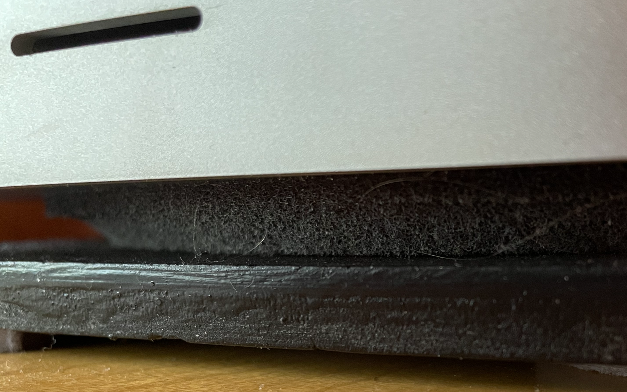

I cleaned the DustEnd filtering material on the Spigen stand. I trimmed it better this time and fitted it better. It is self adhesive so it easily attaches to the underside of the Spigen stand. I notice my operating temperatures are down by about 5° C., and is running at about 46° C. It was never more than 55° C before. I am happy with the Spigen again. By itself it is not really that good but with with the self adhesive DustEnd installed carefully underneath it is doing the job quite well. I am waiting for something with a better filter such as the 3D printed one up thread but for now I am good to go.

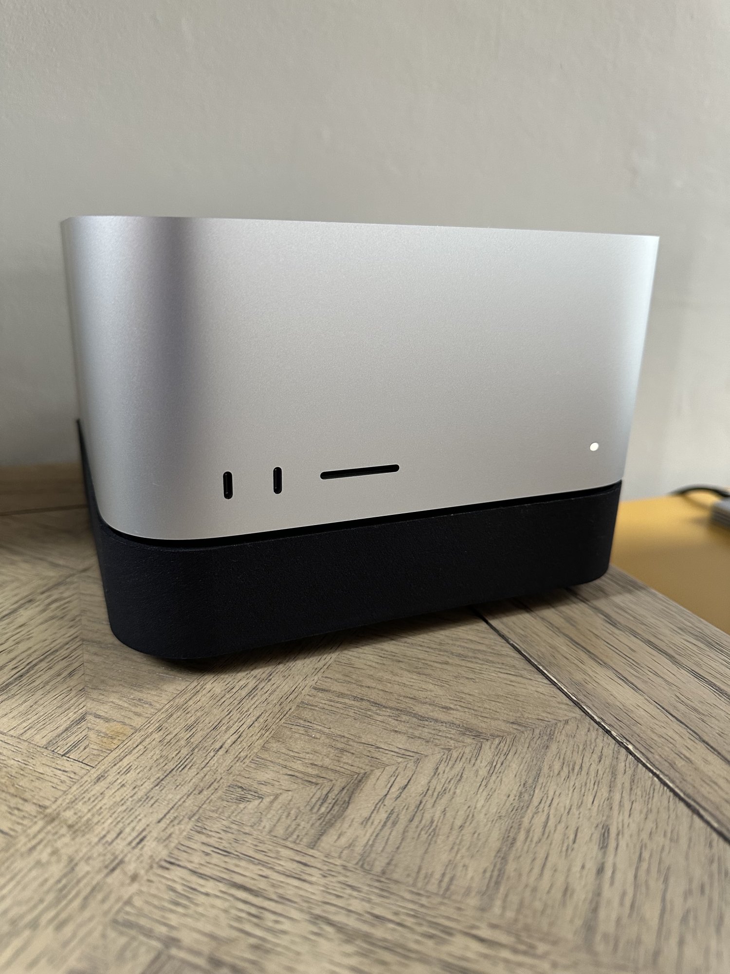

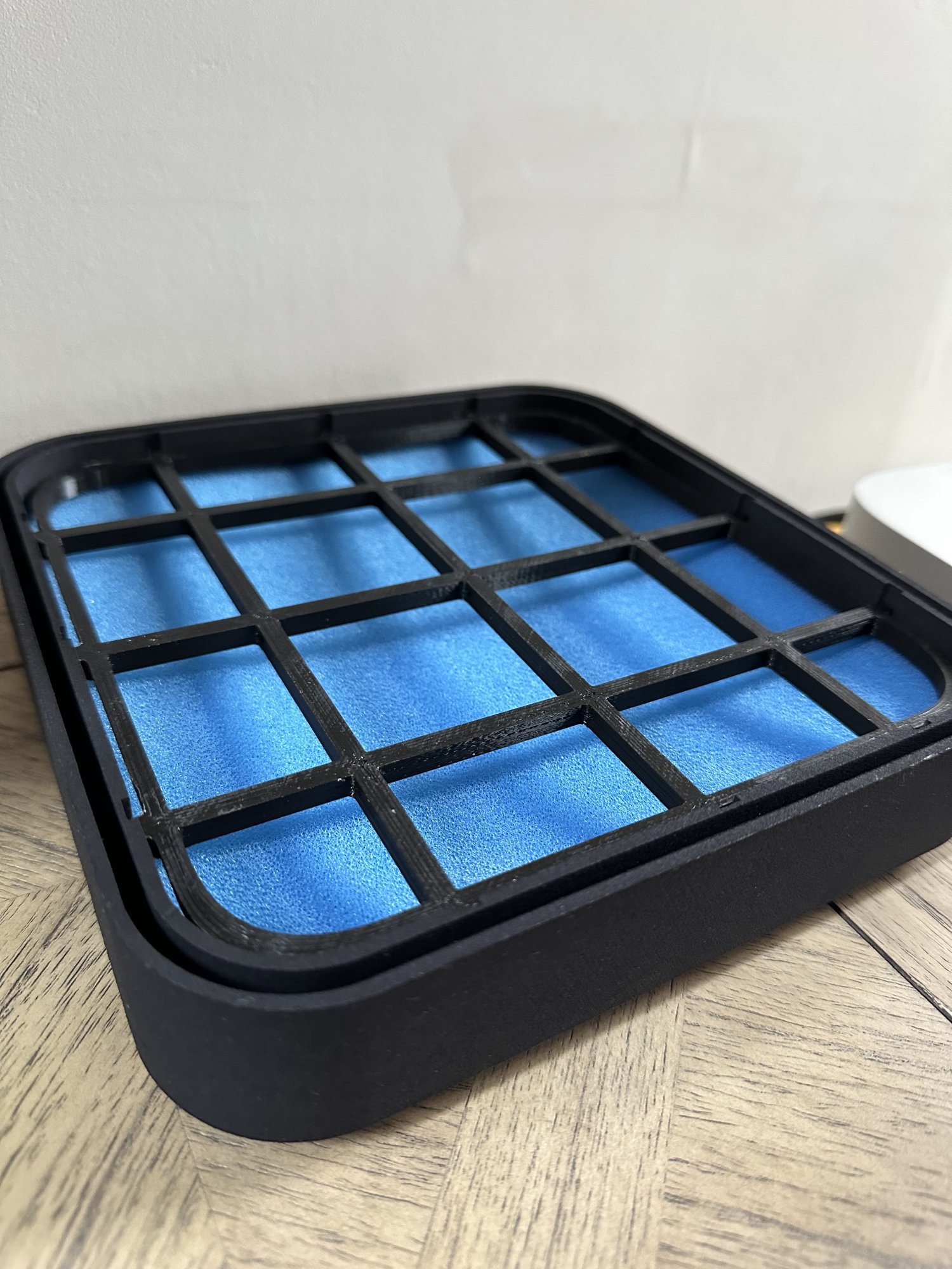

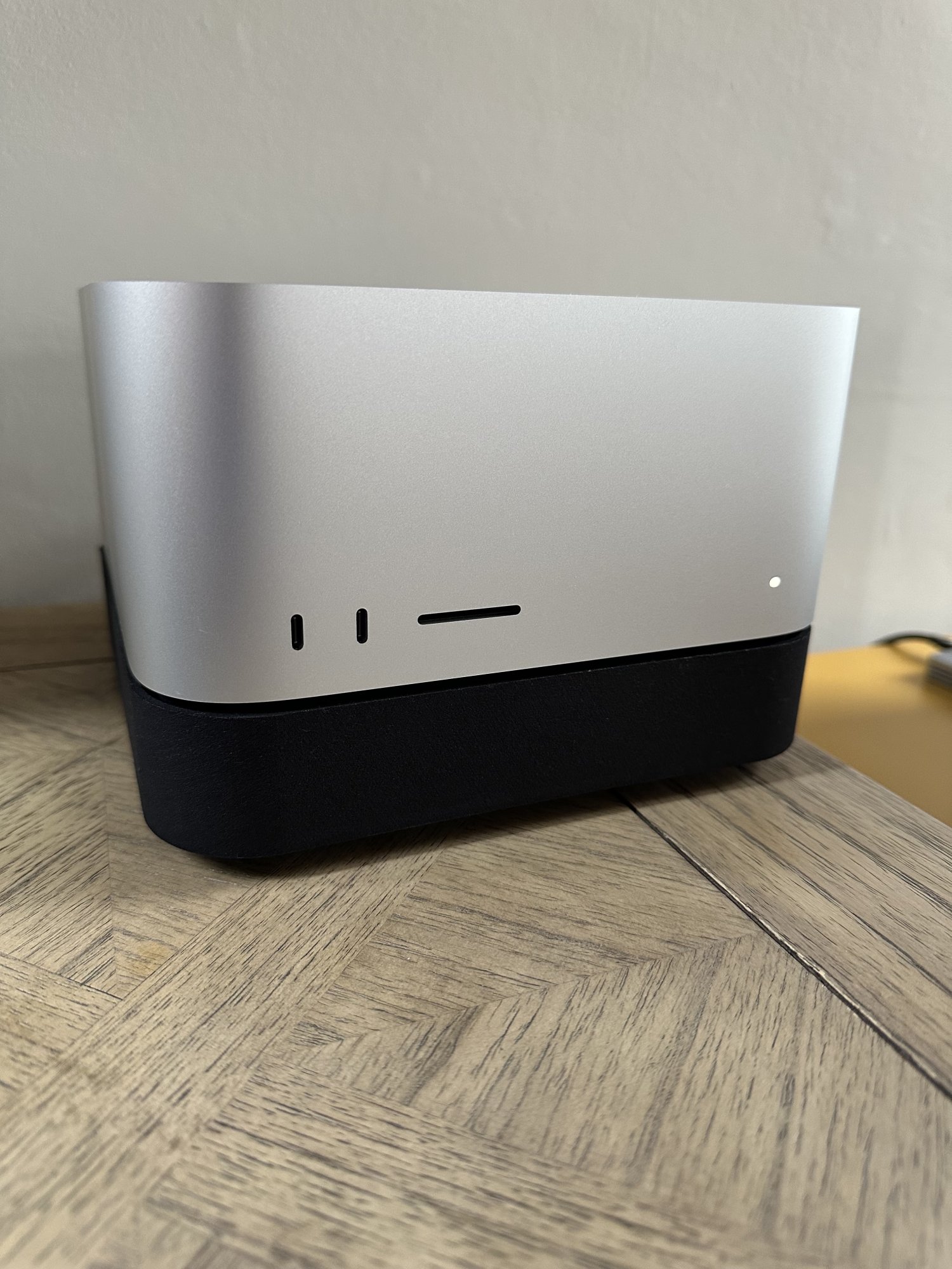

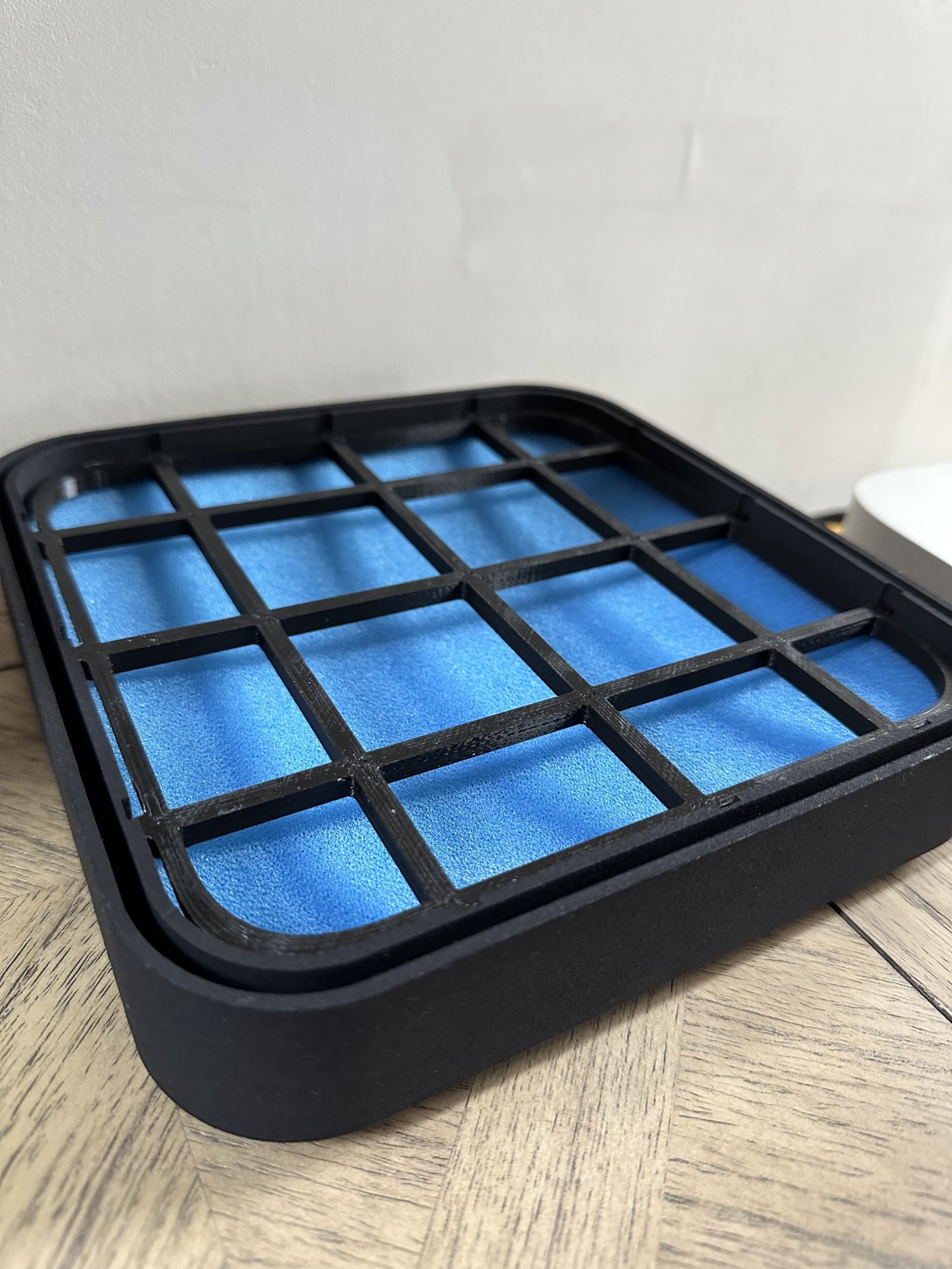

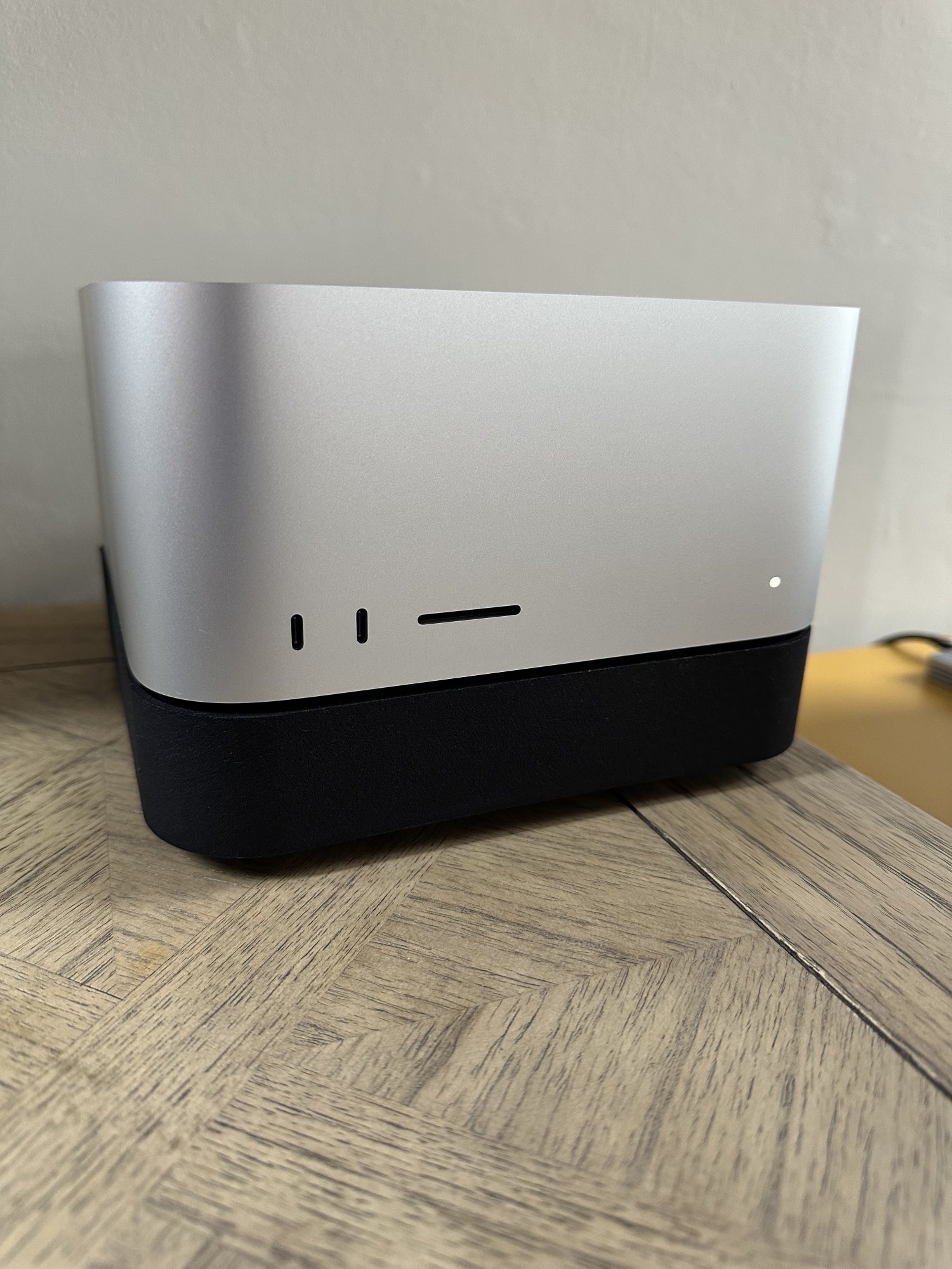

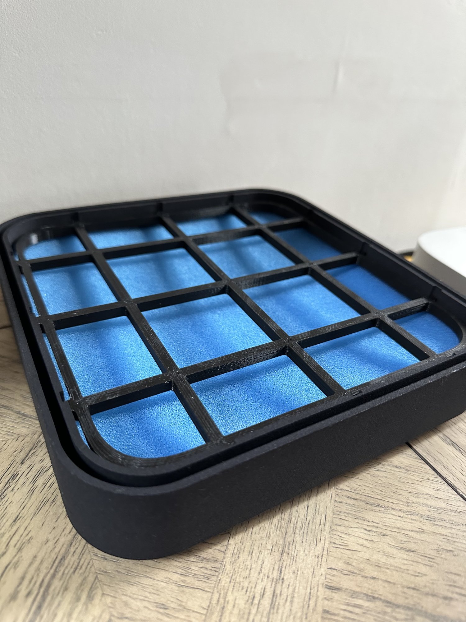

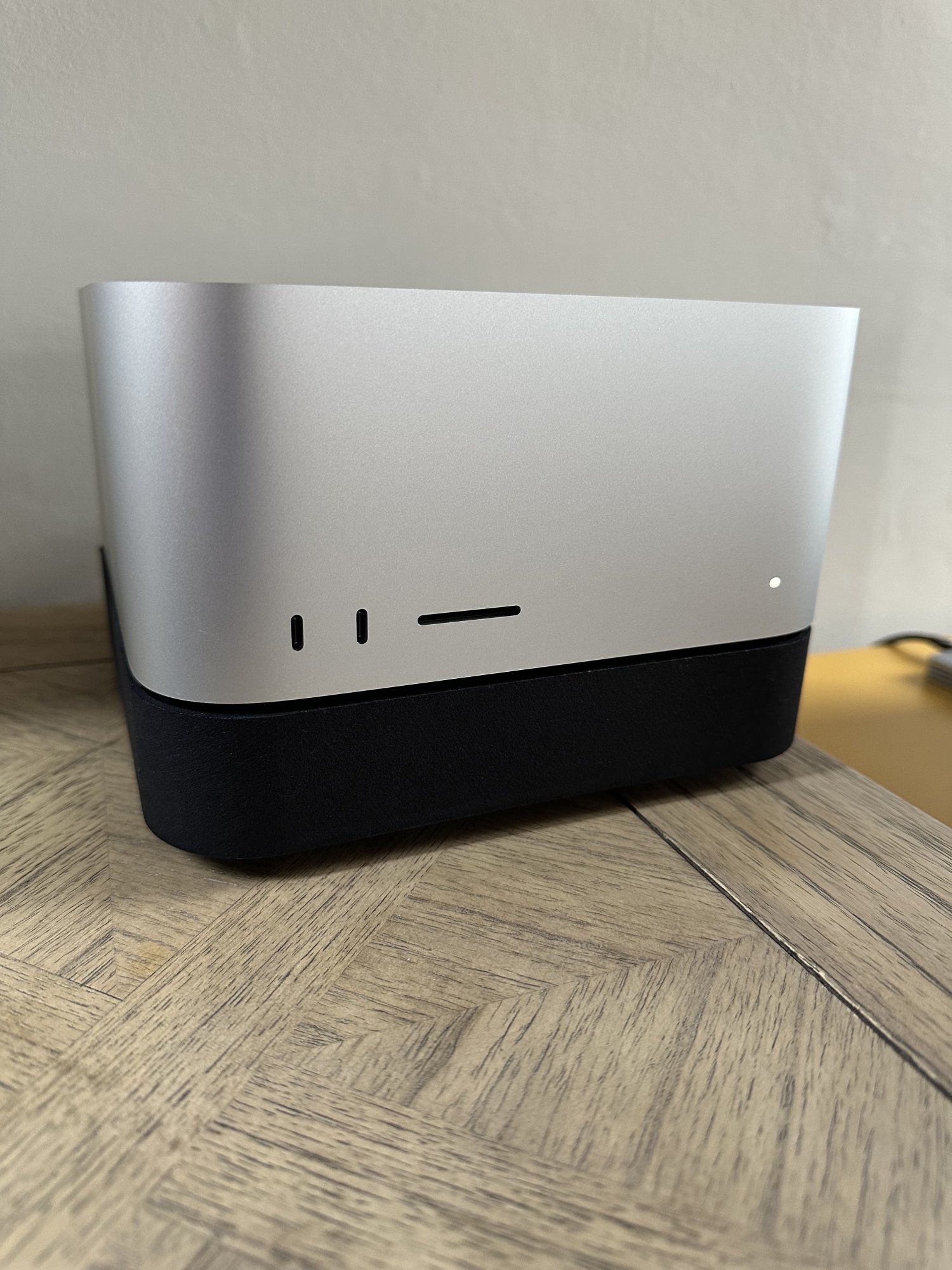

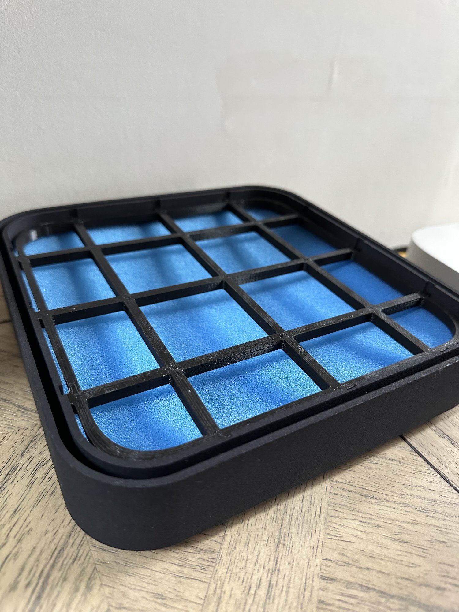

This is where I've landed. I initially jumped onto the Spiegen stand, which was fine. I opted to fill it, imperfectly, with some 45PPI reticulated foam filter. A ~2°C degrees increase on temps under a normal workload within a 20/22°C ambient temperature.
I came across the 3D print model, I liked the approach and without knowing anything about 3D printing, I thought why not.
I opted for the internal pieces to be printed PLA via FMD and the external housing dyed black nylon PA12 via MFJ, for a better finish quality, but at a higher cost.
I've just sourced a silicone sealing strip to fit around the case and create a more air tight seal, to finish it off.
I'm using the same 3D-printed housing and filter material. I like your black color.
What silicon sealing strip are you using? Believe it or not — I'm using a wide shoelace 🙂.
I took the measurements from my digital caliber to allow for printing tolerances. 3mm (thick) and 15mm wide is the closest I could find easily. I think 12mm is optimal, so I'll cut it down.

Just curious if there is a temperature difference between the 3d printed filter and the Spiegen stand?
I certainly left some room for creativity around this case but... man... shoelaces??? S. Jobs is turning in his grave 🙂
However, kudos for creativity 🙂
Soft silicone tubing having an OD slightly larger than the case groove is my new idea.
I don't have reams of data but my graph for cpu average temperature seems to lean toward the 3D case running ~1°C cooler for longer than the Spiegen (with the additional foam filter), it's minimal and will probably average out.

I've confirmed my measurement, a 3mm thick x 12mm wide Neoprene Rubber Strip fits perfectly and creates a good seal and friction so the Mac Studio grips the case.
