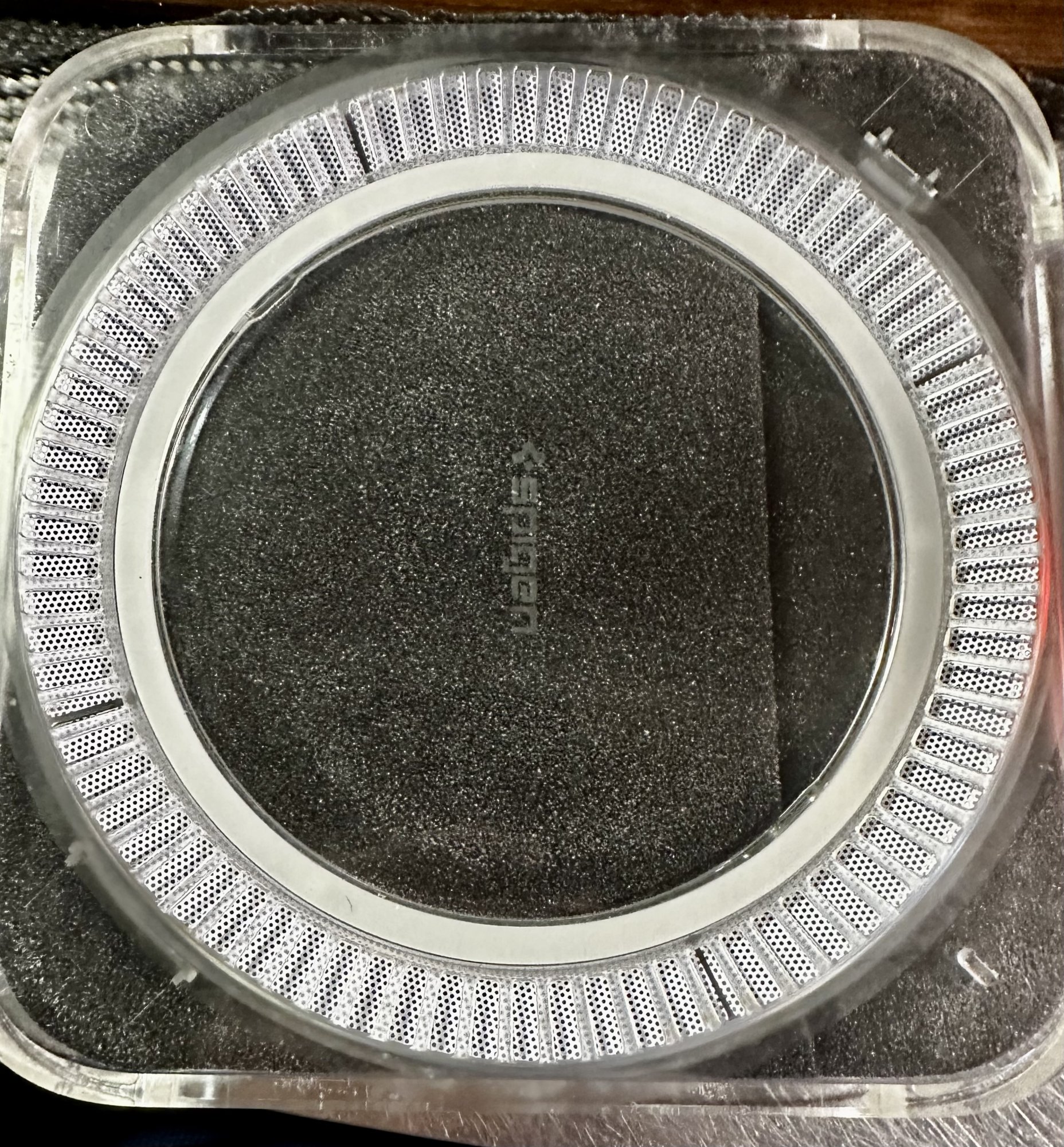

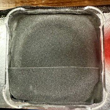

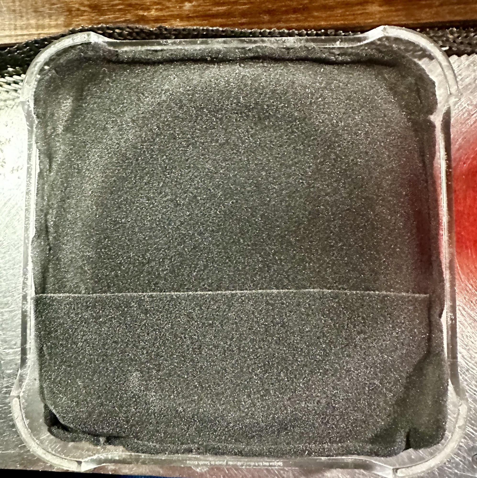

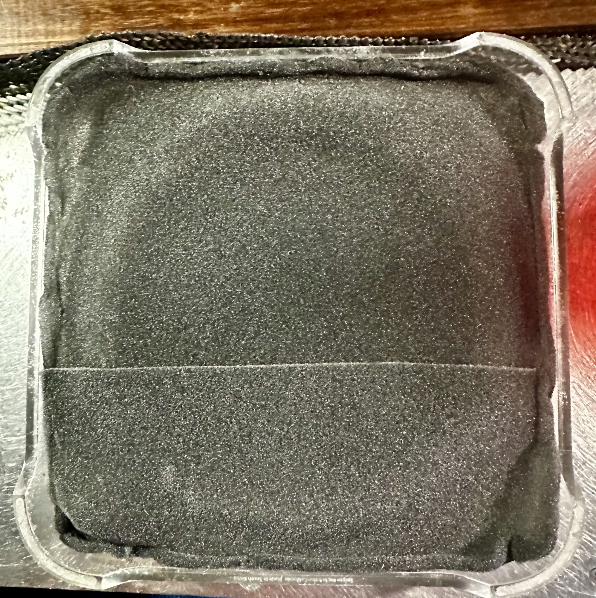

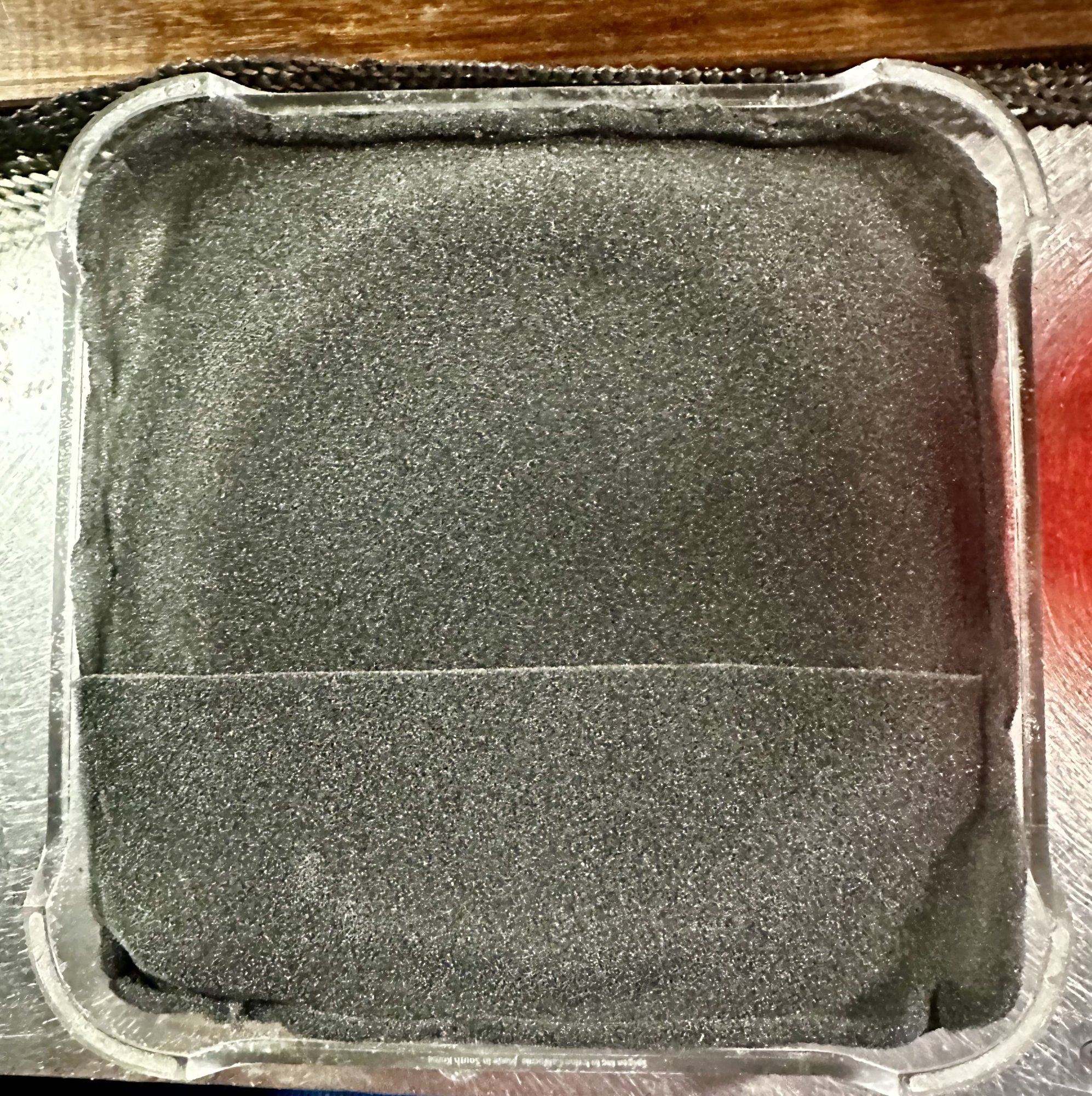

I am going to try this. The "DustEnd" filter material is self adhesive. I just cut it to fit and attached it to the underside of the Spigen filter stand. Its adhesive did a very good job sticking down and sealing the base up. The black foam will enable me to better see what is it filtering out.

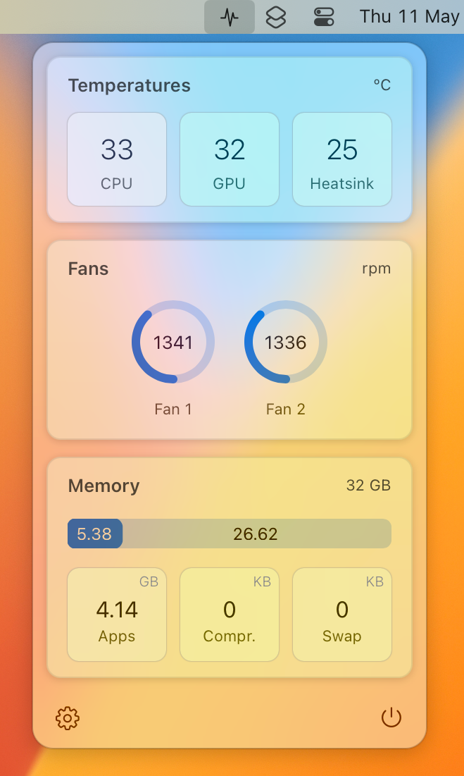

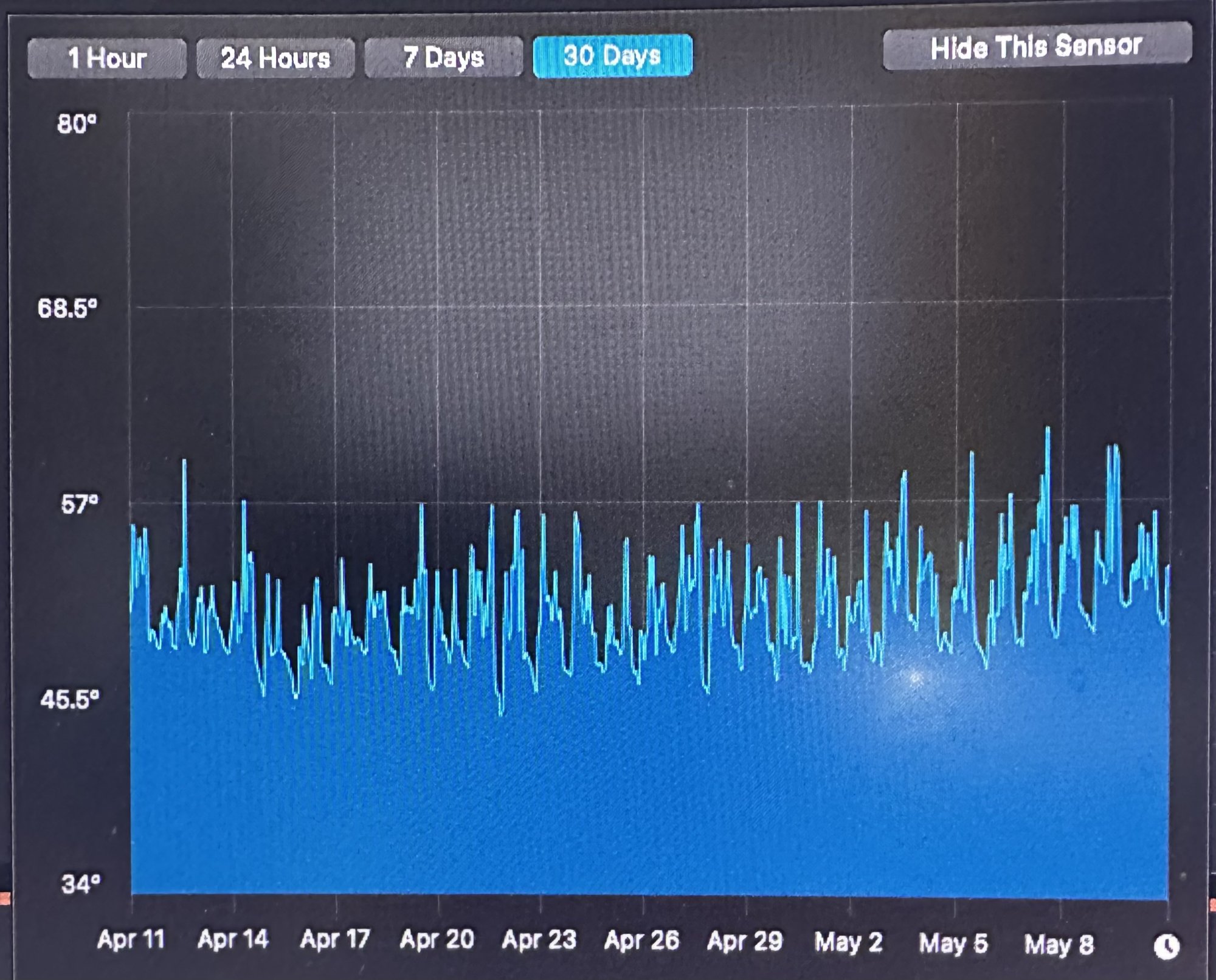

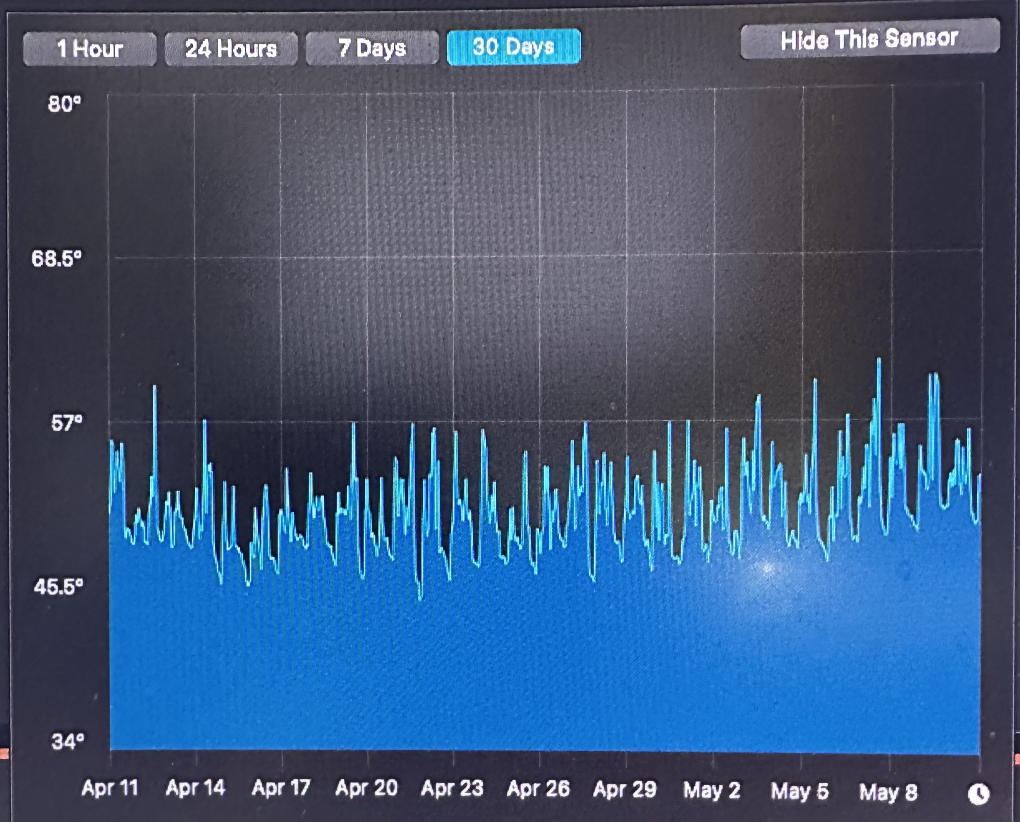

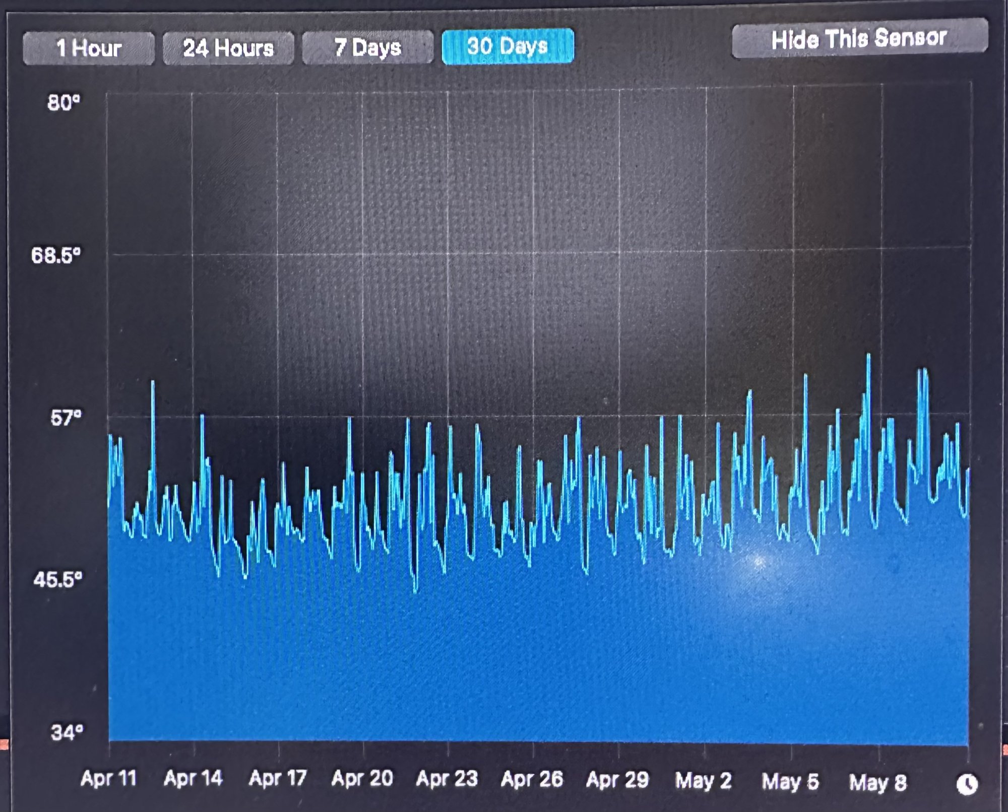

So far so good I am being a little paranoid about temperatures but I have iStats loaded and I can see no difference. I can look at the temperature range for up to 30 days at a time so I will be able to see if there is any increase in average operating temperature.

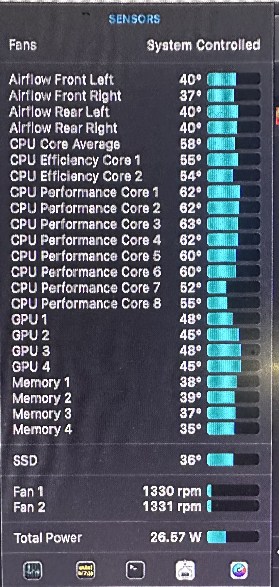

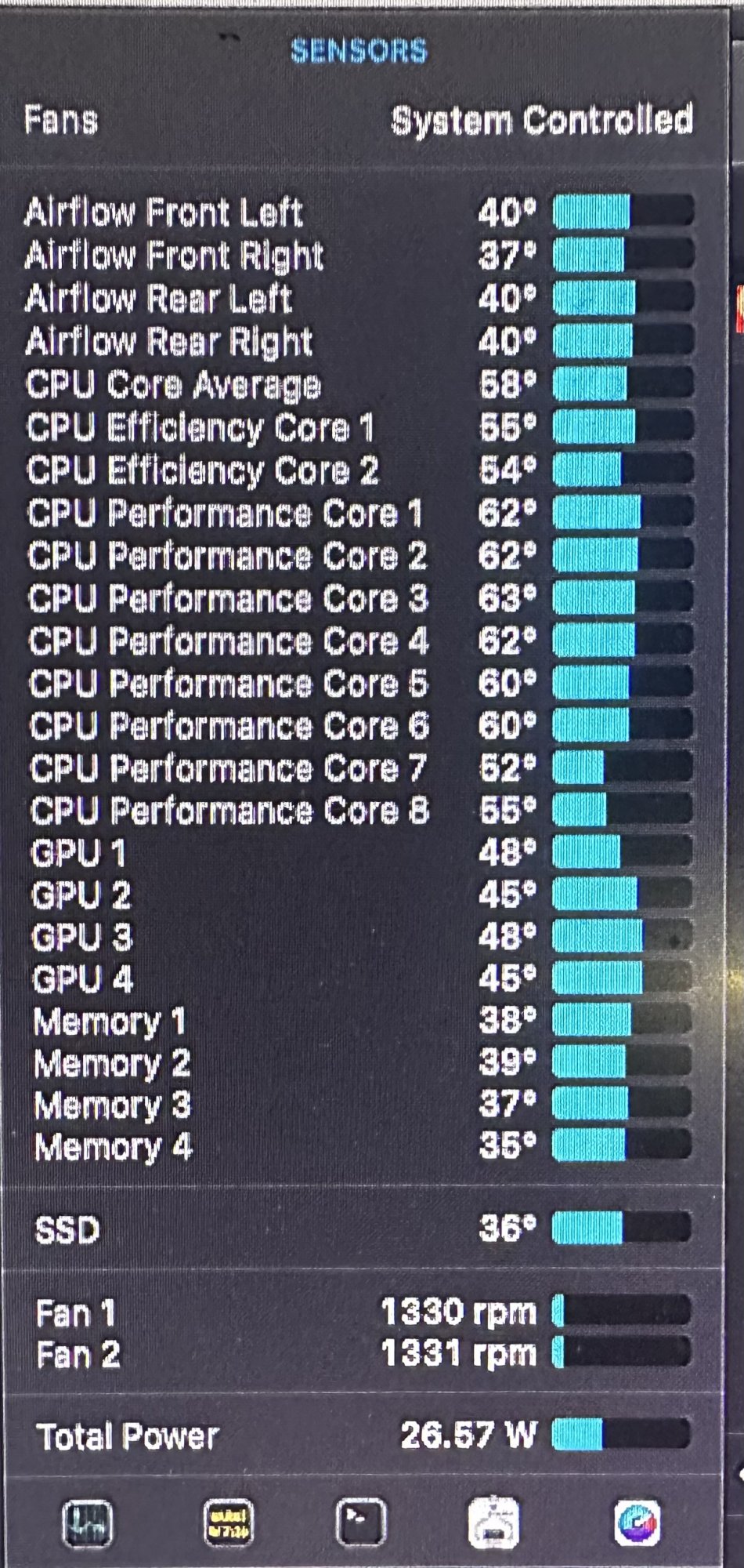

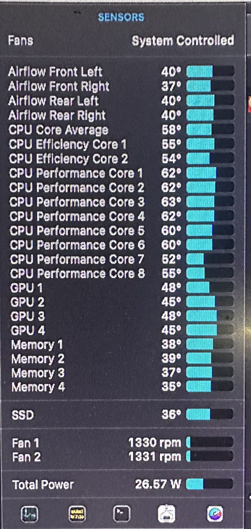

I have the iStat app loaded and it gives me a total view of all of the sensors on the Mac Studio. To the left is the real time figures reported by all of the sensors. On the right is the 30 day average temperature for the entire Studio.

As it turns out other then the dust issue, which may not be a issue at all. Worrying about the temperature is needless. the M1 Max is designed to operate at 100°C. That is a figure straight from Apple.

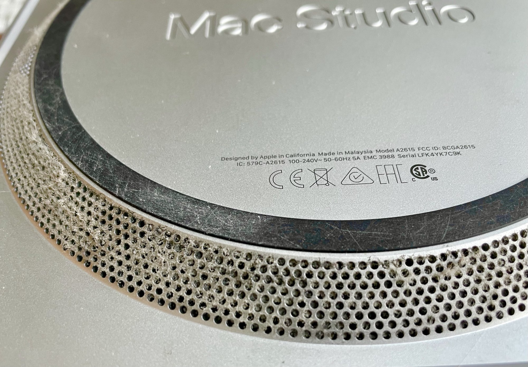

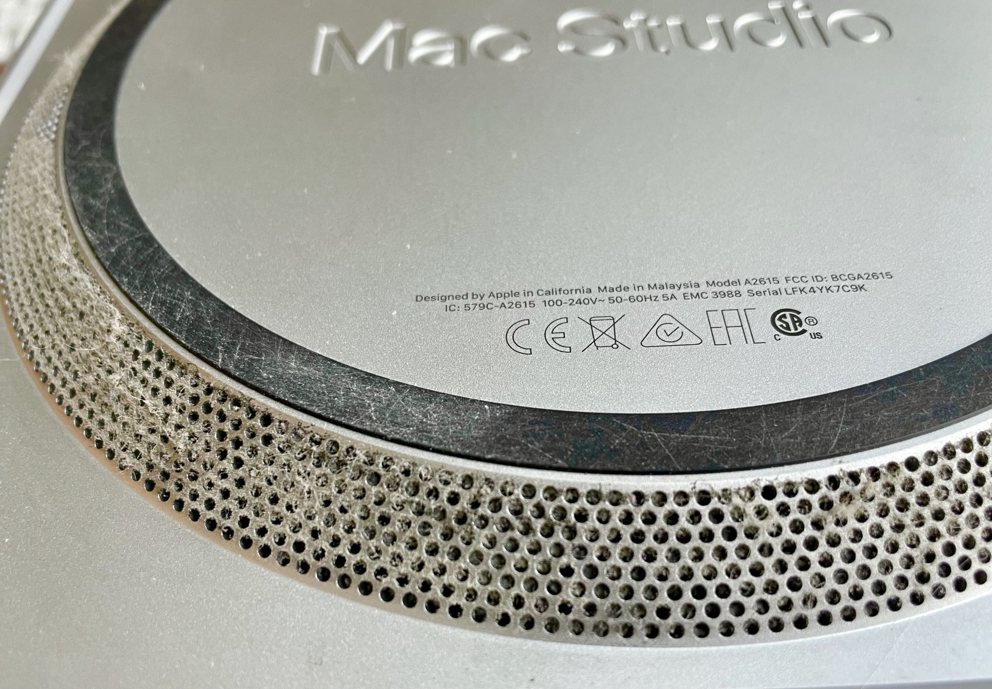

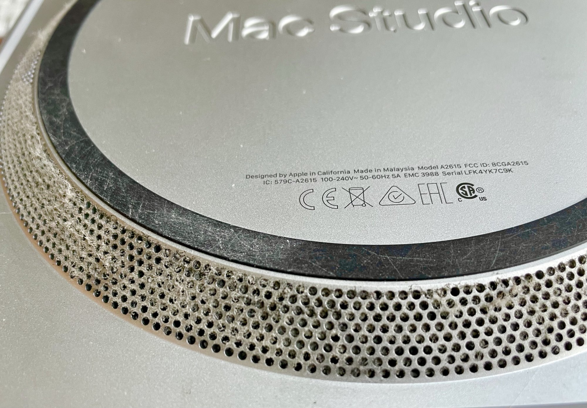

After a year I flipped the MacStudio over. Wow! That’s some level of grime. We have a housekeeper twice a week and a robovac runs every morning. There is no visible dust anywhere in the room—except on the grill of this thing. WTF? And it’s deep in the little holes, too.
Just saw the notes about the Spigen stand: that will be here tomorrow. Hopefully that keeps it from getting worse. The machine runs so cool I’m not too worried about what’s in there already. But I would recommend using something on this machine.

Check out what I did with My Spigen up thread it seems to be working.

Holy crap!!! I bet the units at Apple do not look like this!
