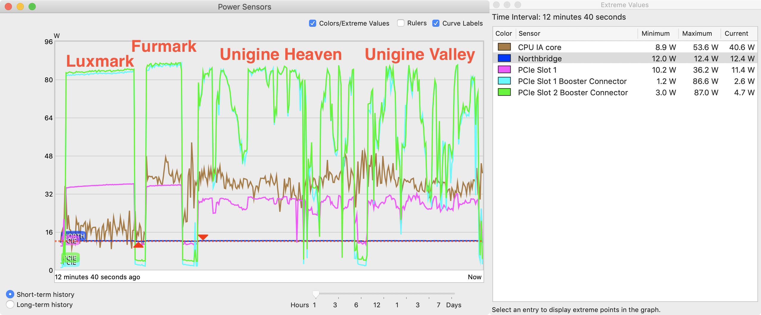

Something happened: MacPro nearly idle: 150W (measured at the wall outlet), Radeon VII rendering in Cinema4D with ProRender (GPU-processor under max. load): max 350W (measured at the wall outlet). No stability-problems.
(My "retired" Vega 64 consumed max 330W alone...without downvolting, but never tried with Vega 64)

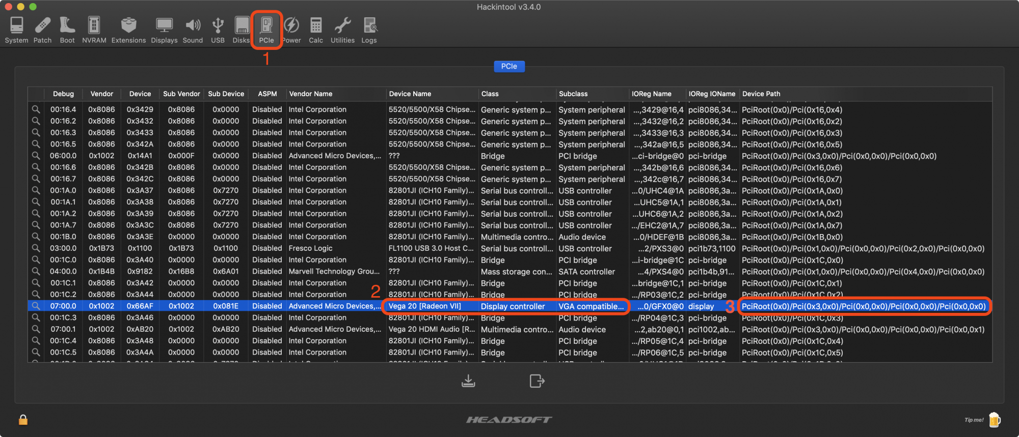

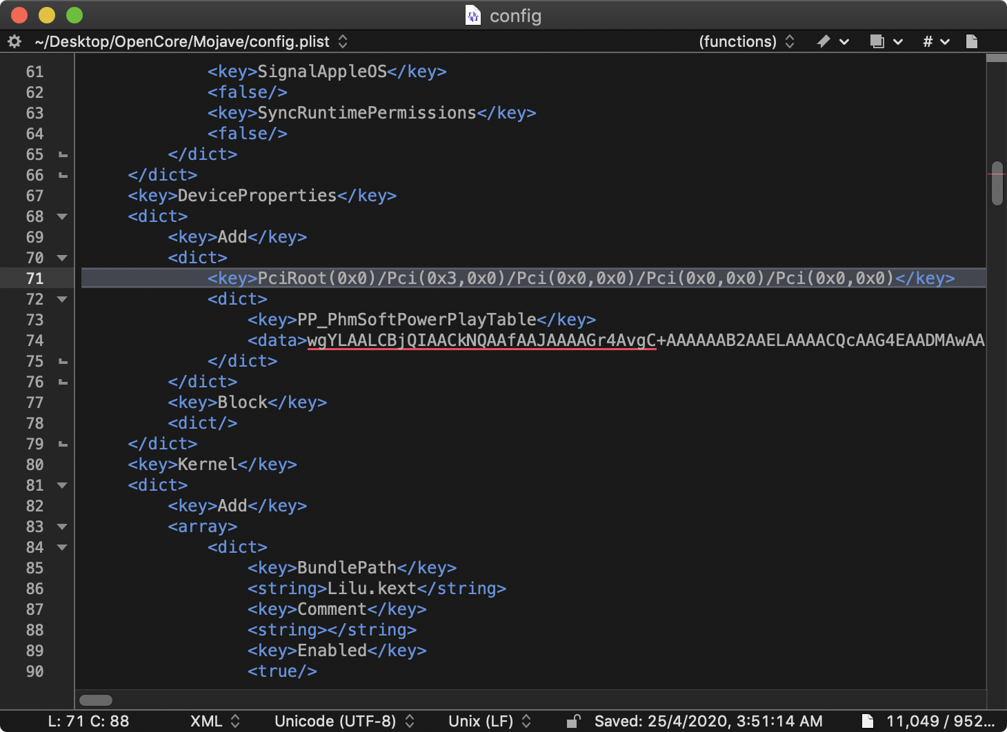

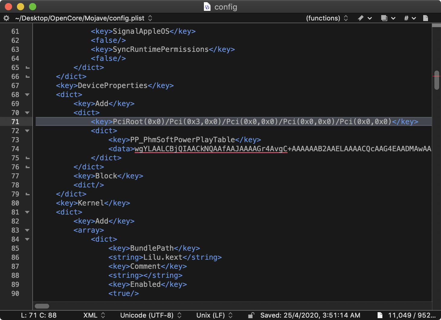

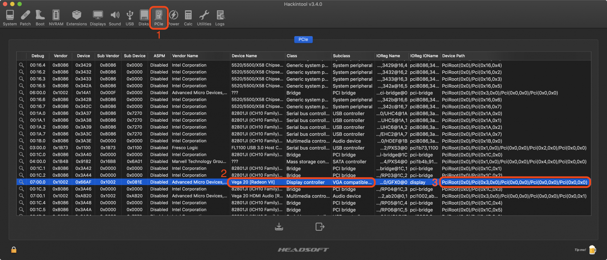

For those who want to inject the PowerPlay table via OpenCore, you may remove the PowerPlay kext, and do the following. For those who want the kext, please go to the bottom of this post.
1) Use Hackintool to find out the PciRoot
2) Mount your EFI partition, then open the config.plist with text editor, search DeviceProperties, and place the following code under the Add section
Code:
        <dict>
            <key>PciRoot(0x0)/Pci(0x3,0x0)/Pci(0x0,0x0)/Pci(0x0,0x0)/Pci(0x0,0x0)</key>
            <dict>
                <key>PP_PhmSoftPowerPlayTable</key>
                <data>wgYLAALCBjQIAACkNQAAfAAJAAAAGr4AvgC+AAAAAAB2AAELAAAACQcAAG4EAADMAwAAzAMAAMwDAADoAwAAyQQAAG4EAABuBAAANAQAACoDAAAAAAAAAAAAAAAAAAAAAAAAAAAAALwCAABmAQAANgEAADYBAAA2AQAAXgEAACYCAABmAQAAZgEAAJMAAAAOAQAAAAAAAAAAAAAAAAAAAAAAAAAAAAABDgAAAAEBAQEBAQEBAQABAQEBAAAAAAAAAAAAAAAAAAAAAAAAHQAAAJgIAACYCAAAmAgAANUDAACYCAAA1QMAAJgIAADVAwAAsAQAABQAAAAKDwAACg8AAF8AAABuAAAAAgAAAAAAAAABAAAAAQAAAAEAAABfAAAAZAAAAF8AAABkAAAAXwAAAGQAAABfAAAAZAAAAF8AAABkAAAAAAAAAAAAAAAAAAAAKAMAACgDAAAoAwAA4gIAACgDAADiAgAAKAMAAOICAABeAQAAFAAAAMIBAADCAQAAGQAAADIAAAAAAAAAAAAAAAAAAAAAAAAAAAAAABkAAAAUAAAAGQAAABQAAAAZAAAAFAAAABkAAAAUAAAAGQAAABQAAAAAAAAAAAAAAAAAAAAAAAAAAAAAAAAAAwAAAP/v9DkAAAAAvgAAAAAAAAAAAAAAAAAAAL4AAAAyAAAASgEAAGQAbgBeAHMAcwD///////8AAAAAAAAAAAEAcwAAAAAAAAAAAPAK8AqgD6APJgAAAAEBCQAAAAAAAAAAAFuxvz7sUfi+ZRlSPwABCABkO58/Ft6lvQAAAAAAAAAAAAAAAAABCAA1Xpo/jzYuPgAAAAAAAAAAAAAAAAABCABpb7A/SDMWPQAAAAAAAAAAAAAAAAABCADlYaE/EvdYvQAAAAAAAAAAAAAAAAABAwC1FYM/wt0ZPgAAAAAAAAAAAAAAAAABCACGOIY/Dr4wPgAAAAAAAAAAAAAAAAABCACDwFo/TaHzPQAAAAAAAAAAAAAAAAIBCAAAAAAAAAAAAKRwjT/kFIW/1ecyPwIBAwAAAAAAAAAAAAAAAAAAAAAA1ecyPwEBCAAAAIA/AAAAANGR/D4fhSu/Mnd1P7wCKANuBFwFCgaTBtUG7QYJBwAAAAAAAAAAAAAAAAAAZgHmAWsC9AJSA8wDbgRuBDYBkAEMAmsCqAL0AlIDzAM2AZABDAJrAqgC9AJSA8wDNgEMAjcCawKoAvQCUgPMA14BIANMBEwEJgJiArIC+AJmA8ADOATJBGYBxgE3AqgC9AJSA8wDbgRmAcYBNwKoAvQCUgPMA24EkwDyAFgB5AEVAqoDEwQ0BA4BHAIqAwAAAAAAAAAAAAAJB24EzAPMA8wD6ANuBG4ENAQqA8kEAADIACwBYAnwCigDAAAAAAAAAAAAAAAAAAAAAAAAAAAAAAkHAQAAAAAAAAIGBlAANAEAAAAAAAAAAAAAAACQAZABkAGQAZABkAGQARQAVAtUCwoPUAAAAAACAAAAAAAAAAAAAQAAAAAAAFCNlzwK16M7AAAAAOqymDyHokA9AAAAAAAAAAAAAAAAAAAAAAAAAAAAAAAAAAAAAAAAAAAAAAAAAAAAAAAAAAAAAAAAAAAAAAAAAAAAAAAAAAAAAAAAAAAAAAAAAAAAAAAAAAAAAAAAAAAAAAAAoAABAAAAAAAAAKAAAAAIEAIQGgRMBOgD6APoA+gDAAAAAAAAAAAAAAAAAAAAAAAAAAAAAAAAAAAAAAAAAAAAAAAAAAAAAAAAAAAAAAAAAAAAAAAAAACGCyILVAsAAJABkAE4AAAAAAAAAAAAAAAAAAAAAAAAAAAAAAAAAAAAAAAAAAAAAAAAAAAAAAAAAAAAAAAAAAAAAAAAAAAAAAAAAAAAAAAAAAAAAAAAAAAAAAAAAAAAAAAAAAAAAAAAAAAAAAAAAAAAAAAAAAAAAAAAAAAAAAAAAAAAAAAAAAAAAAAAAAAAAAAAAAAAAAAAAAAAAAAAAAAAAAAAAAAAAAAAAAAAAAAAAAAAAAAAAAAAAAAAAAAAAAAAAAAAAAAAAAAAAAAAAAAAAAAAAAAAAAAAAAAAAAAAAAAAAAAAAAAAAAAAAAAAAAAAAAAAAAAAAAAAAAAAAAAAAAAAAAAAAAAAAAAAAAAAAAAAAAAAAAAAAAAAAAAAAAAAAAAAAAAAAAAAAAAAAAAAAAAAAAAAAAAAAAAAAAAAAAAAAAAAAAAAAAAAAAAAAAAAAAAAAAAAAAAAAAAAAAAAAAAAAAAAAAAAAAAAAAAAAAAAAAAAAAAAAAAAAAAAAAAAAAAAAAAAAAAAAAA=</data>
            </dict>
        </dict>
The end result should looks like this
3) Check the PciRoot is same as your GPU's Device Path found in step 1, if not, correct it.
4) If you have your own PowerPlay table, replace the base64 code accordingly.
5) Save and reboot
With this method, the PowerPlay table will NOT under AMD10000Controller anymore, but be injected to the GPU's device path directly. So, in IOReg, you will find the PowerPlay table under the GFX0 (assume you use my OpenCore package, which patch the GPU name to GFX0 for HEVC HWAccel)
This will NOT further improve anything. If your setup is working flawless now, there is no need for you to change anything. Especially in Mojave, there is no more GPU driver update. The kext now should be good forever (in Mojave).
However, if you are with Catalina, this method can avoid some possible compatibility issue for future macOS update.

Anyway, for Radeon VII, it's not too hard to know if the kext is really working. As per the info in post #1. You should able to observe the difference in power draw when you run Luxmark. (Luxmark produce very stable power draw, that's why I use this benchmarking software, but not the others)
Dumb question, but does Luxmark measure the power draw itself? Or are you using another program to do measure the draws? I somehow missed that bit of info.
For example, what program's are these [1] [2] ?

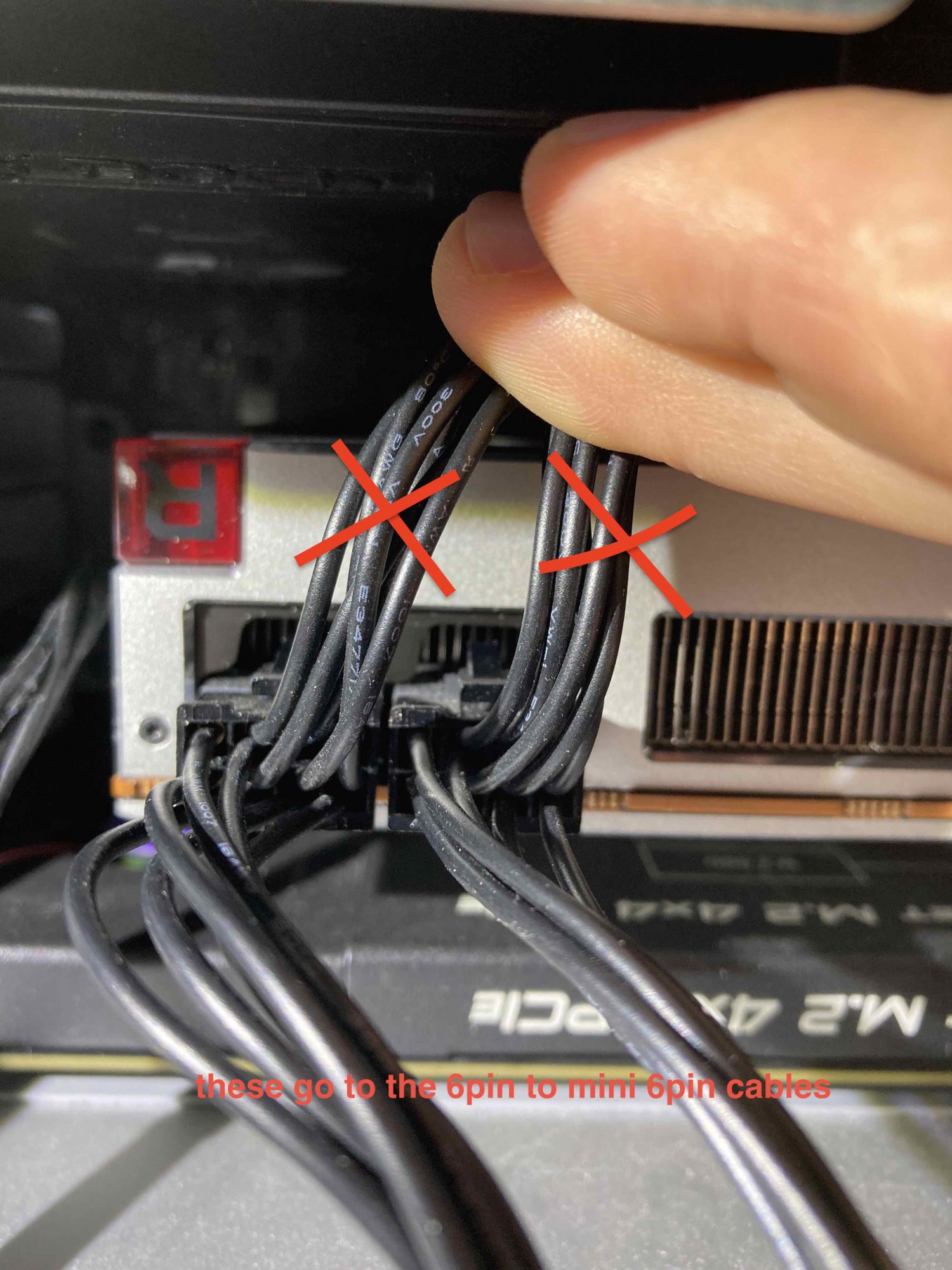

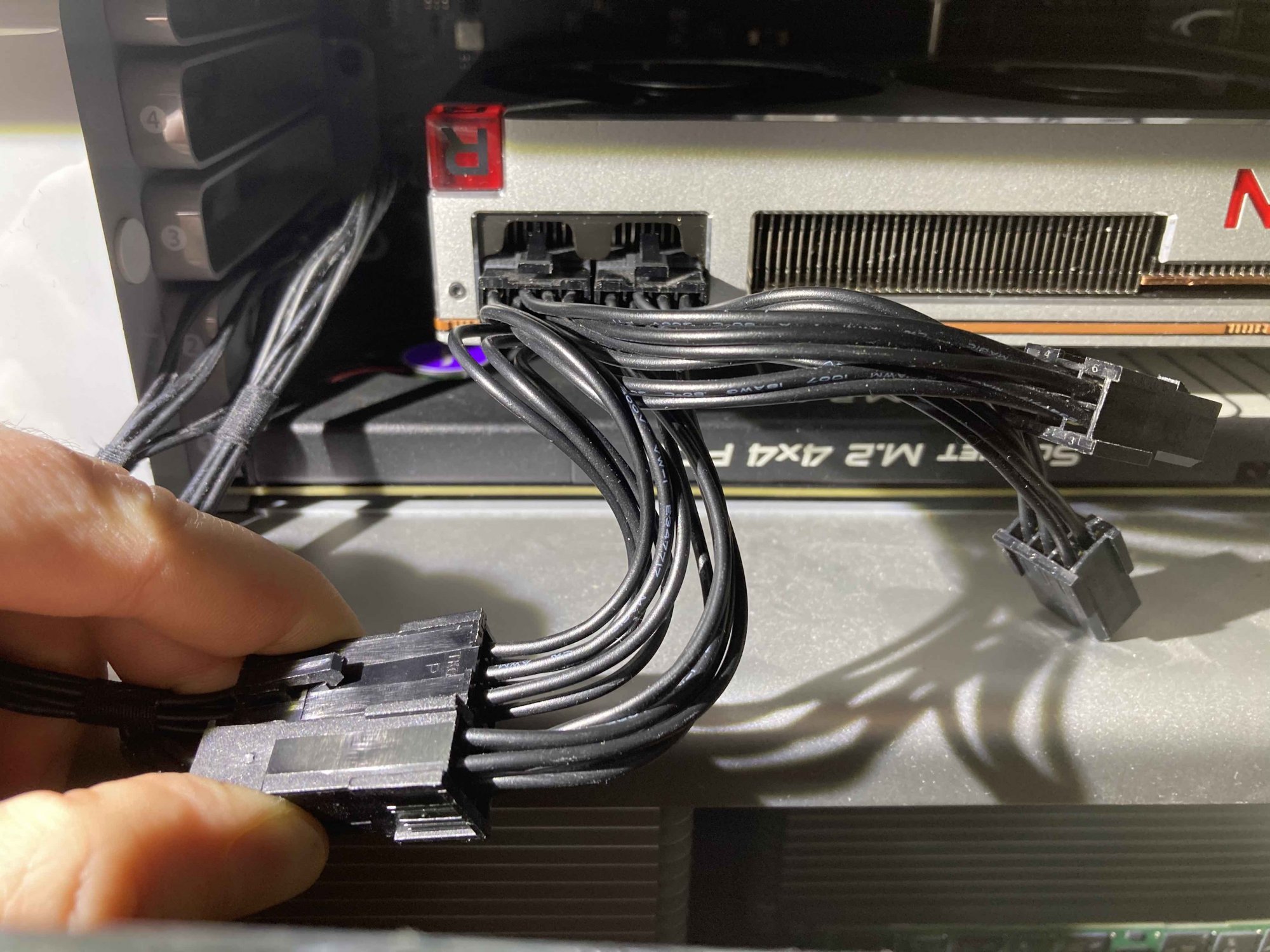

Did you balance the power draw?

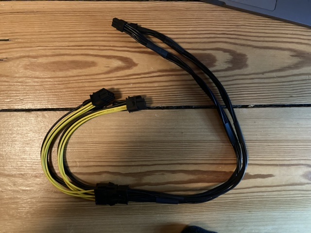

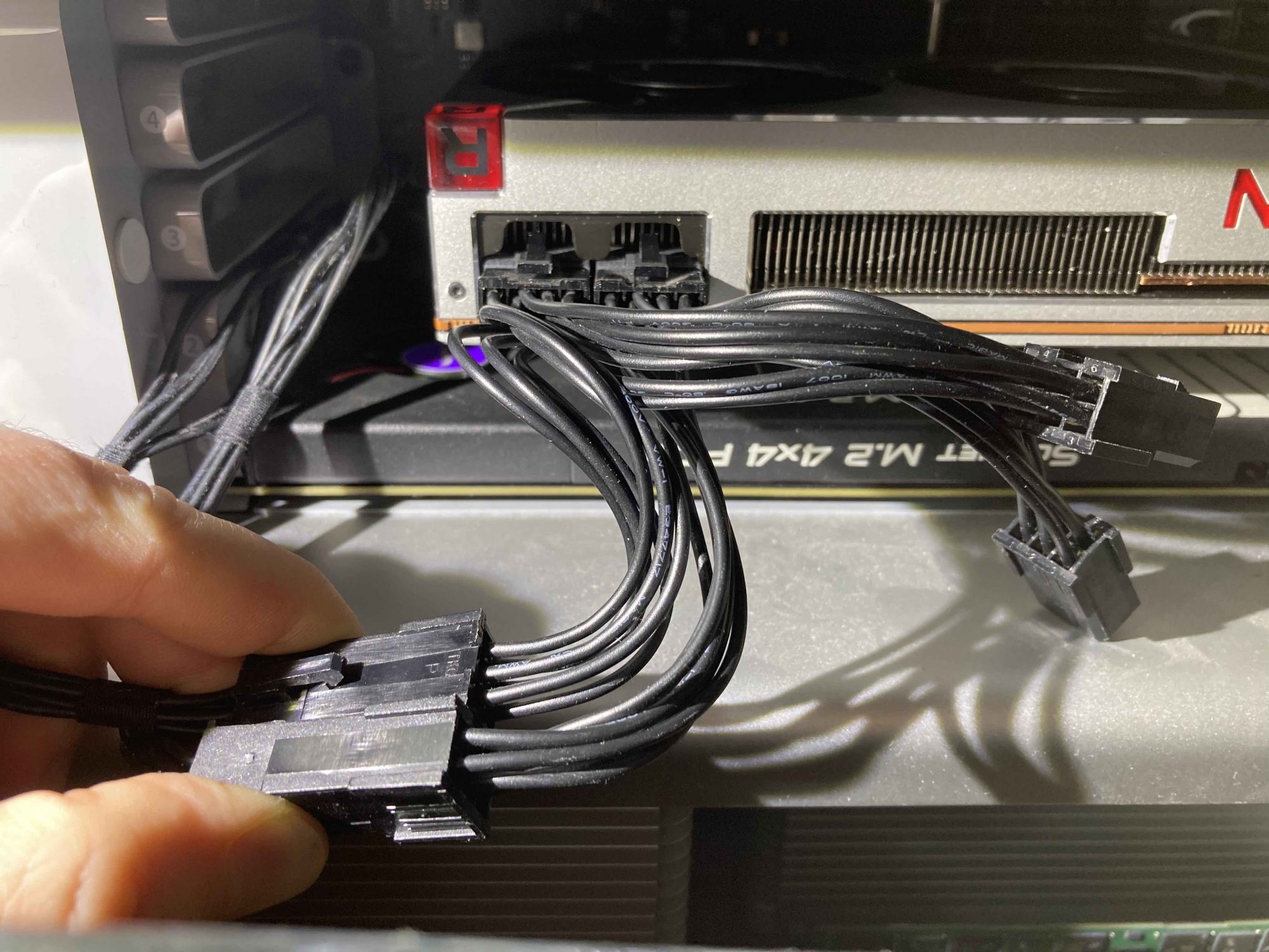

mh i have a weird cable setup since i was not able to get the same cables as in this post. I'm using 2x mini 6Pin to 6Pin cables then i have 2x dual 6Pin to 8pin cables of which i use only one 6pin per side resulting in to seperate mini6pin to 8pin cables sort of... i guess thats really messy...

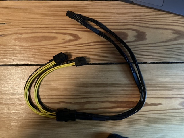

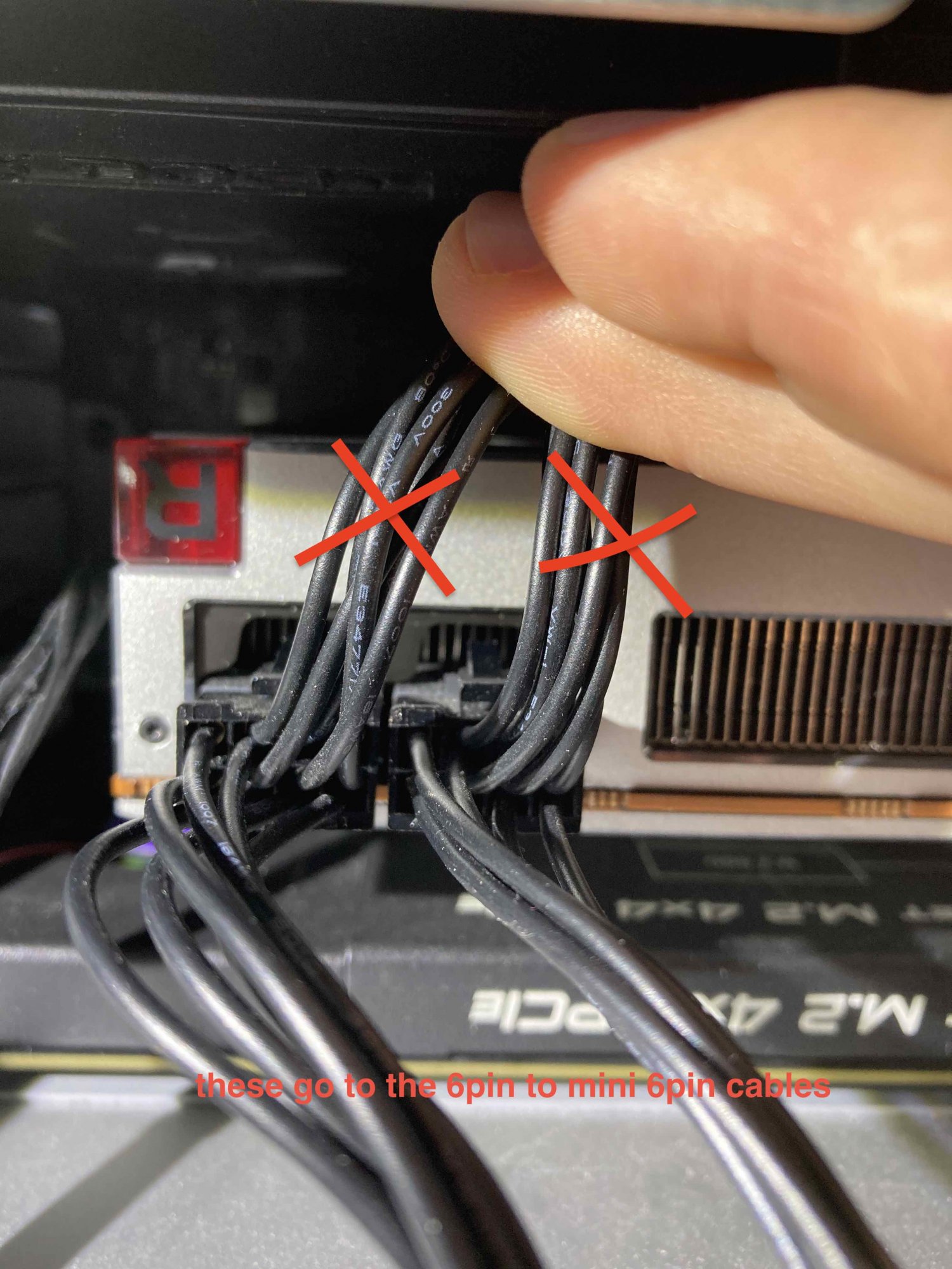

I also have a dual mini 6pin to single 8pin cable and a single 8pin to dual 8 pin cable but using that the card wont even power up

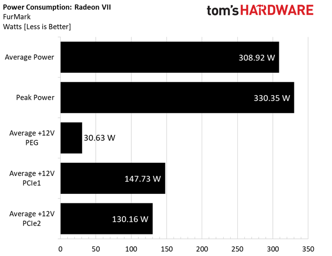

This is just insane, you are powering a GPU that Tom's Hardware found the peak power at 330.35W with a setup that can safely provide at best around 225 to 230W (when balancing the power draw, which you are not currently).
Yeah i have no idea what i did there i just tried a bunch of weird combinations after i got frustrated when the cables i ordered wouldn't work. Any idea why the dual mini6 to dual 8Pin combo in my other post doesn’t work? It should work the same as the solution martin used to balance powerdraw no? I cant get my hand on the exact combo he used since i can’t find the cables he described anywhere...
VII is a GPU that needs TWO 8-Pin power connections, 150W + 150W. Mac Pro backplane mini PCIe AUX Boost connectors can sustained provide 90~95W each.
No one should ever use a VII without a Pixla's mod unless you really don't care about shutdowns and your backplane power traces being burned to crisp.

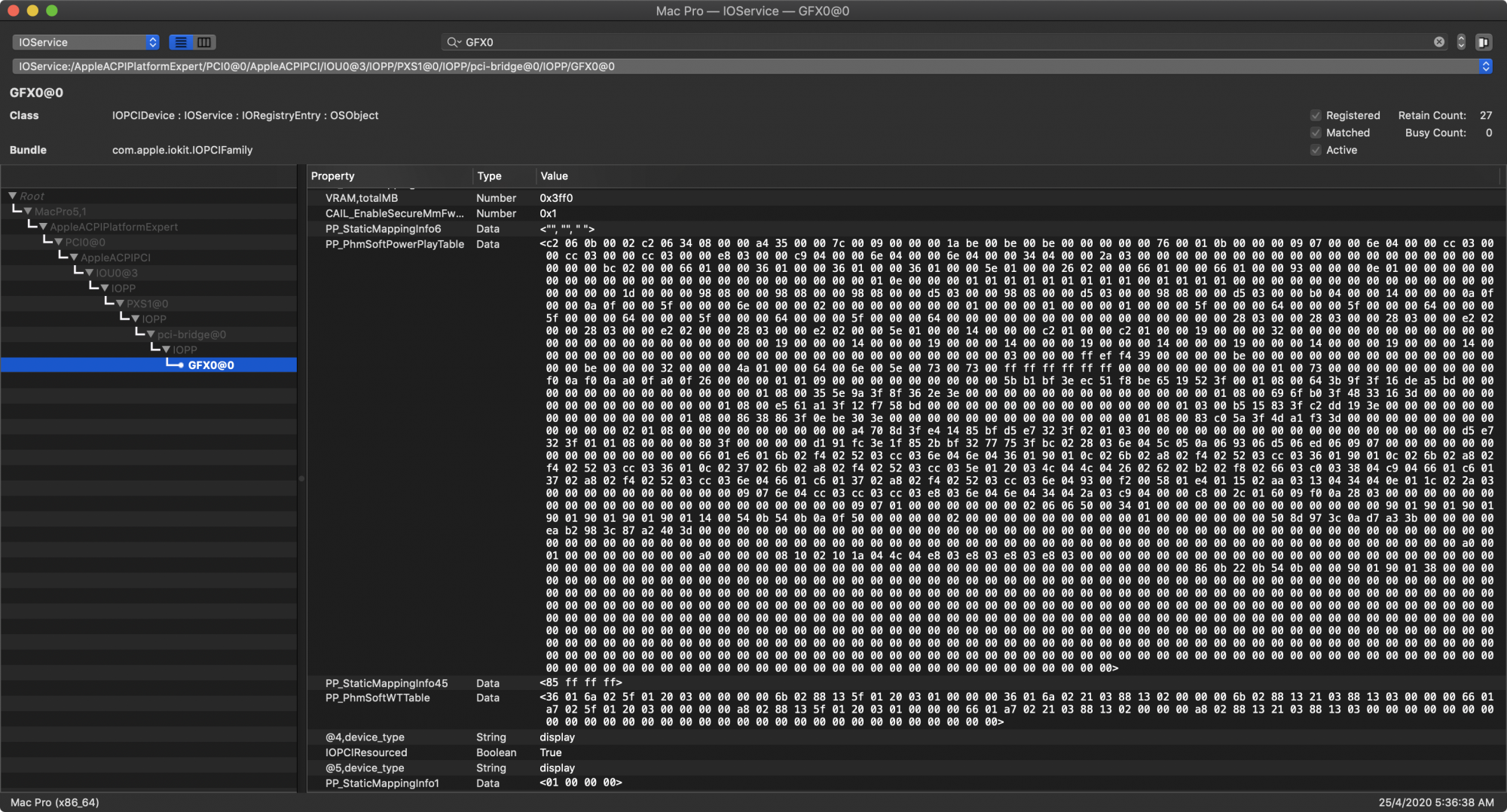

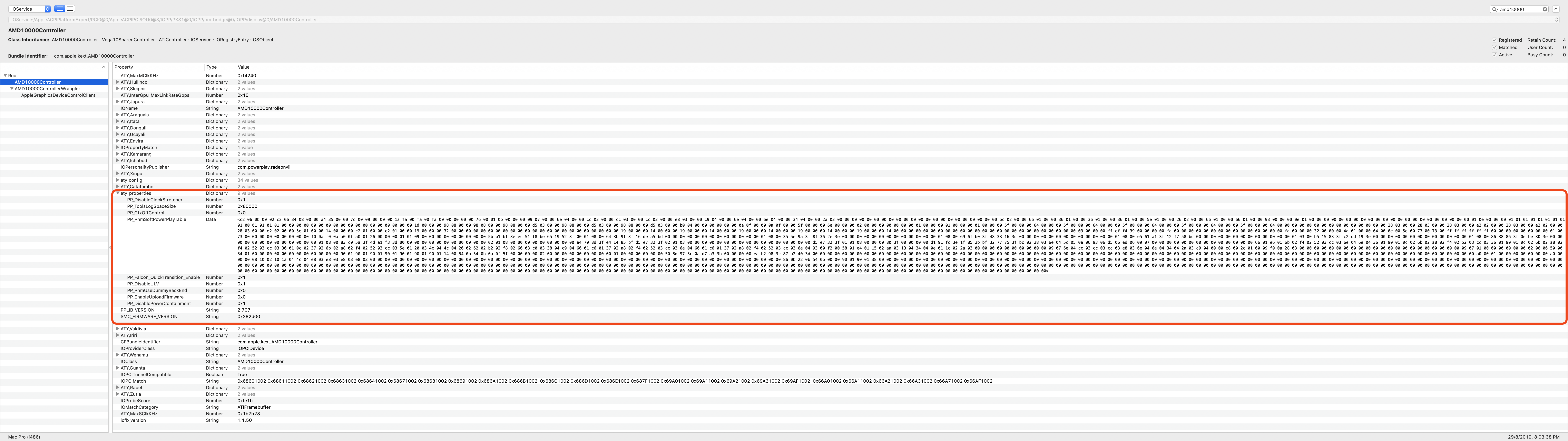

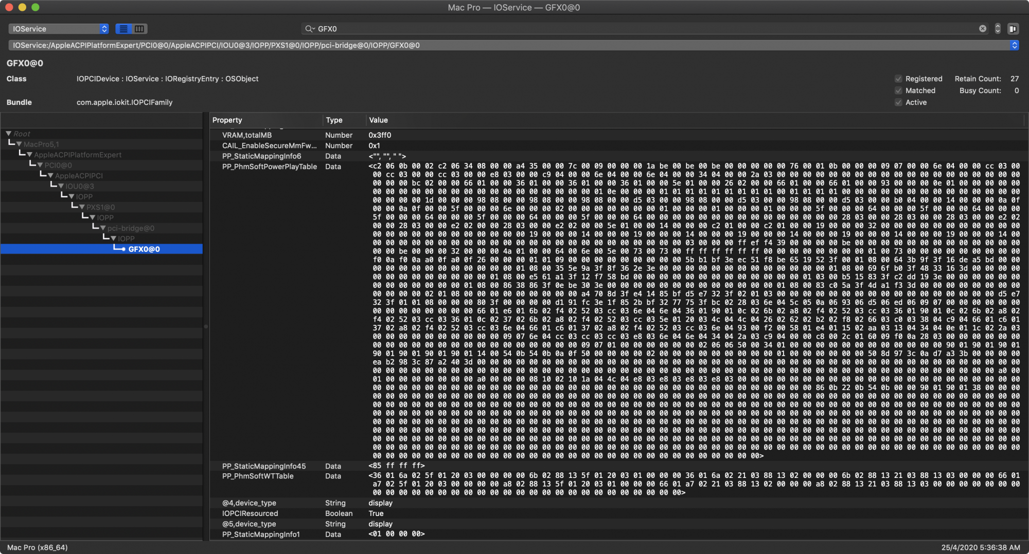

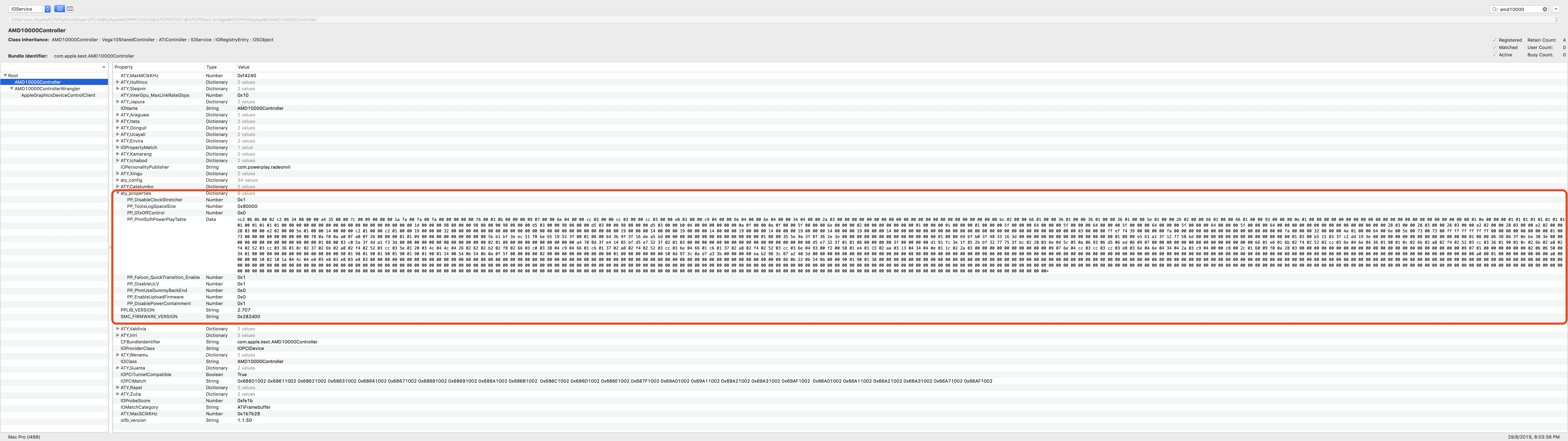

After reboot, the PowerPlay table should be working as expected. Since there is no way to observe the RadeonVII's parameters directly in macOS. My own suggestion is to run Luxmark 3.1 before applying the kext, record down the power draw and score, then run it again after kext installed. You should see about 5% improvement, but lower power draw.
Also, you may run IOJones
https://sourceforge.net/projects/iojones/
Then search AMD10000, you should see "9 values" next to "aty_properties", and able to see that large PP table.

I did this a few months ago and couldn't confirm afterwards that it had worked using IOJones (only 7 values after aty_properties and no large PP table), but using Hardware monitor while running Luxmark and Unigen Heaven seemed to produce the expected results so I didn't go back to see what I did wrong.
btw SIP is disabled. also I saw you post a screenshot of your extensions in System Information and the CustomPowerPlay kext was there. Mine is not...
