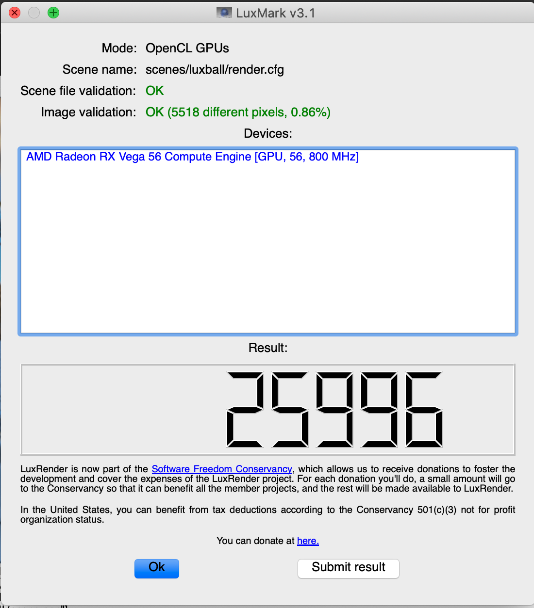

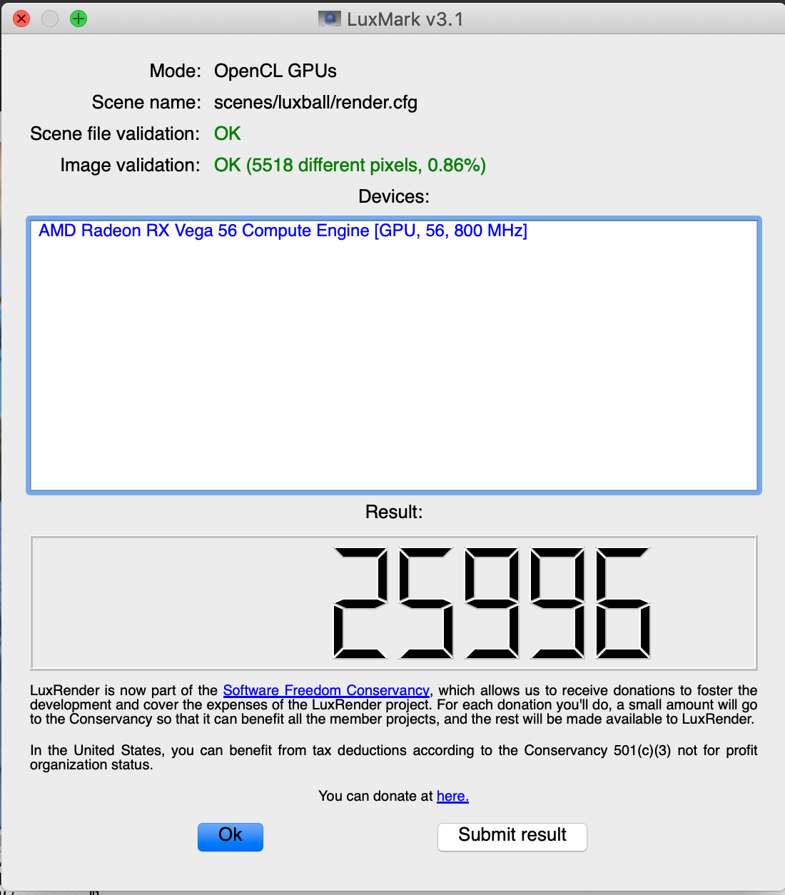

Wanted to share my result limiting max power on my VEGA 56 Reference (blower).
I've manage to limit max power on my VEGA 56 using VGTab by reducing core clock for the P5, P6 and P7 to the same value as P4 (1312Mhz) as it is not possible to down-volt VEGA 56 in macOS.
Running LuxMark max PCIe ampere is 6A (~ 75 Watt on each 6 pin) with Core clock: ~1250Mhz.
Surprisingly LuxMark score still looks good even with the reduced core clock.
PS: I edited the info.plist from the generated VGTab kext's IOProbe to 65051 as mentioned by H98 otherwise it won't load.

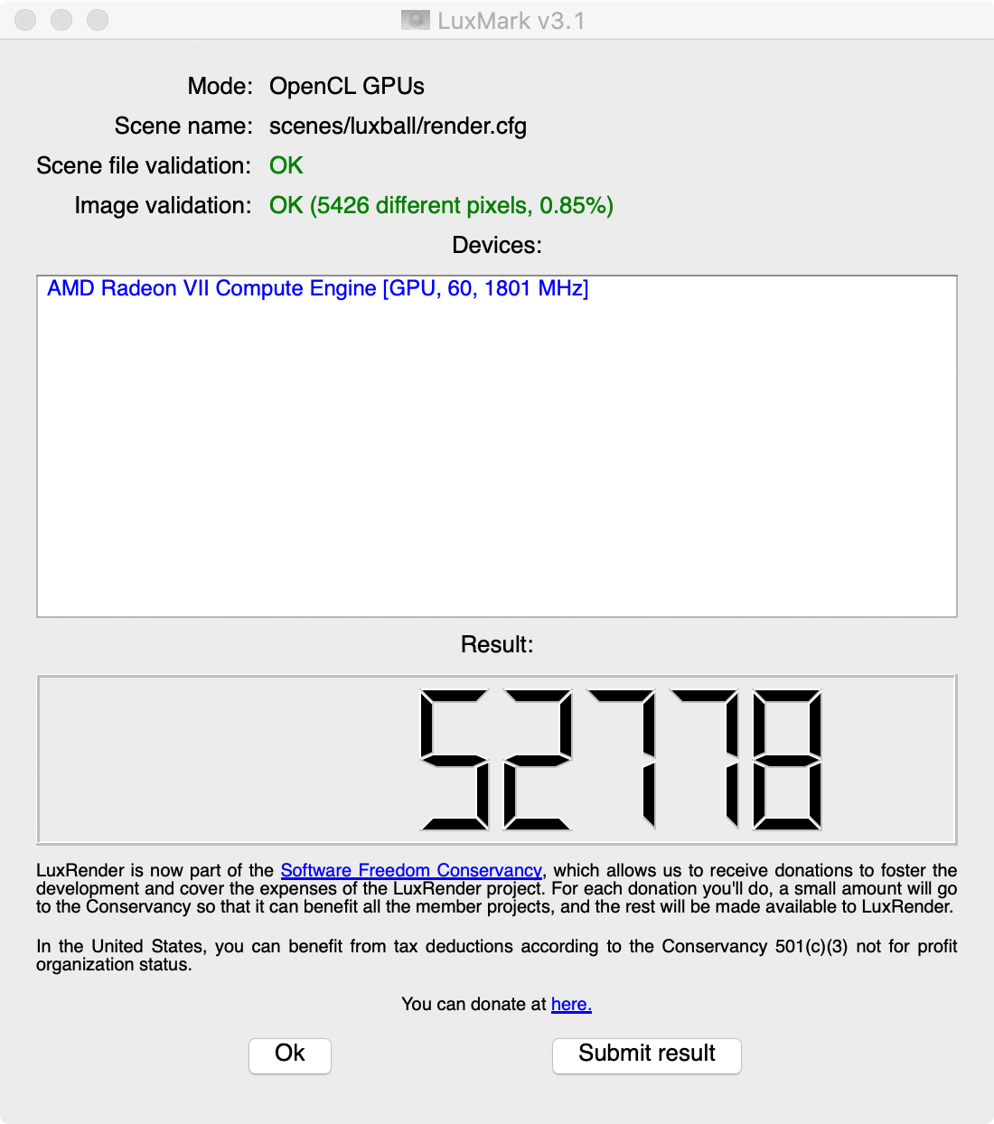

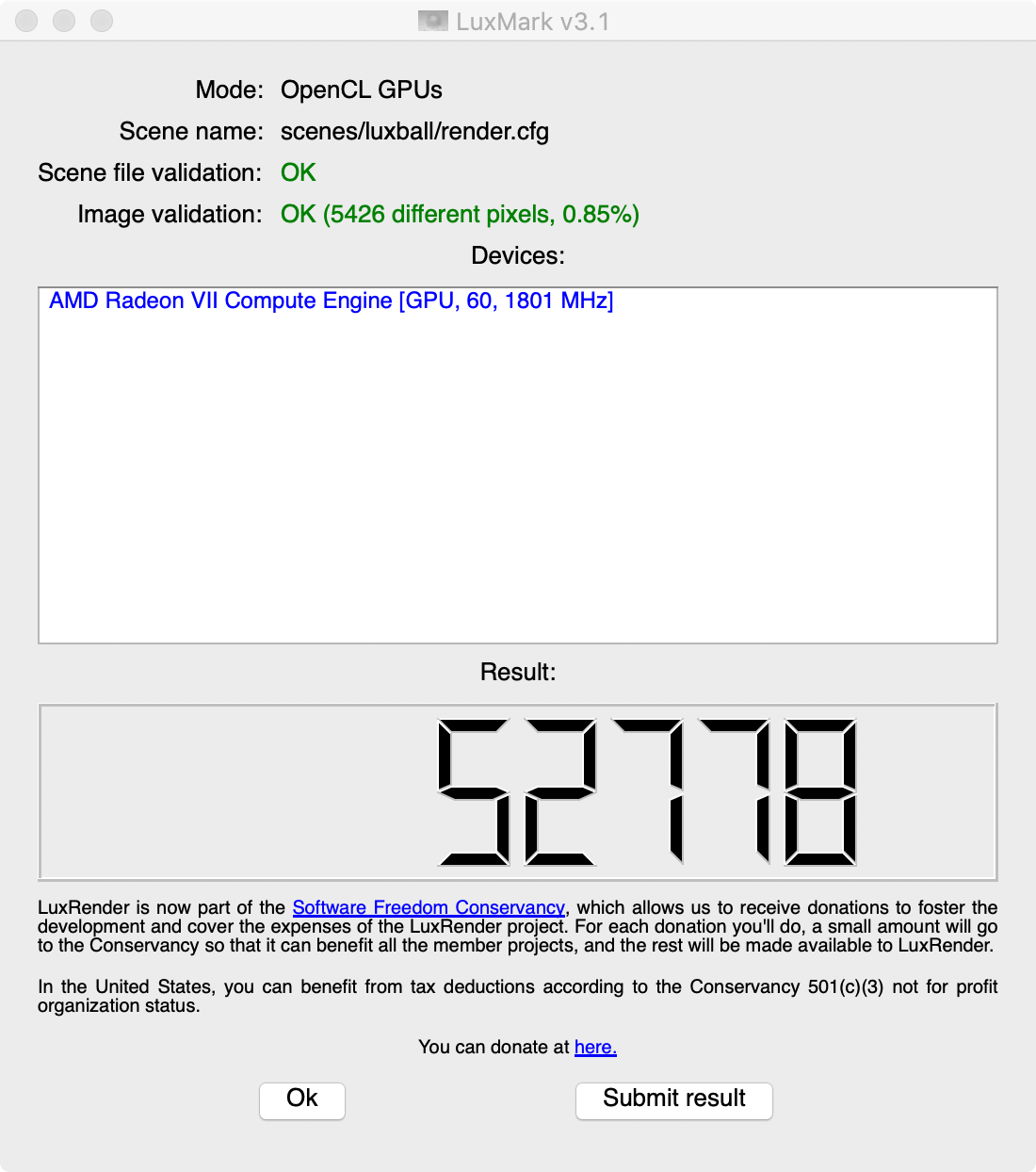

I just made a kext for 10.15.2 (19C57)
Same procedure as per post #21
Quick test shows good performance as expected. Anyway, good to see that Luxmark can report the correct boost clock speed in Catalina.

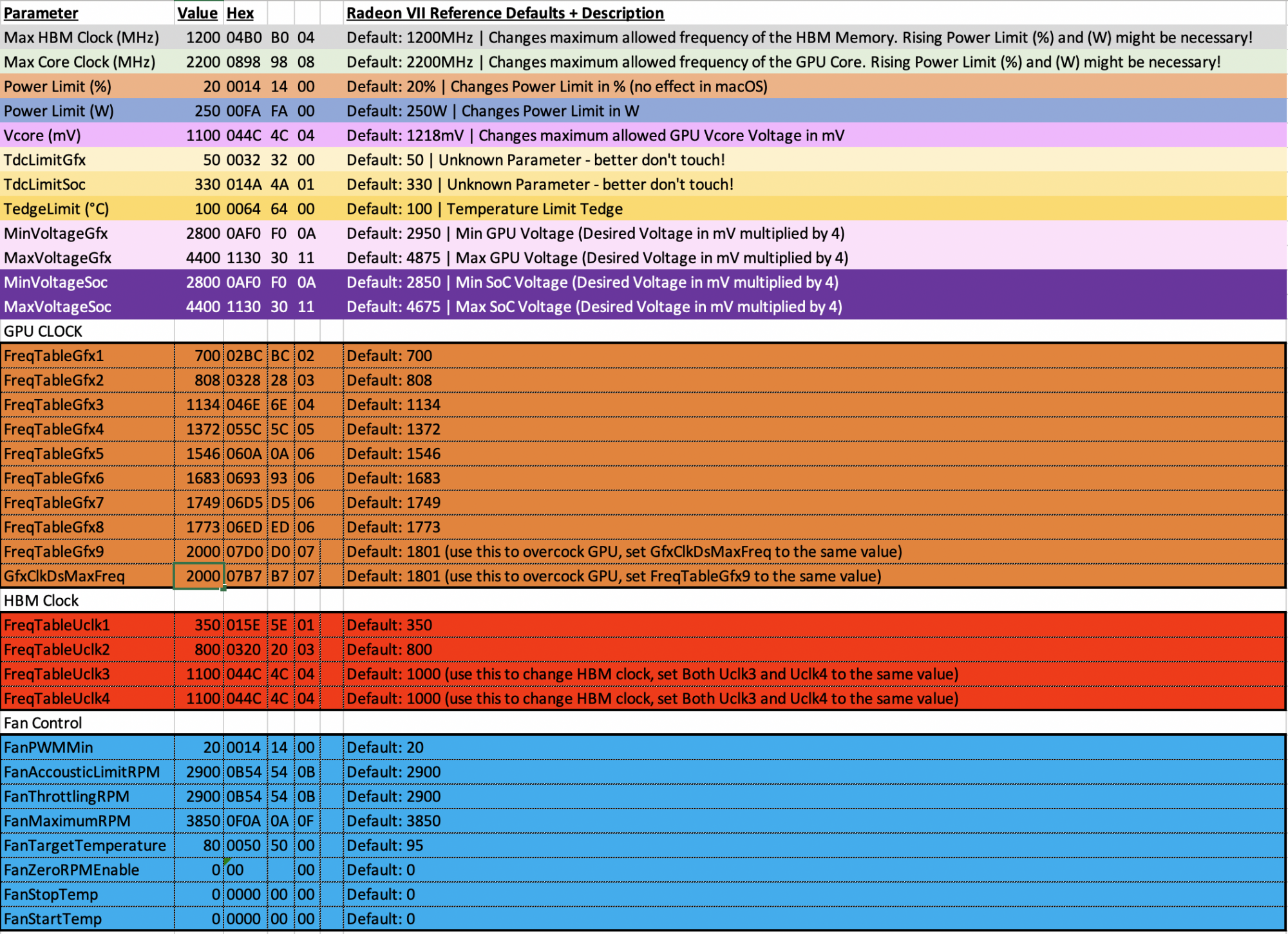

@h9826790 First off, thanks for taking the time to look into this. Really useful.
I haven't tested it yet, but will do so during the holiday. Im on watercooling solution for the card, so I want to push the it beyond the standard 1800mhz. At the moment I am running 1100mv in Windows to run 2000gpu/1100ram, stresstested for 6 months and running stable (I can go lower on MV, but sometimes it reboots my system).
Would I need to add 1110mv x 4, and can I set the clock & mem speed to above?

I also tested OC config on my Radeon VII. This parameters works. Basically same as yours. 2000/1100MHz @1100mV.

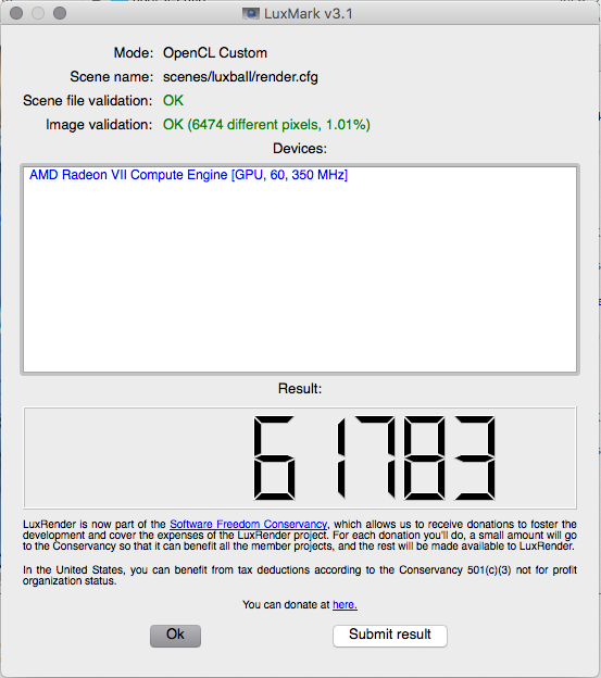

The most extreme OC on Radeon VII I know so far is 2250MHz @1300mV

Ahh nice - thank you so much, so I can use these. I think I will set max gpu 2000 and mem 1100 (they are 2200 / 1200 on the sheet). 2250 is a big OC.. but 1.3mv - I wouldn’t dare, even doing benchmark.
