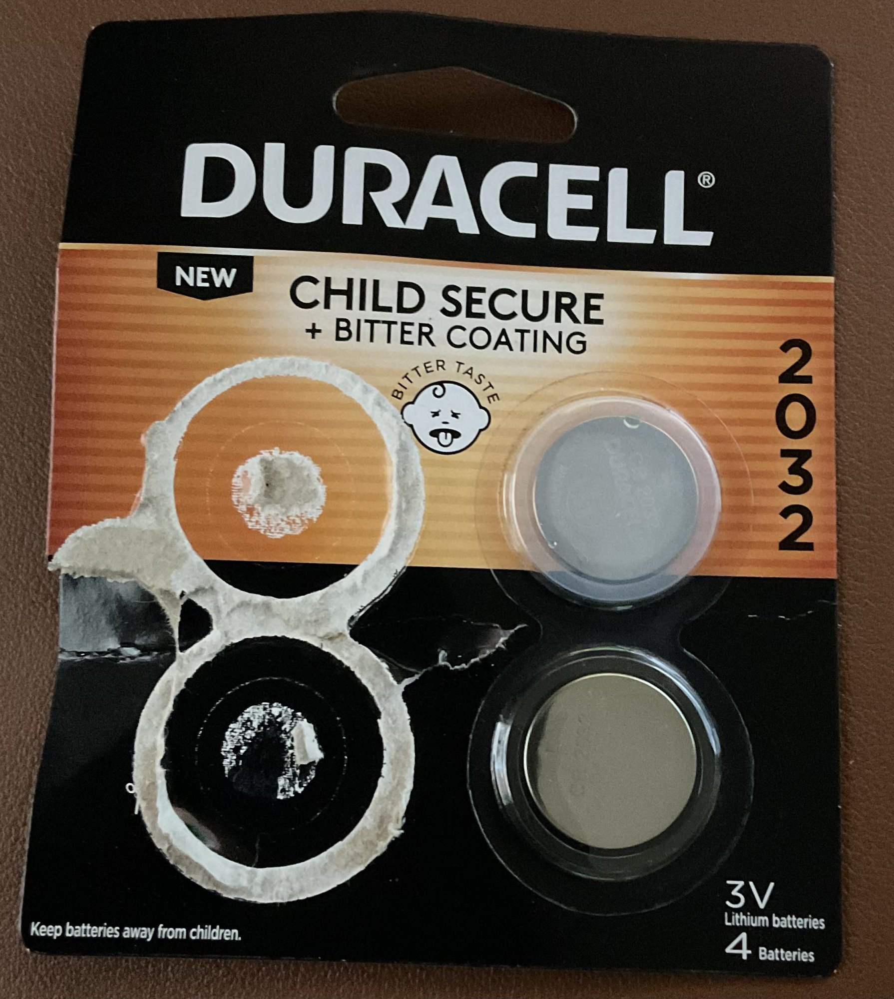

If you try to replace your AirTag battery with one of Duracell’s premium coated “Child Secure” 2032 batteries, good luck. Because I couldn’t get them to work. I tried 2 different batteries and neither would work. I popped the old battery back in and it immediately sprang to life. The old battery is just low, not dead yet.
Anyway, if it works for you, let me know. But I don’t think these AirTags like whatever coating is applied.

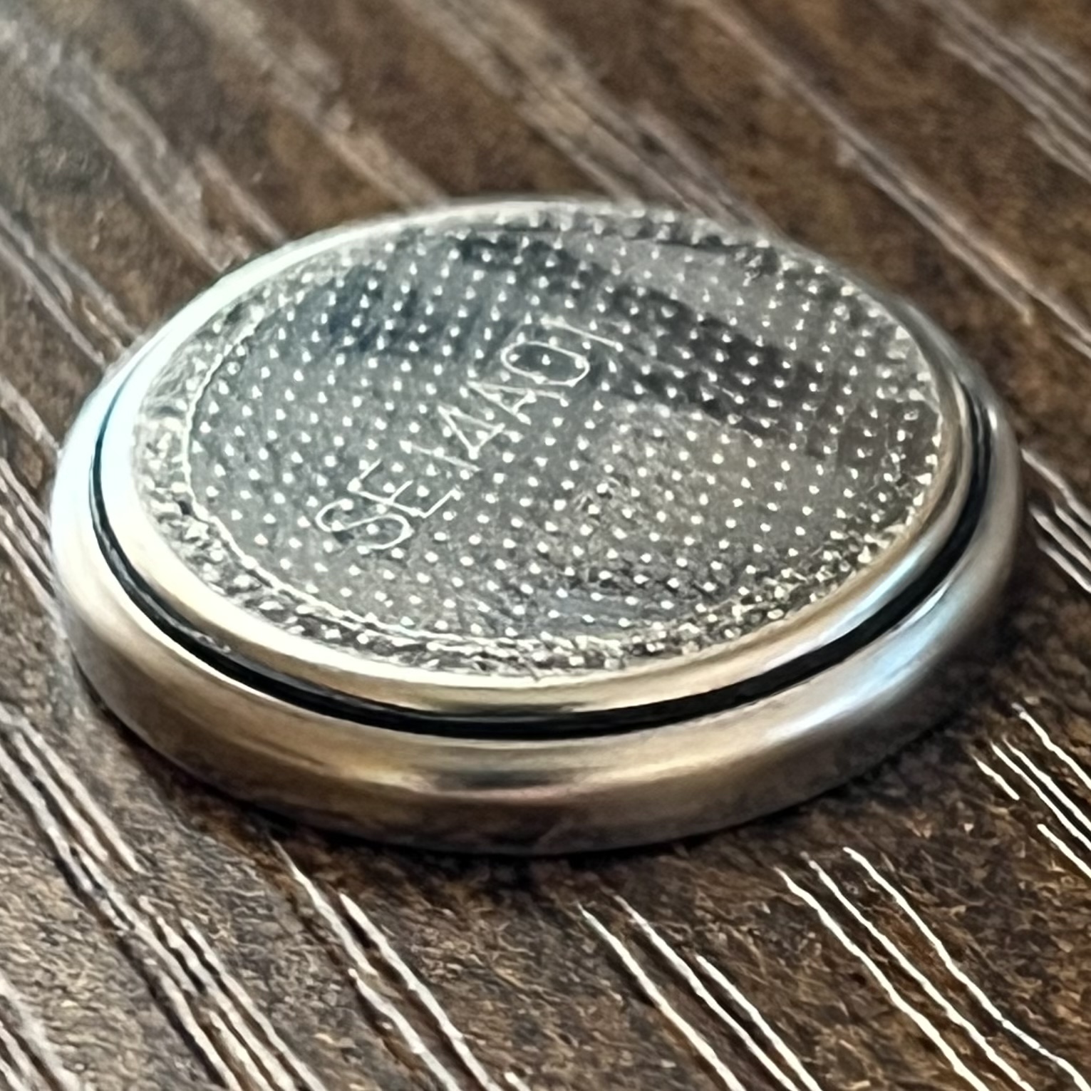

You did peel off the adhesive insulator that's on the opposite side to the side shown in the photo you posted? View attachment 2035621
Ha! Yeah, I’m sure. However, the Duracell coated batteries don’t have that covering.

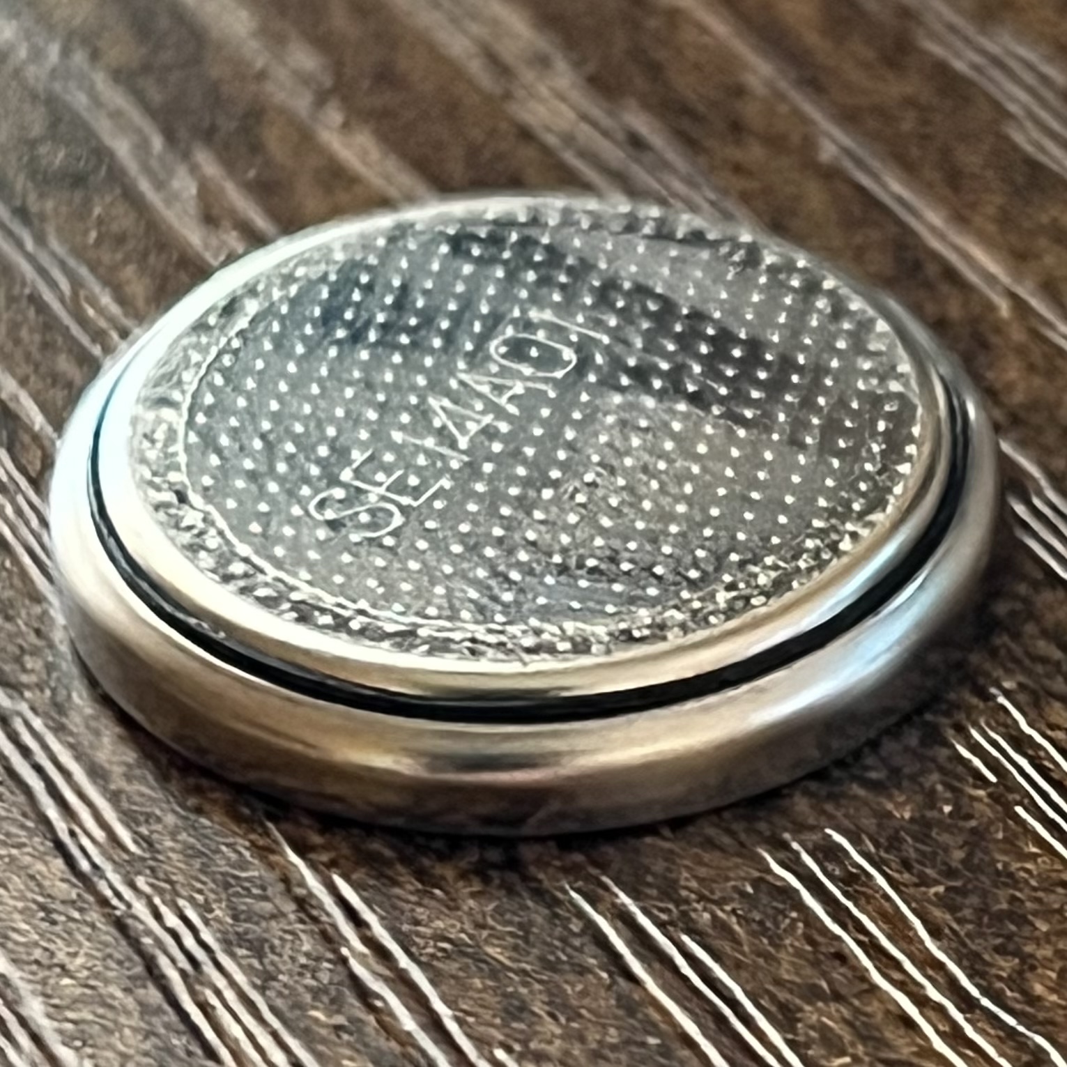

The bitter taste comes from an almost invisible clear adhesive that is applied on that side. I had a hard time even getting a photo where it could be seen.
I tried to remove the bitter adhesive with a razor blade and tweezers but I had no luck. It’s almost impossible to get off.
Here’s a closeup photo of the bitter adhesive. It’s not meant to come off and even if you try, you can’t.

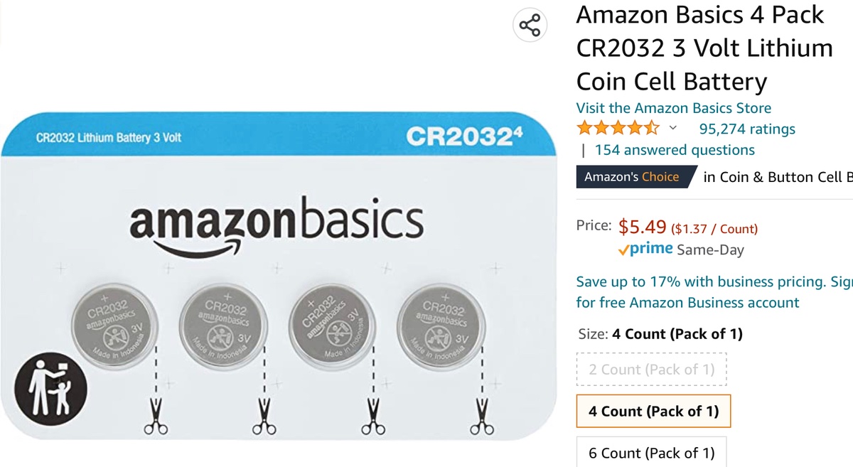

Yeah, that would probably work with about 15 minutes of effort. But I preferred to just spend the $5.50 on another set that was compatible. I bought these off of Amazon and they worked just fine.
Was about to ask if these would work and got my answer. ordering now.

Ah, good to know. I was kinda wondering what I was gonna do with these premium Duracell 2032’s that cost me $12 at Lowes Hardware. The more I think about how expensive they were, the more motivated i am to make them work. I’m gonna get my Dremel out and use a steel wool attachment to rub off that coating.

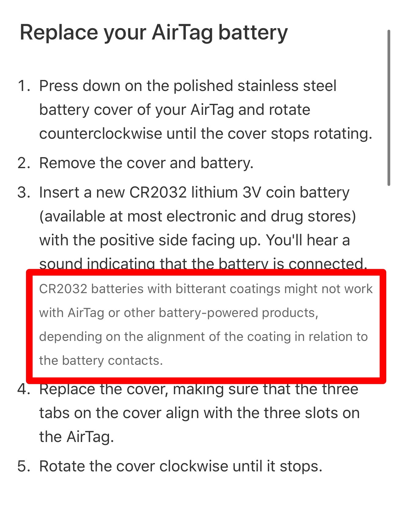

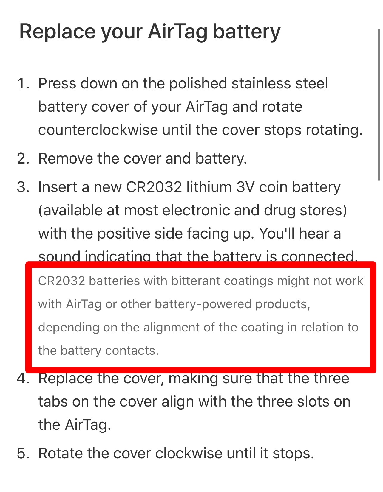

It has to do with where Apple put the metal contact for the negative side of the battery in the AirTag, near the edge. That happens to be where Duracell is putting the bitter coating, and leaving the center open. (You can see the bitter coating ring in one of the OP's pics.) Most other devices have the negative contact in the center of the battery, not off towards the side like Apple did.

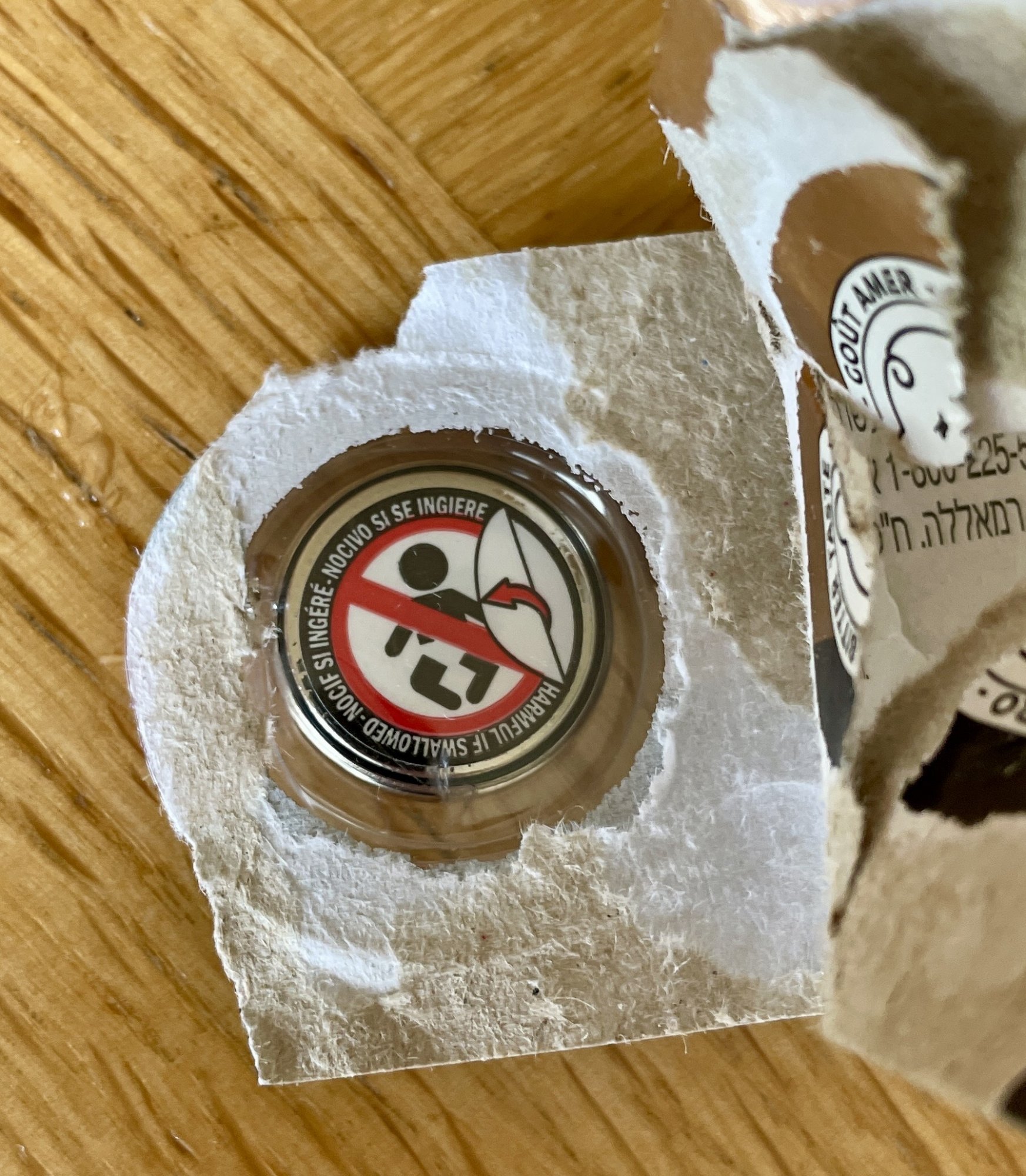

I bought some of these today, went to about 4 different places until i found the 2032's, but i'd forgot about this thread.
When i got the battery out my heart sunk a little as the packaging was not as in your face as the OP's, a tiny little baby head in the corner. Anyway i peeled the sticker off the back and put it in and it didn't work at first. Took it out and tried again and it worked....and yes..i did lick it...disqusting 😄
