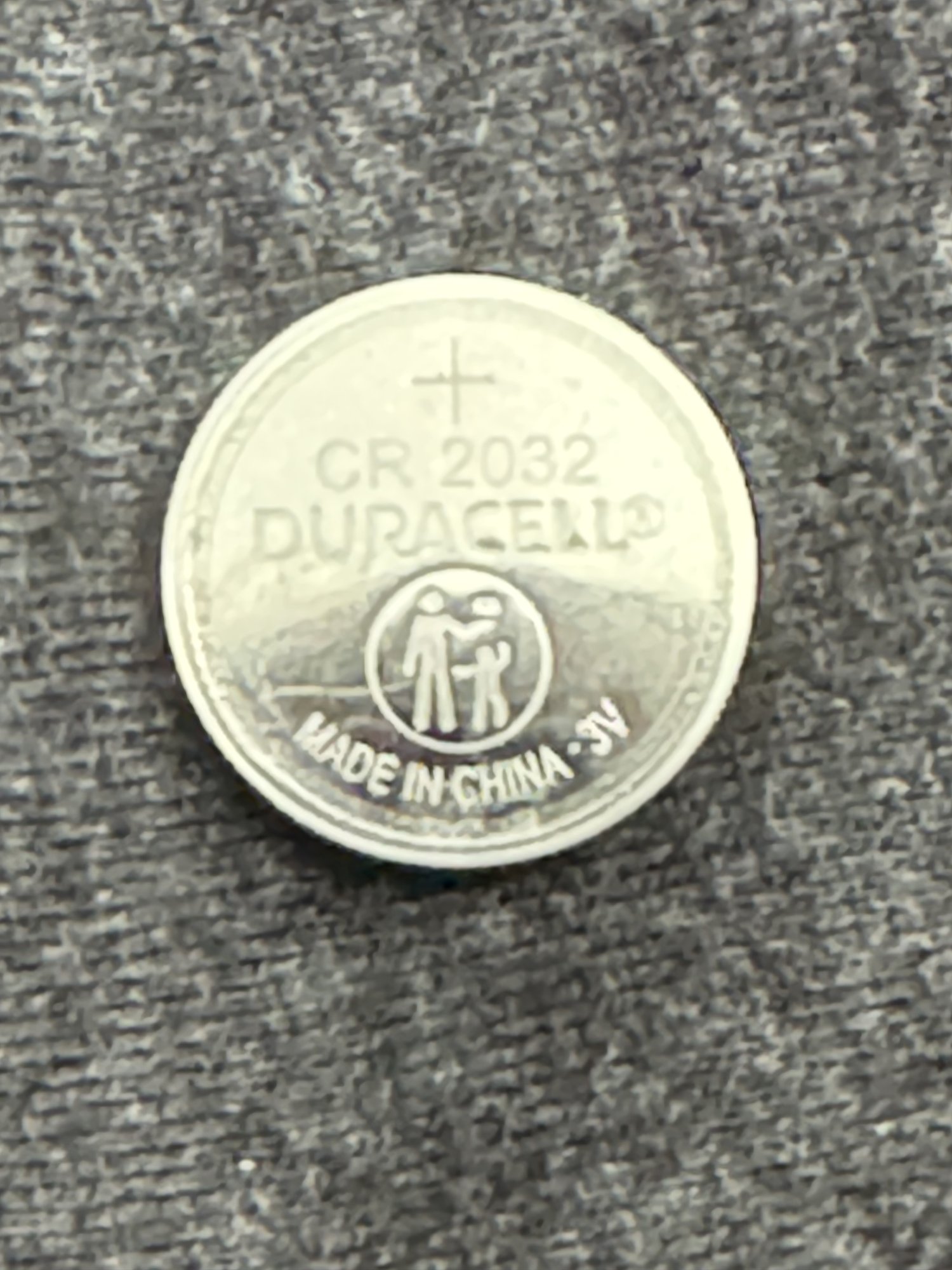

Also, Duracell changed the placement of the bitterant. As you can see in the picture the bitterant ring is now located on the positive side instead of the negative, so there’s no need to jump through hoops to remove it or avoid it. All of my AirTags came with Duracell batteries with this updated placement and I’ve also verified the placement on batteries with the “compatible with AirTag” label on the retail packaging.
