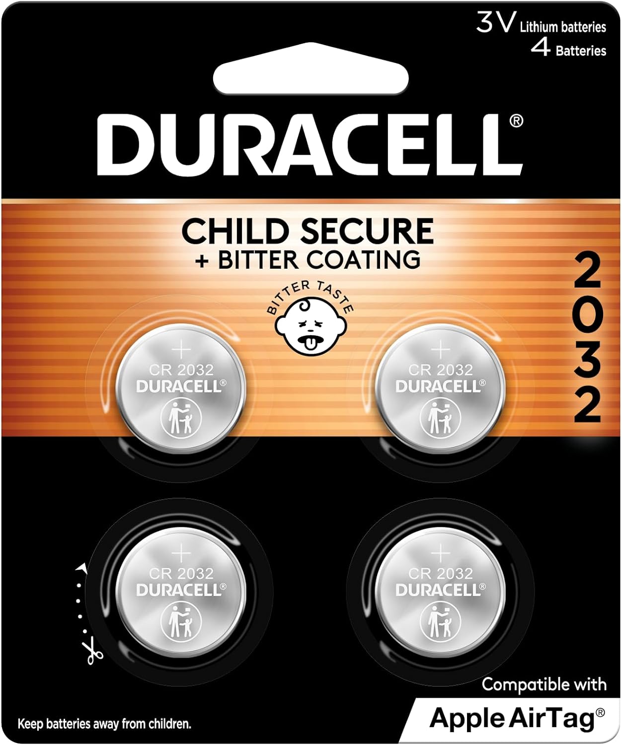

While on vacation, I needed to replace the batteries in 2 of my airtags. I bought a set of batteries, took them back to the hotel, and was perplexed that I could not get either airtag to work with the new batteries. After retrying the old batteries, i concluded the batteries must have been old and depleted.
So I went to a little further towards civilization to a CVS. Two more batteries. Same result.
Some searching here, lead me to learn that some brands of coin cell batteries have a bitterant added to them that insulates the battery where the airtags make their connection. I went to check, and sure enough. There is a small ring of something on the outer edge of the negative side.
I’m now $30 in on these tourist priced batteries, so I am determined to find a way to make them work. I saw some mention sanding or scratching the coating off. I tried using some scissors to scrape along the edge, but no dice.
Then I realized, its most likely water soluble, right? You need to the bitterant to dissolve on the tongue to be effective. Sure enough, if you take a damp paper towel and rub the negative side for 15 seconds or so, it comes right off. Popped them into the airtags and they worked perfectly.
Hopefully this helps someone else.

Thanks a lot! After trying with a new Duracell I thought I was going crazy . Then I found this
Instead of licking, you can also use your spit on a Kleenex and don't electrocute your tongue 😄 and it's instantaneous
Saliva has enzymes that work faster than water to dissolve the bitterant

If you try to replace your AirTag battery with one of Duracell’s premium coated “Child Secure” 2032 batteries, good luck. Because I couldn’t get them to work. I tried 2 different batteries and neither would work. I popped the old battery back in and it immediately sprang to life. The old battery is just low, not dead yet.
Anyway, if it works for you, let me know. But I don’t think these AirTags like whatever coating is applied.
I had the same problem. All I had to do is clean off the battery with rubbing alcohol. Then it worked. A friend of mine had a scales and we put a brand new battery in and it didn’t work. Then I cleaned off the battery with alcohol and put it back in and it worked.

I got the Costco packs of these Duracell with these coatings. All you have to do is use isopropyl alcohol - the higher the concentration, the easier it is to remove. Spray it on the coin or drench it up well. Use a microfiber cloth and just wipe the cell thoroughly. I recently replaced two AirTags with two of these coated batteries and it didn't work and I thought the batteries were bad until I realize they are the coated type. So after wiping thoroughly with the alcohol it worked flawlessly.

Duracell with updated packaging should work.
