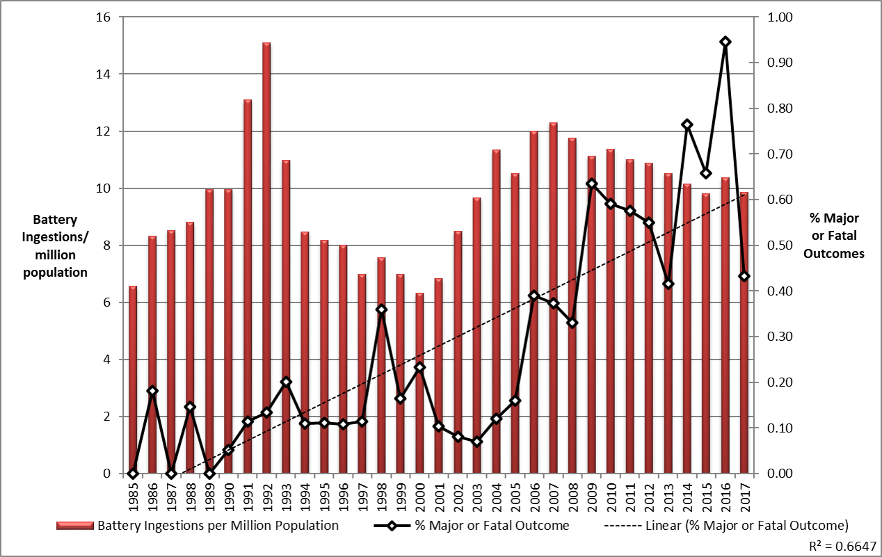

Parody? I’m not sure. Battery ingestion fatalities are rare (single digits per month), but then so are the cases of anyone giving a damn about the coatings on batteries. Here’s a whole lot of stats, but one you should be worried about - by far the most commonly ingested batteries are those intended for hearing aids…
