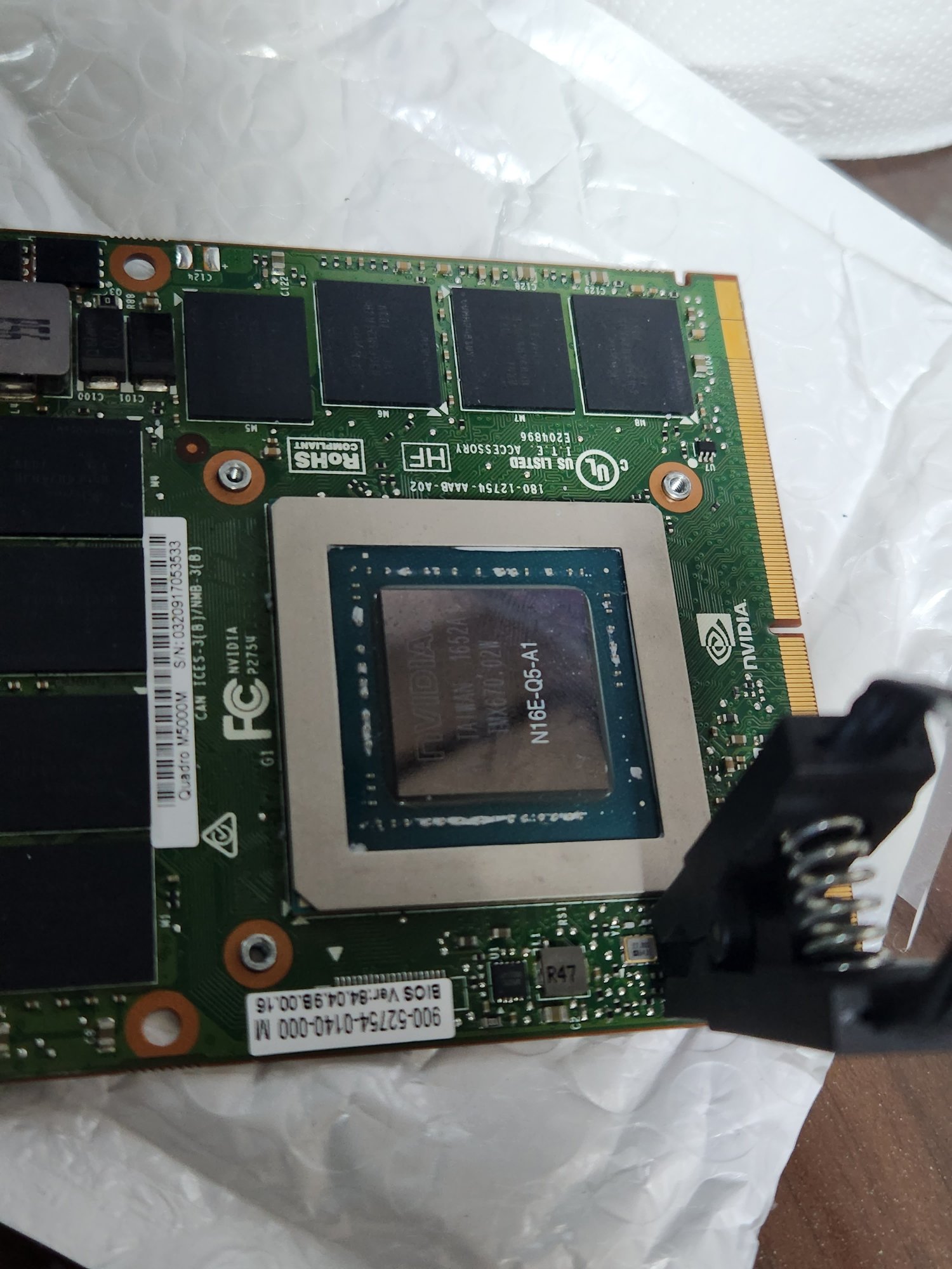

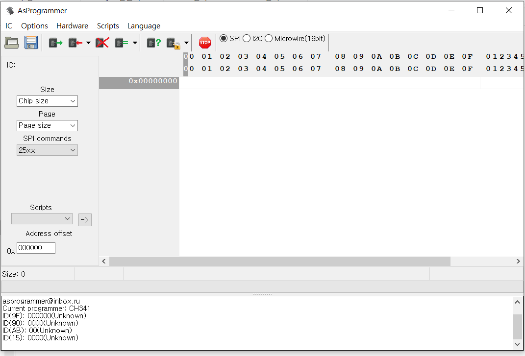

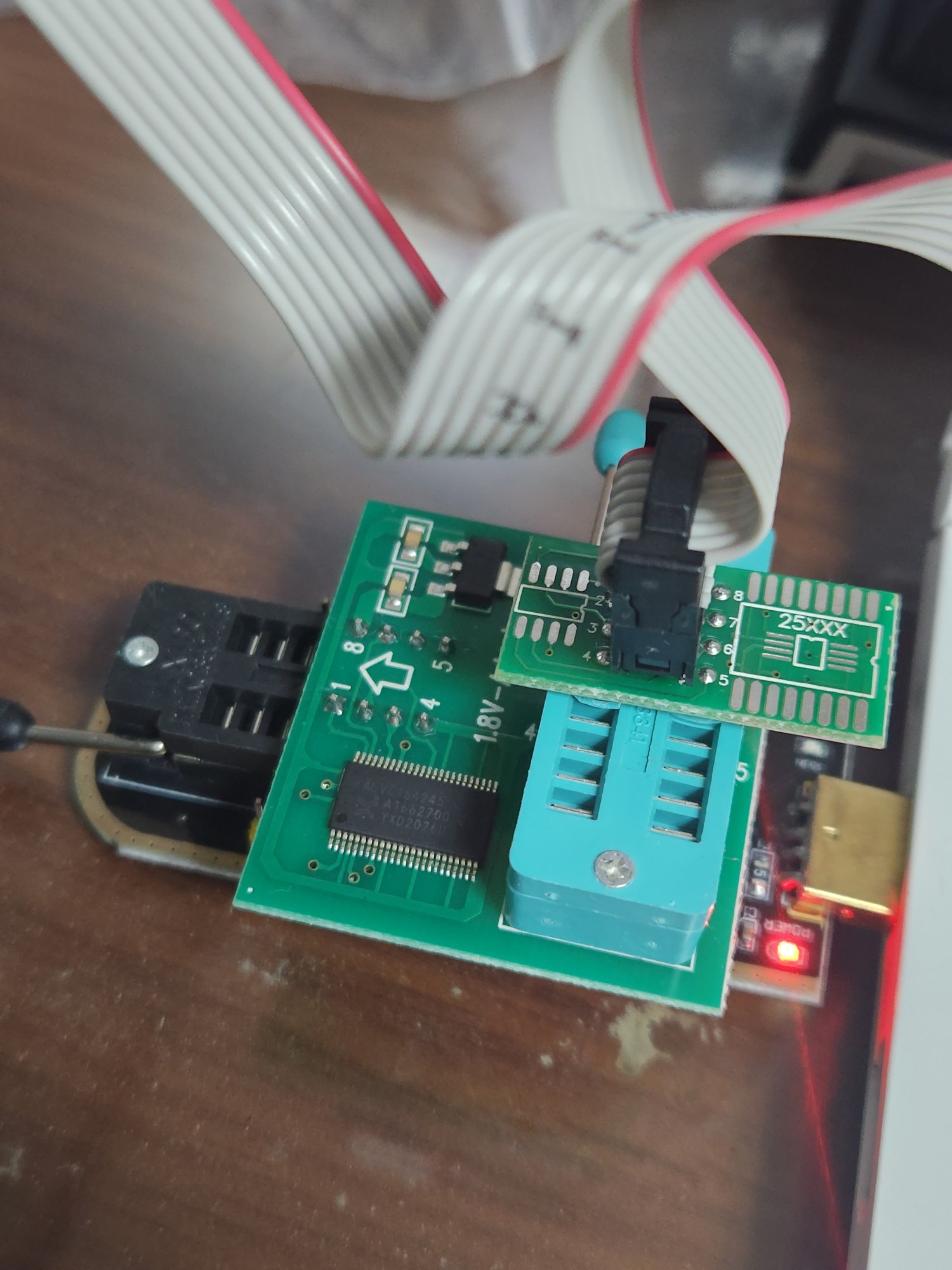

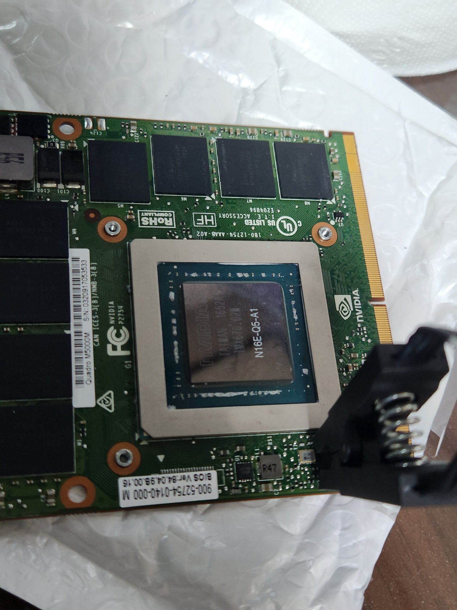

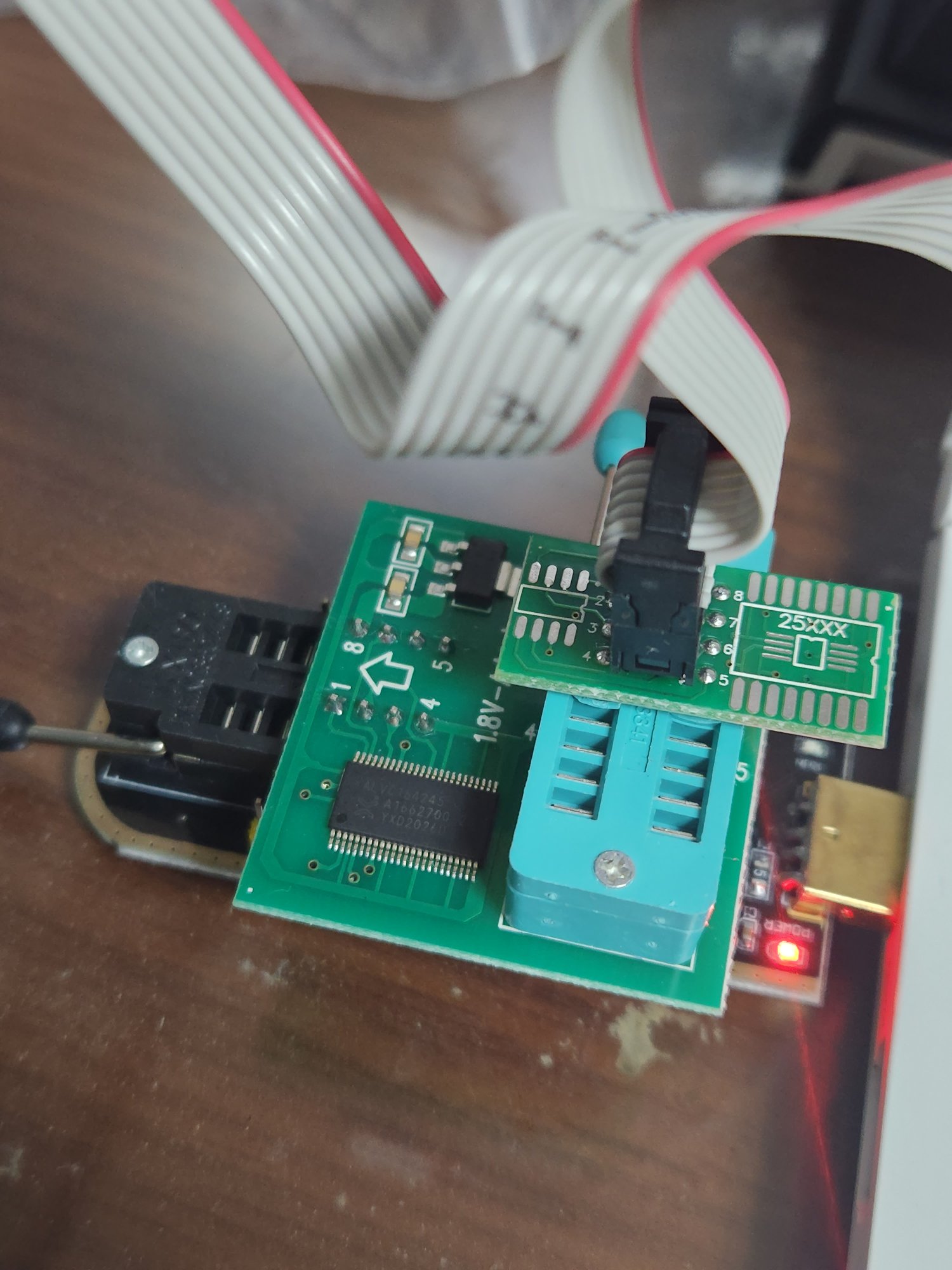

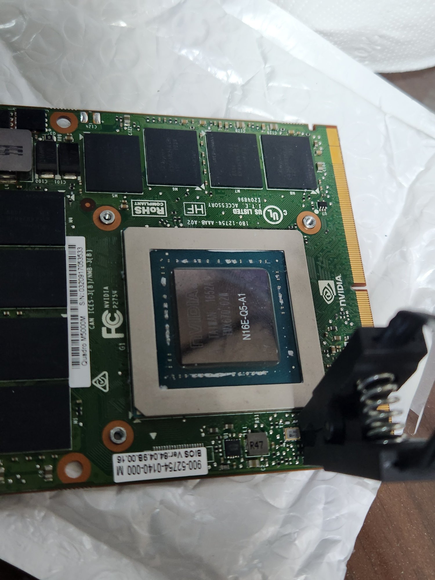

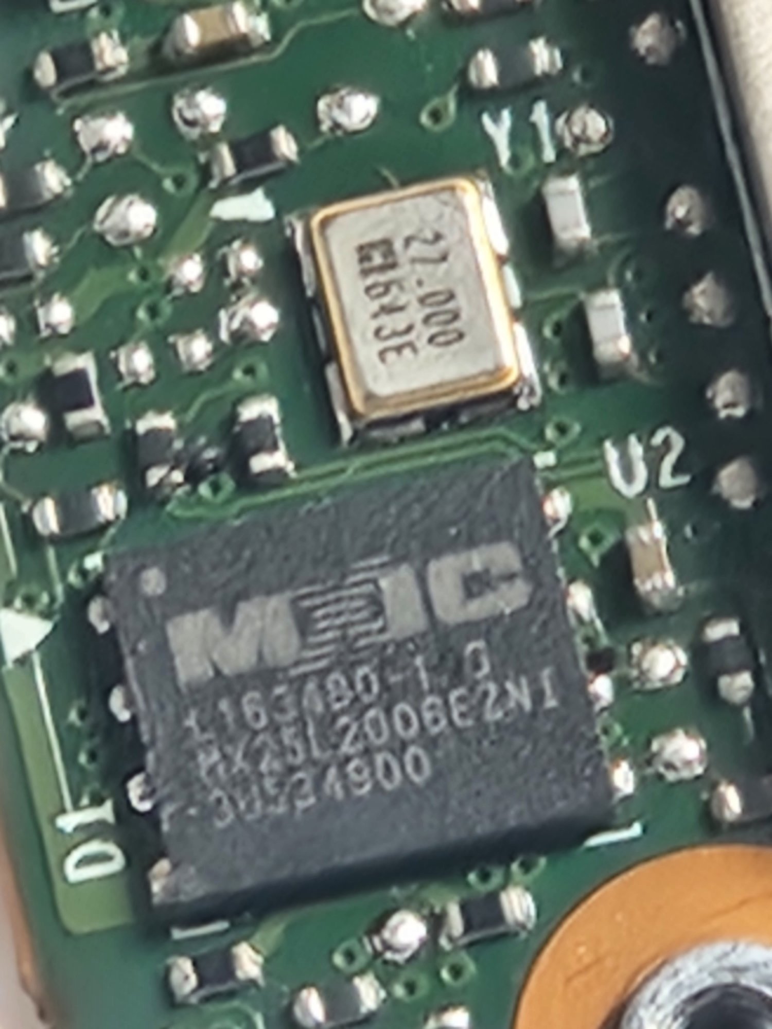

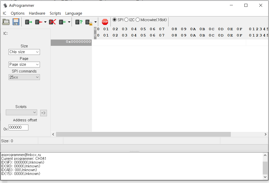

Hi,

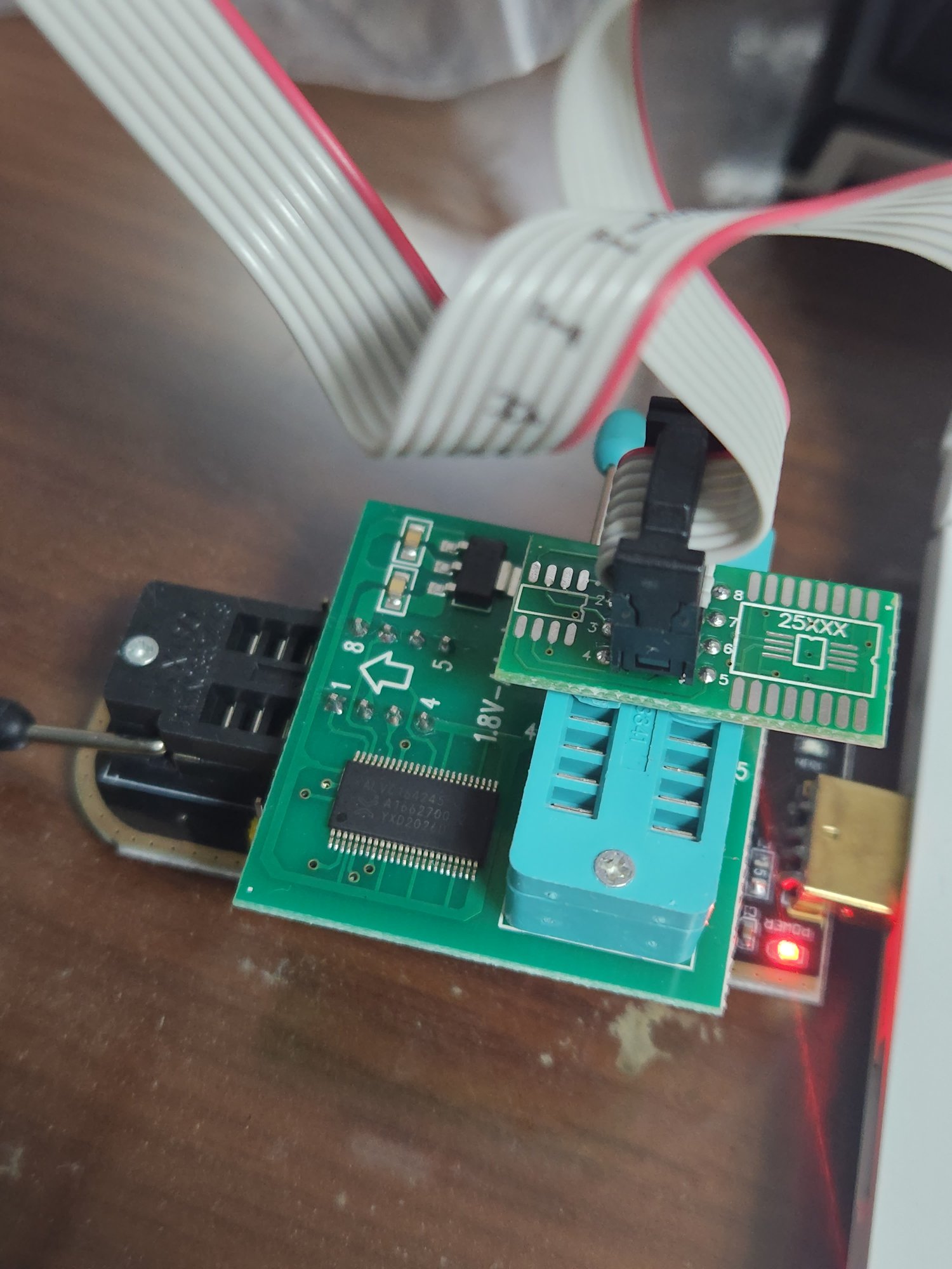

New to this Bios update via CH341A!
I saw Assprogramer couldn't detect the flashrom correctly like the attached pic. If I specify the IC name manually and read it, I got all the zero or ff bytes.
Am I doing something wrong in assembling Ch341a, 1.8v adapter and clipper?
Btw, I was doing it for M5000M.
Thank you,
Nam

Hi,
Thank you,
Nam
If your Quadro M5000m was from an old HP Workstation laptop, it's normal. I guess.
I'm not sure if it's from HP or Dell since it's 2nd hand one from a guy bought from Aliexpress.
So you mean if it's from HP then normally the flashrom is empty and I can overwrite it with custom bios I downloaded from here?
I don't know.
In my case, I installed the MXM card to the iMac and flash with the GRML Linus USB.
I didn't care whether there was any data inside the EFFROM chip. I just overwrote it.
Yes, the vbios I used from this thread.

Reinstall the driver again or another normal driver.
Check the contact again, the program should determine in any case !!!

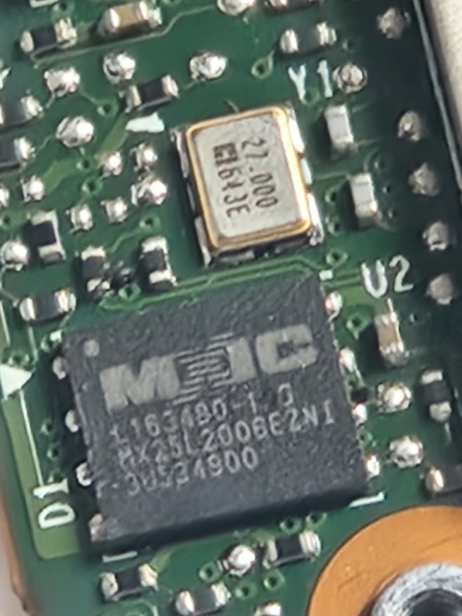

This eeprom is 3.3v and I think you won't be able to clip wson package with ch341a, better try to flash it from windows or linux using patched nvflash for Maxwell.
Ah, damn it.
I didn't know it was Maxwell not Pascal until now. lol. Thank you.
I'd try to flash it from Linux later.
Thanks again.

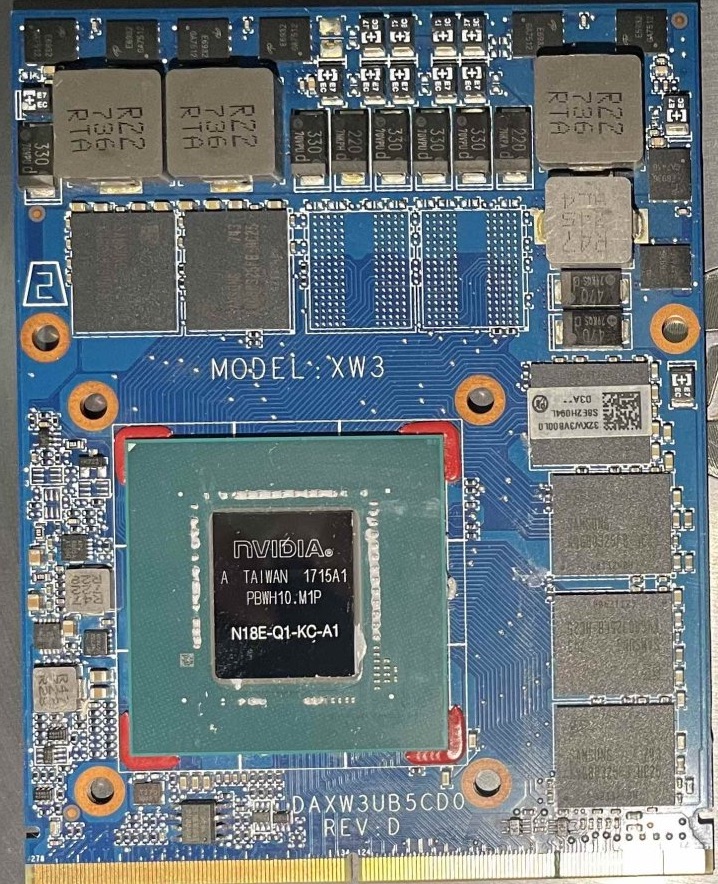

iMac Quadro P3200 rom:
- Enables the internal display.
- Enables GOP boot screen using Opencore.
- Brightness control and sleep/wake work.
- Max GPU clock raised from 1542 to 1594 MHz.
- Max Memory clock raised from 3500 MHz to 4000 MHz.
- Max TDP raised from 80 to 115W.
- Power Limit (%) slider unlocked in Afterburner, to decrease the Max TDP if desired.
- Temperature throttle limits slightly increased.
- NVGI header added for ease of Windows driver install
- External display is enabled and tested on the mini DP closest to USB ports.
Many thanks to @jay508 for help and long time spent testing this card and vbios.
Windows 10 will automatically recognize card and install Nvidia drivers. You can use NVCleanstall if you wish to update to the latest GeForce drivers.
To enable brightness control on Windows you need to manually add the same registry entries as with other Nvidia cards.
Works on MacOS High Sierra with Web Drivers.
GPU clock can be locked to a specific value using the voltage-frequency curve in Afterburner. The curve itself can't be edited (no undervolting possible).
3 pipe heatsink and install with good thermal paste is a must.

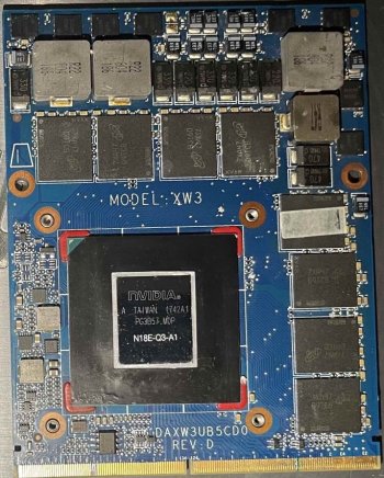

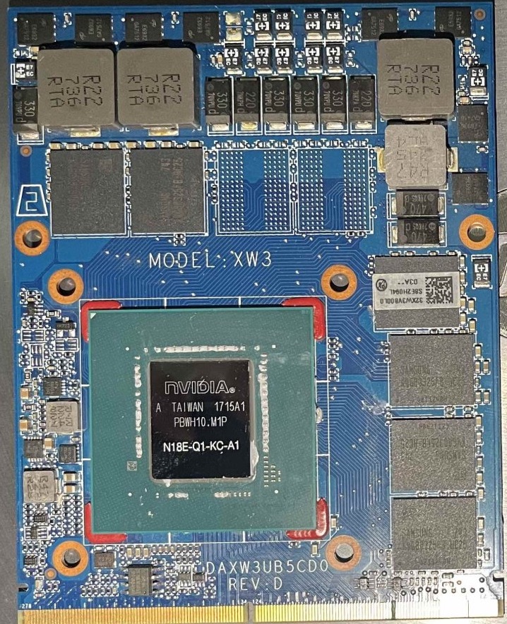

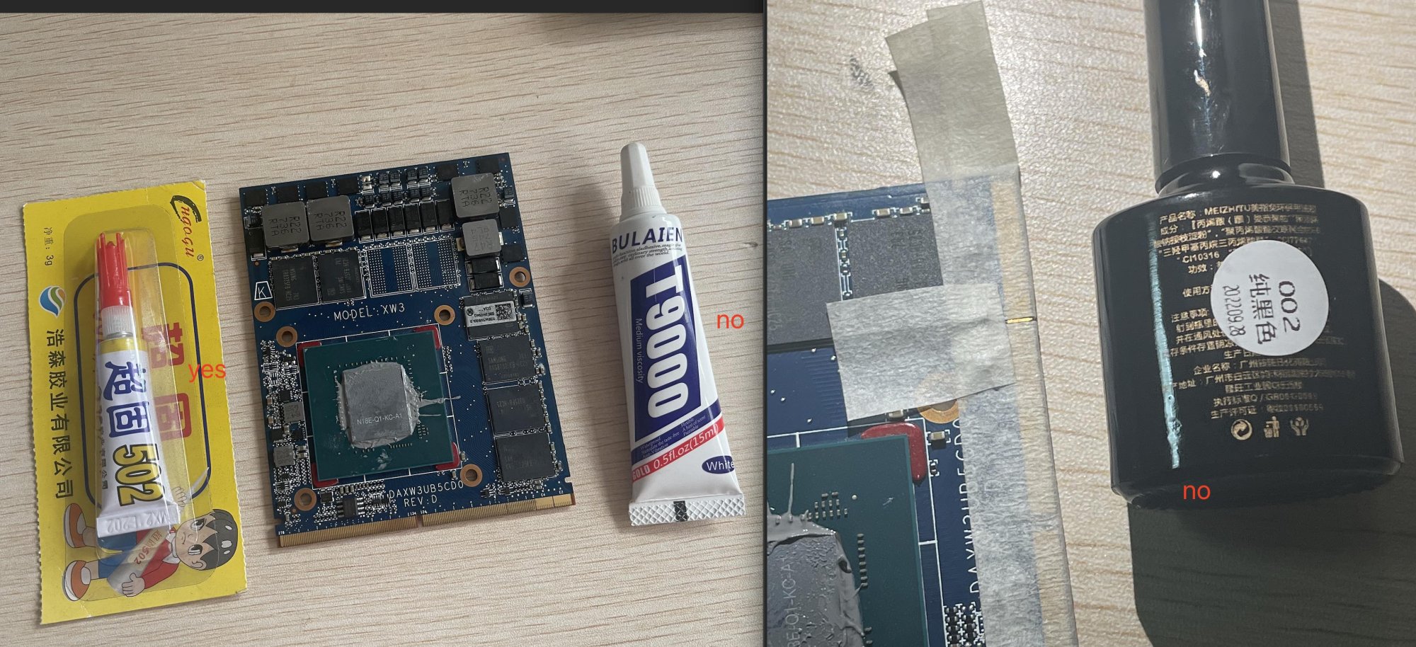

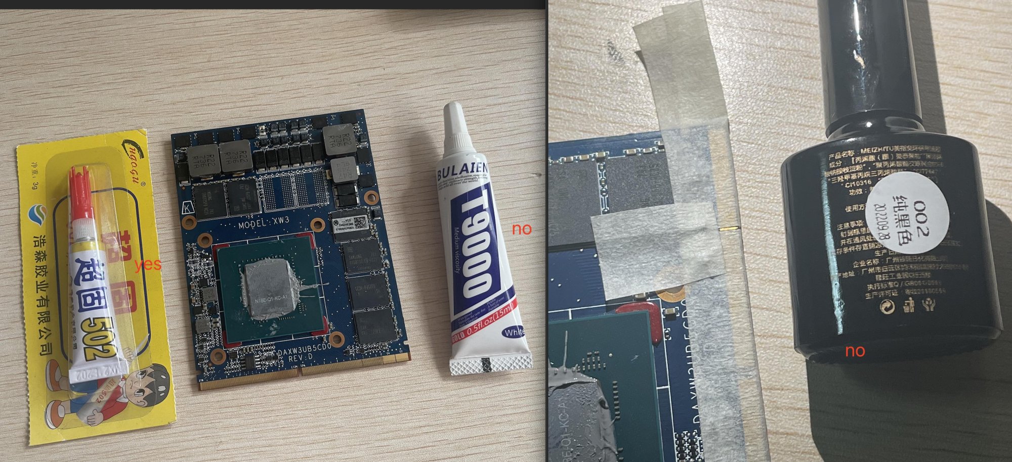

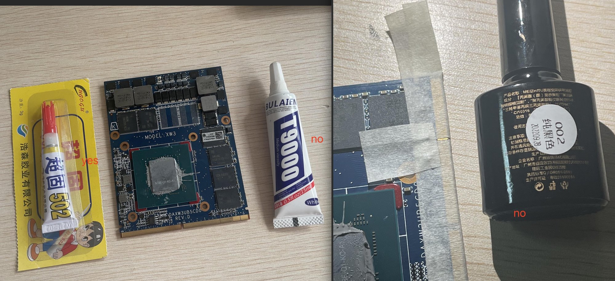

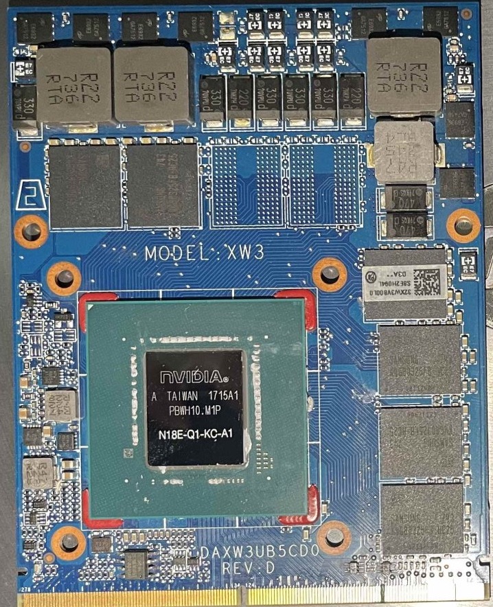

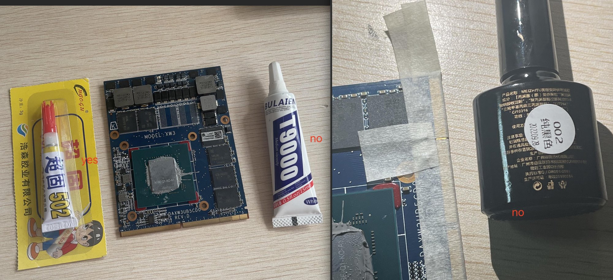

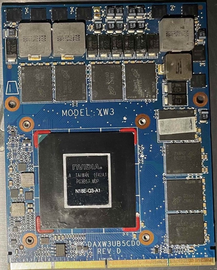

The card we tested (board DAXW3UB5CD0 REV D) needed to apply the smbus isolation trick to work properly on the iMac 12,2. There is a smbus collision that makes the card work at ~50% power if SMB_DAT track is not isolated from the mxm connector. This hack may not be needed for other models of iMac which use different smbus addresses, or other different card pcb revisions..

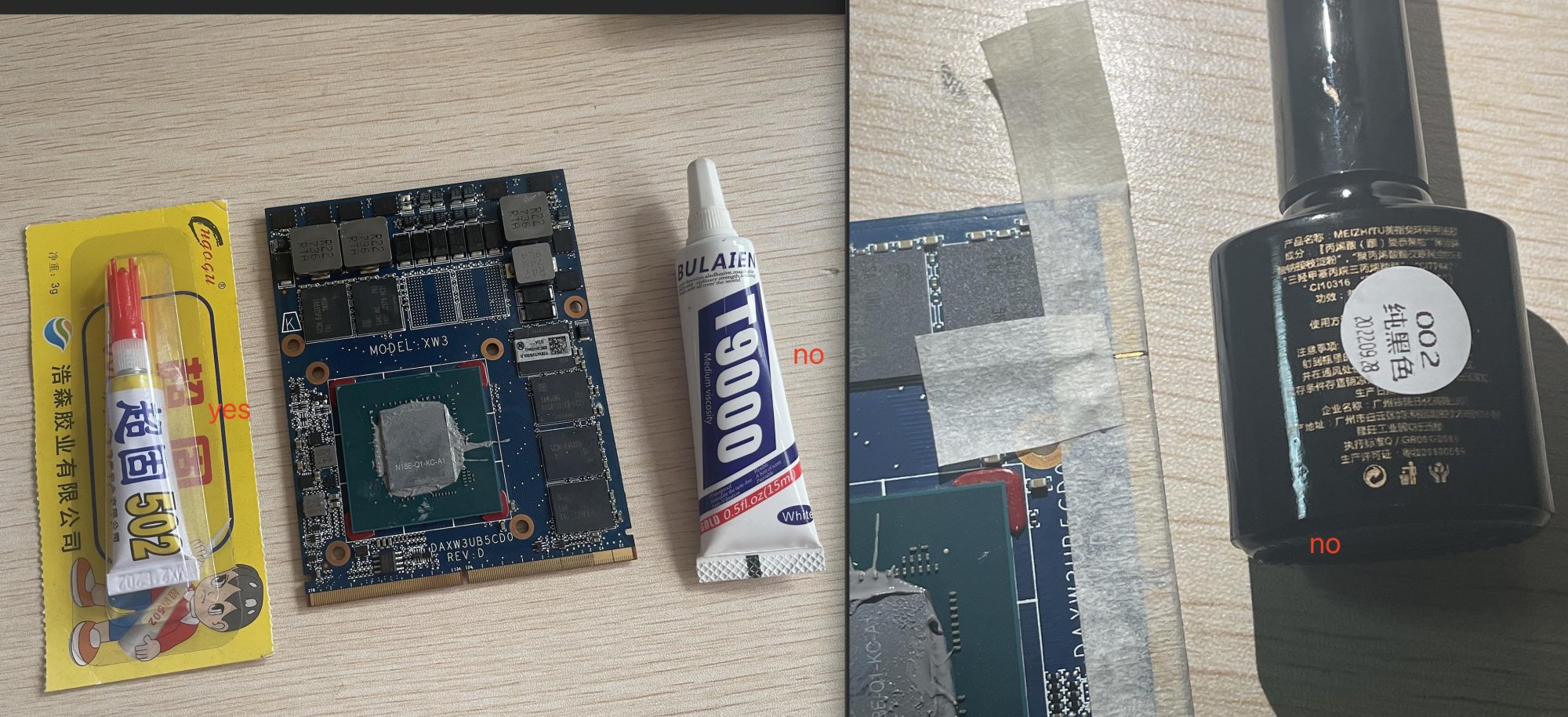

See picture below for how to isolate smbus track, @jay508 tested nail varnish, cyanoacrylate glue and uv curated solder mask to cover track, first two were removed after some insertions/removal of card, but for light use it should be enough.
You must use a hardware programmer to flash this rom on the eeprom chip at 1.8V (nvflash will not work, as digital signature is invalid). Also take into account most cards come without eeprom chip onboard, you have to use a nvflash compatible 4M-bit 1.8v eeprom chip like W25Q40EW / W25Q40EWNIG for the bios (some sellers may offer to solder it for you).

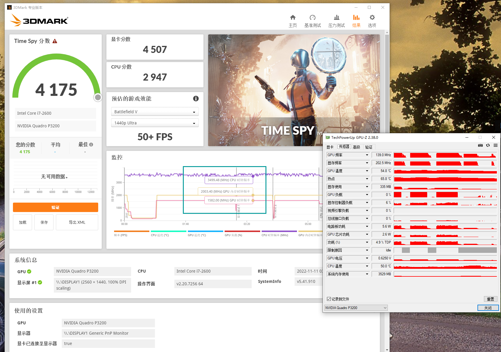

Card performance is great, it performs like an overclocked P4000 at half the price (4500 gpu score on Time Spy).
Display tables changes based on @Santa's Little Helper work for the P3000/P4000 cards.

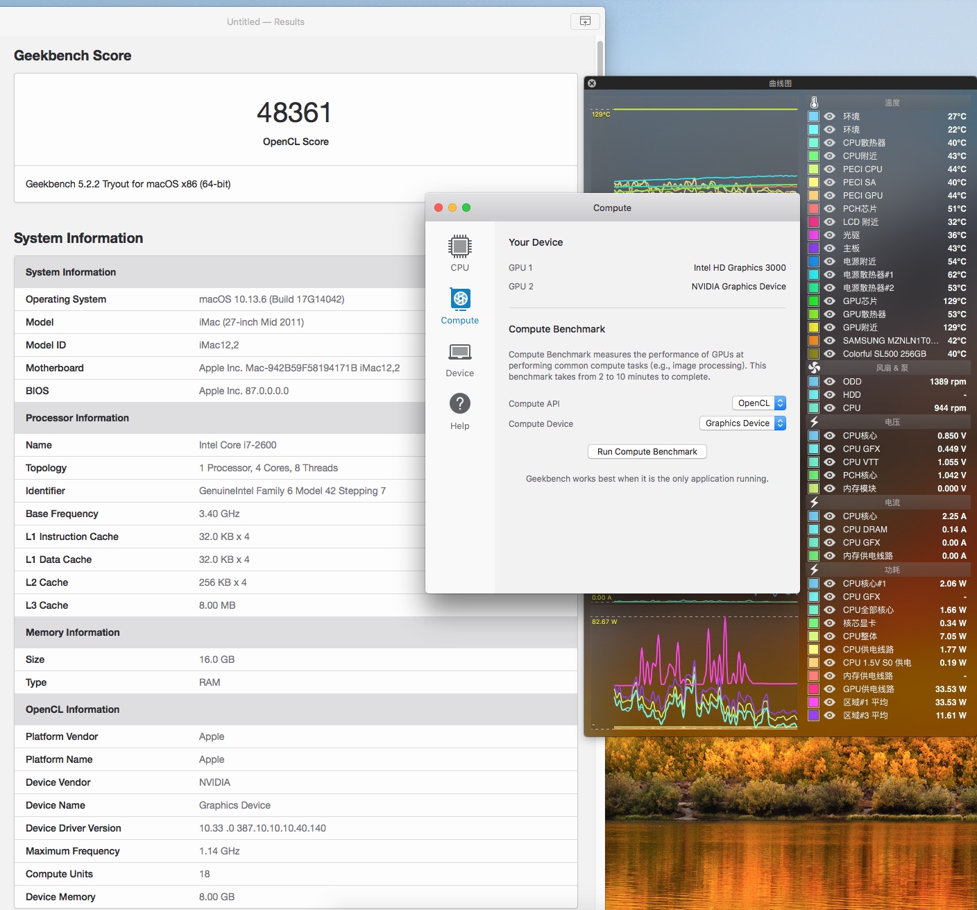

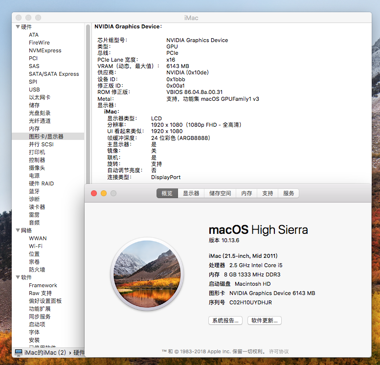

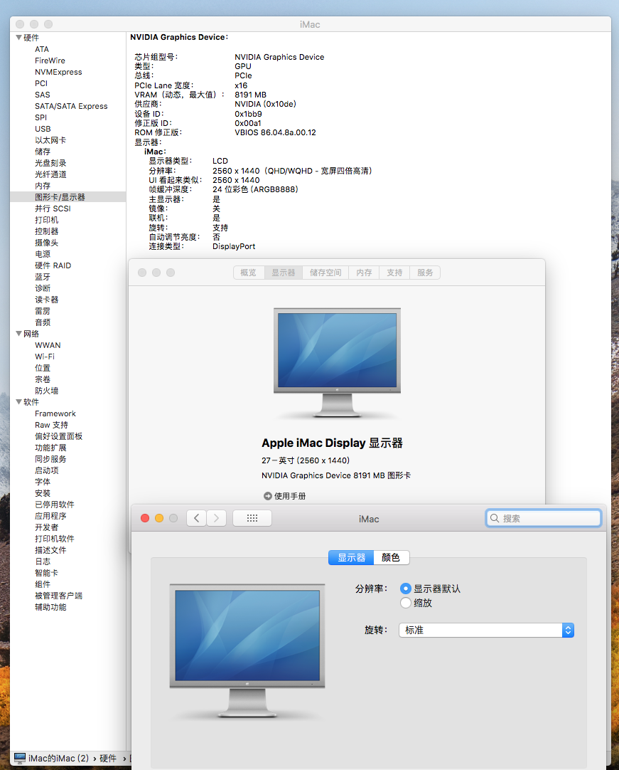

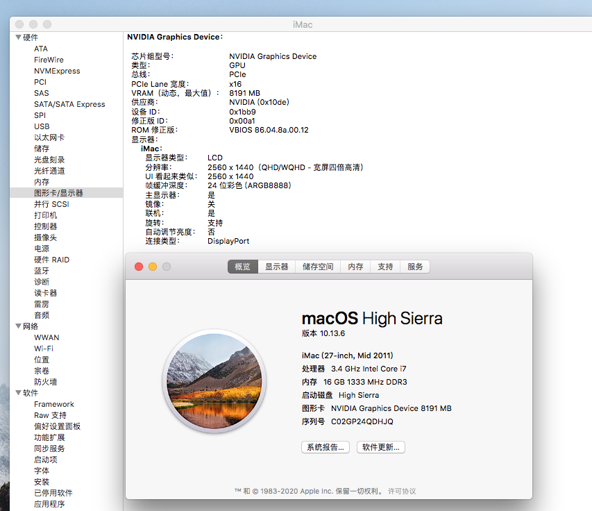

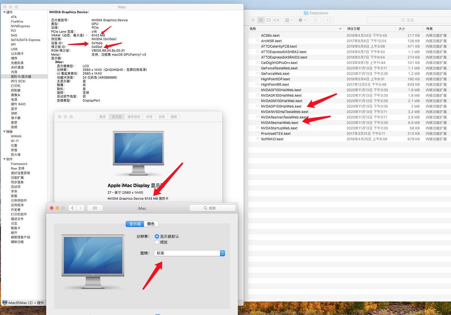

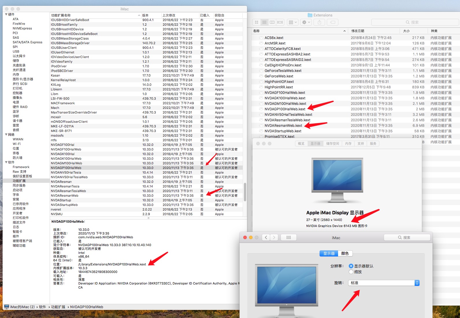

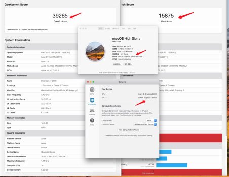

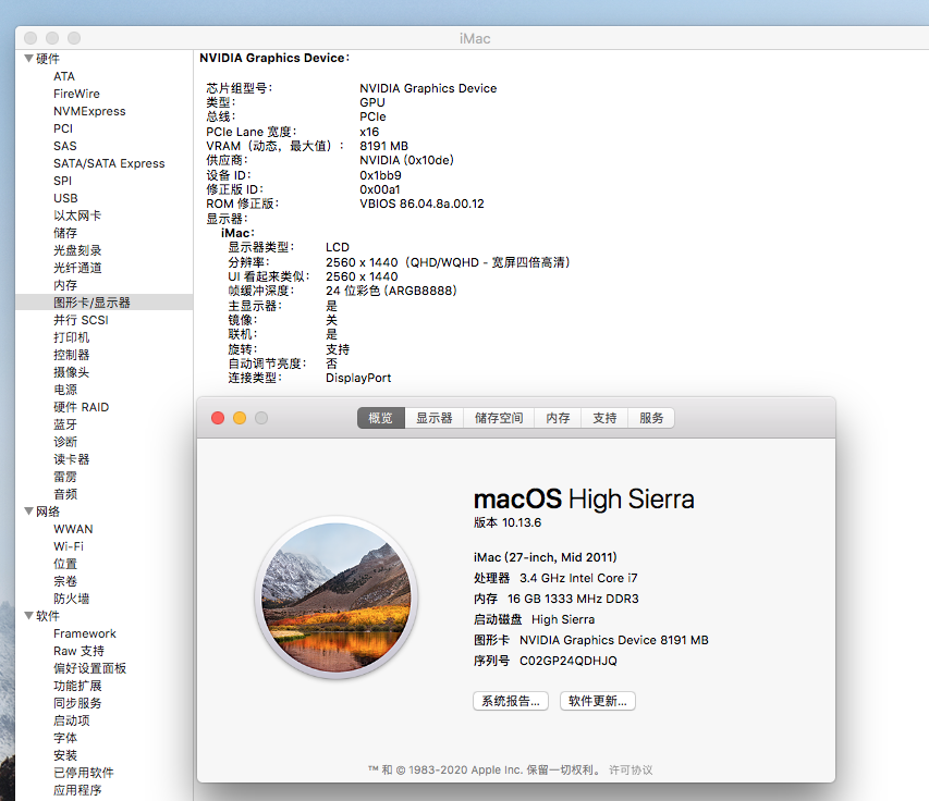

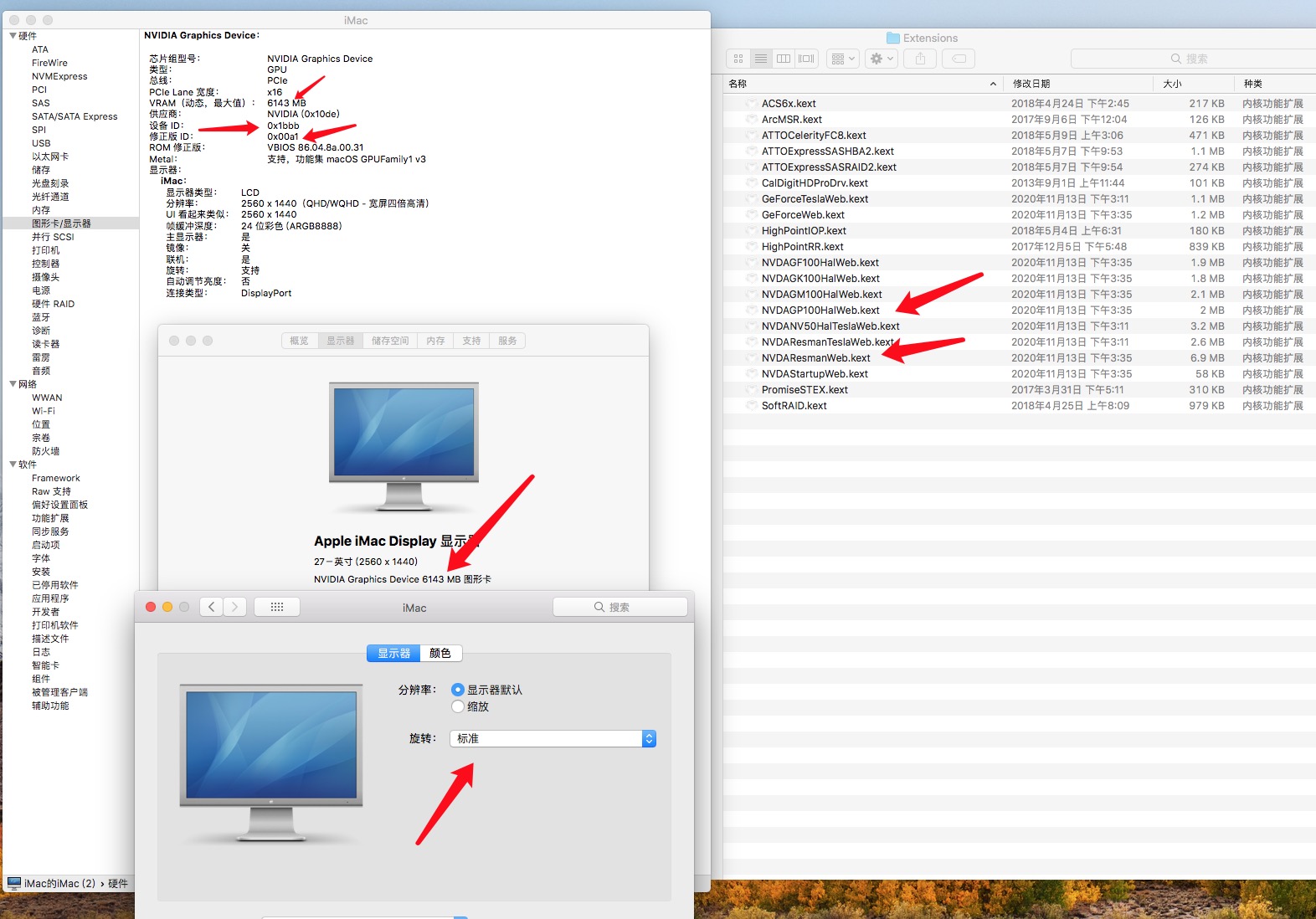

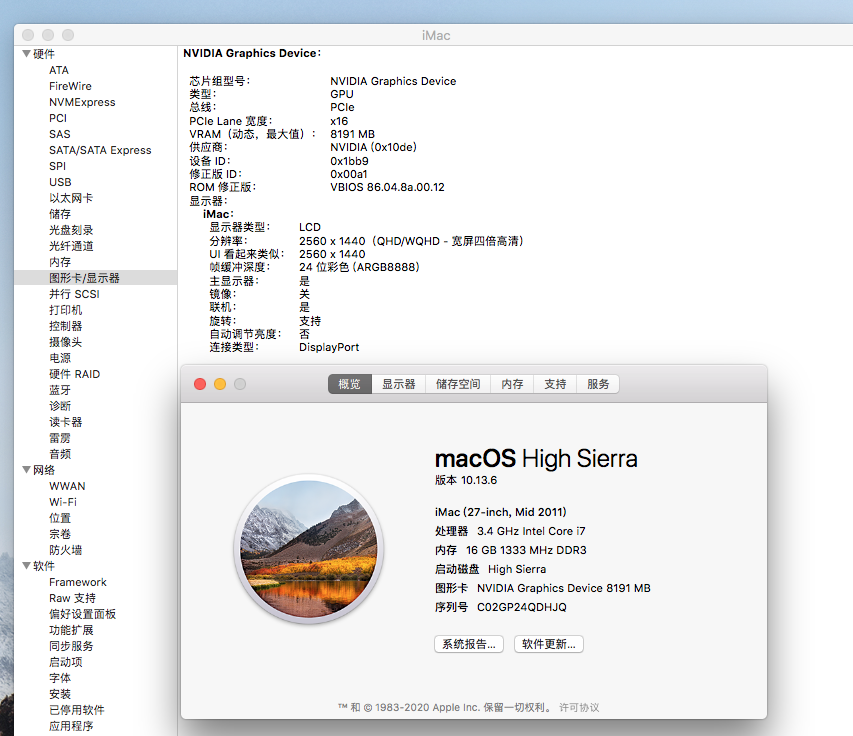

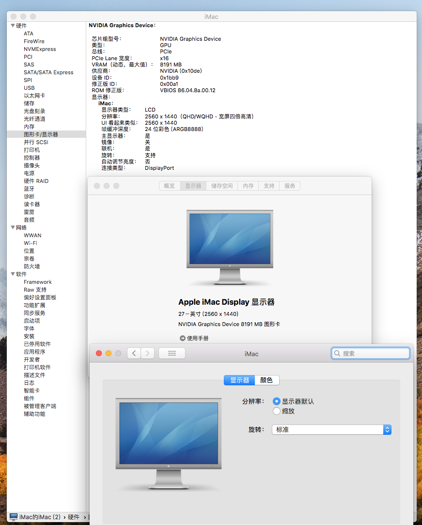

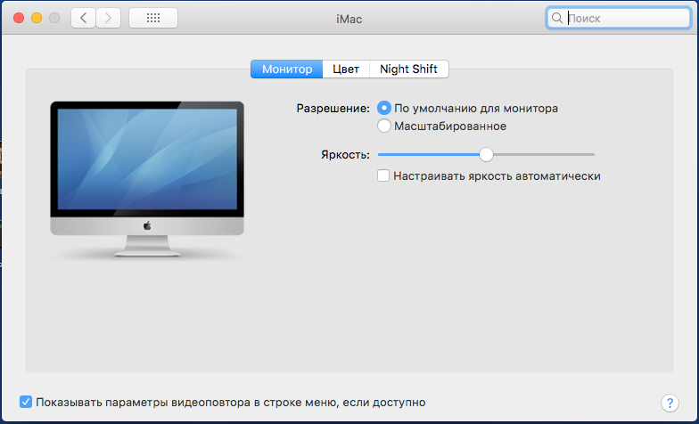

I checked the driver directory to load the driver.
Is there any way to try to modify the driver to add id to support brightness adjustment for macOS system.
Reactions: idenis42

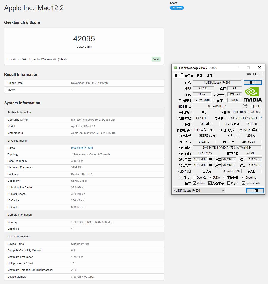

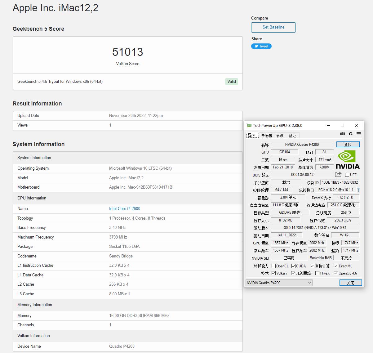

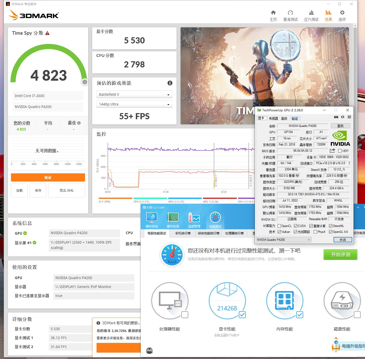

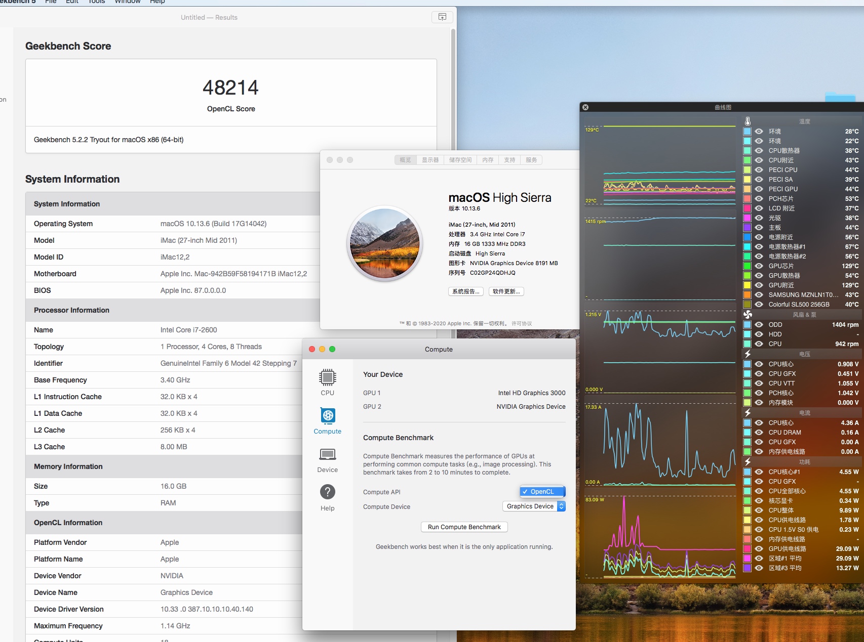

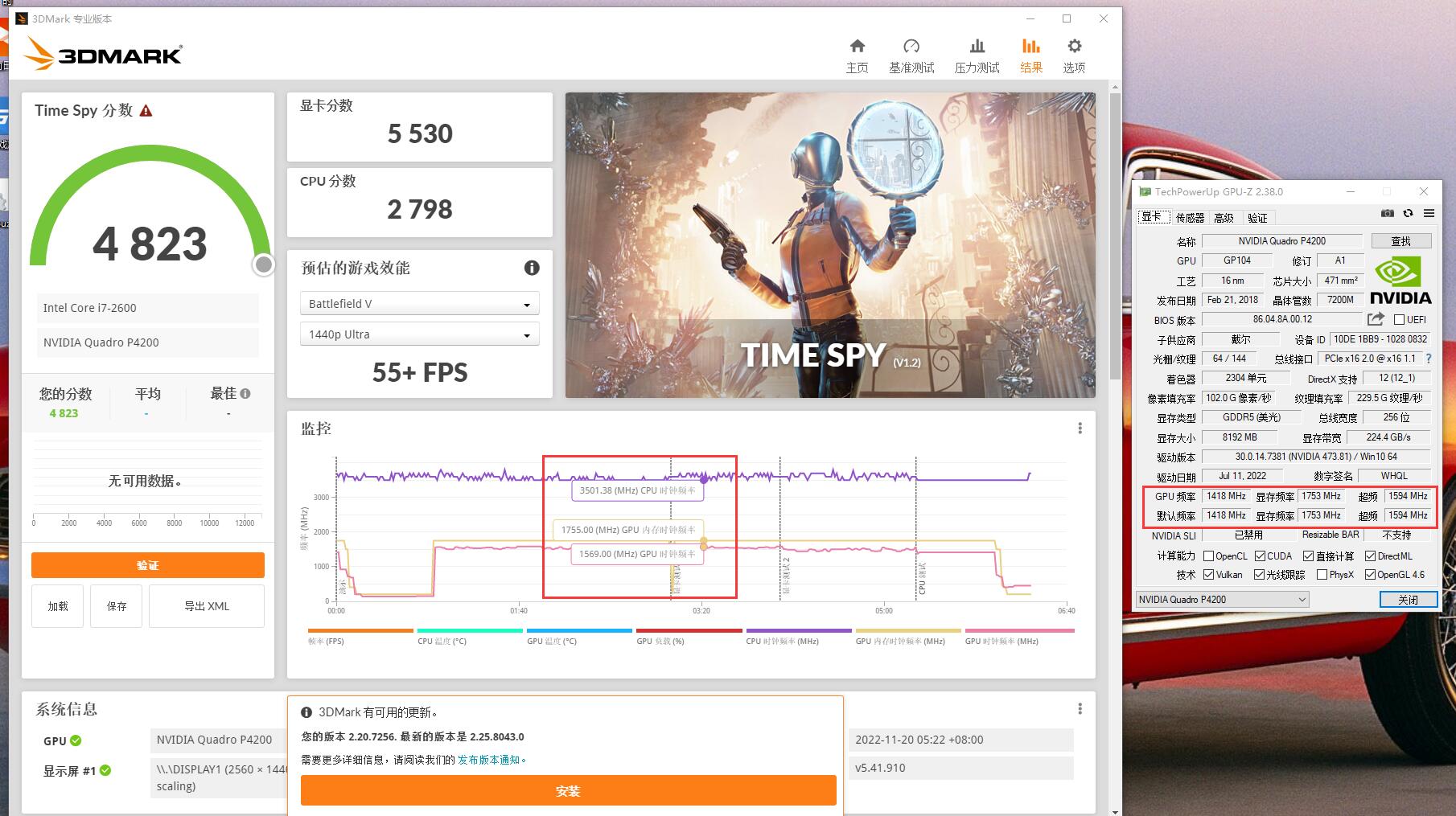

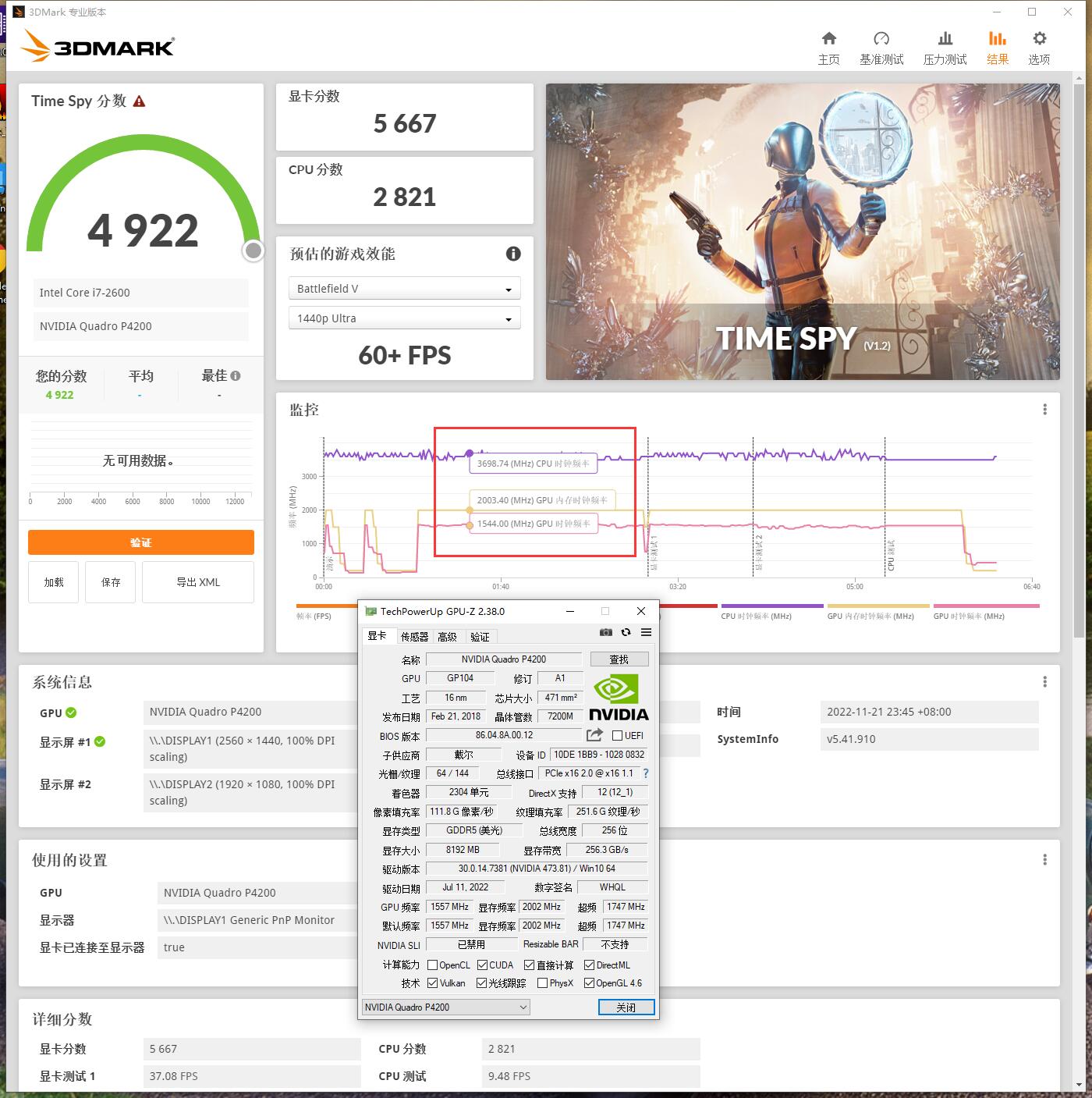

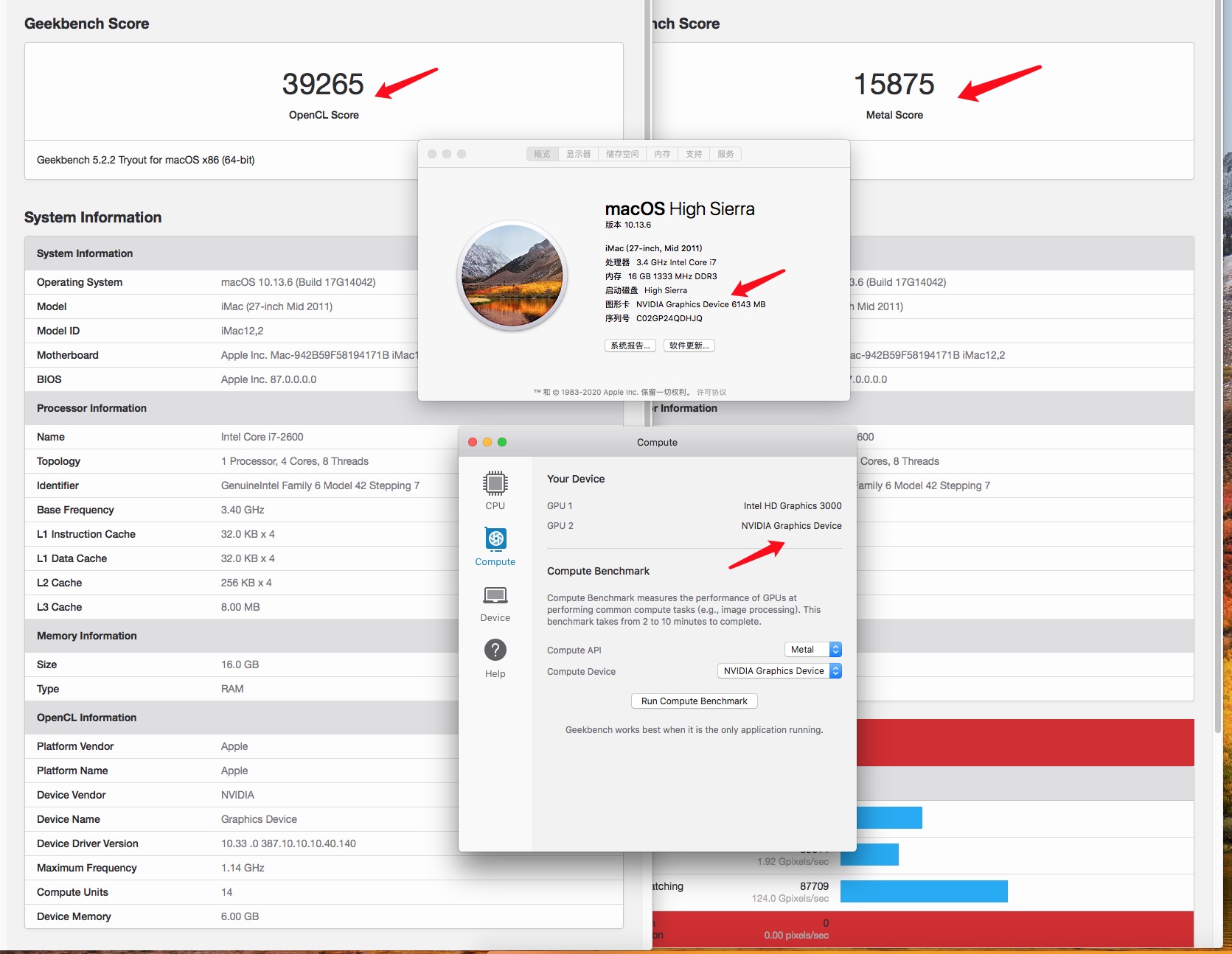

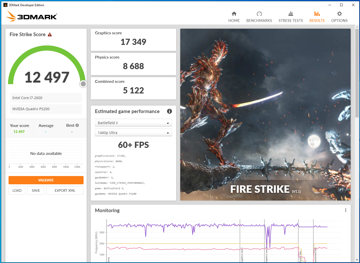

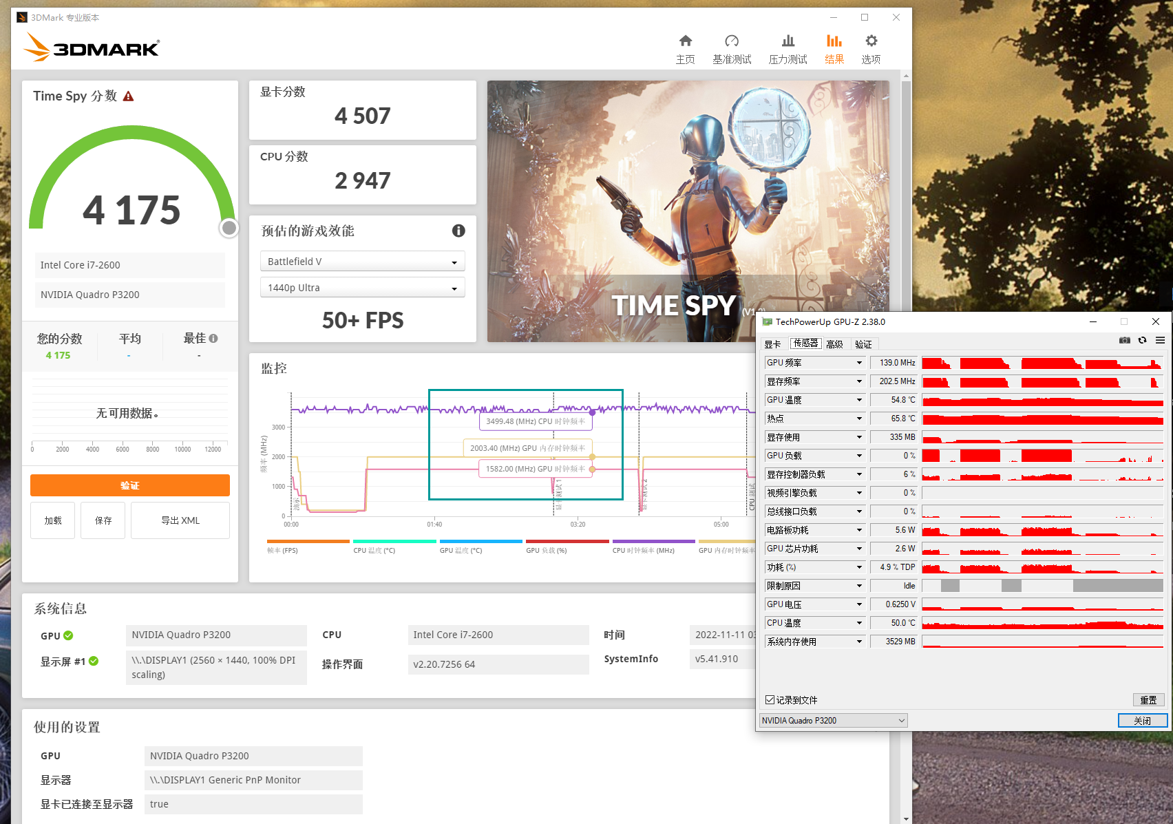

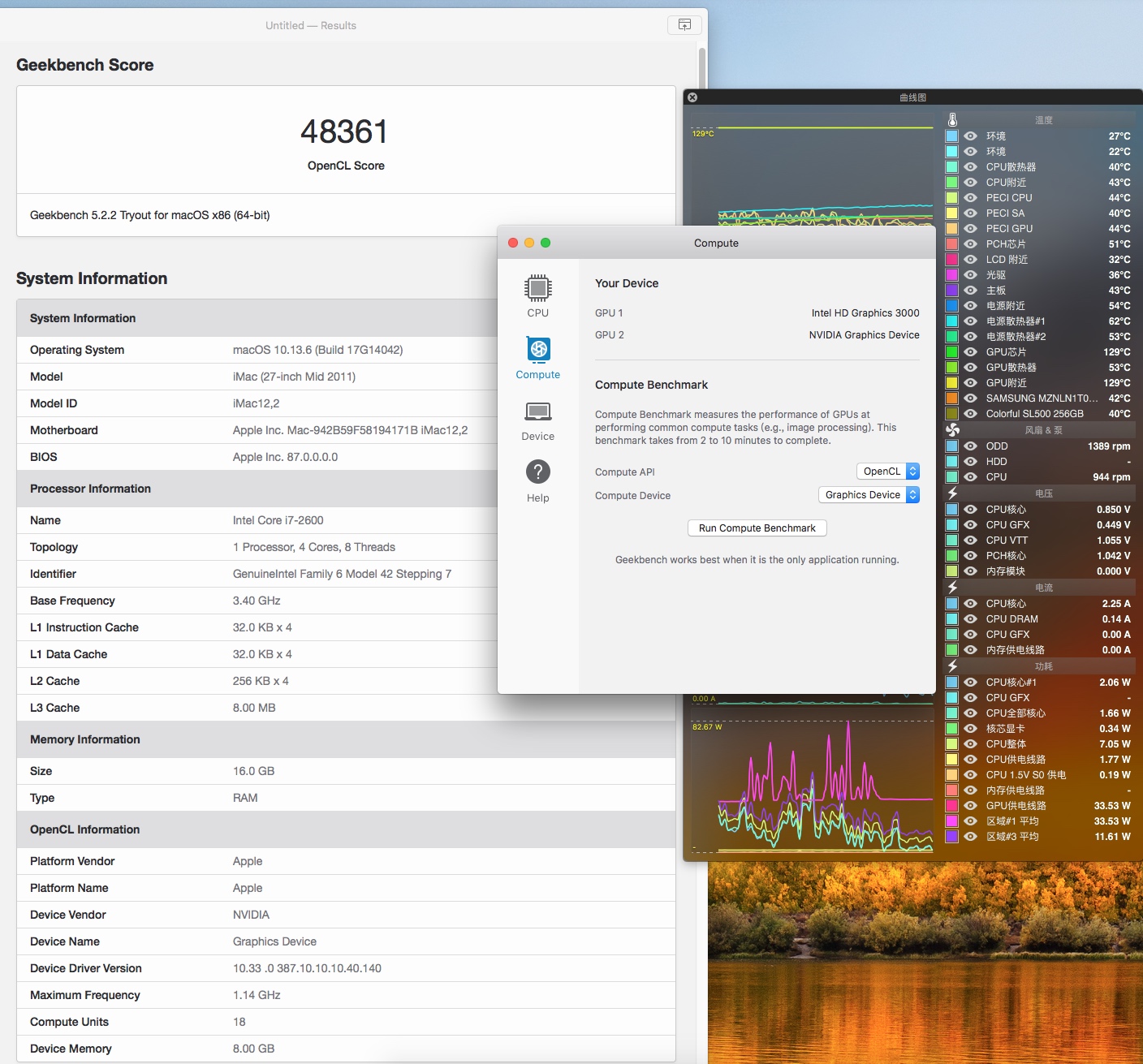

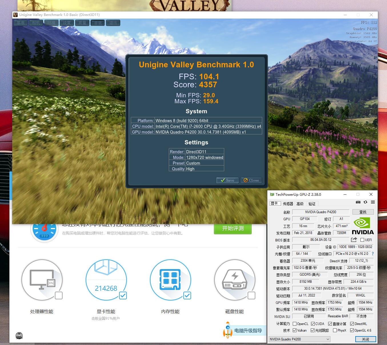

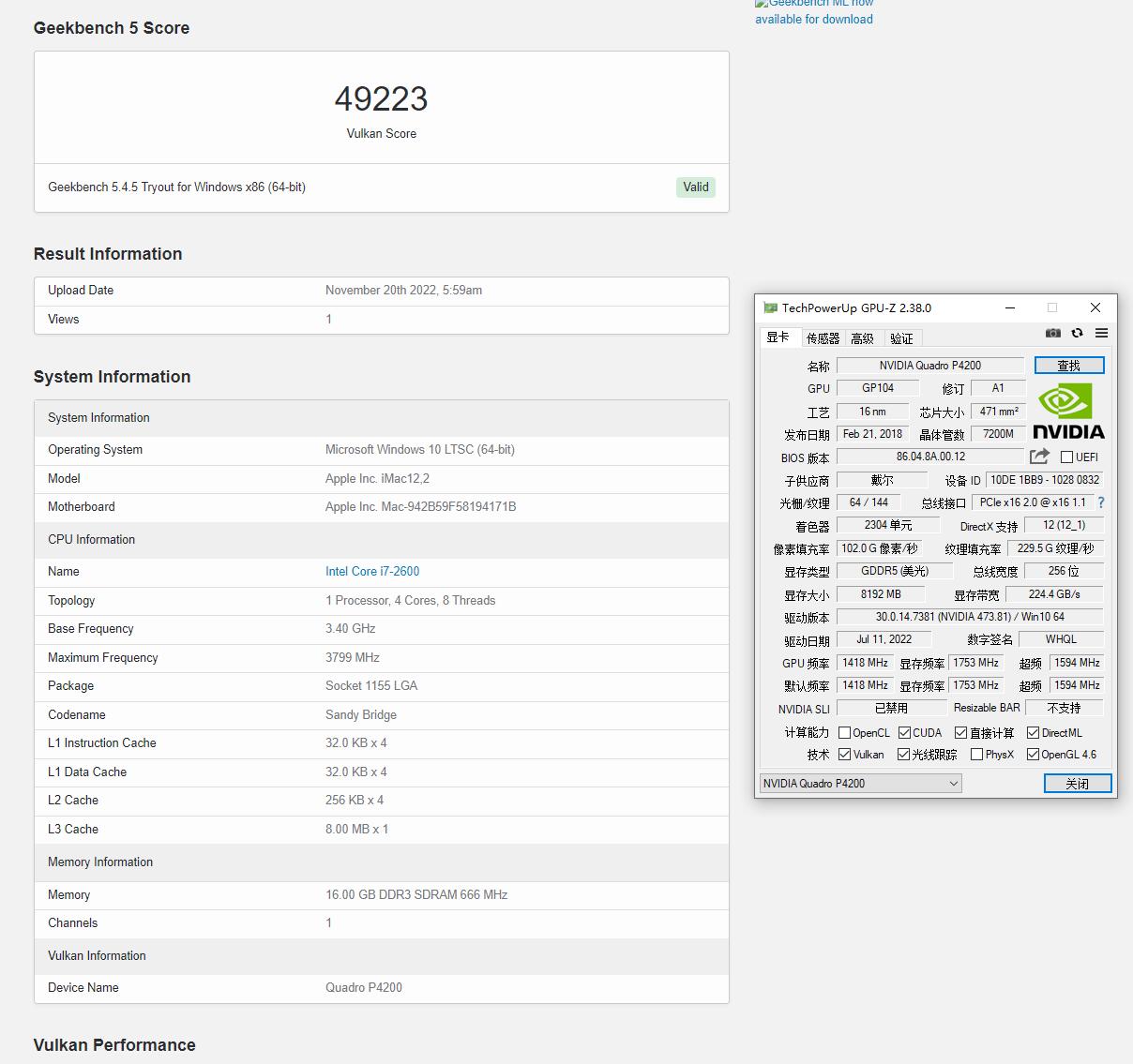

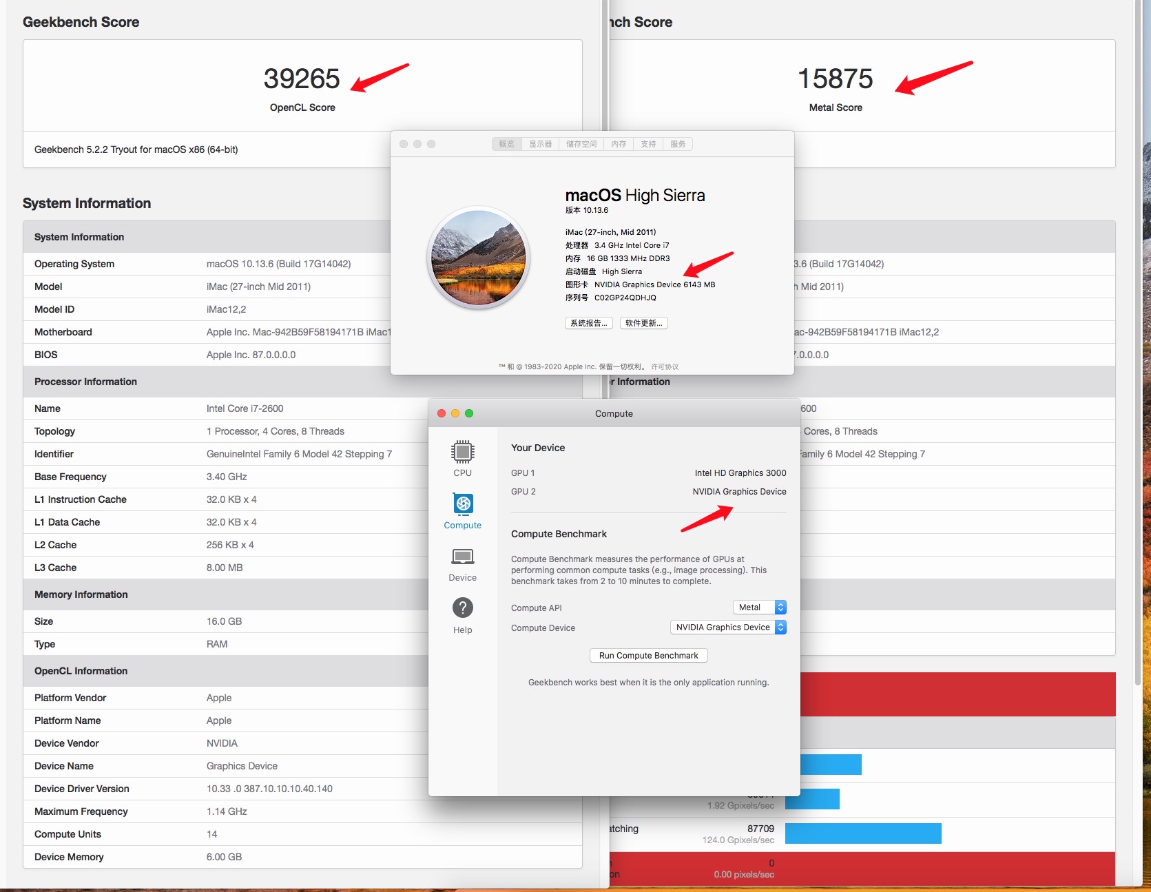

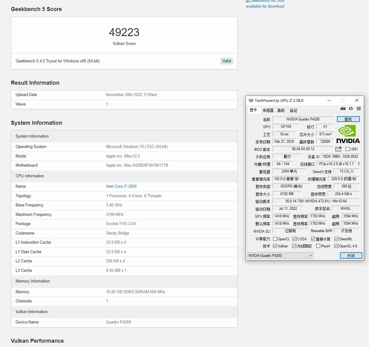

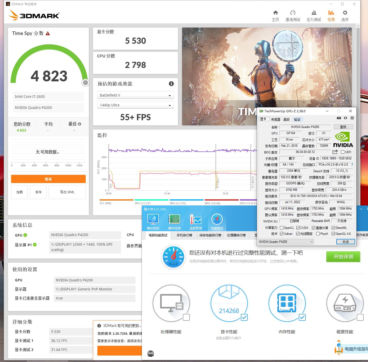

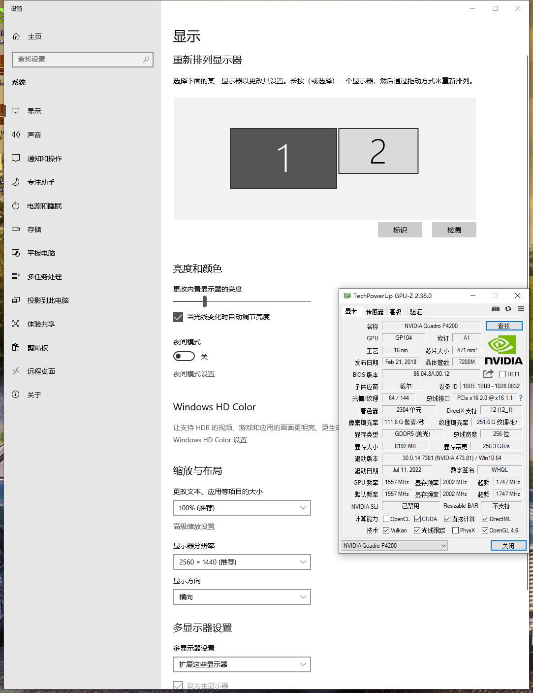

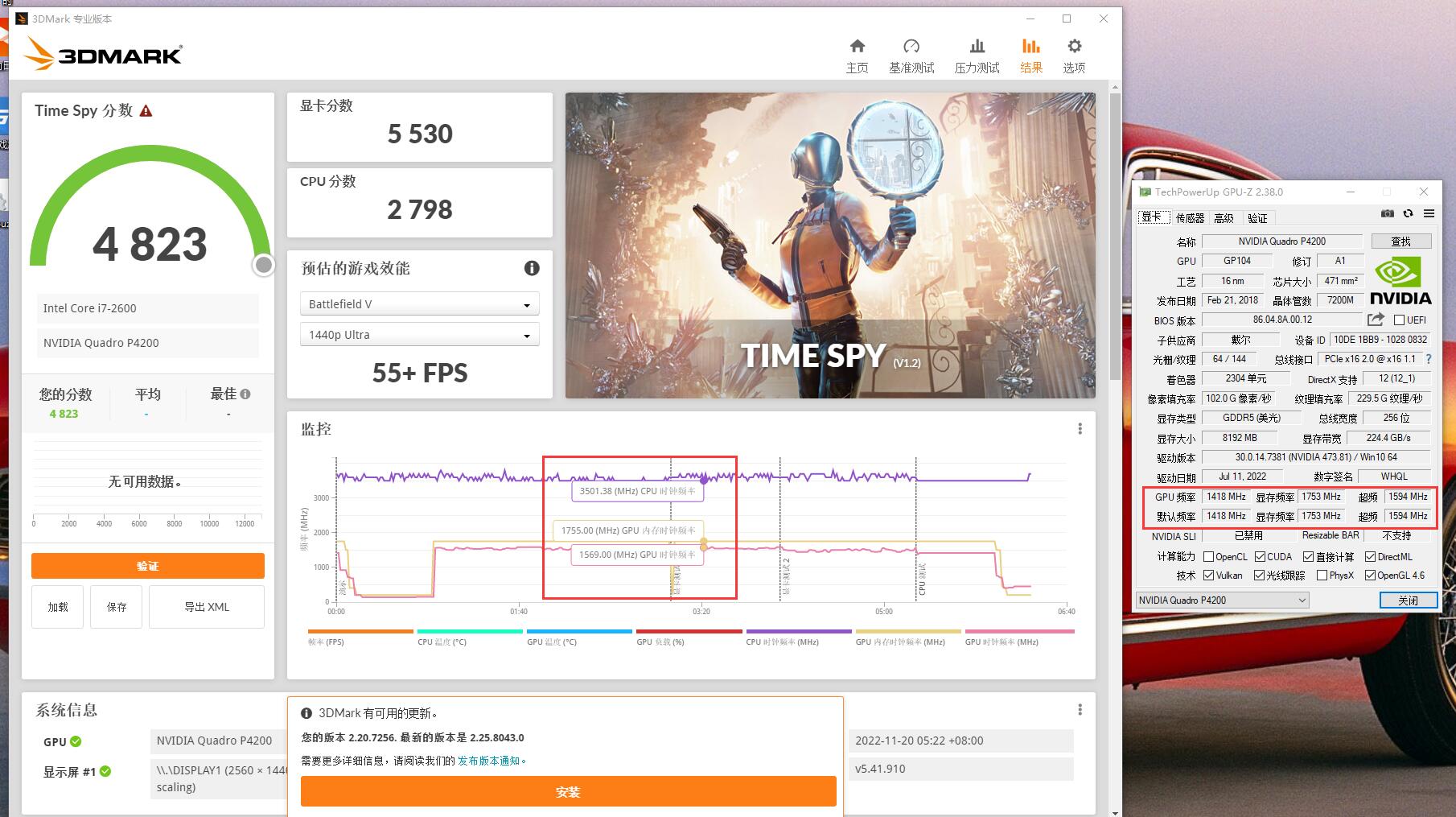

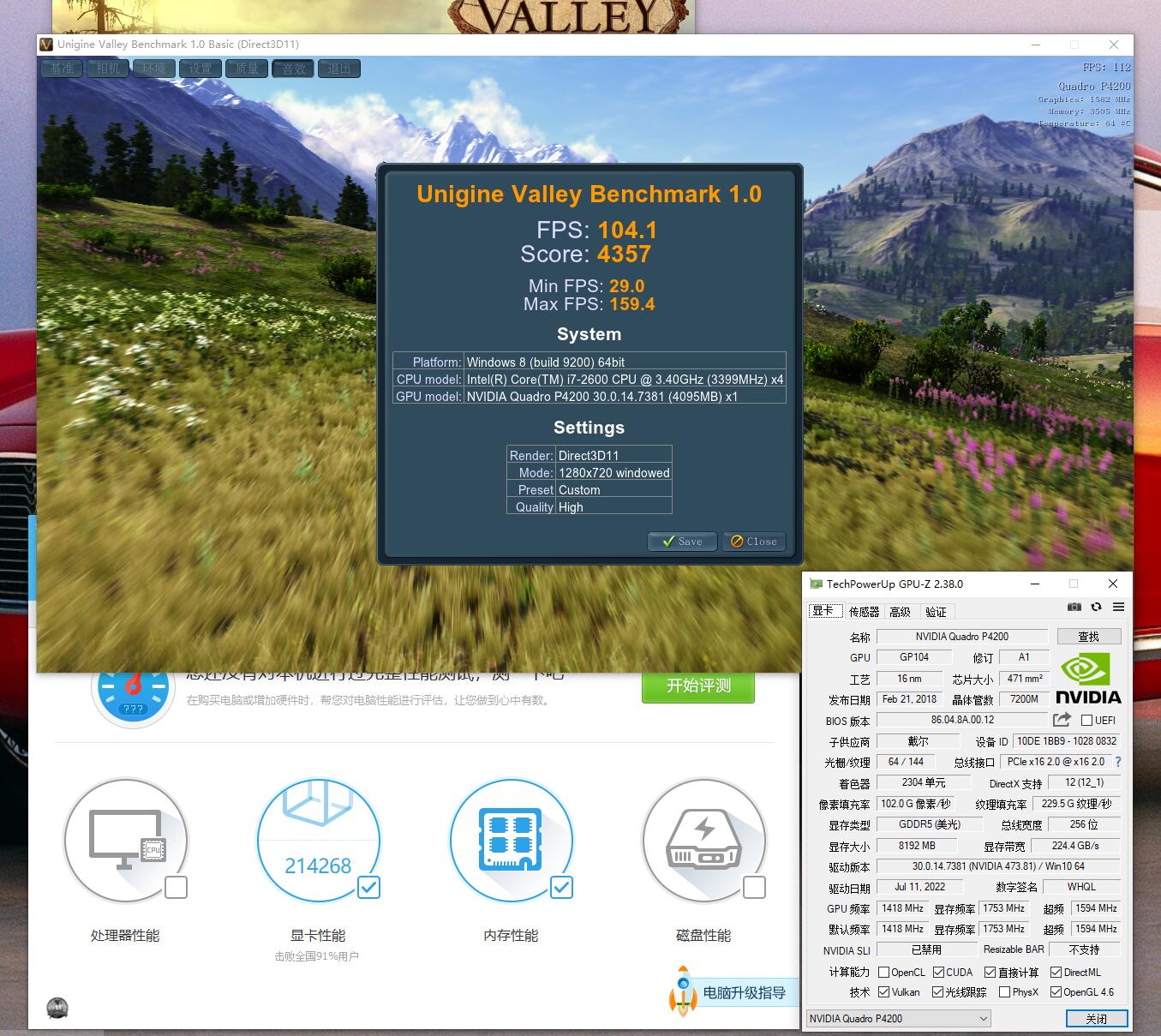

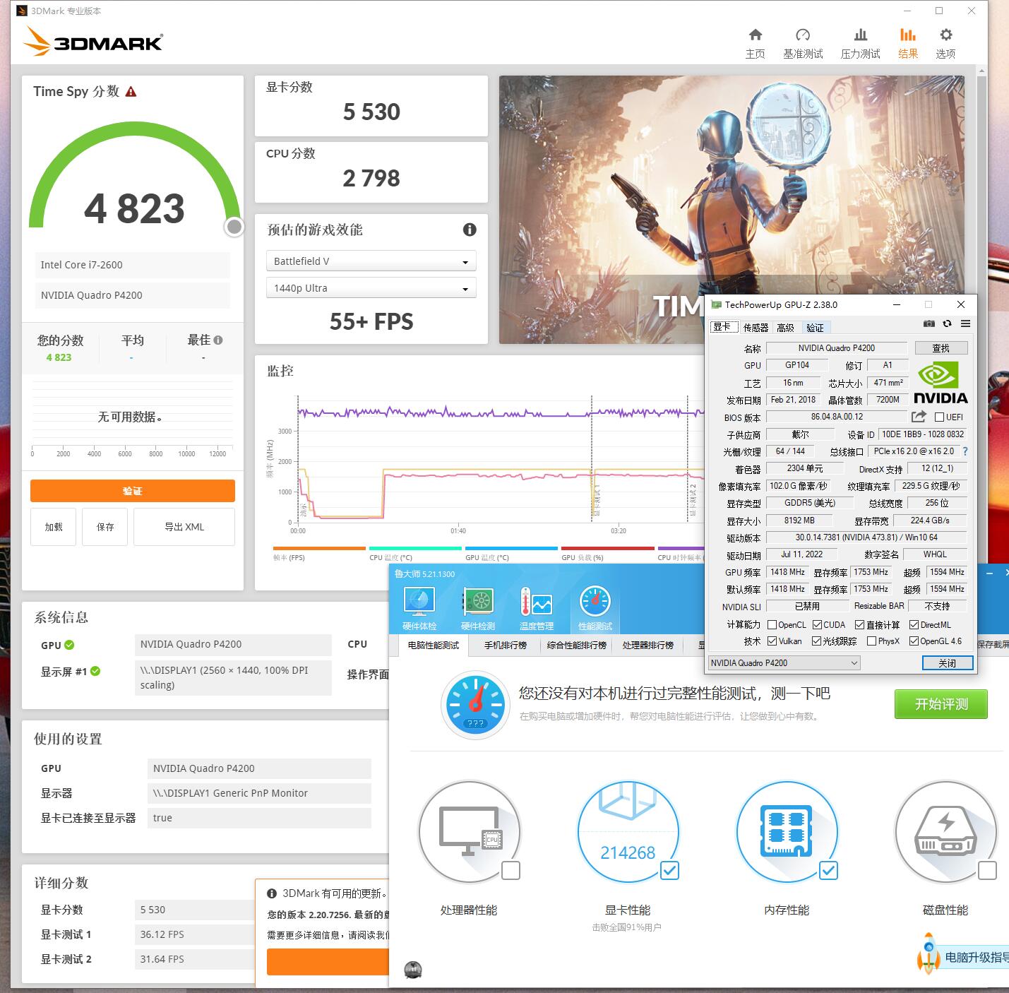

The first version of the p4200 performance test windows performance close to the overclocked gtx1070 super p5000.
windows10 system all normal

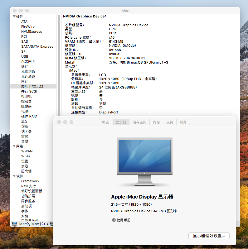

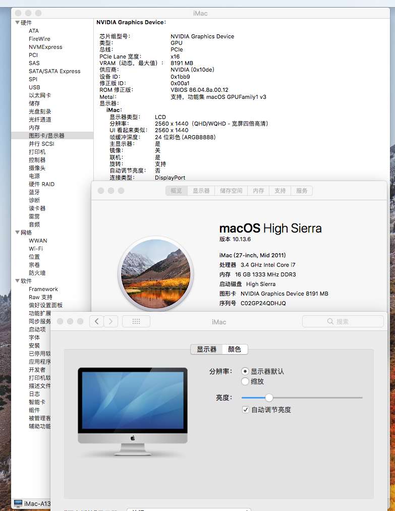

The macOS system is still unable to adjust the brightness, does not support metal. maybe the driver id problem still needs to be fixed and improved.
View attachment 2115911View attachment 2115912View attachment 2115913View attachment 2115914
View attachment 2115915View attachment 2115916View attachment 2115917
Do I need to isolate the smbus track?

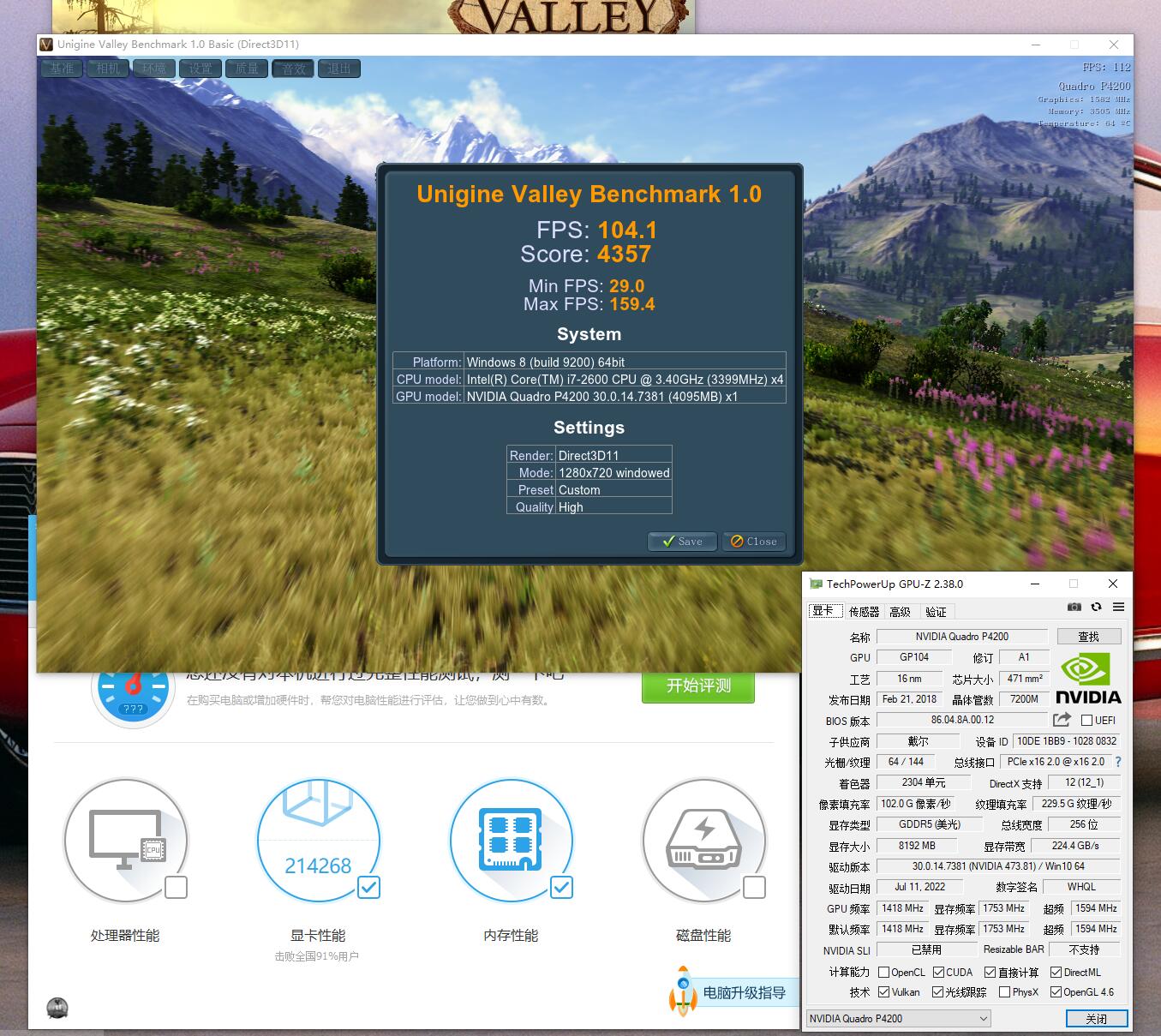

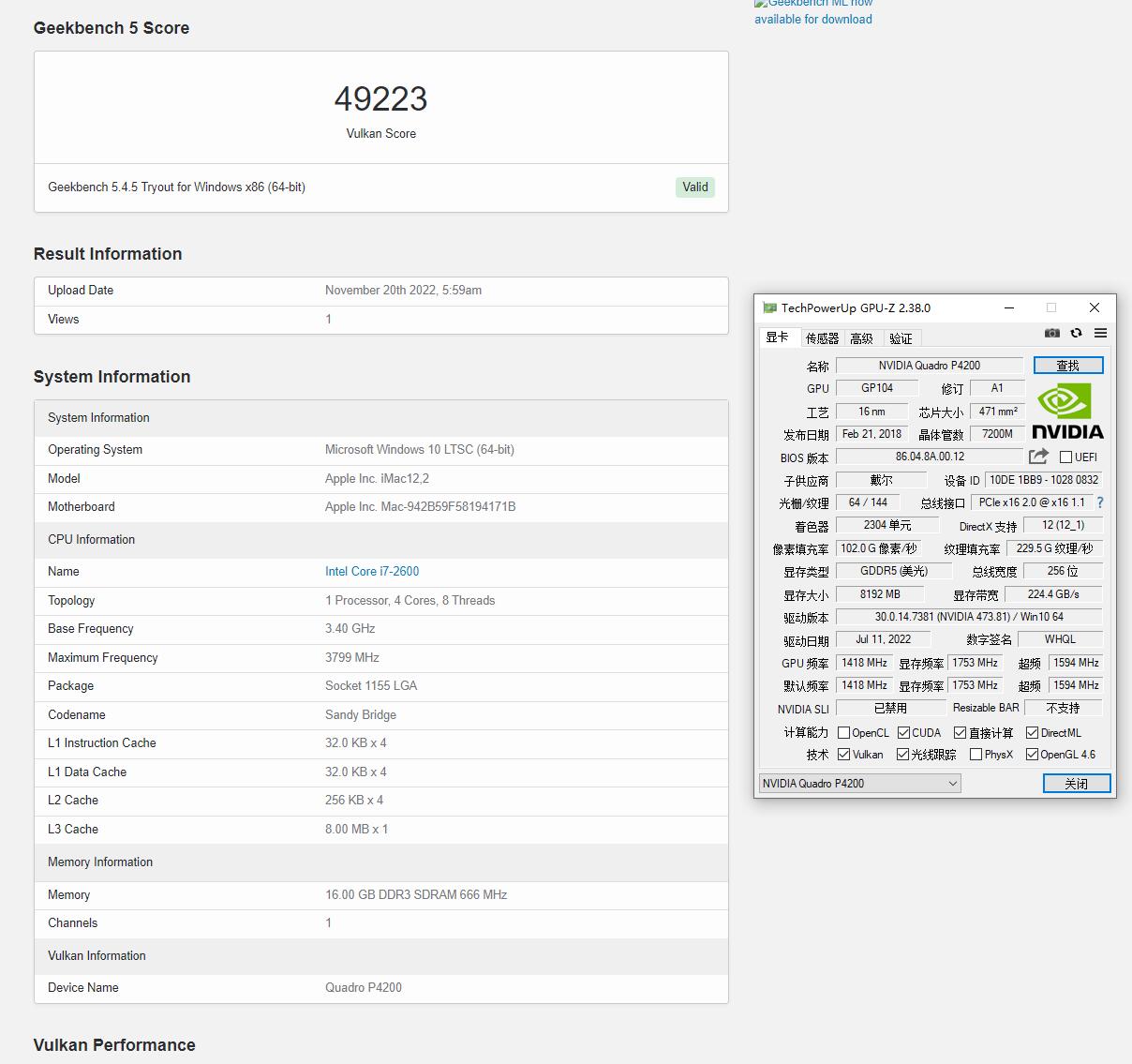

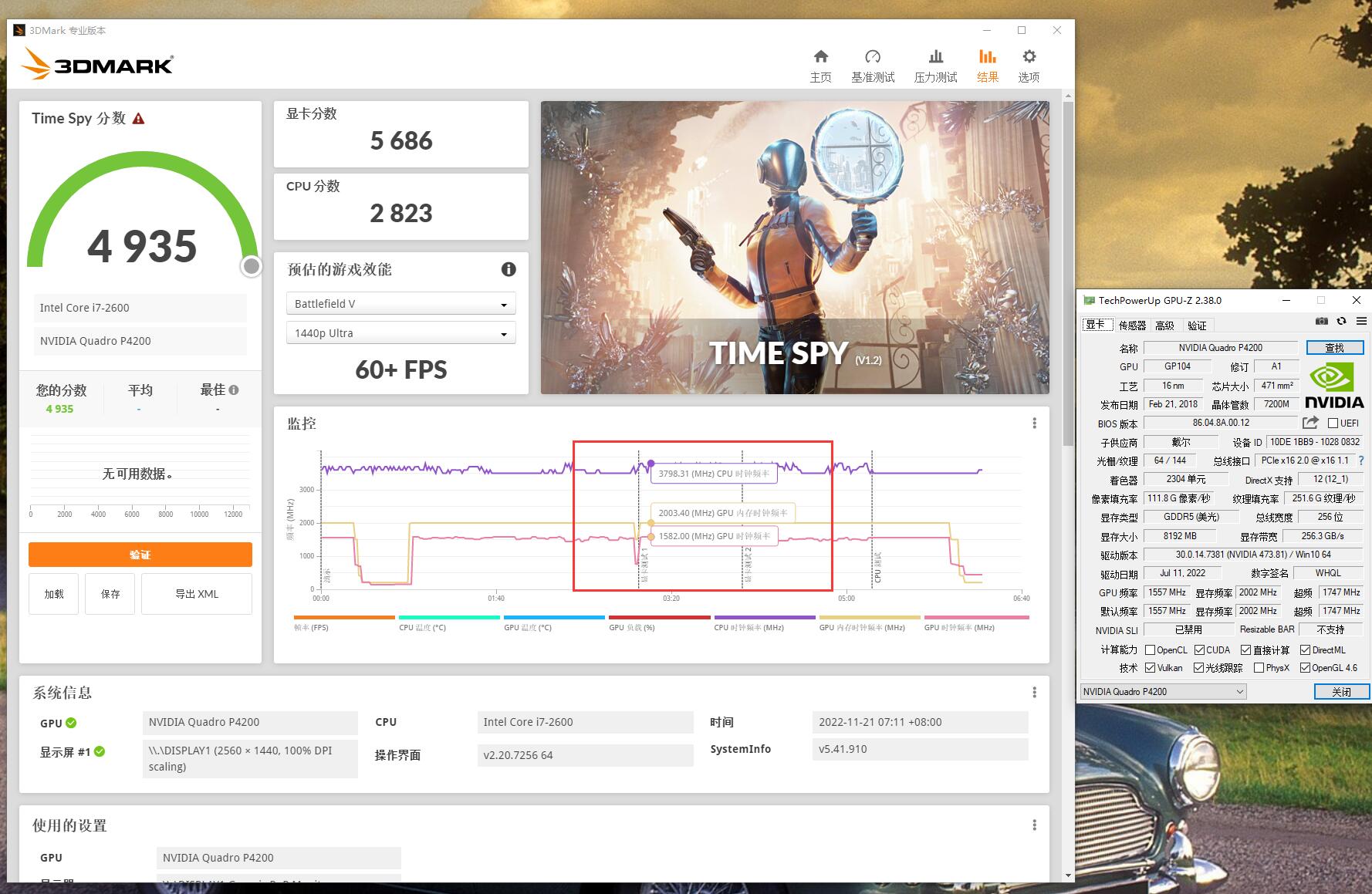

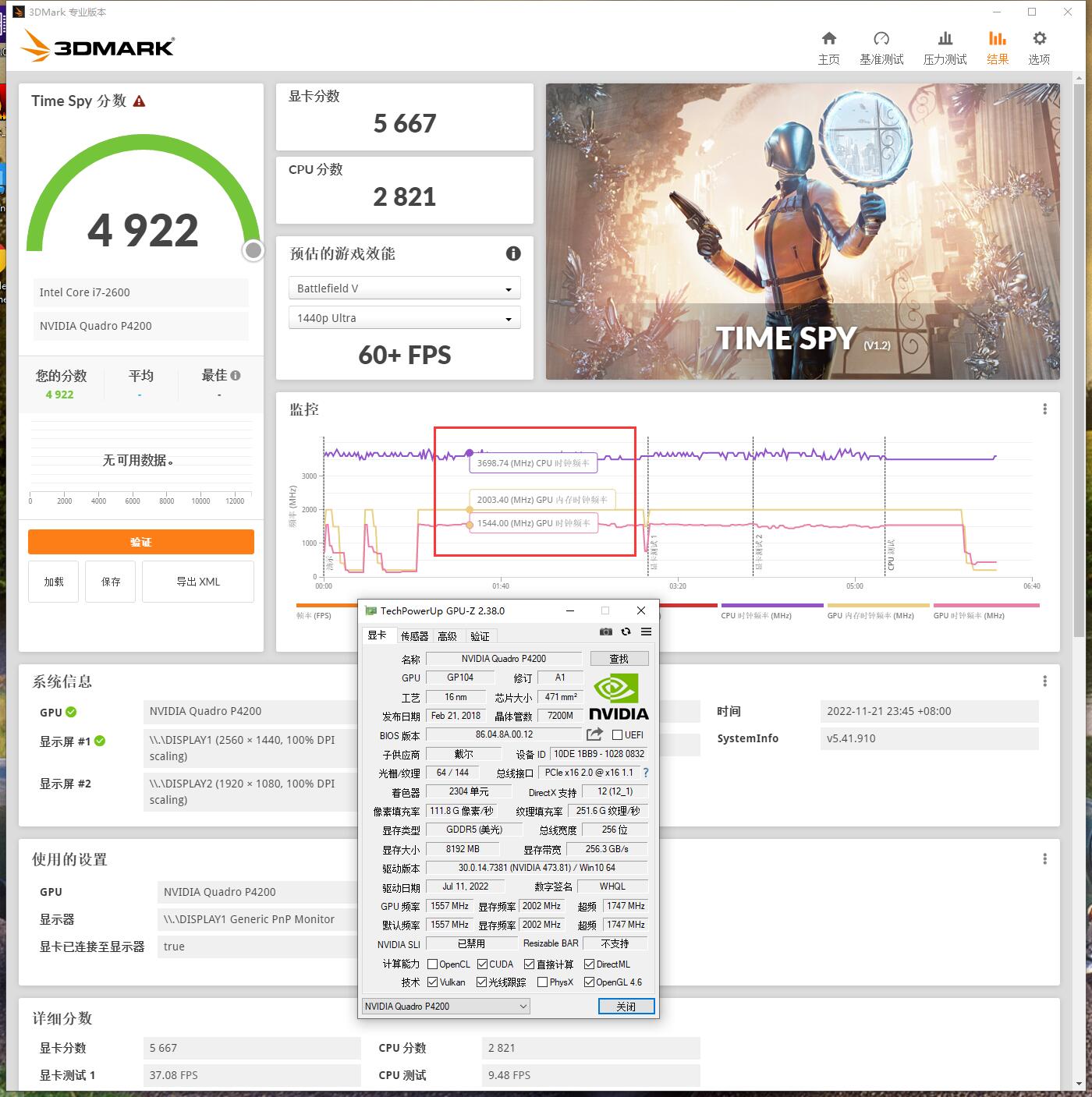

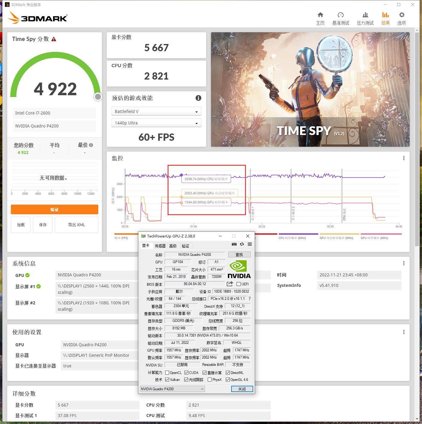

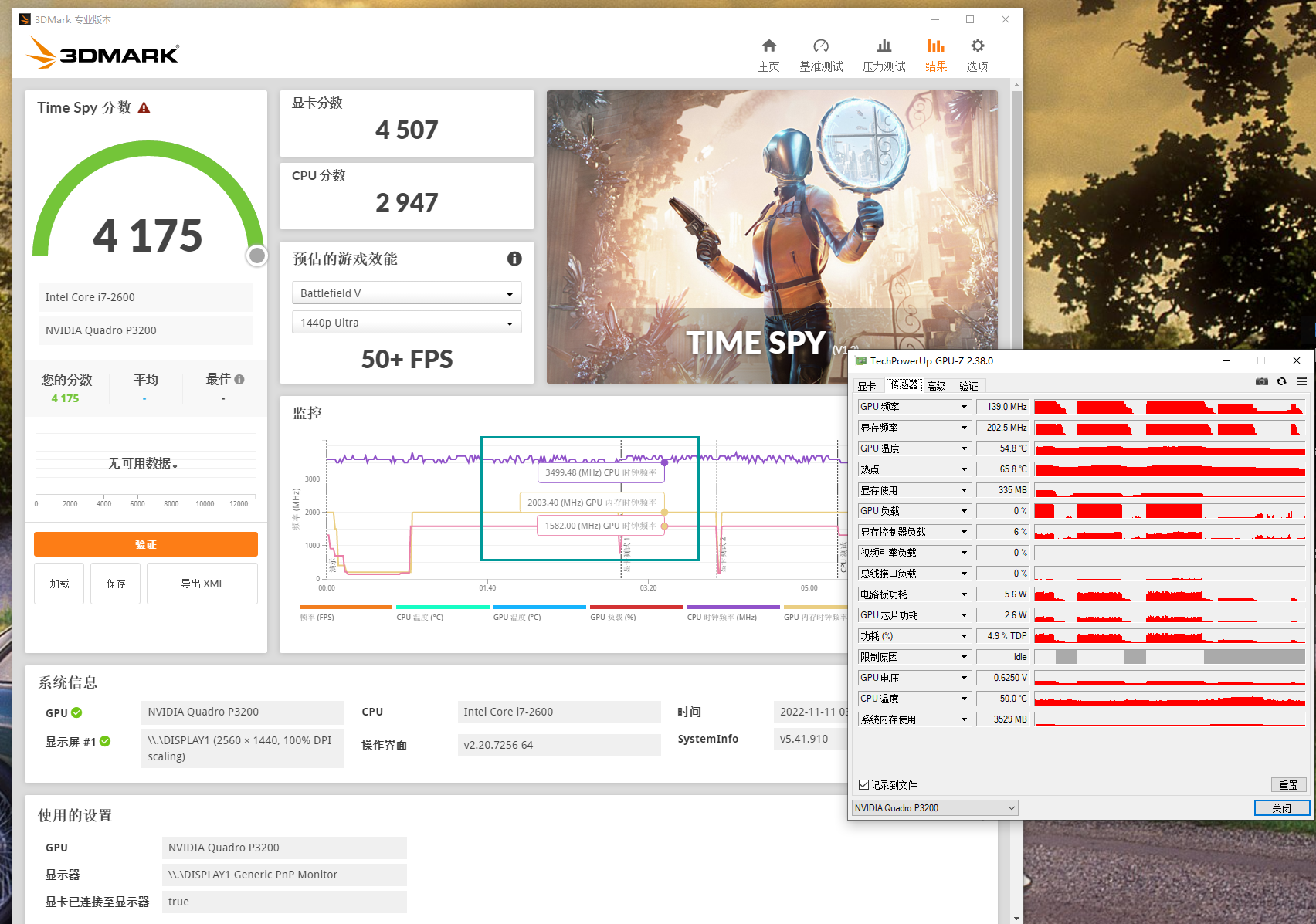

The second version of windows 10 performance is flat gtx1070 over p5000.
macOS nothing has changed
Yes, it seems that is needed on P3200/P4200/P5200 cards and iMac 12,2
Also most (maybe all?) of this cards come without 1.8v eeprom soldered onboard, I have edited the main post to include that.

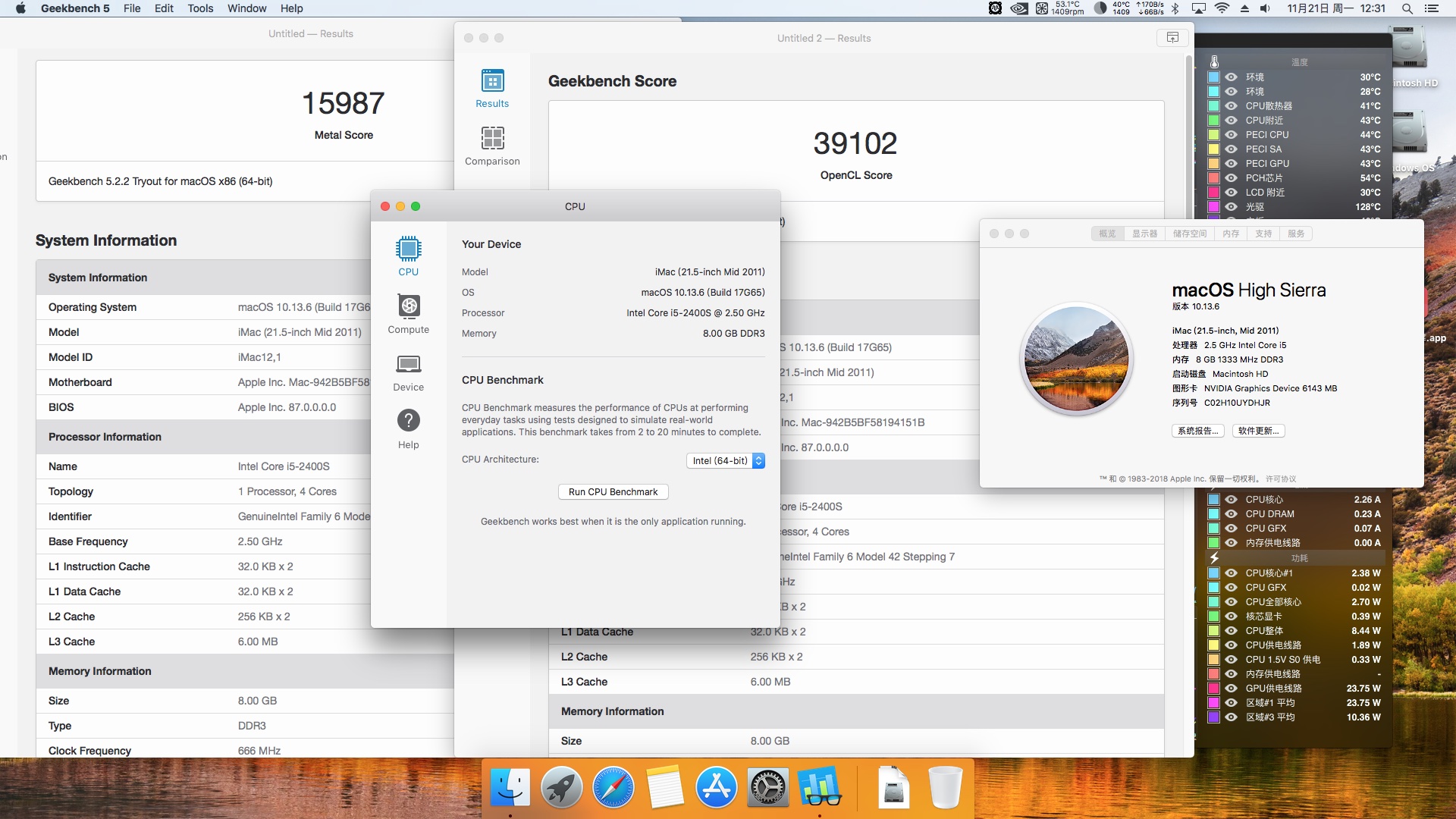

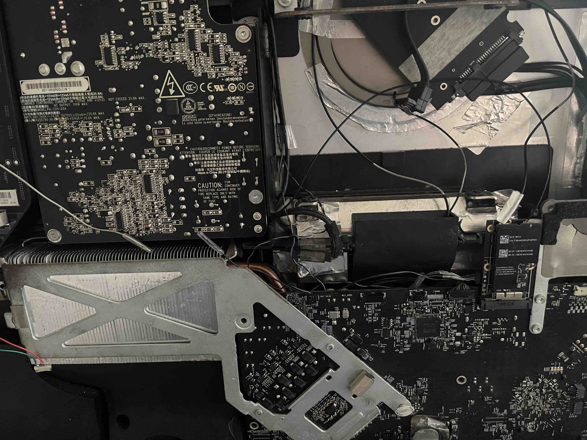

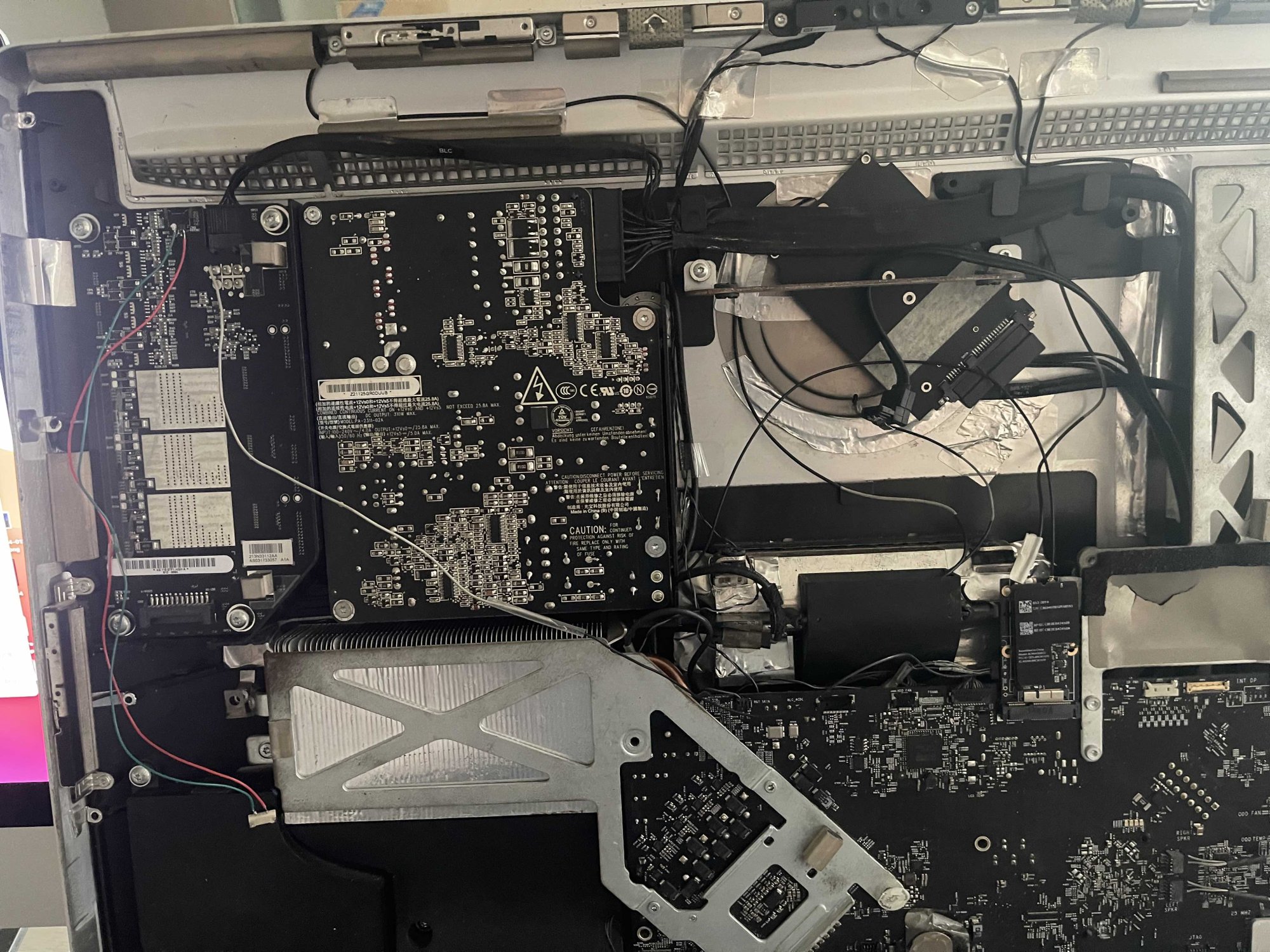

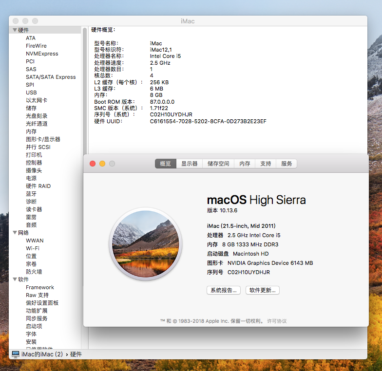

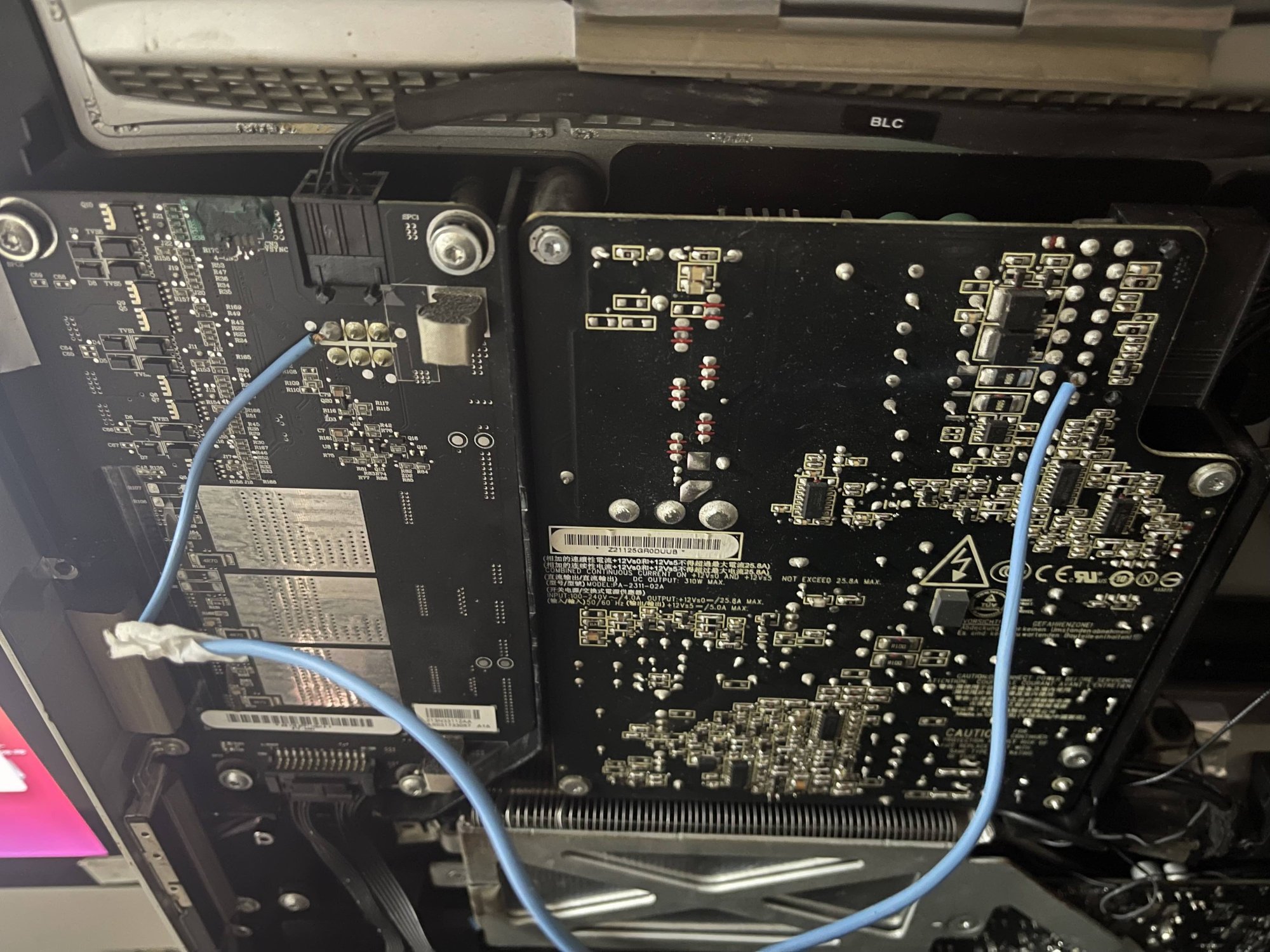

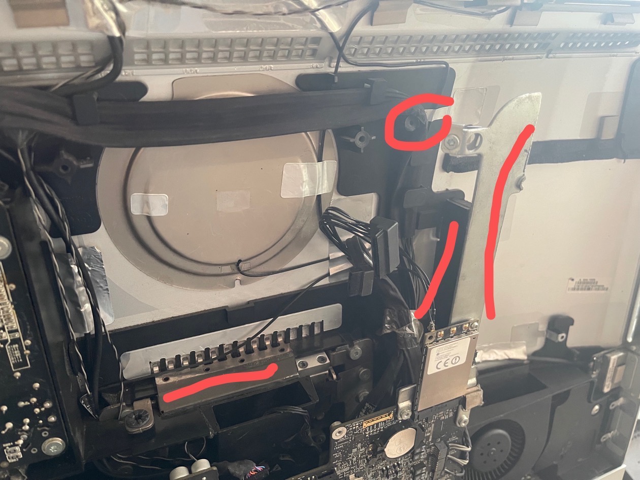

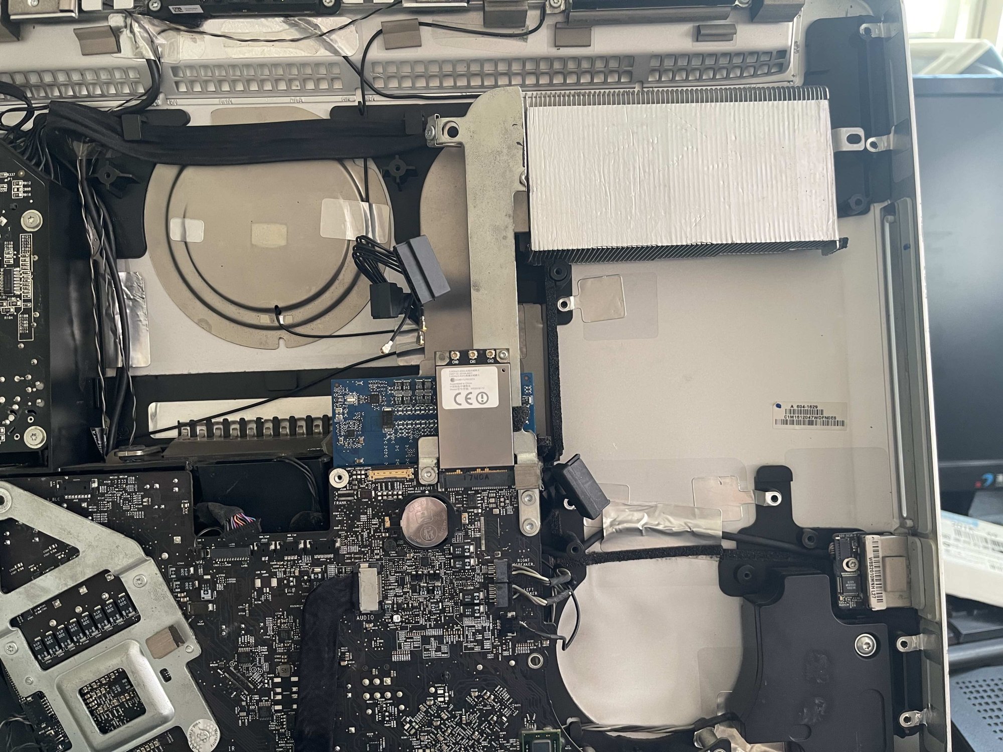

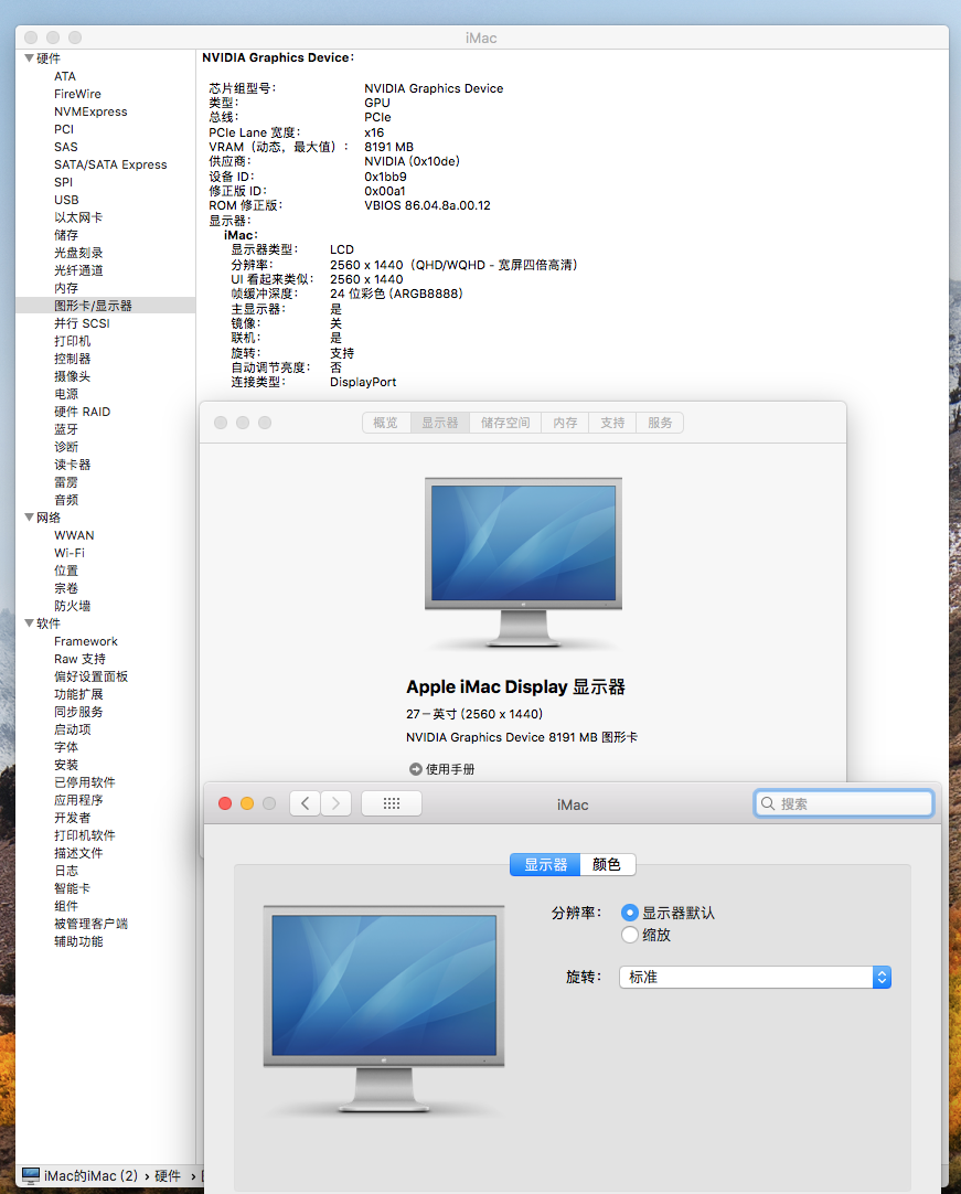

I tested the p3200 in iMac 12,1 2011 21.5 inch model modified cut part can, can install three heat pipe radiator.

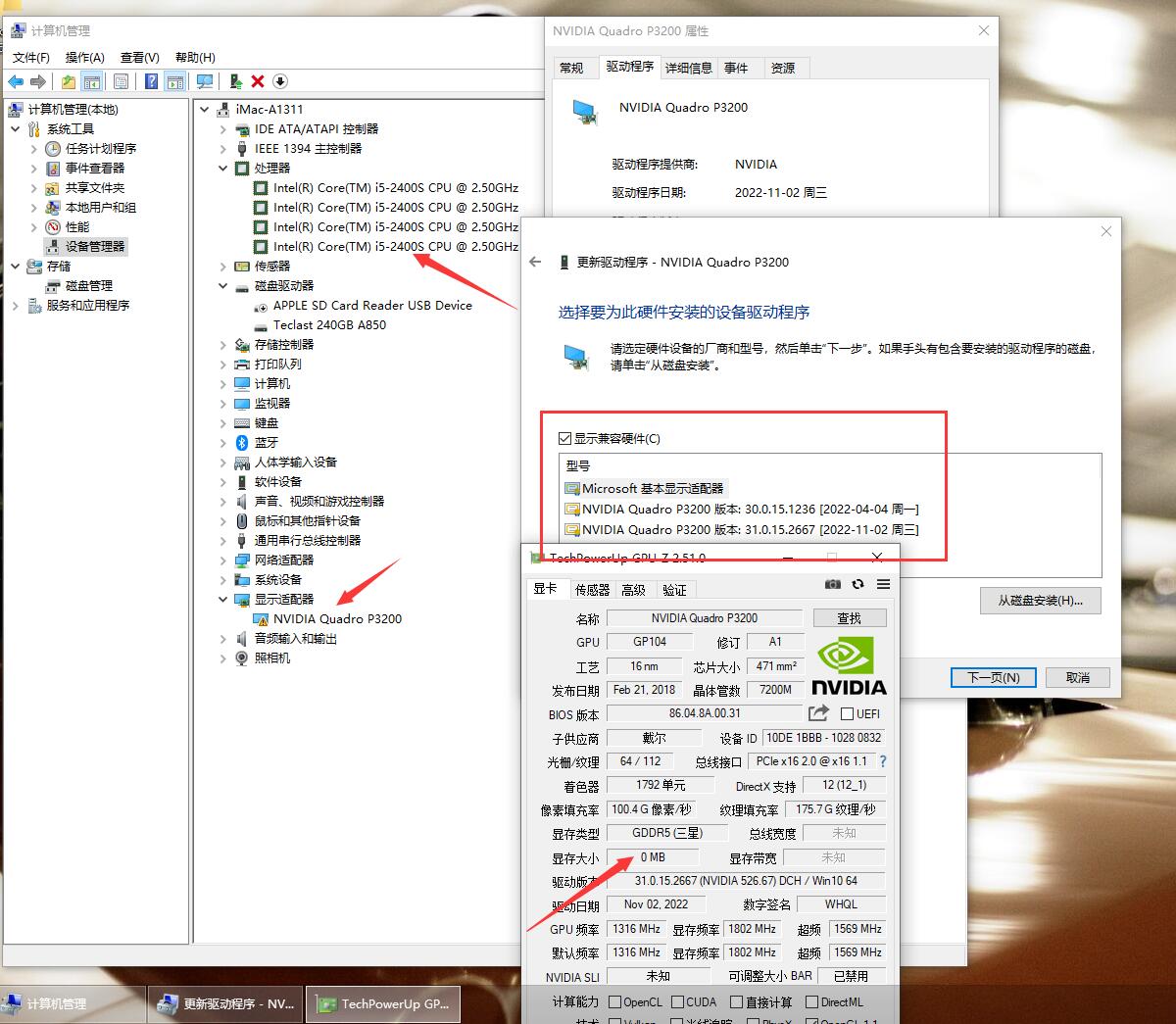

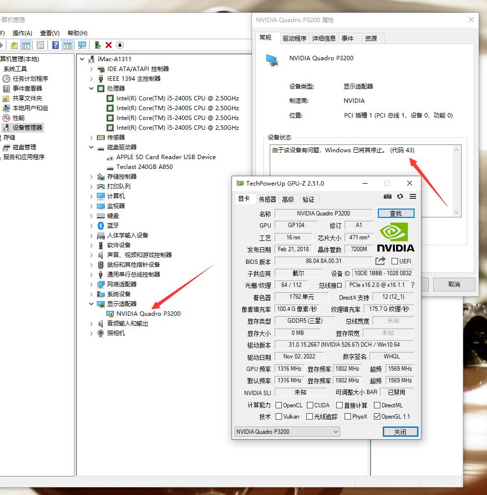

windows10 system do not know what the reason for installing several versions of the driver are 43 error can not be used still need to debug, macOS system test available brightness adjustment is still the same.
iMac Quadro P4200 rom:
- Max TDP raised from 110W to 115W.
Many thanks to @jay508 for help and time spent testing this card and vbios.

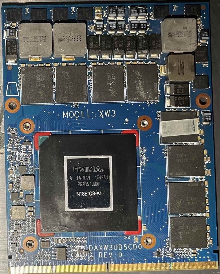

The card we tested (board DAXW3UB5CD0 REV D) needed to apply the smbus isolation trick to work properly on the iMac 12,2. There is a smbus collision that makes the card work at low ~50% power if SMB_DAT track is not isolated from the mxm connector. This hack may not be needed for other models of iMac which use different smbus addresses, or other different card pcb revisions.
You must use a hardware programmer to flash this rom on the eeprom chip at 1.8V (nvflash will not work, as digital signature is invalid). Also take into account most (if not all) cards come without eeprom chip onboard, you have to use a nvflash compatible 4M-bit 1.8v eeprom chip like W25Q40EW / W25Q40EWNIG for the bios (some sellers may offer to solder it for you).

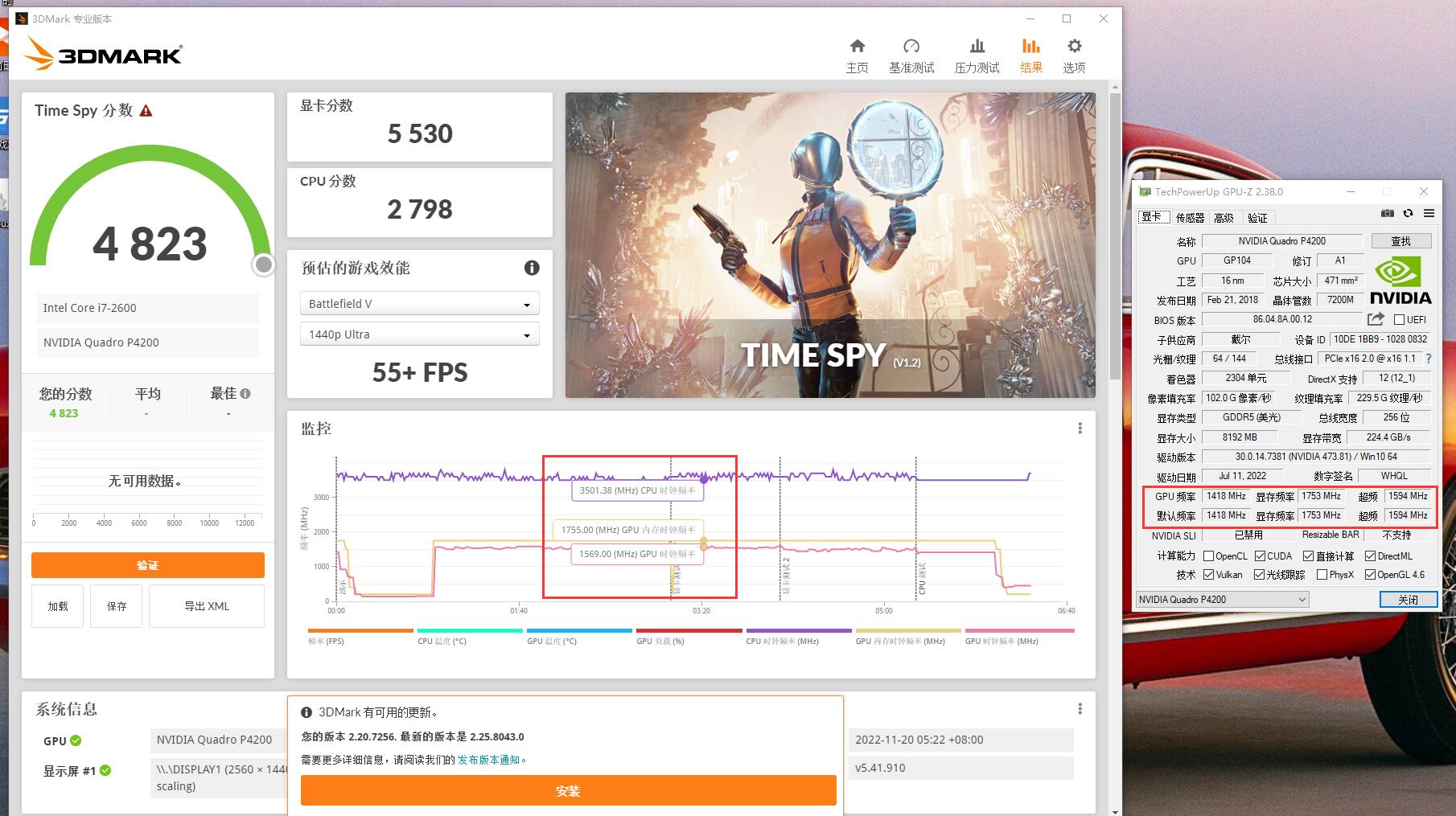

Card performance is great, it performs like an overclocked GTX1070.
**UPDATE**
2022-11-24
MacOS brightness issue fixed.

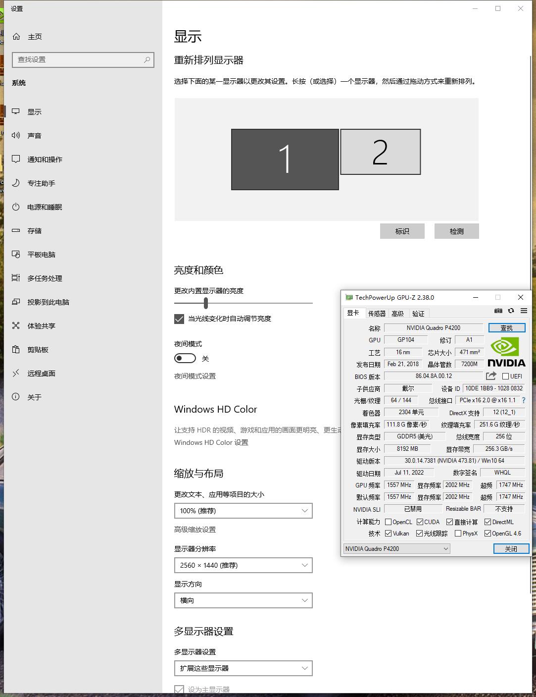

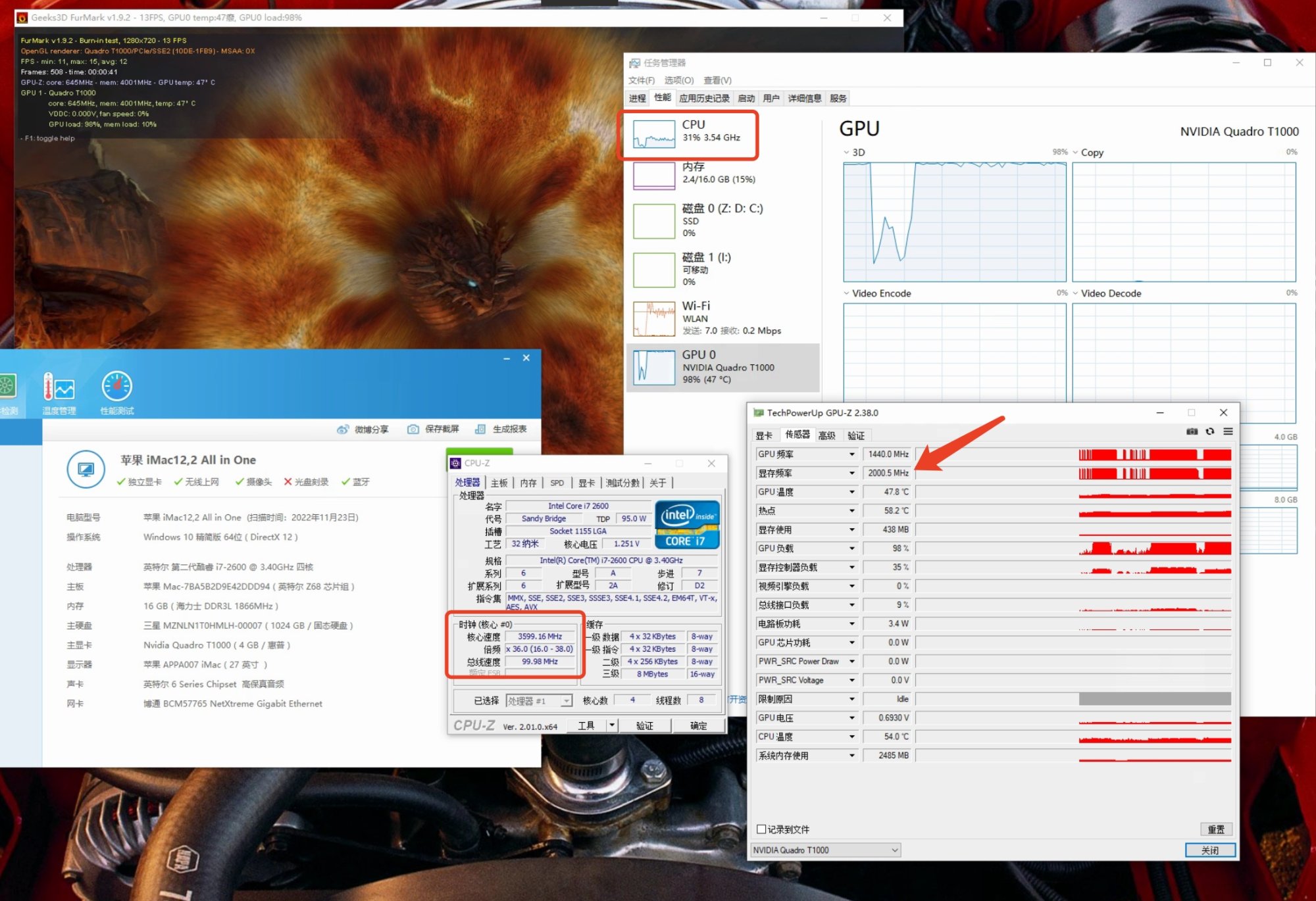

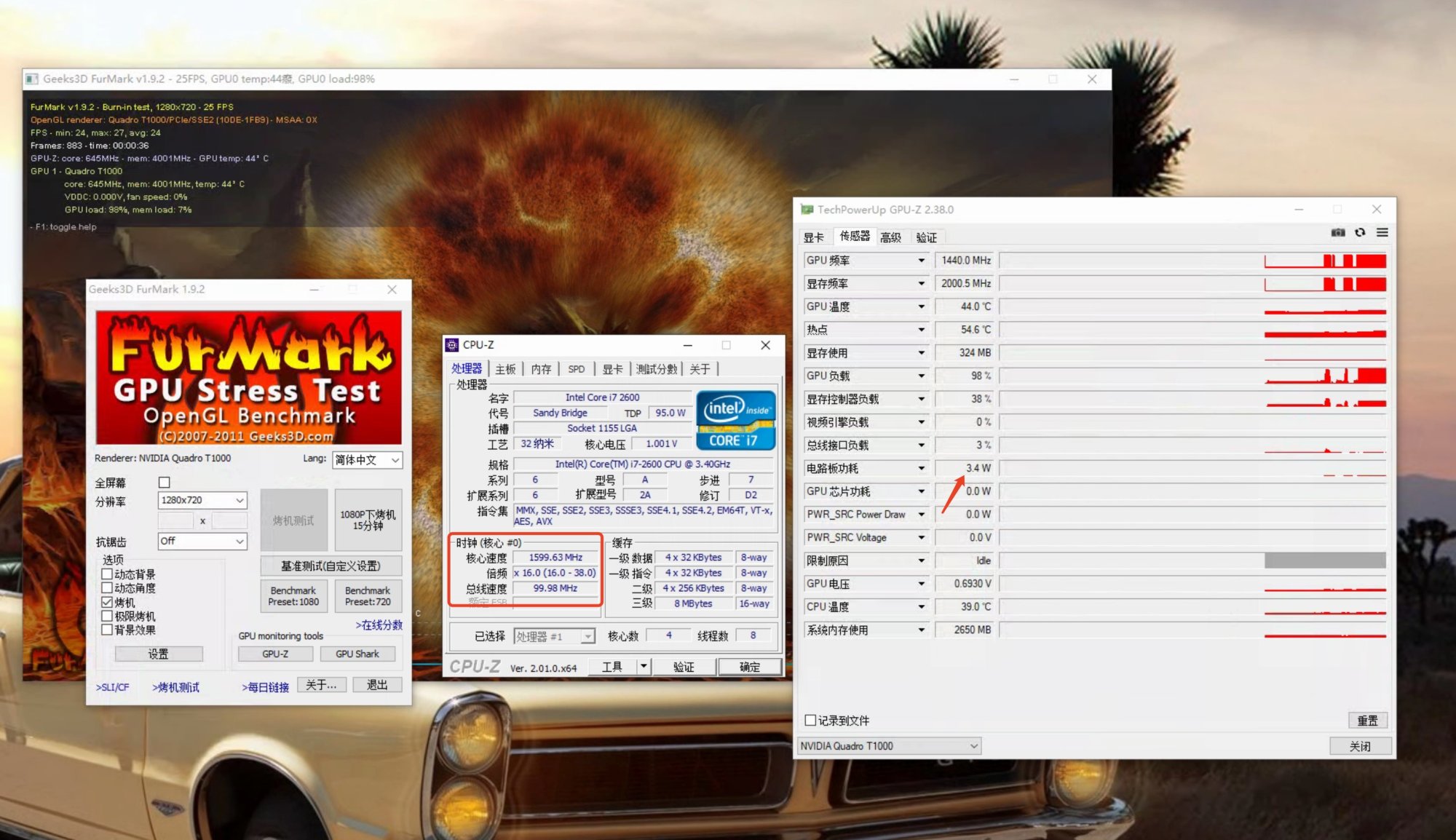

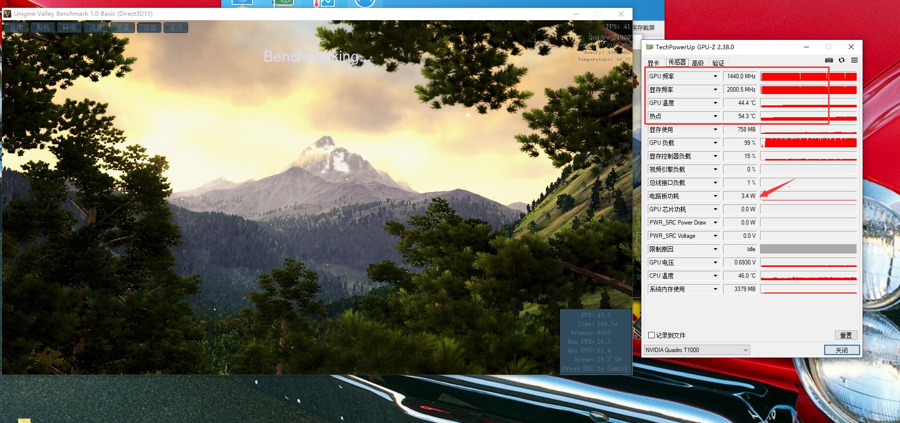

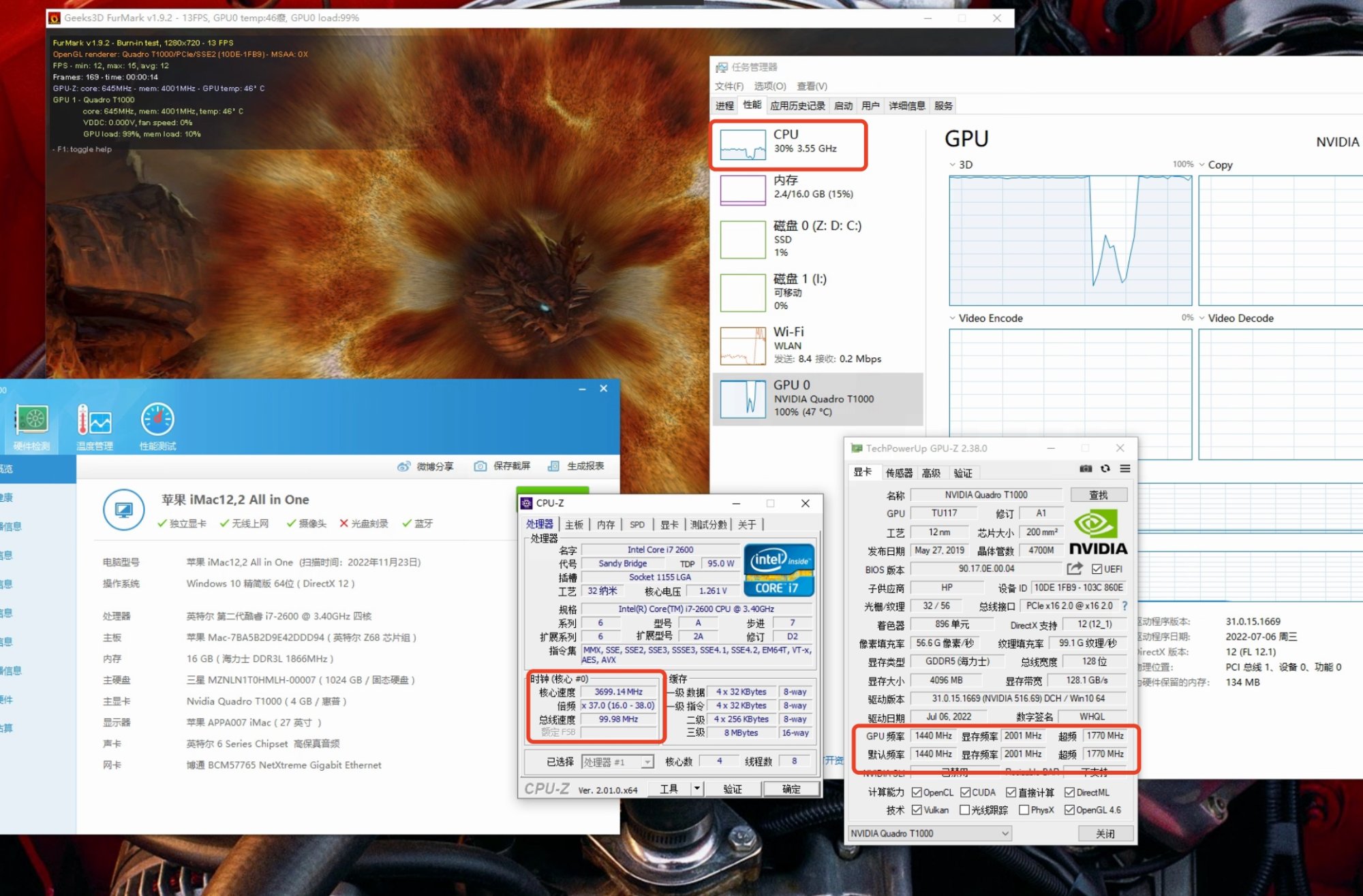

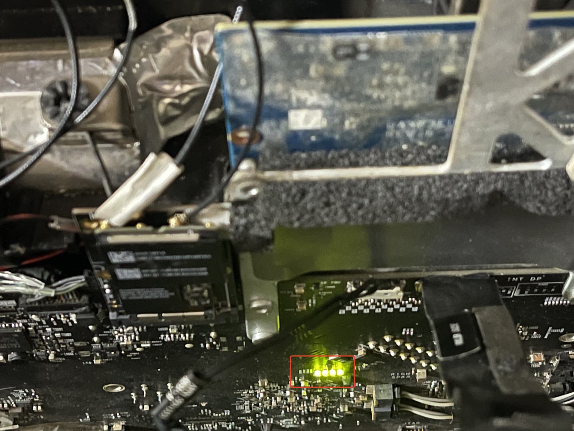

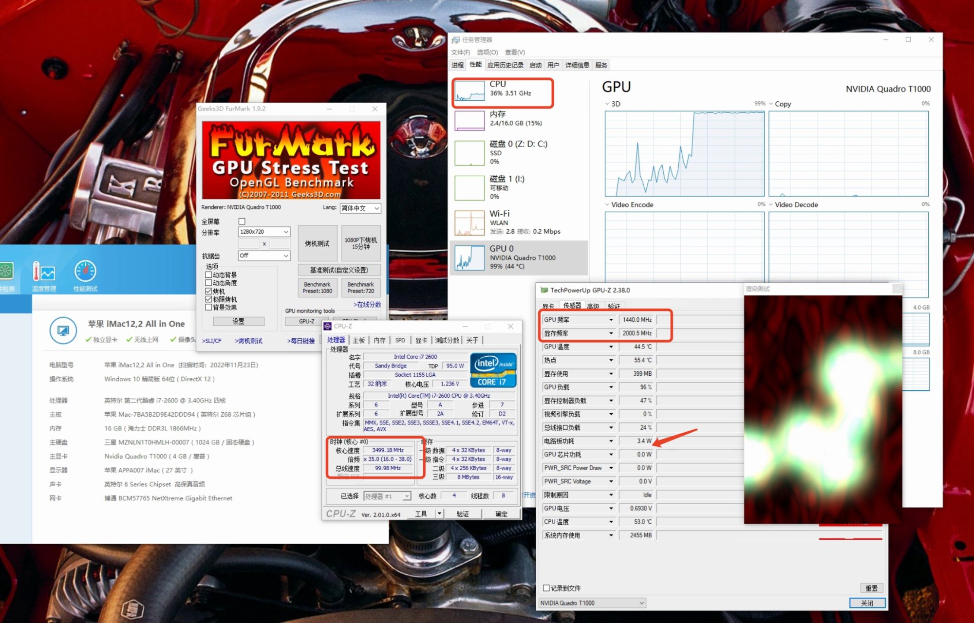

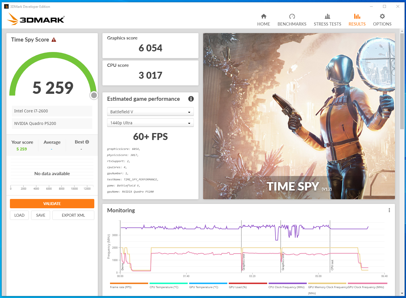

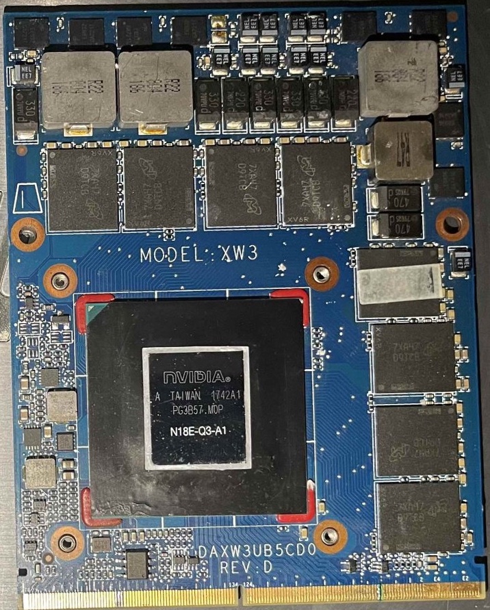

Bad news, gpu-z shows board power consumption only 3.4w core power consumption of 0w such a situation is not known to be normal? Backlight cable is connected. cpu frequency is locked at the lowest 1.6gz running
Disconnect backlight connection cable cpu frequency back to normal.
Disconnect or connect the backlight screen will not light up to keep the black screen does not work, the default motherboard on the four led lights will light up. The two Thunderbolt interface external display are not working.
The default vbios with refresh @Santa's Little Helper provides the vbios are the same situation. So how can I get the screen backlight to work properly?

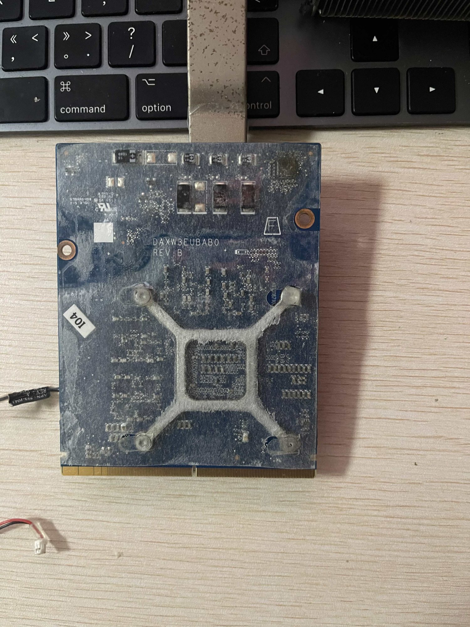

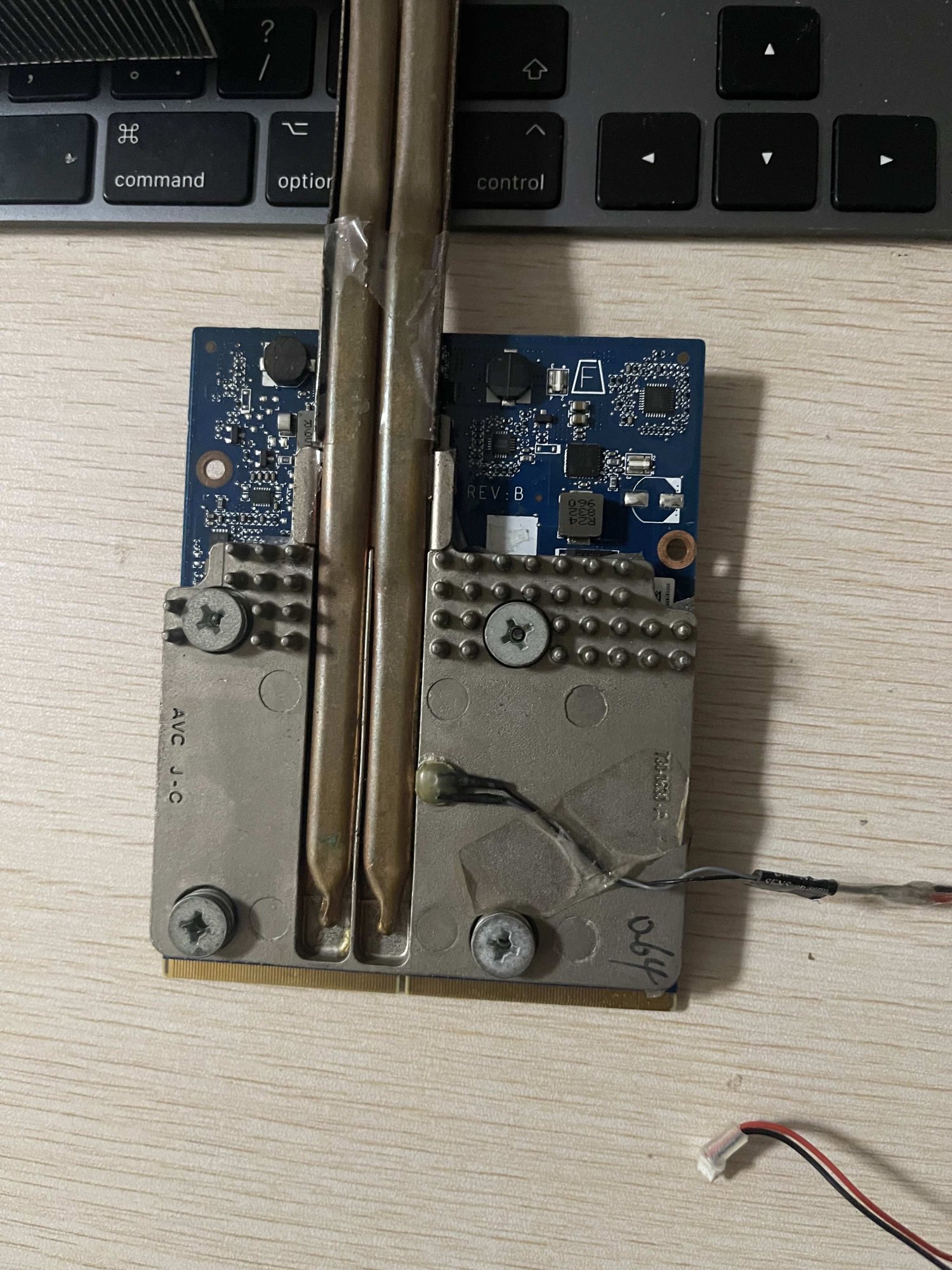

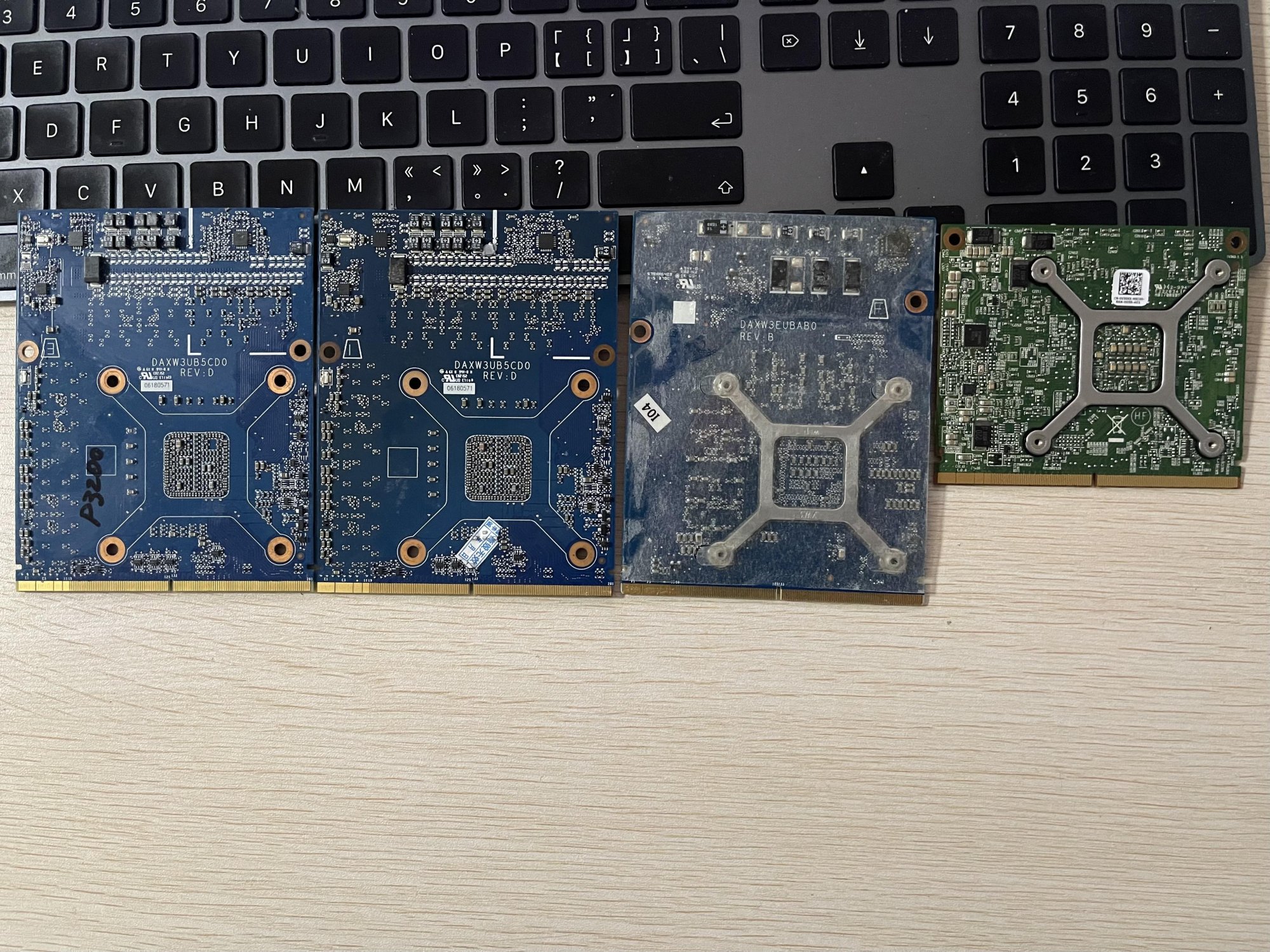

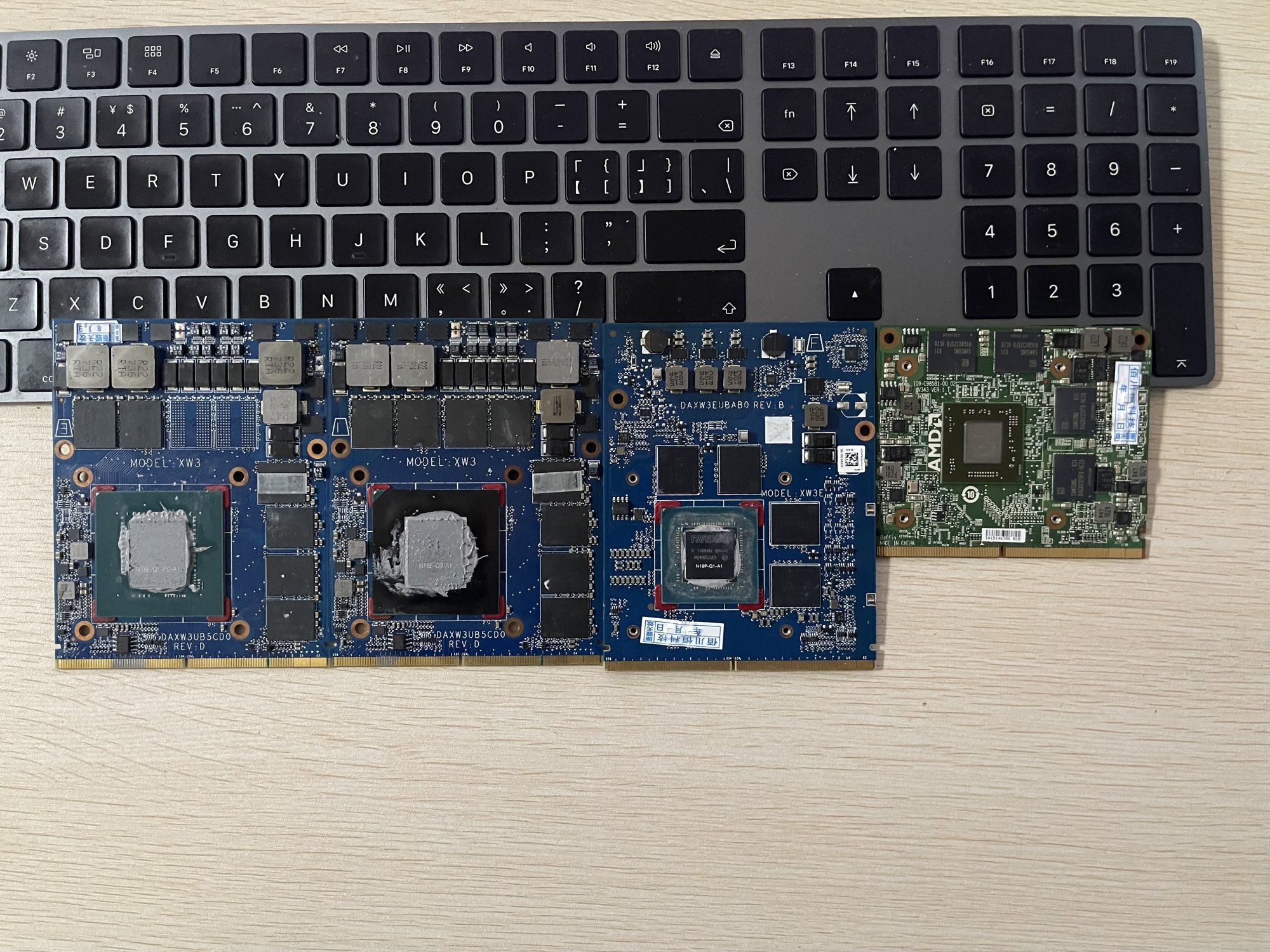

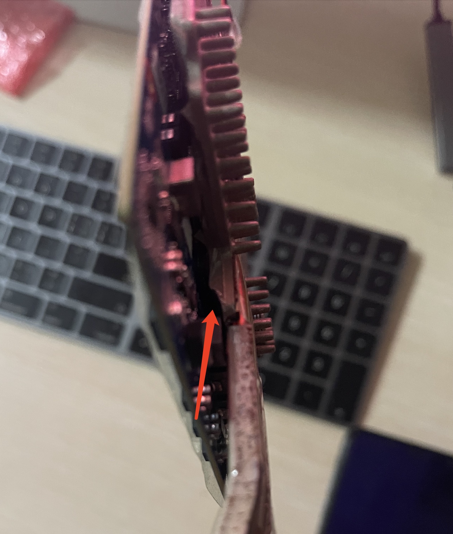

Power consumption is relatively low I used two heatpipe heat sink modified to install perfectly. I tried the three heat pipe radiator installation needs to be modified too much.
I recently purchased p3200 p4200 wx4150 t1000 respectively, wx1450 just compare wx4130 test windows macOS system performance there is no difference, only the difference in video memory size, however wx4150 price is too expensive than wx4130 not worth it.

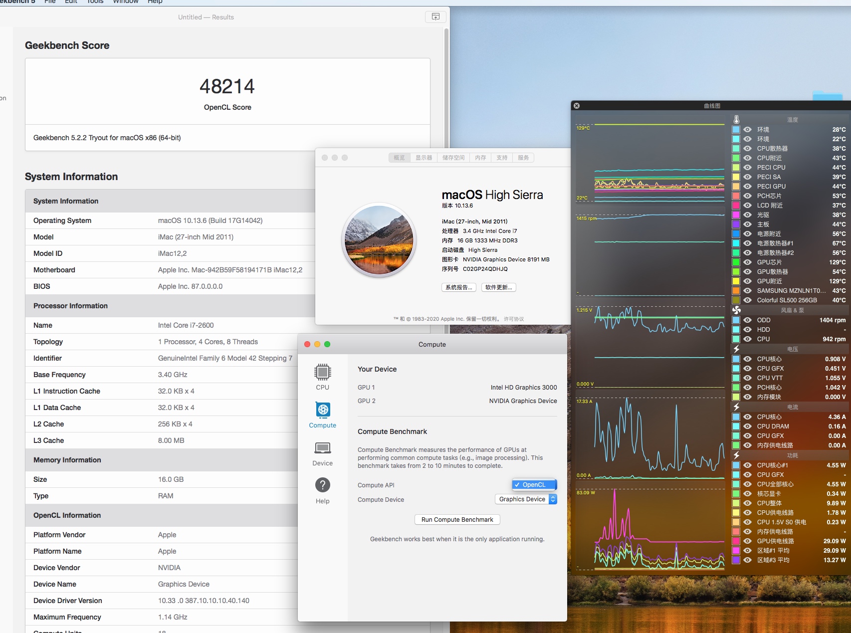

Have been testing to modify the p3200 p4200 macOS system driver normal system brightness failure does not work, there is no progress hope to know how to call the solution to provide help. Thank you all
Reactions: Nguyen Duc Hieu

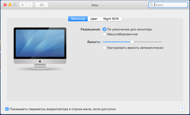

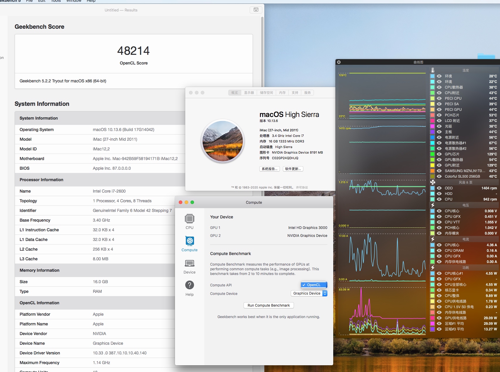

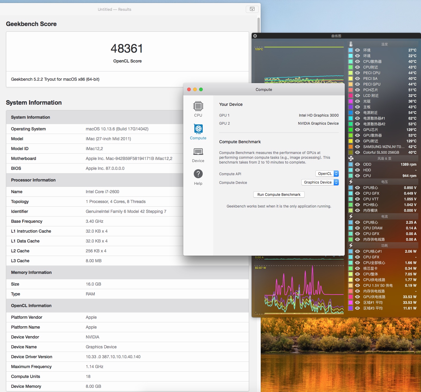

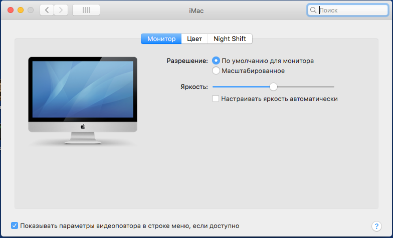

p4200 macOS system brightness adjustment or get progress, brightness adjustment is normal, but also can not display the correct model display universal driver model also need to fix the solution.

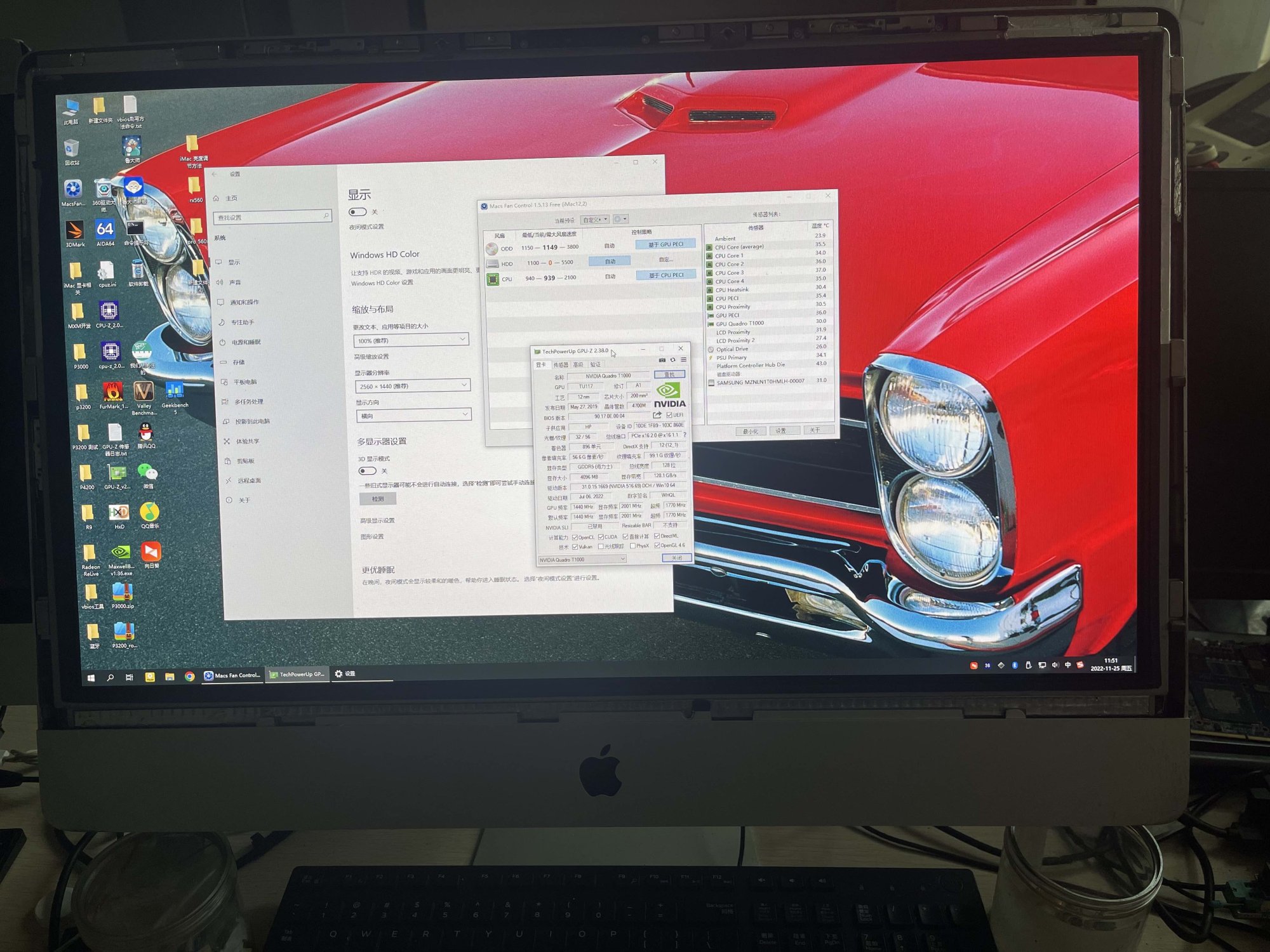

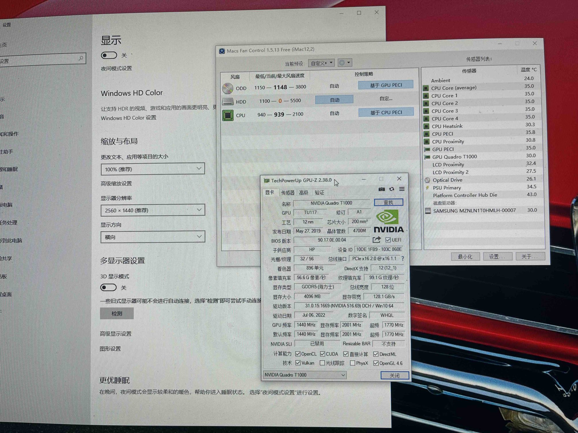

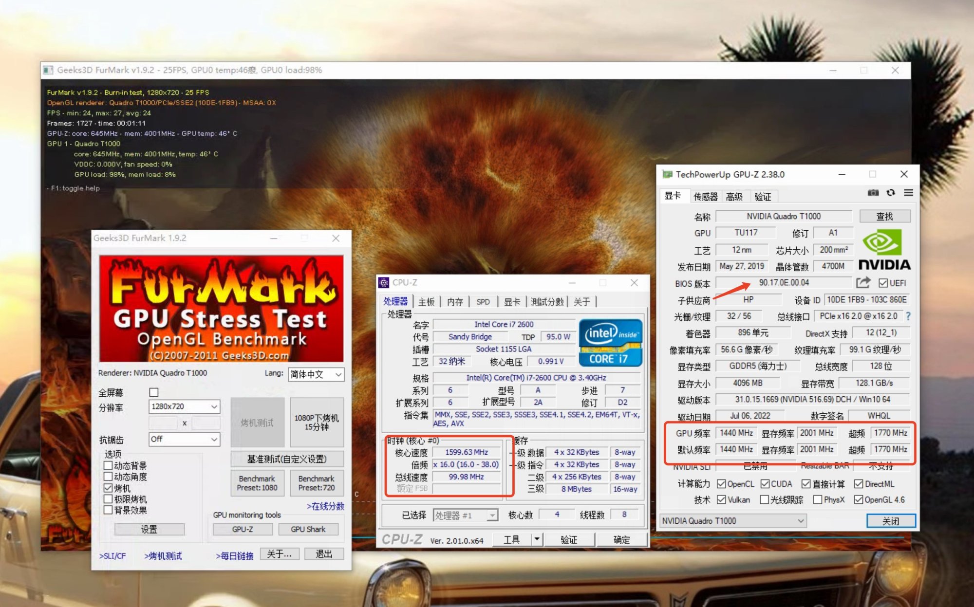

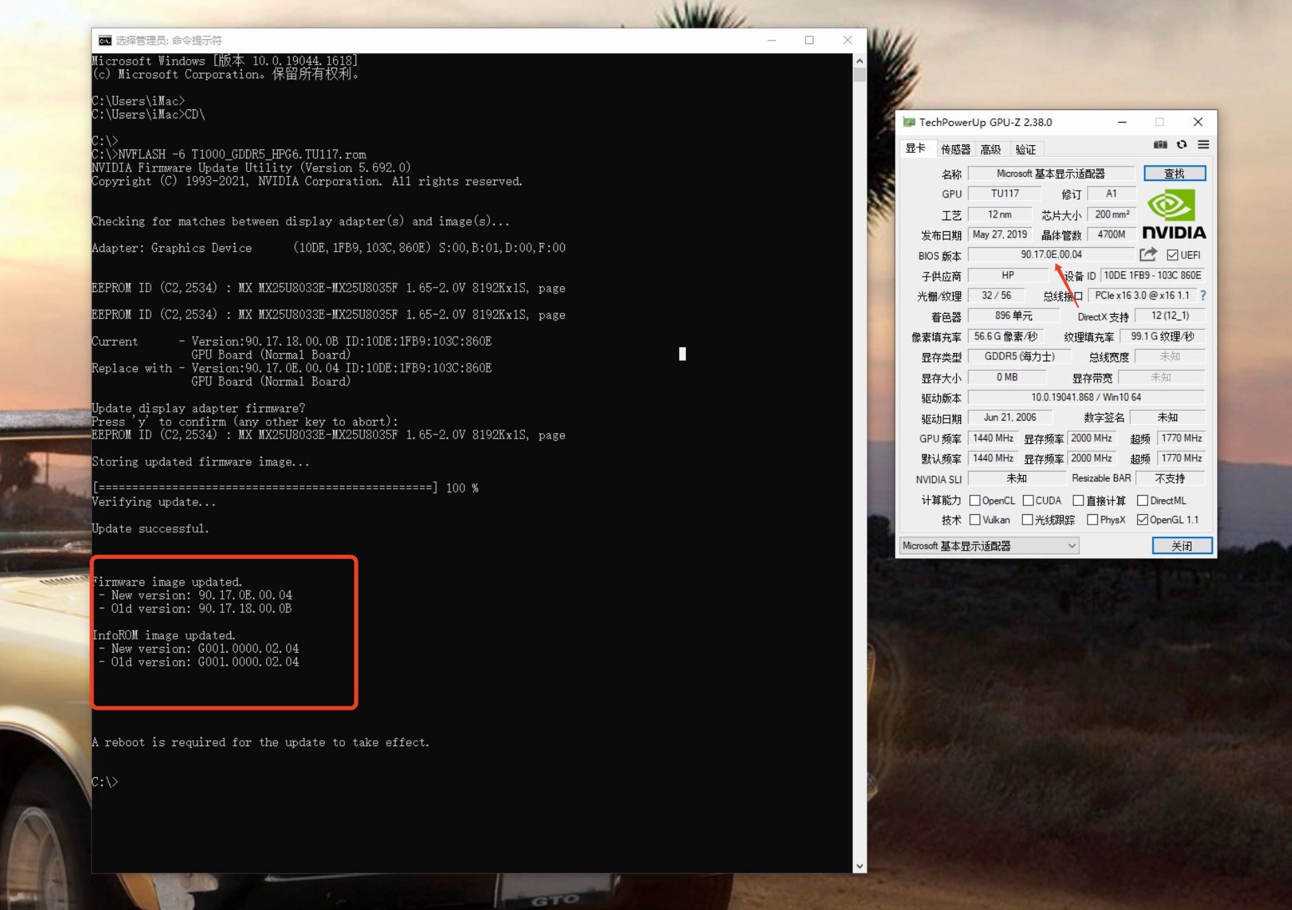

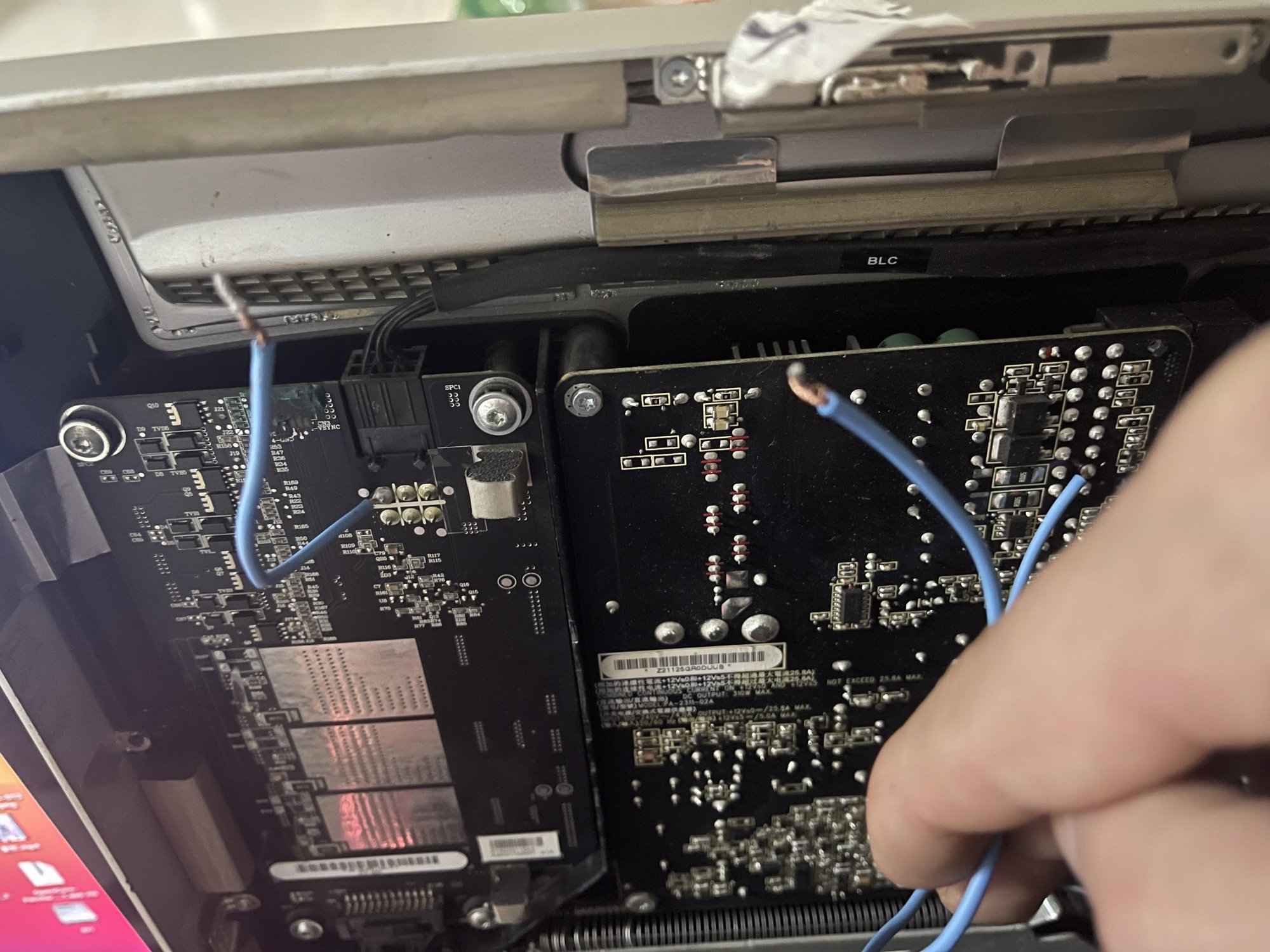

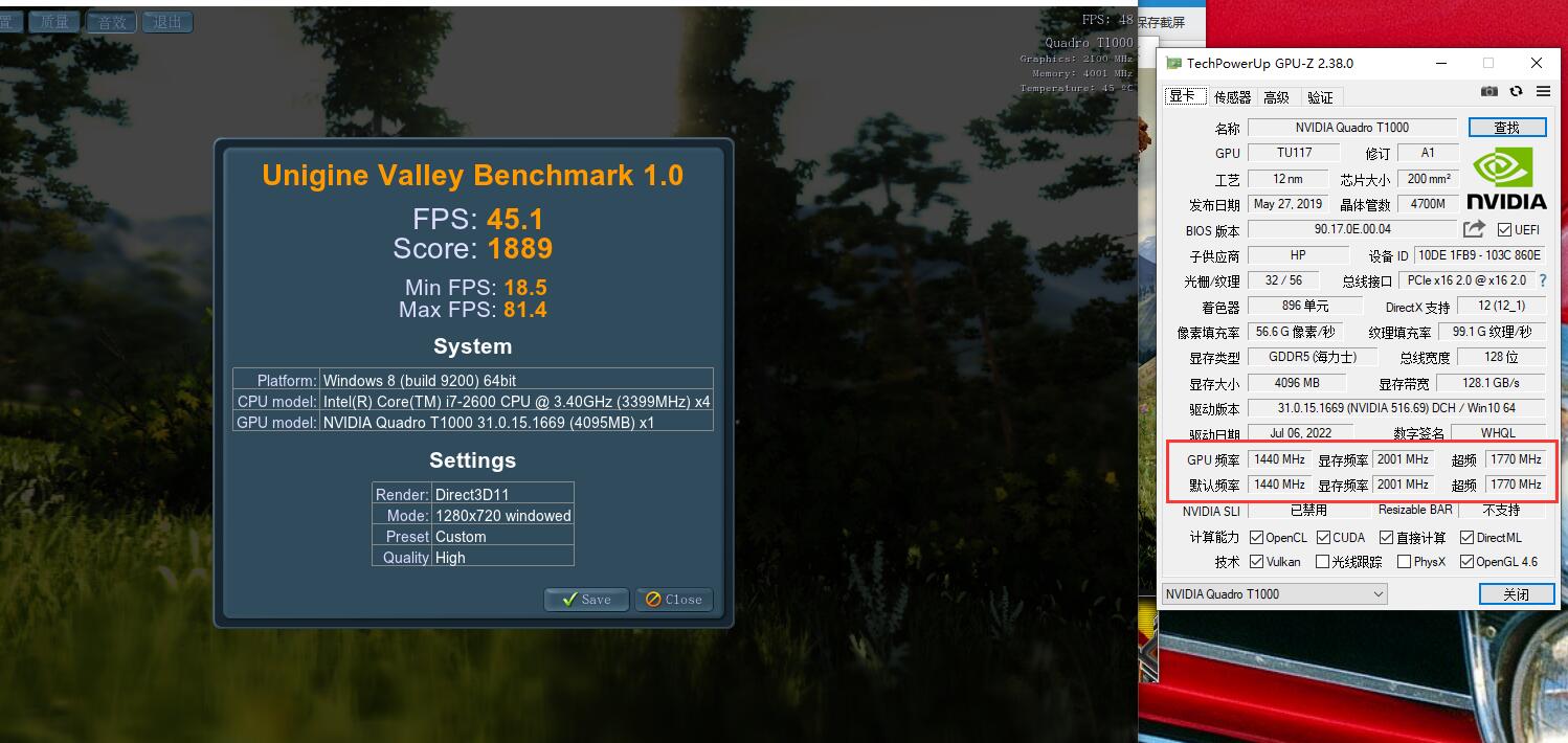

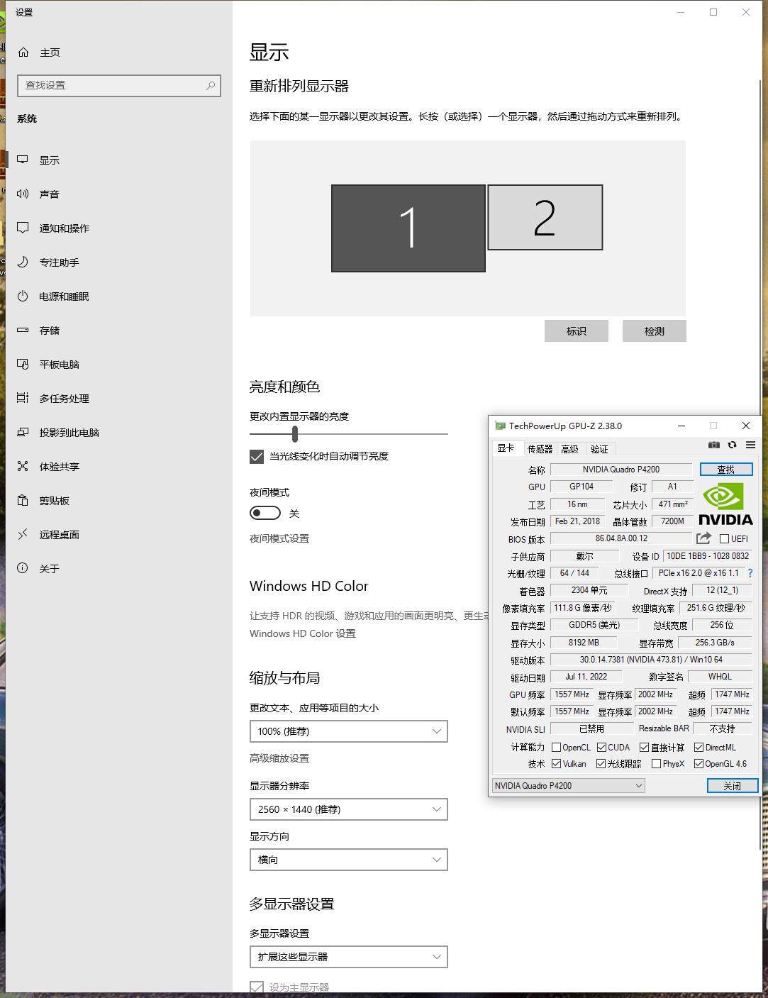

T1000 has been able to screen display only the screen brightness can not be adjusted to maintain maximum brightness.
Performance is also not normal without RWD has been maintained in the most basic frequency performance is very poor.
Connect the backlight p3200 P4200 WX4130 screen brightness also can not be adjusted to fail. System display can be adjusted, setting the brightness without any change.

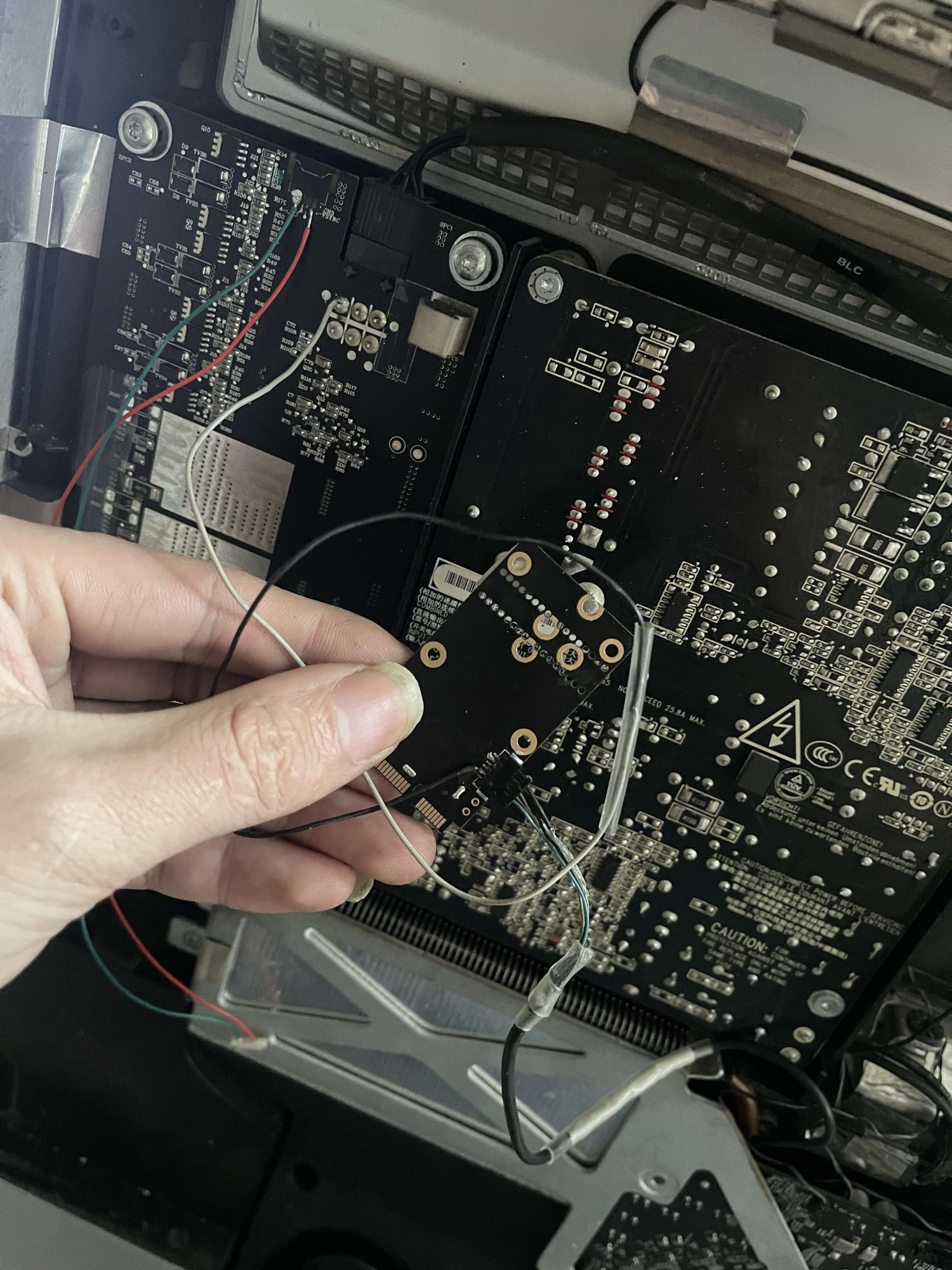

I gave solder on the wireless network card adapter card 3.3v power supply can be displayed.
Connection cable I divided into two sections when needed to connect long, disconnected when not needed.

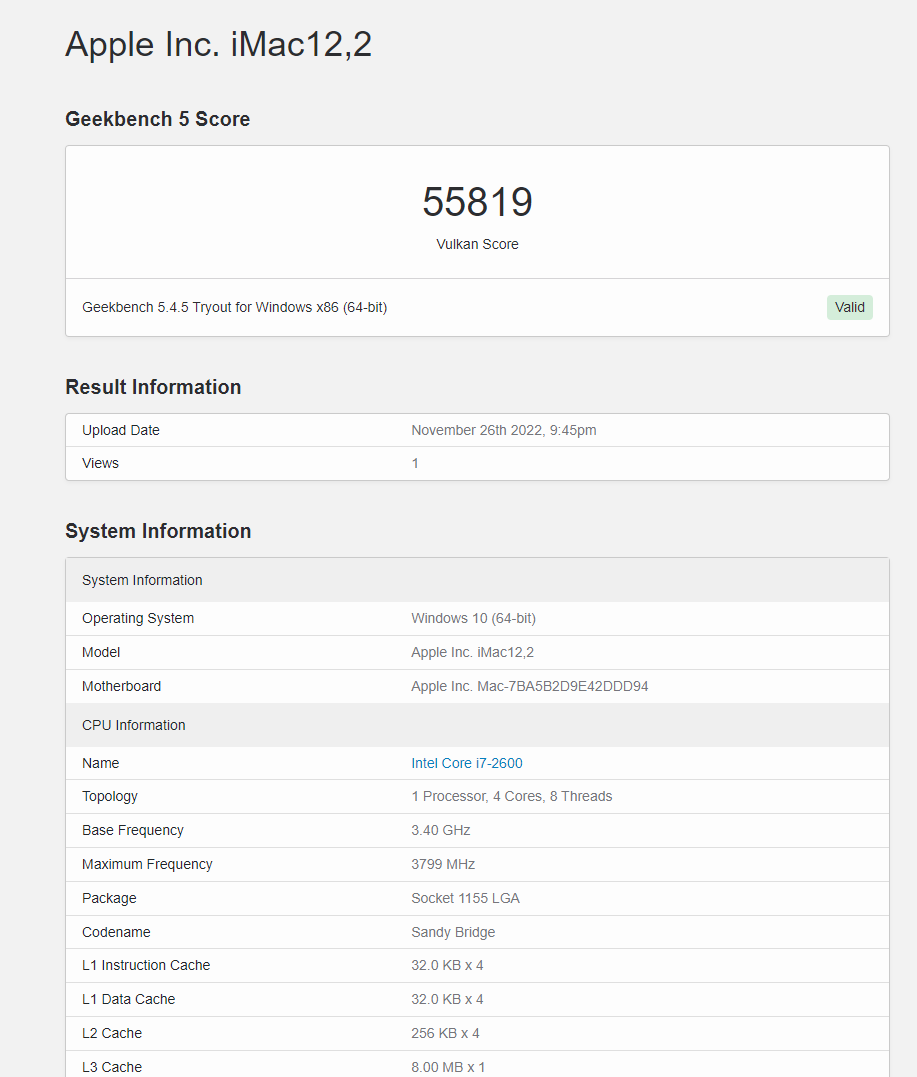

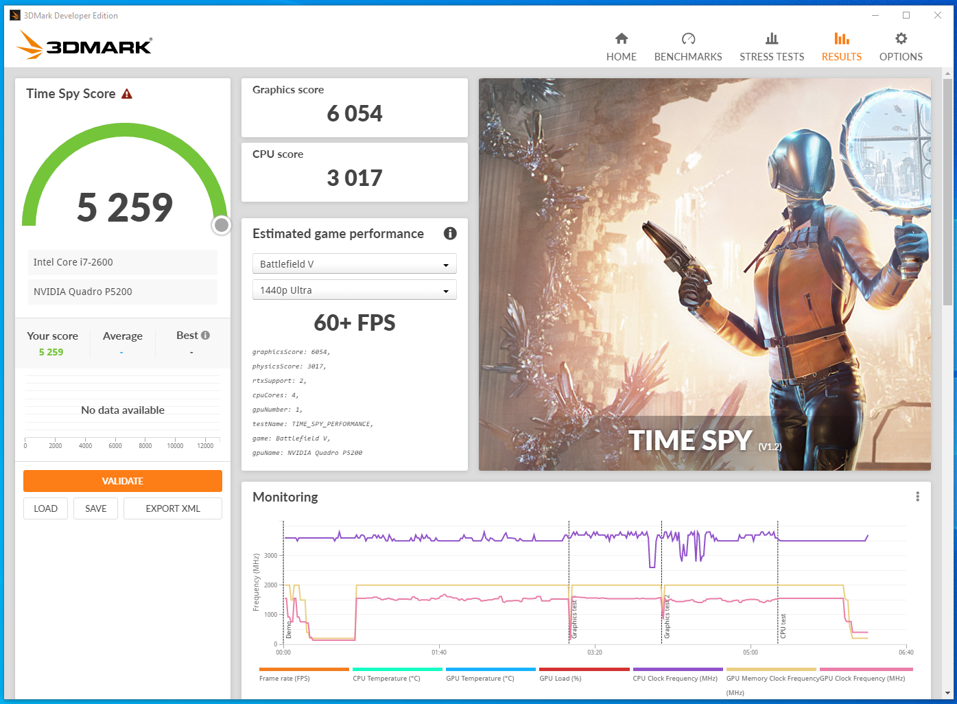

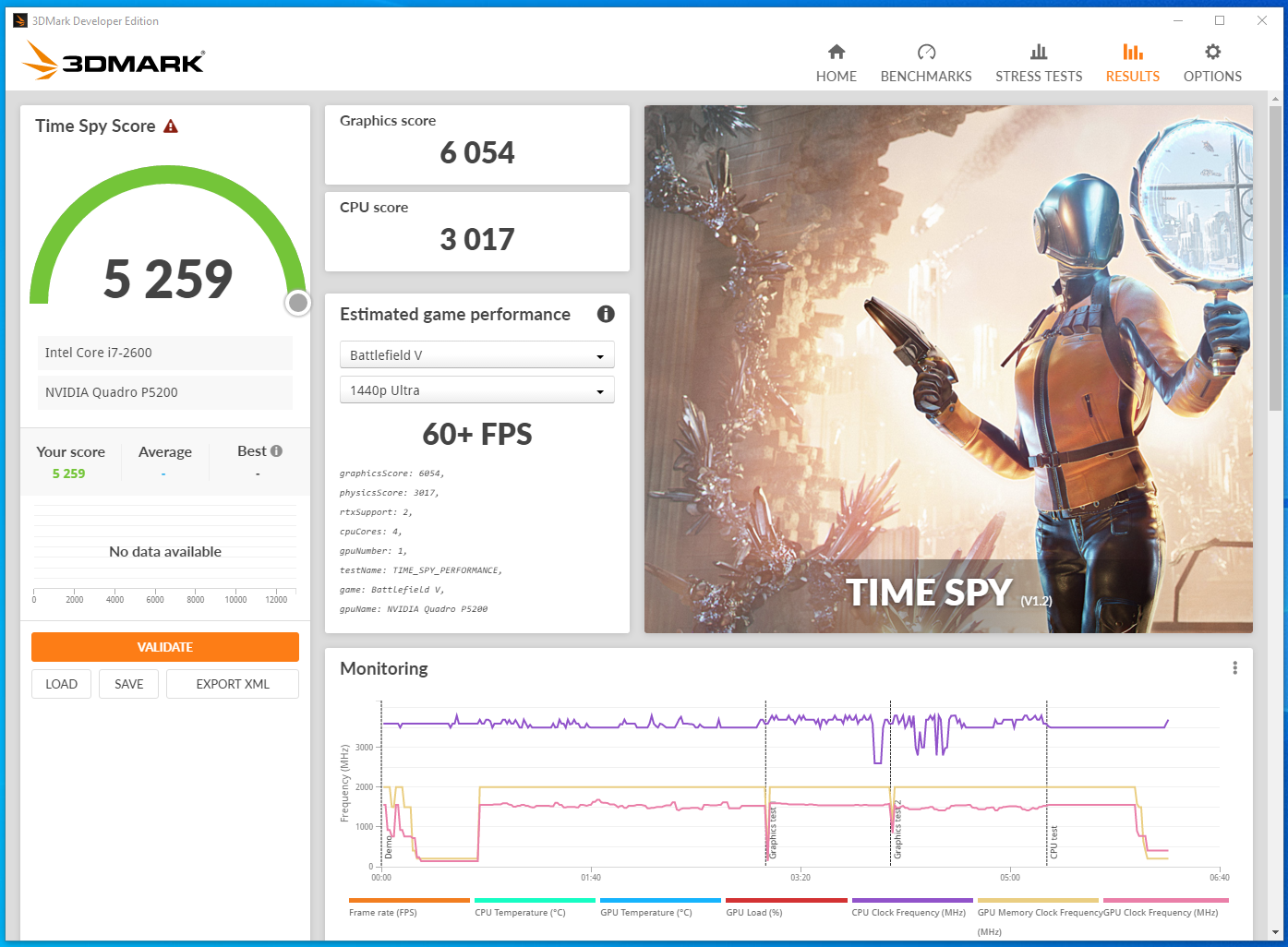

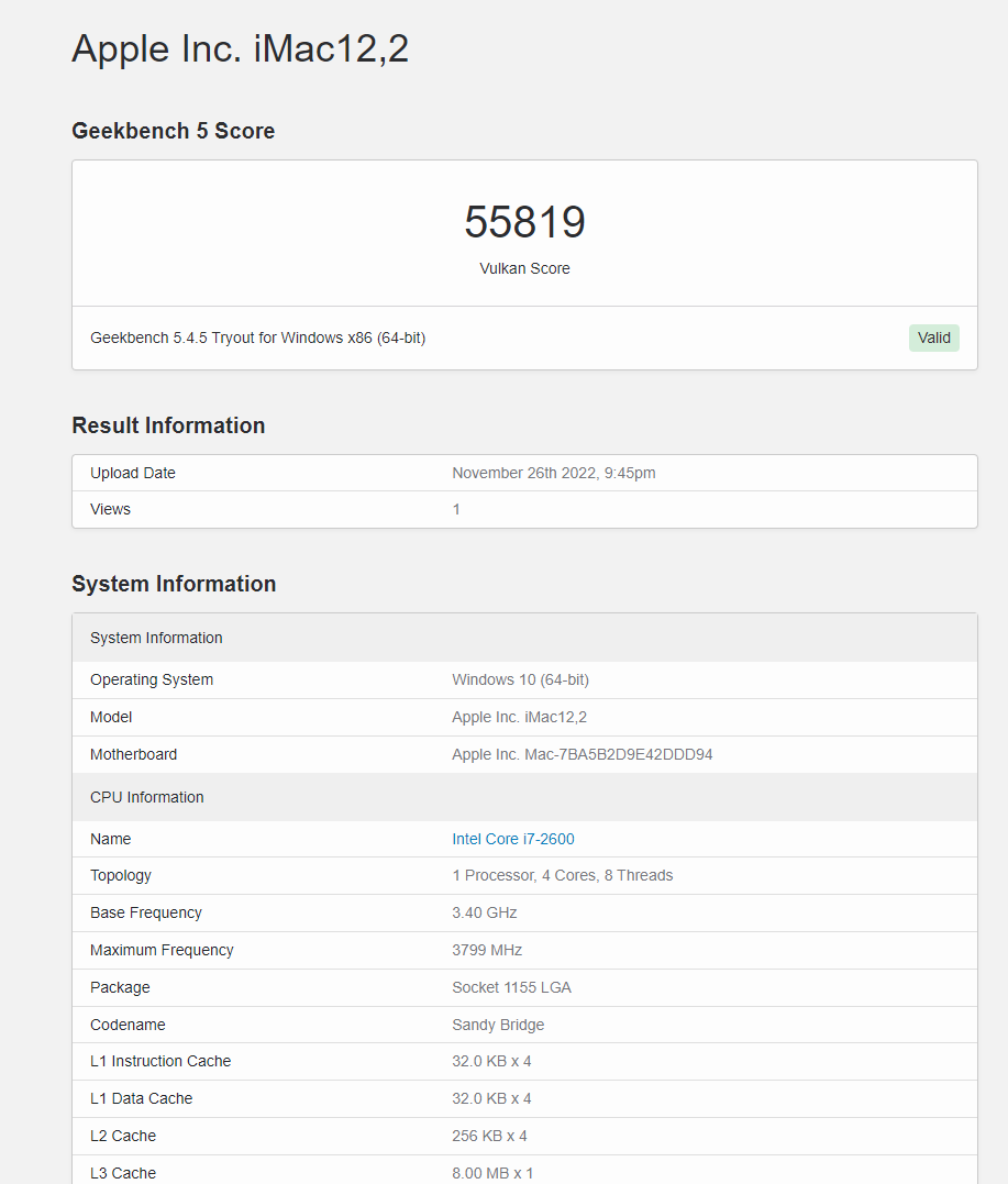

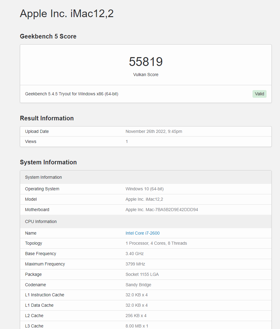

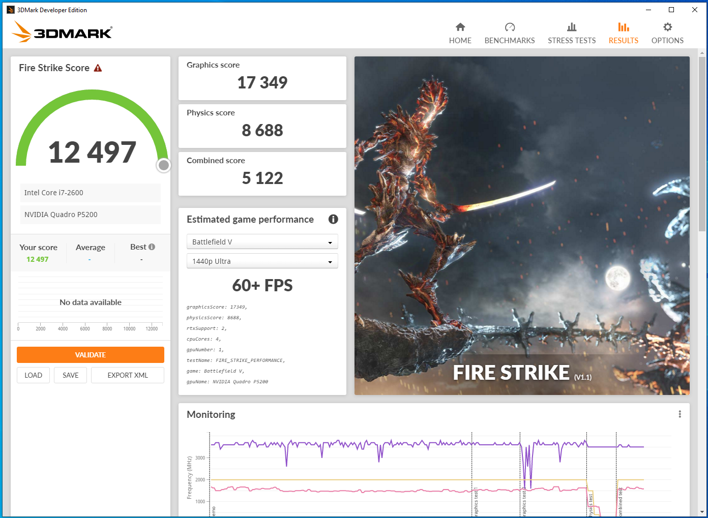

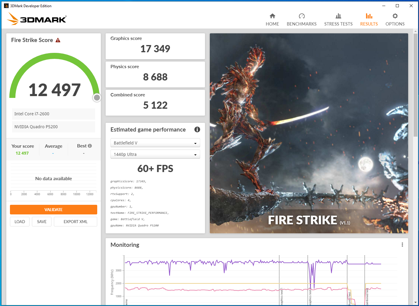

1.png2.pngFIRESTRIKE_mod3_125w.pngGeekbench_Vulcan_mod3_125w.pngmetal_125w.pngTIMESPY_mod3_125W.png

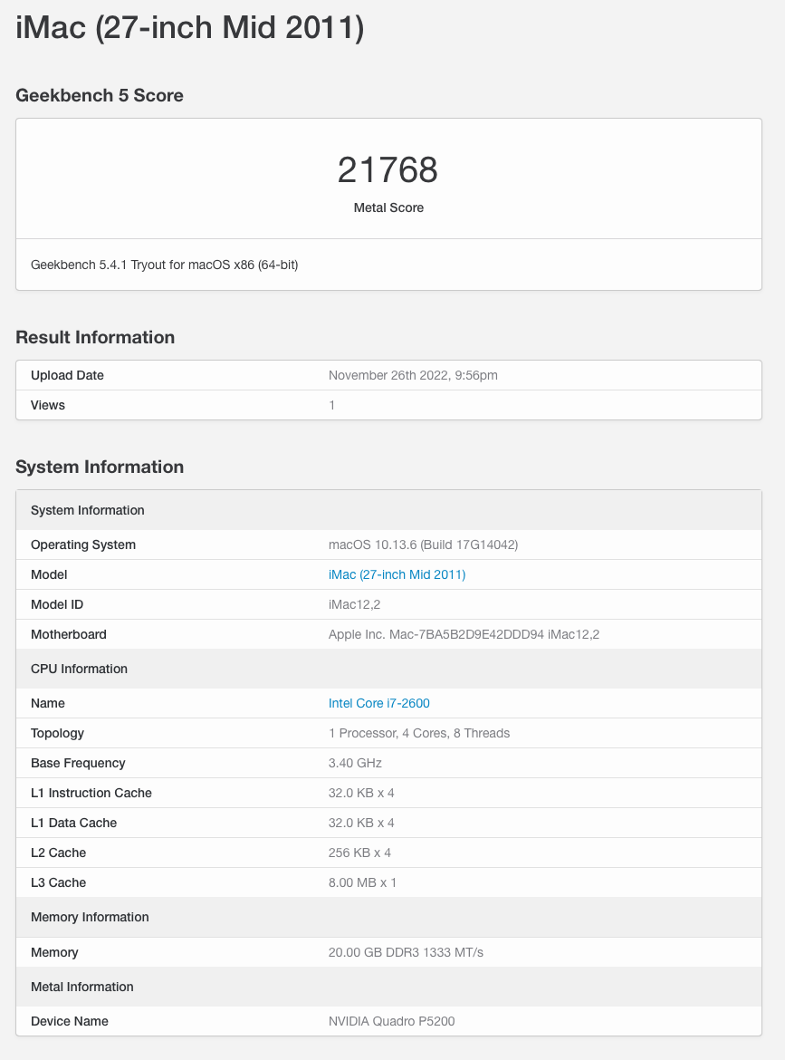

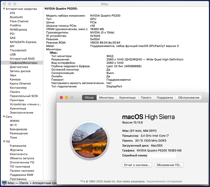

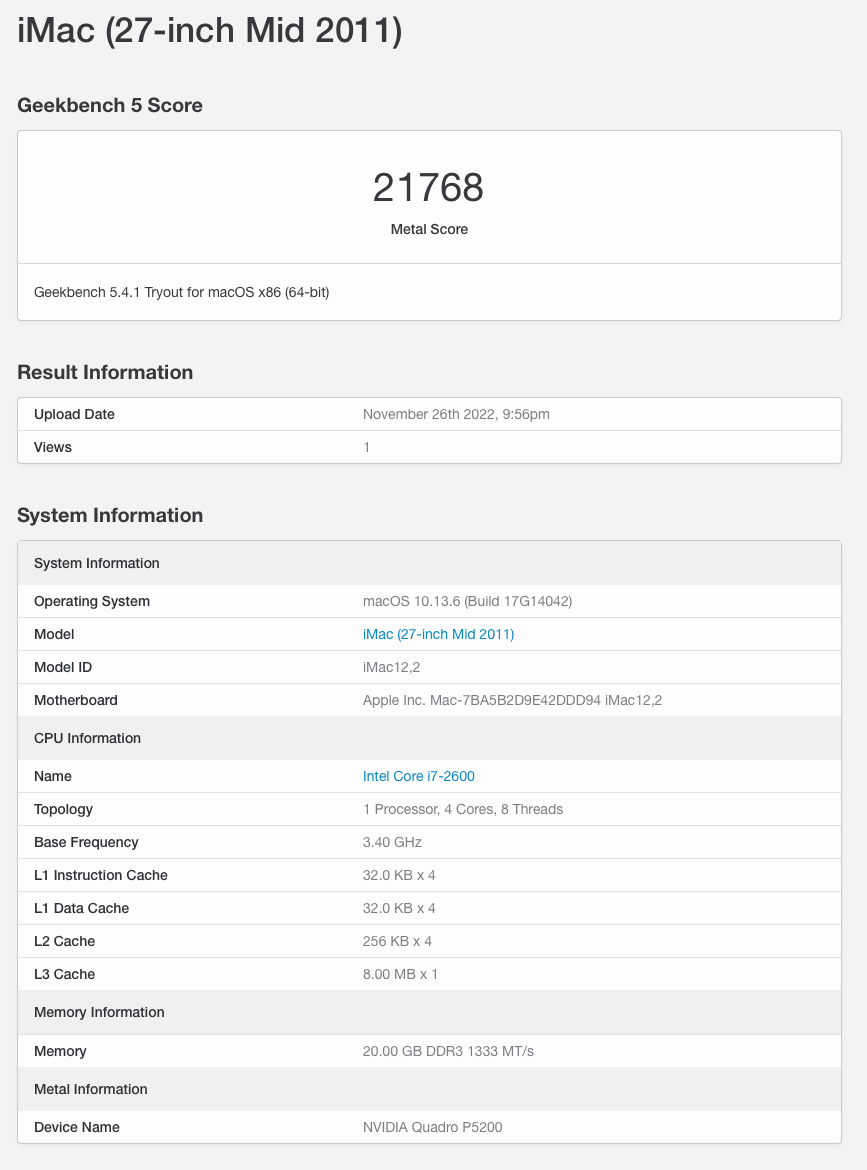

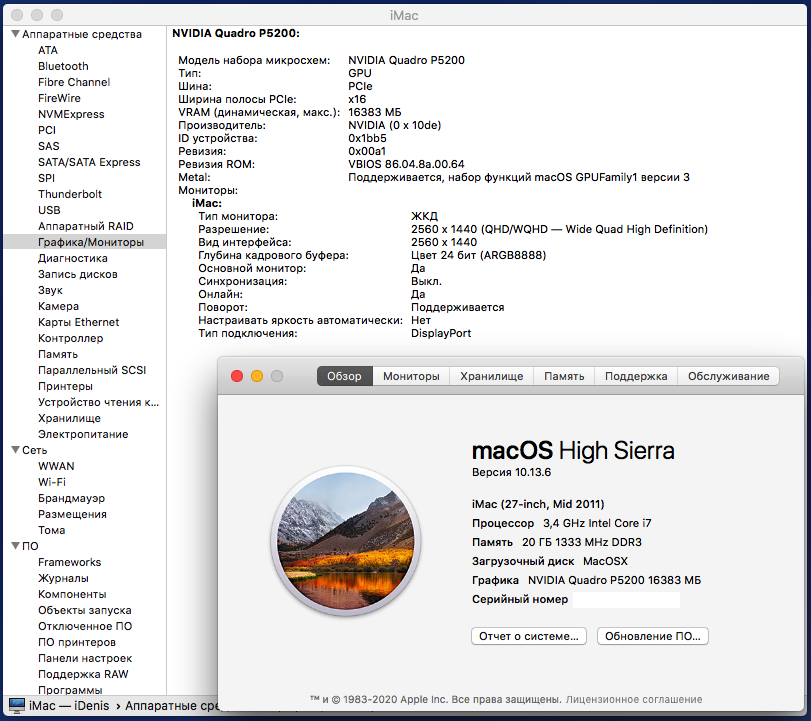

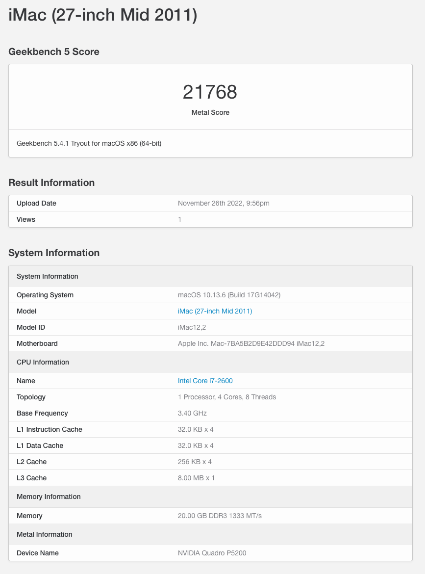

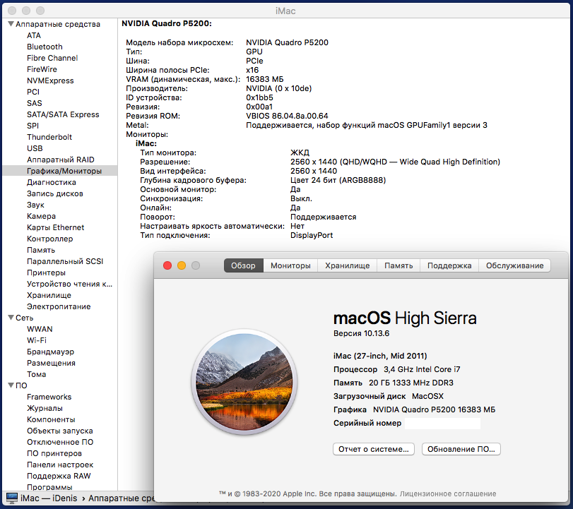

I checked the video card quadro p5200m. It is not necessary to isolate the smbus track. Plugged in and works perfectly.
Shows the model correctly.
Works adequately max 68 degrees.
The brightness control works. Thanks to him m0bil.
