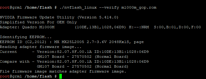

Tried to flash vbios from P4000 max-q which has lower tdp. Flashing worked but after installing nvidia driver it had some freeze from time to time and was stuck around 600mhz clock. This is propably not having optimus support? So came back with no success.
I am testing now core clock 1797mhz with TDP limit 112W. Max temp is about 75-76. Lower TDP helps to keep this baby under 80 degrees. So finally 112W is my sweet spot.

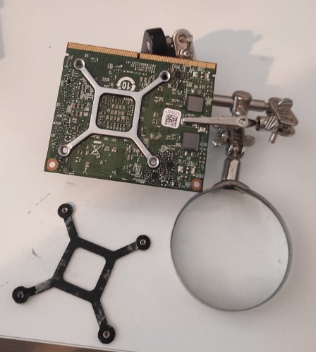

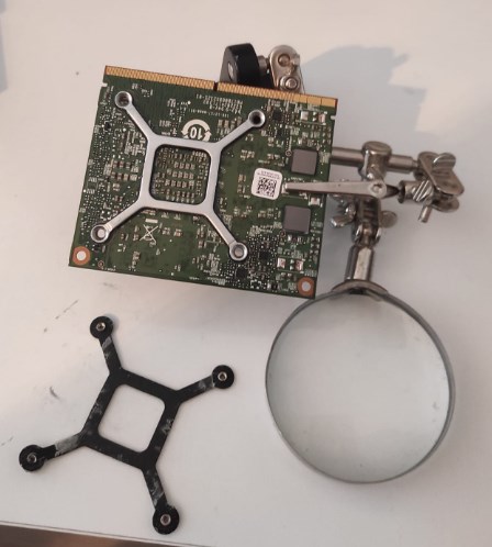

I have successfully installed and flashed a quadro m2000m on my old imac 2011 (27").
I was quite lazy on setting up OpenCore before, when I could actually see a starting menu, also because I can't really wrap my head around it.
So now the computer boots blindly with grub2 to linux, and I can work on it via ssh, but no screen ever 😛.

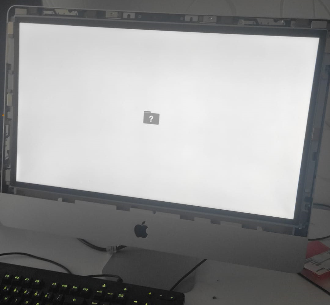

I think I’ve messed up somewhere while reinstalling the radeon.
I had to order another flex cable since I was in a hurry to close the thing a connect it (life with kids around) and destroyed it (the pins in the pcb looks unaffected)
So even with the new cable and the old radeon on, the screen remains completely dead.. I’ll have to check all over again (maybe/hopefully I haven’t re installed the gpu correctly).
Do you know if I could have killed the screen with some bad connector? is there a way to debug the lcd?

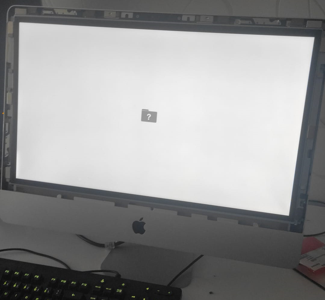

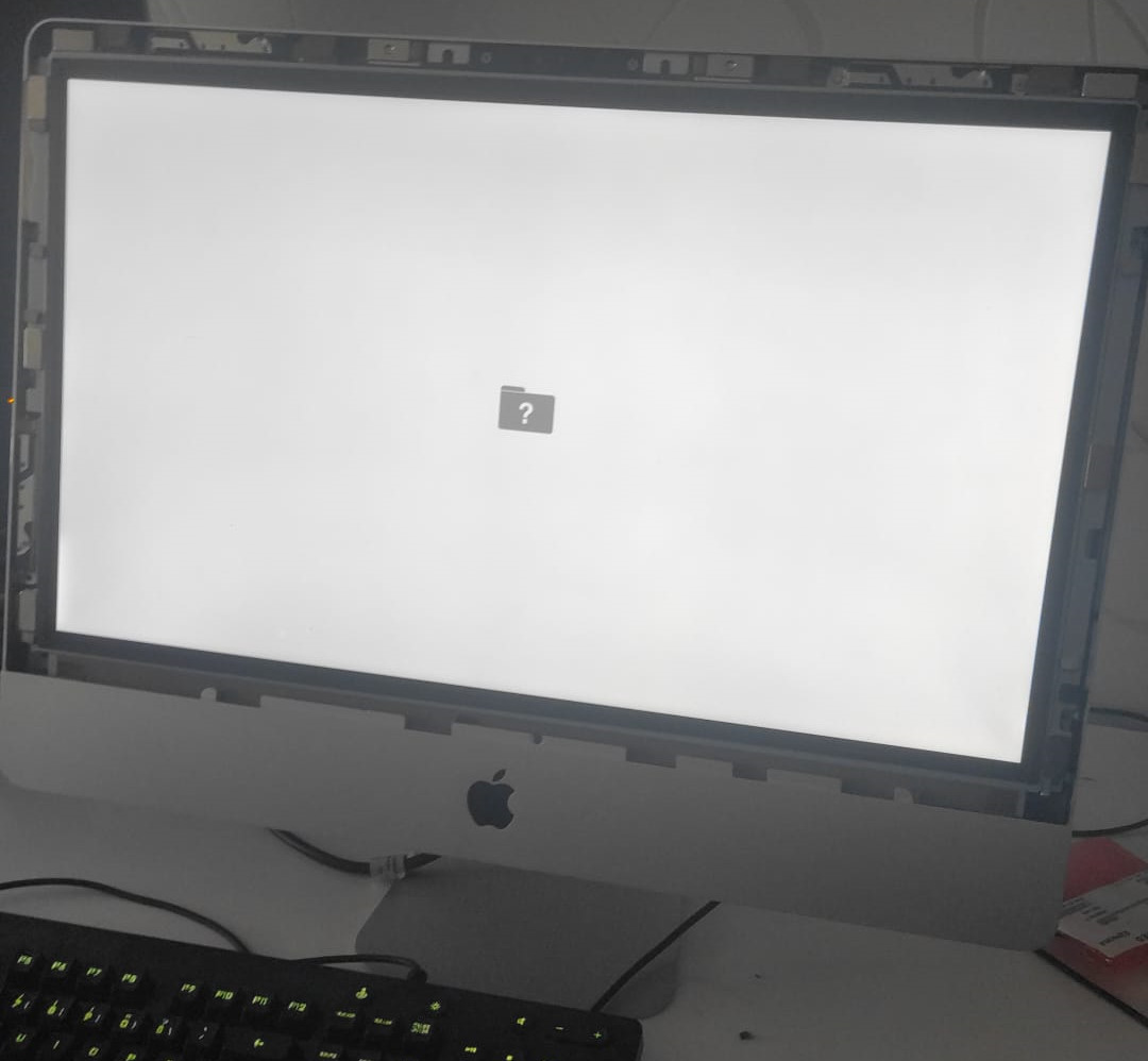

Ok, the thing is back alive. I swapped the old radeon back, made a somewhat booting EFI/OC folder using the recommended settings to reload the nvidia rom, and install the quadro M2000M back again.
However, the screen still doesn’t respond. I’ve reset the pram, just in case it was something like that, but no.
The mainboard has 3 led turning green (1-2-4, the 3rd led, if there is one, doesn’t light up at all).
I flashed the quadro with the first rom suggested in OP (for the corresponding board).
I was planning to install the OS with all the drivers afterwards, but maybe I need to do otherwise

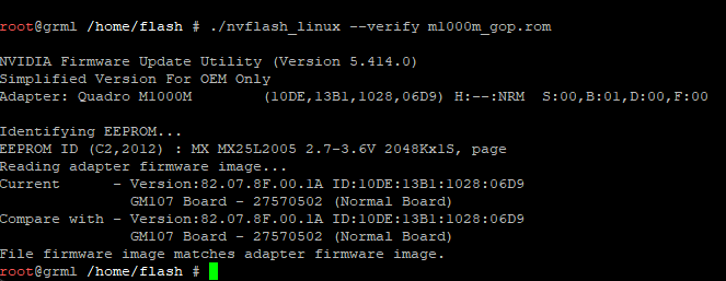

Success story: I got an iMac12,1 for free with a broken GPU and broken ethernet. I bought a cheap (25€) Dell NVIDIA Quadro M1000M (Maxwell, MXM-A). The first issue was that the DELL backplate didn't fit into the iMac cooling and was glued, so i removed it with a hairdryer and replaced with the stock one from the iMac.
After the GPU was installed in the MXM slot, i disconnected the HDD and SSD (so that it automaticly boots from the USB drive) and tried to dump the vbios with GRML. This was not easy due to no networking. I used an usb ethernet adapter and tried to boot GRML from usb. For whatever reason, the newest GRML froze at starting (this one) so i used an older one. (2011_imac_usb.zip) This one worked perfectly.
By default, the second USB network card is not enabled, so i typed commands blind on my keyboard to enable it. Maybe it can help someone in the future:
(wait until GRML is booted)
enter
netcardconfig
enter
(wait 5 seconds)
arrow down
enter
(wait 10 secs)
enter
enter
(wait 1 min)
enter
right arrow
enter
After this i dumped, patched the bios on my mac mini (with OpenCore's EnableGop tool) and verified the firmware.
Result:
I also tried OpenCore Legacy with Nvidia GOP injection before patching, but for whatever reason it didn't worked.
Result:
Looks like everything went well, the iMac misses an operating system to boot.
Try to create an High Sierra USB installer and start up the installation.
EnableGop seems to work since you have a working display, in addition the correct eDP support was already included in your base vBIOS.
You may upload the modded and original vBIOS? (both zipped)
