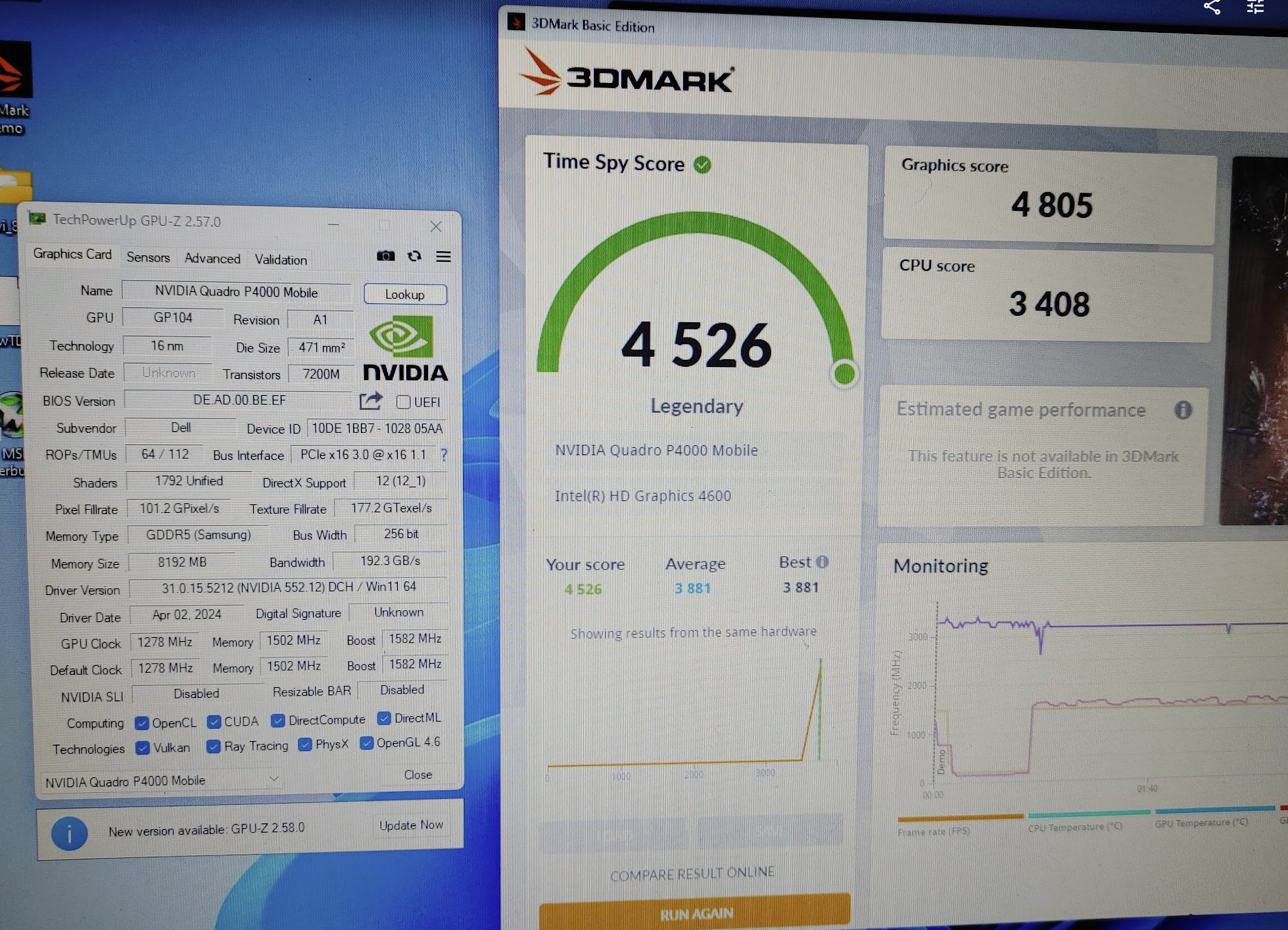

I would like to thank you to user m0bil for making oc bios for P4000. Your vbioses are pure gold. I can confirm that your bios is working on my Dell version P4000 and MSI 4th gen laptop. Flashed vbios with Ch341a and 1.8v adapter. I also had to modify nvidia inf but all is ok. This gives me +400mhz on core clock. Firestrike went up from 10500 to 12100. Playing the last of us gives me about 5-10 fps extra. I use 100w version. My laptop bios is in legacy mode so maybe this is why this vbios is working. Could you make also one vbios with higher memory clocks? or at least tell me where are placed memory clock values when using hex editor. thanks :)
Reactions: Nguyen Duc Hieu

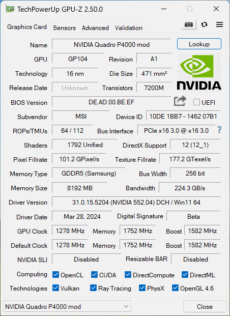

@macfev Hah! Just signed up to report the same thing! Just tried @m0bil 's OC vbios in an Alienware P18e and my Timespy score went from 4000 to 4800! Many thanks!

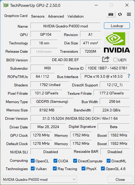

I think I also found where are memory clocks located. Today will try to flash my mod. If it works then we will have bios with 1750mhz memory clocks. ;)
Holy shet that's exciting! Timespy 5000+ letsgoooo

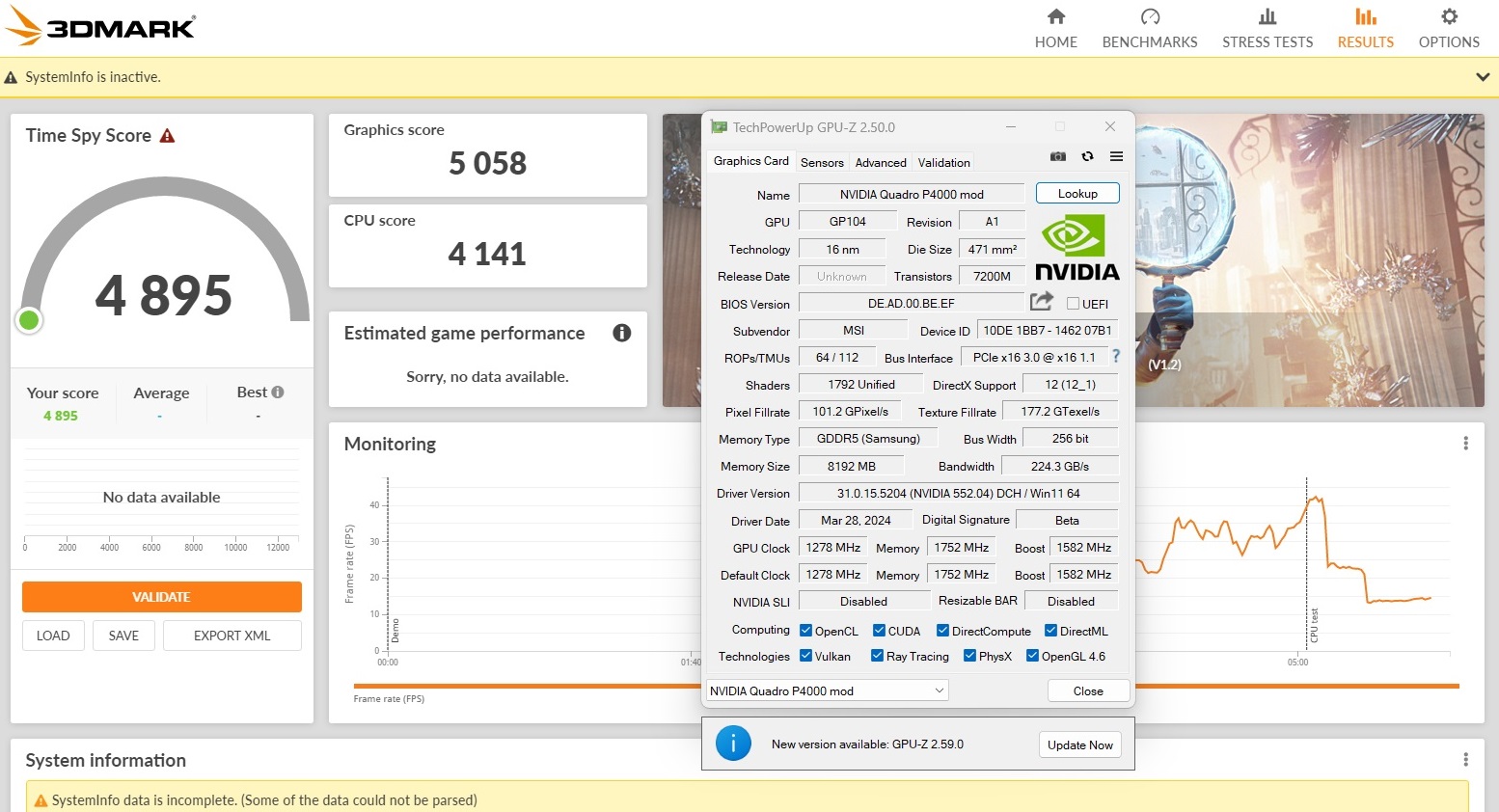

And its working! But I was expecting higher benchmark scores. It seems that card is more blocked by "low" core clock than memory speed. I also rised tdp to 107w. I am considering what TDP to set because I dont want to burn my laptops mainboard 😅 This card when hits TDP limit downclocks to around 1600mhz, sometimes even 1550mhz. Rising TDP would make clocks more stable at higher values but how this will affect mainboard in longterm??
Best thing now would be to undervolt gpu. I noticed that our gpu max clock goes to 1657.5mhz and then it uses 0,881v. What is funny that if max clock was 1657mhz it would use only 0,875v 😅 1mhz lower clock would improve performance by not hitting tdp limit so often.
Dont know if I have skills to find voltage values. I would love to undervolt to 0,85v

Nice! I've got plenty of thermal headroom still in my Alienware chonker - GPU still barely hits 70c so I wouldn't mind increasing TDP limits a bit.
There's @m0bil 's OC3 vbios that increased the TDP to 115w and max clock even futher. They also increased the voltage a bit in their original OC vbios so maybe they can comment on where to tweak that?
@macfev If you don't mind tweaking the OC3 vbios file with your mem OC - i'd like to try that out just to see how far I can push this thing without running into thermal problems.
OC3 has higher clocks and voltage so core clock will fluctuate even more. You can try this one and let us know how it performs. I dont think it will be much better, maybe 5% improvement over normal OC version. Problem is that mxm 3.0b slot has tdp limit 100w so everything above is risky for mainboard.
Wait is it really only 100w? I thought MXM 3.0b had a max power rating of 200w? Though i imagine this would vary per device. I've got a 300w power brick - i wanna use the whole 300w :p
Tommorow I will make mod with TDP 120W. My card uses mostly 90w-100w in the last of us so I think this should be safe for mainboard. I expect about 5000 in timespy.
Please share if it works out!
This gpu is very power hungry. I set it to 120w but it still downclocks :cool: This happened in benchmarks so propably in normal gaming will not occure. Going higher with tdp limit could damage mxm 3.0b slot 😅
Now we need undervolting. Some guy with his 1060 mobile was able to do 0,8v and 1800mhz core clock. We have plenty space to undervolt! ;) He made it with msi afterburner and curve editor. Dont know if it will work with this card. 🤔
Today will test this vbios and if all is ok I will upload it tommorow. :)

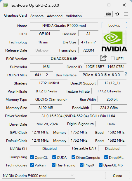

Quadro P4000M modded rom:
- based on
m0bil P4000M_OC.ROM
- temperature throttle steps increased above 80 ºC
- max TDP increased to 120W 115W ( to prevent spikes above 120W )
- memory clock raised from 3000mhz to 3500mhz
Things to do in the future (maybe someone could help with that):
- unlock undervolting
- find where are located voltage values in bios: 0.85v;0.862v;0.875v;0.881v;0,893v and 0.9v
if you like this bios please consider donating to m0bil . Thanks to his work I was able to mod this bios.
  • P4000M_OC115W.zip

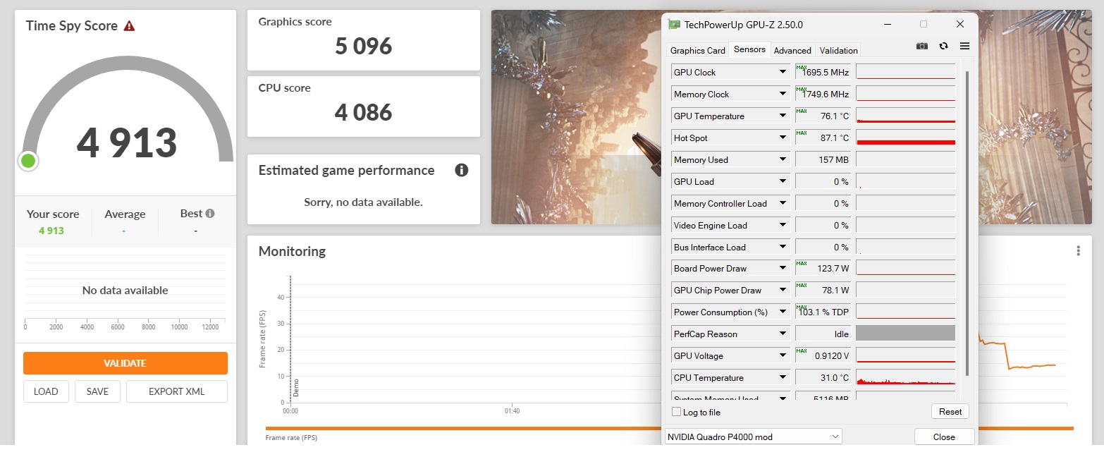

I also tested 1709mhz on P4000 but voltage goes slowly up to 0.932v. This is not worth to use considering only 50mhz boost in clock speed with much higher voltage.
On 1696mhz it looks much better. Voltage goes to max 0.912v 0.925v. So this is max safe for this card without undervolting. There is some voltage stepping, not worth changing clocks higher. its better to stay on 1657mhz.
With undervolt I could go above 1800mhz.
Anyway performance boost is now about 25% comparing to default clocks :cool: I am happy with that ;)

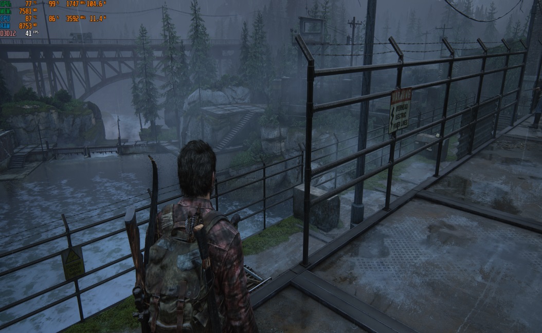

Did some more testing. :cool: I overclocked to 1747mhz and set TDP 116W.
In benchmarks its the same because it hits TDP limit but in gaming I can see nice performance improvement.
This card is not for benchmarks but for gaming. So now I think its better to set higher clocks but lower TDP limit to protect card from damage. It will simply downclock itself when we play on more intence areas. Gtx 1070m has tdp limit 115W so I think I will use this limit.
