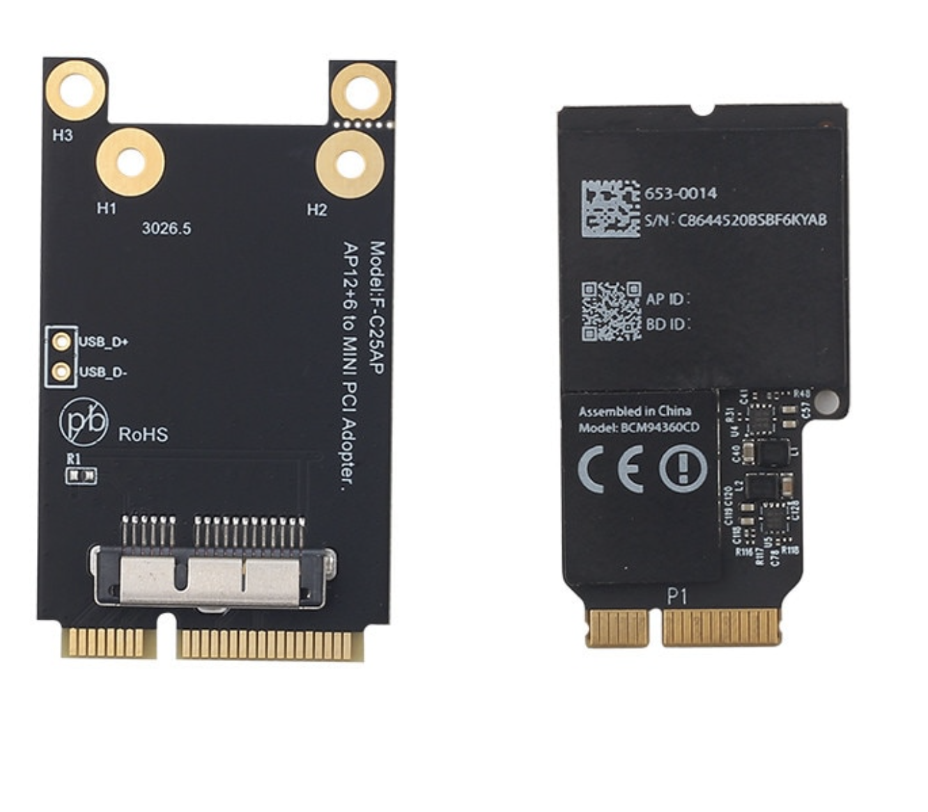

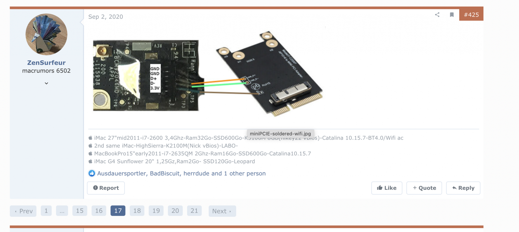

So I got the adapter for the BCM943602CDP module ready to go. I ordered an extra BT power cable (593-1035 B), hacked off the end below, and soldered to the adapter.
I just picked up a late 2009 21.5” and am just starting to look into doing this.
That Bluetooth cable you bought, does one end connect to the existing cable in the iMac and then you solder the correct wires on the other end to the new board for the new card?
Correct, but it connects to the existing female end on the Mac motherboard. Then the other end solder to the BT card. Make sure you double check before you “cut”, as the connectors on the cable are different for each end.

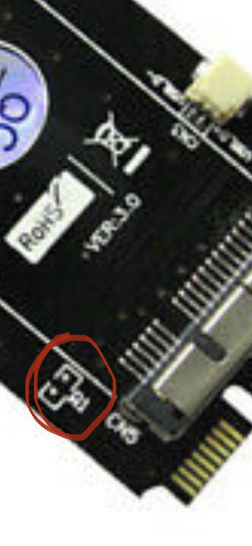

Hey everyone. I’m looking to upgrade to a BCM943602CDP.
with this adapter card, the 3.3v would go to the inner pin in the area I have circled? Is that right?
