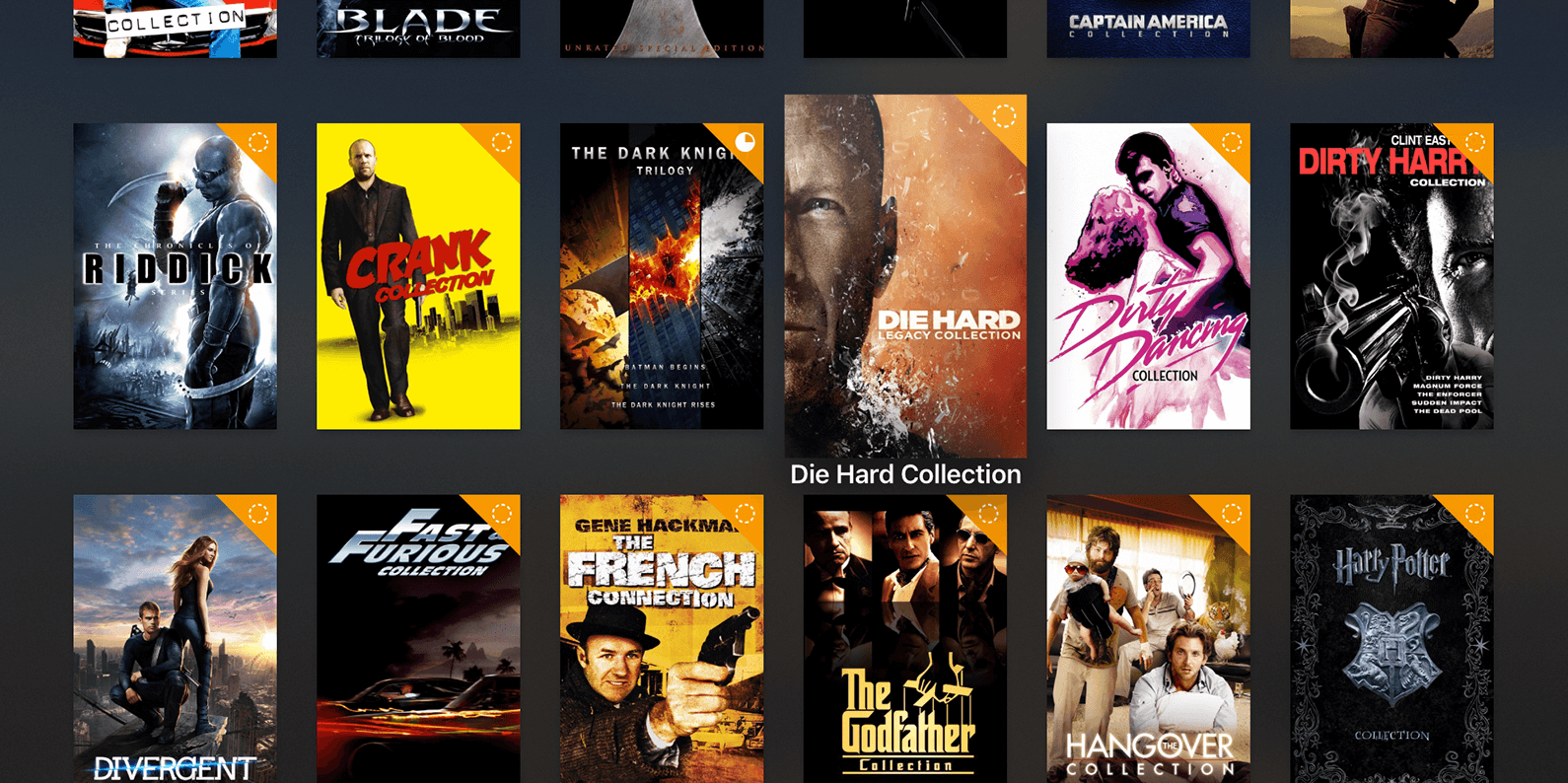

Movie collections
Infuse now automagically tidies up your Library by grouping sequels into collections. Can't remember the name of the second Fast and Furious movie, or the third Bond film with Sean Connery? Wonder no more - just search or browse for a collection and all titles will be grouped together and ordered by their release date. Boom! Collections are available in all existing Library categories, or through the new dedicated Collections section - which may come in handy if you're looking for a full series to binge on.

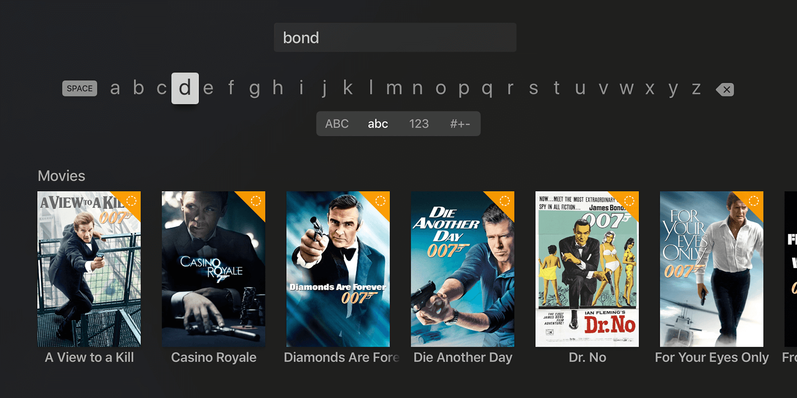

Super-fast search
Find what you're looking for in a flash with our new super-fast search for Apple TV. Search by entering a single letter, or use Siri to dictate a full title. Infuse will instantly start searching for movies, collections, and TV series/episodes. Finding something great to watch has never been easier.

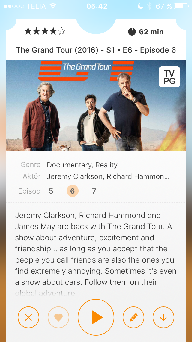

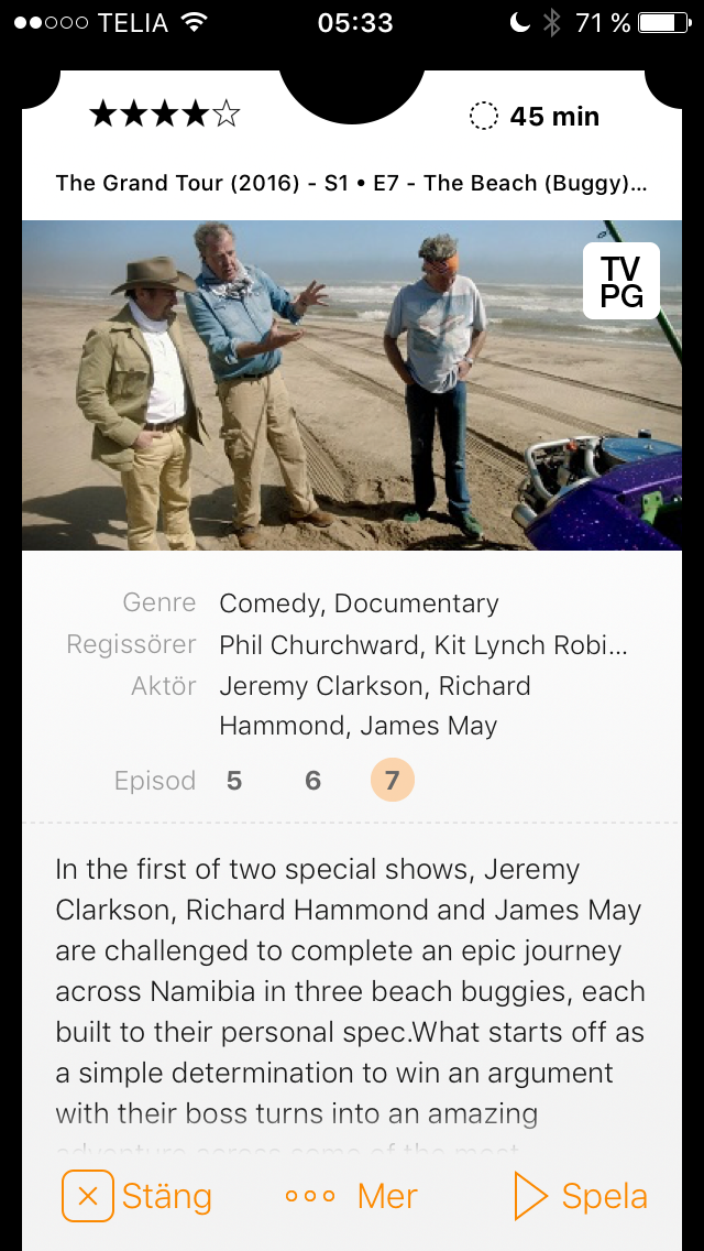

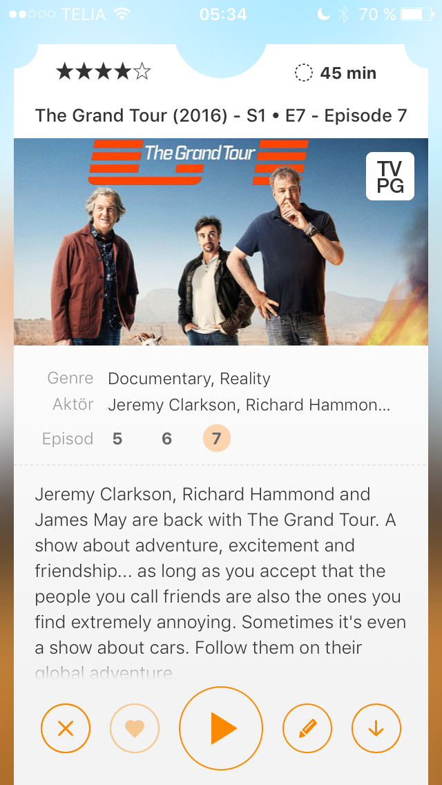

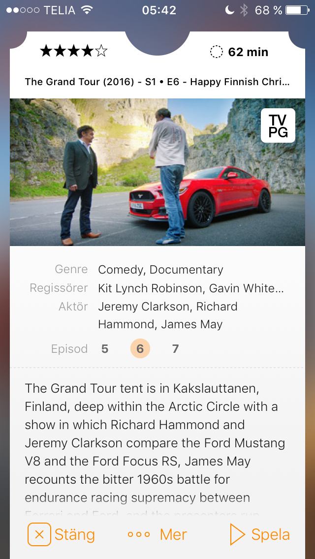

I noticed an bug/change that started showing up during one of the updates to Infuse 5. For all my TV shows it used to show an episode shot as the cover art for each episode now it just shows a generic cover art for each episode.
Hmm, what type of image are you seeing?
It's the same for me too.
It changed with the last update.

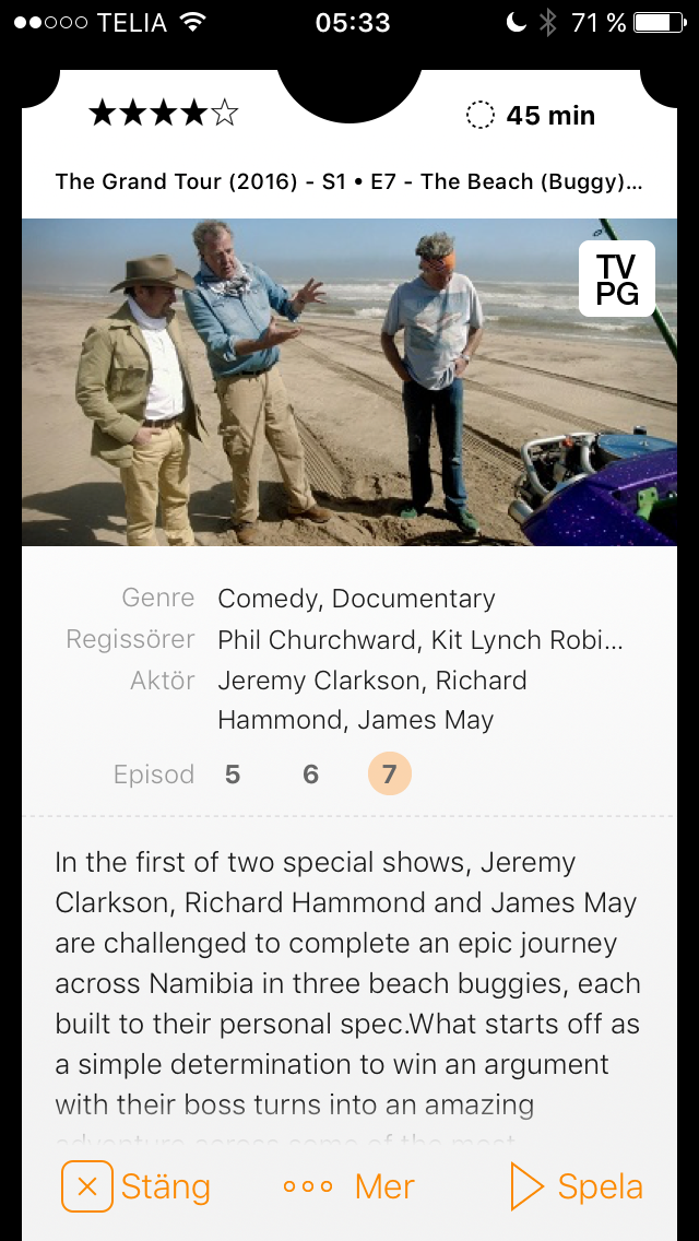

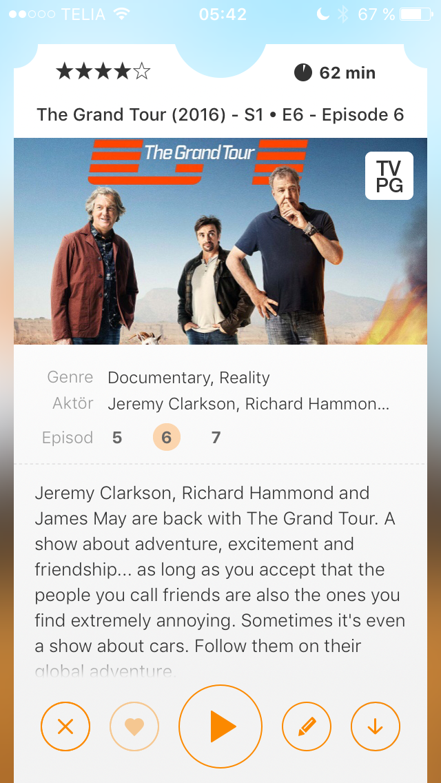

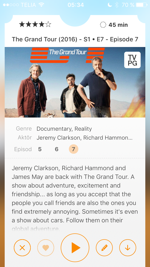

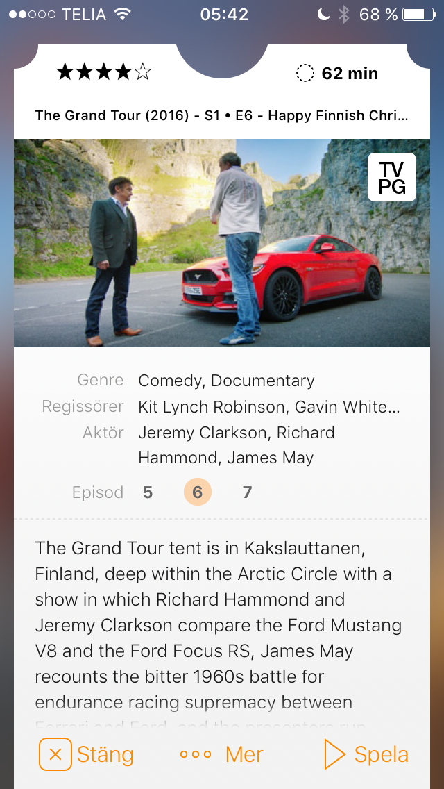

It's the same picture for all episodes and also the same text for all episodes.
It's still working correct in Infuse 4.3.6.
The attached pictures are from IOS version but is the same pictures on TVOS versions.
Version 4.3.6 Episode 6
Version 4.3.6 Episode 7
Version 5.1 Episode 6
Version 5.1 Episode 7

This is a known issue we're currently looking into.
In the meantime, you should be able to use Infuse's edit option to search for titles manually, or edit the filenames to movie the extra periods/dashes. E.G. Hawaii Five0 and The Man from UNCLE.

Hmm, is this happening with all shows or just this one? Did the correct episode artwork ever appear for this series in v5, or has it always been the series artwork?
It's happening with more than this show.
Yes it was working before v 5.1.
But it's still working for some shows in v 5.1.
My feeling is that for shows that is working with correct episode artwork and text the metadata was downloaded before v5.1.
