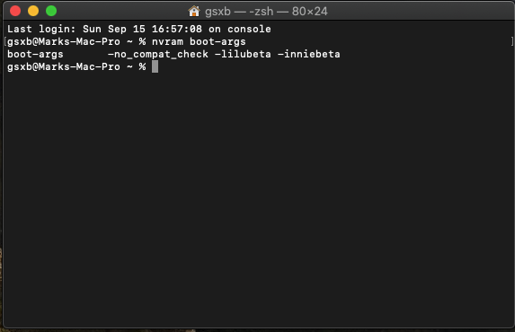

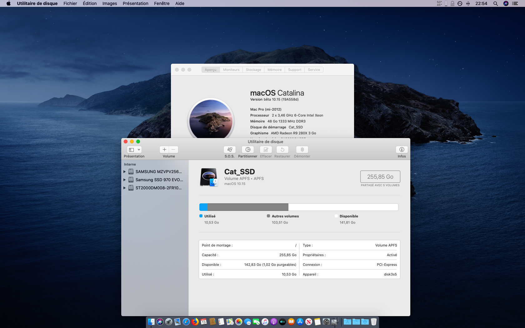

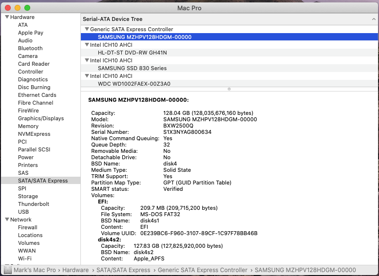

Yep it work! I just installed DP8
At first boot after installation my 2 Samsung NVMe PCIe were seen external but after typing this code in the Terminal
Code:
sudo nvram boot-args="$(nvram boot-args | sed $'s/boot-args//;s/\t//g') -lilubeta -inniebeta"
and after a restart everything is back in order, my 2 NVMe PCIe were seen internal.

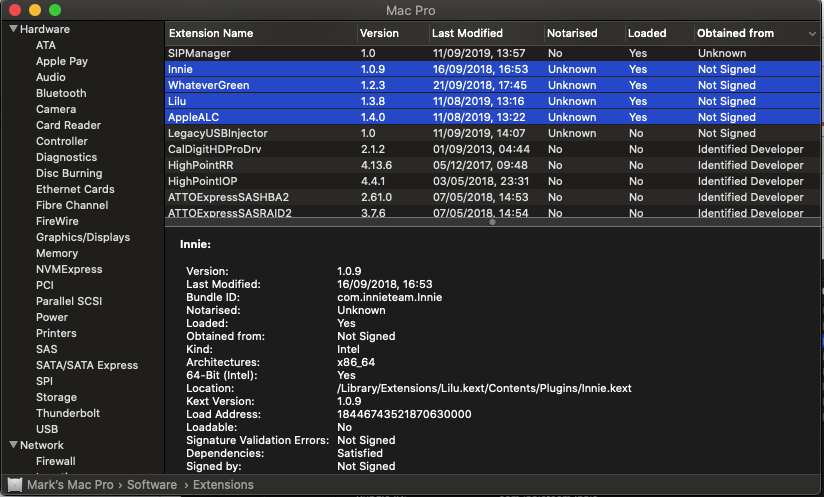

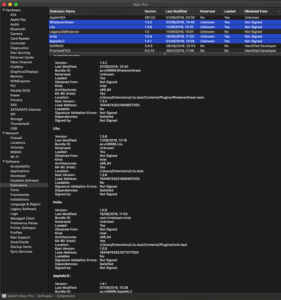

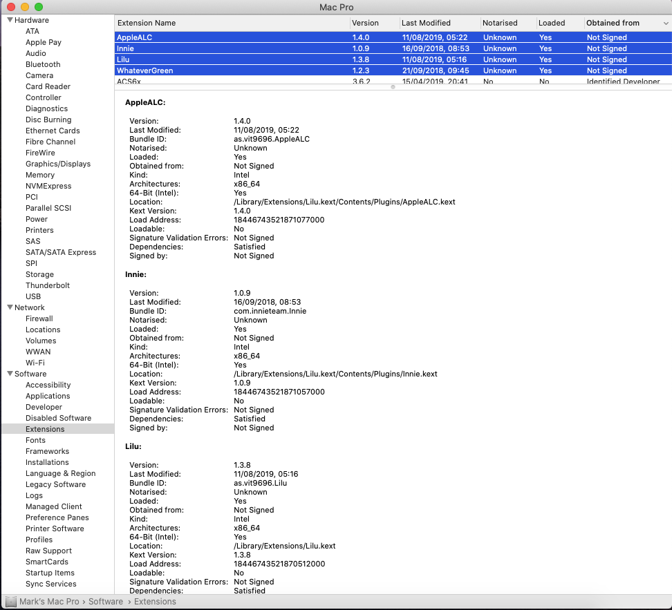

I followed post nine and added the line of code you quoted and I didn’t work
Any thoughts as the kexts are loaded but not working

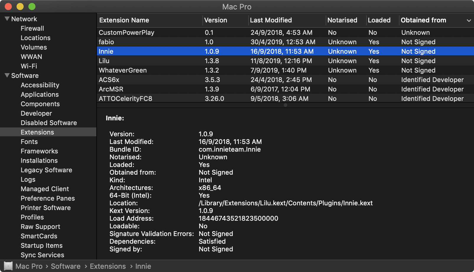

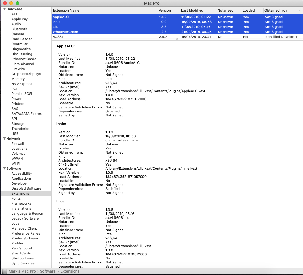

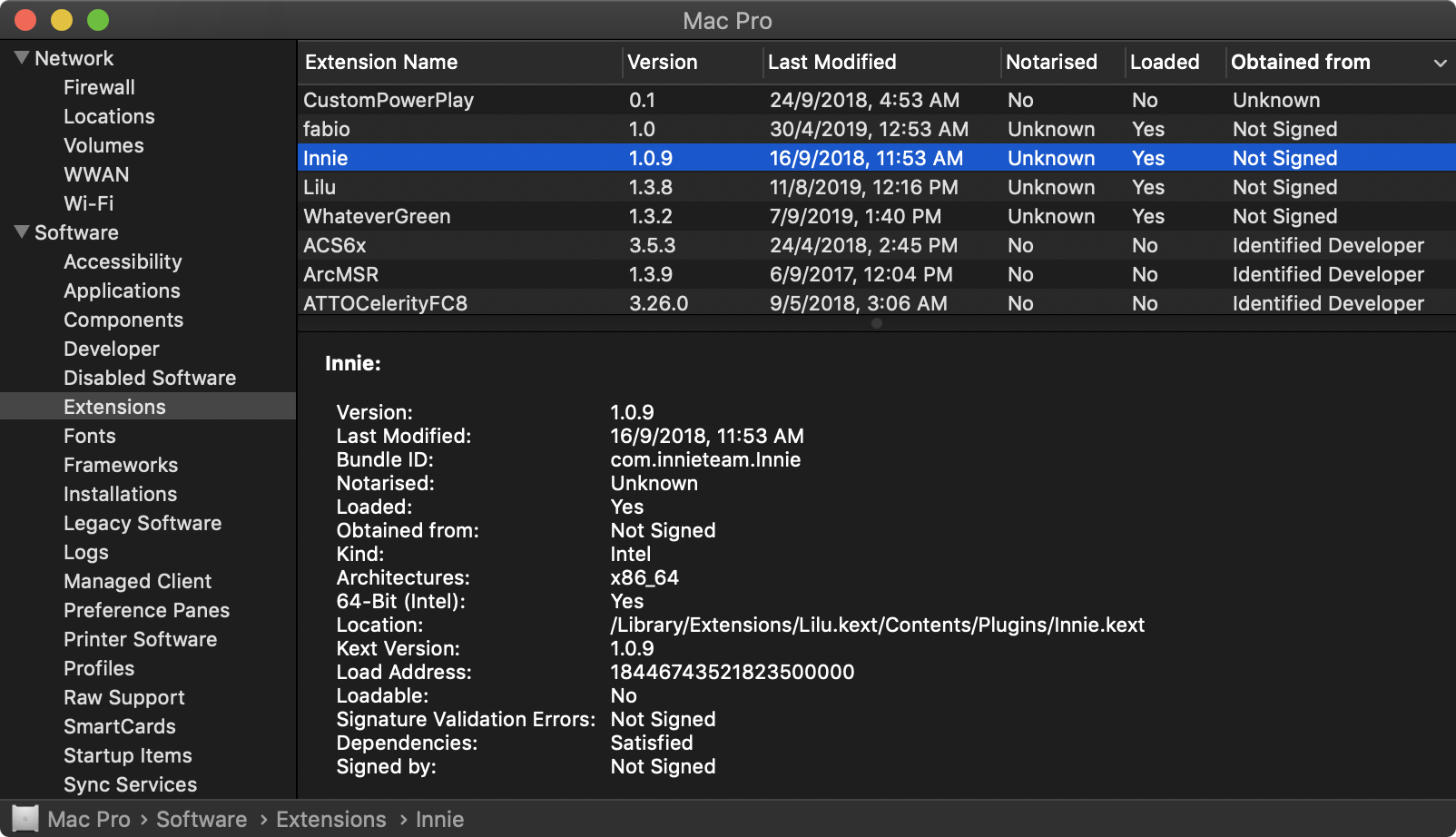

I’ve added the plugins folder to lilu 1.3.8 and placed the latest whatevergreen kext , and the latest appleALC kext with innie
Run the terminal commands rebooted and run the other command rebooted and it doesn’t work has anyone got any ideas
What’s your boot argument now?
@GSXB, other third party kexts can interfere with Lilu and its plugins. In Post #234, your screenshot shows a "LegacyUSBInjector" kext. It also shows an "AppleHDA" kext, which has apparently been modified ("Obtained from" = "Unknown").
I’ll look into that, I’ll back em up and delete em rerun kext cashe and try again
Thanks for pointing that out
I’ve removed the usb legacy kext
It made No difference
As for the AppleHDA I’m unable to delete it and have been reassured by dosdude that the kexts in question would not be conflicting with lilu and innie
Now I’m completely stumped any more ideas

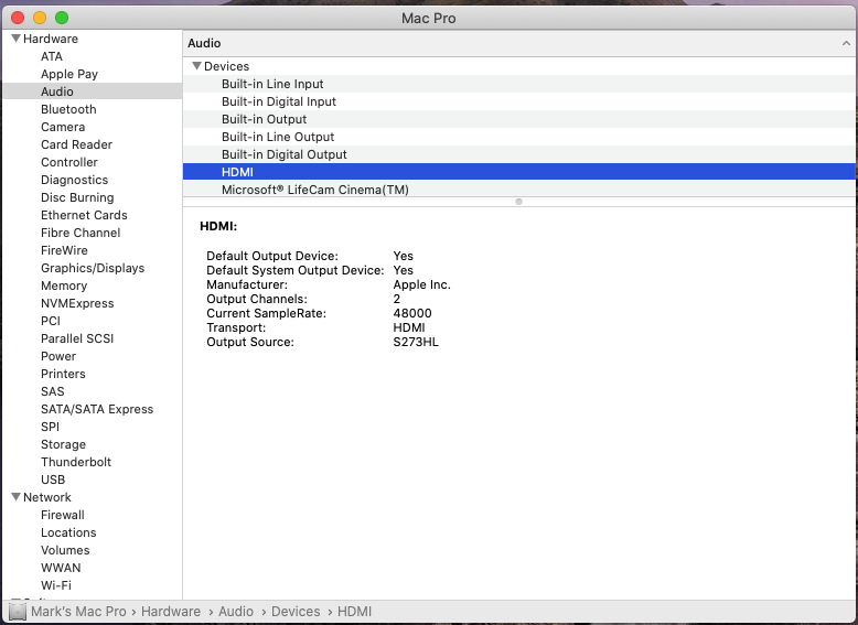

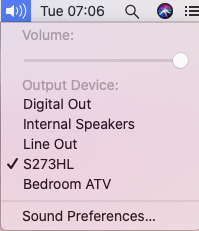

Just for the record:
I tested today with some SAMSUNG TV and get audio out of the RX's HDMI perfectly well right now (which, as i also tested, is not present without the AppleALC.kext, running High Sierra). So everything works perfect right now and i have an in a few ways even more useful 5,1 now. Thanks alot for that!
I also switched to the release-versions instead of debug for Lilu as well as for the plugins "just in case" and added WhateverGreen.

I really need this .... I have a ssd m2 adata sx8200 pro and I've tried it on mac pro 5.1 ....... I've followed everything you suggest ... but it always fails .... maybe I I did it wrong in point 4 ... I am confused what I should copy in the plugin folder ... I really need your help ... thank you

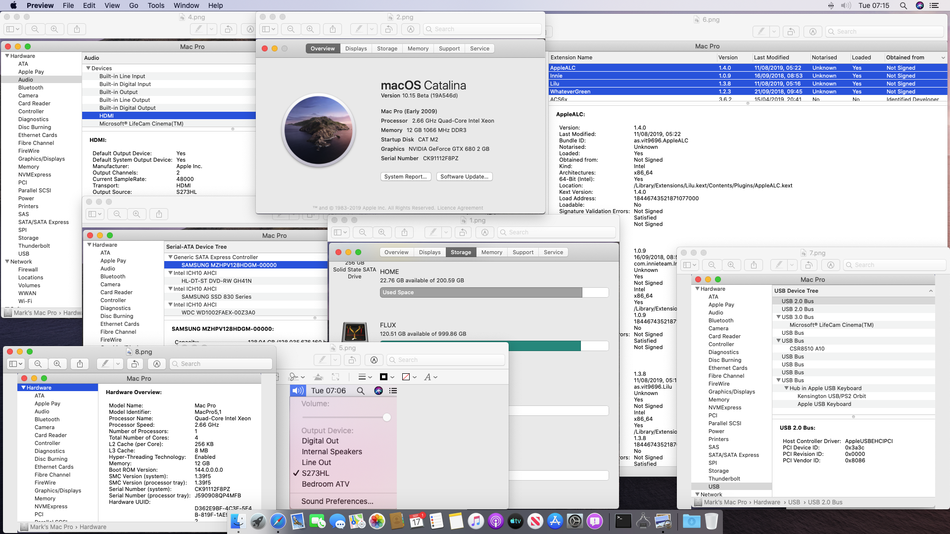

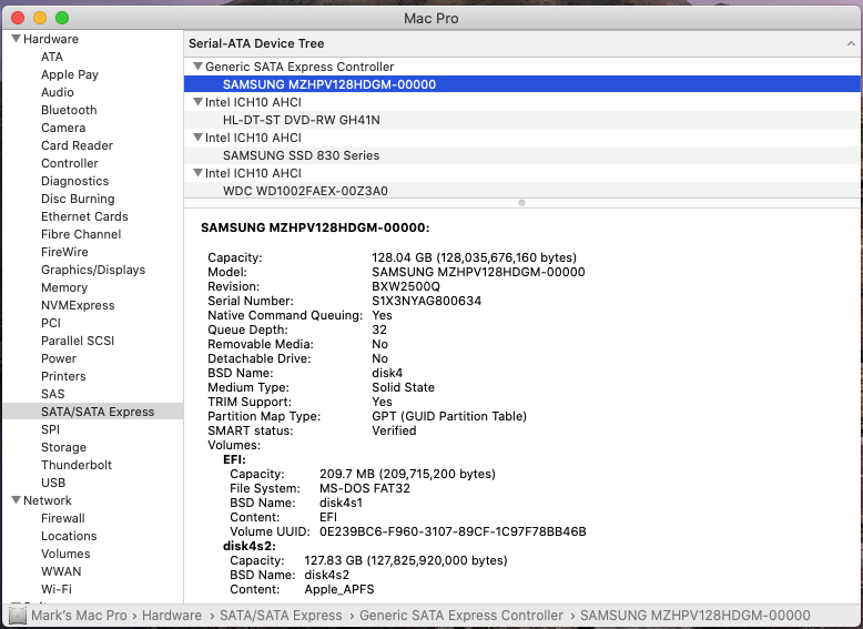

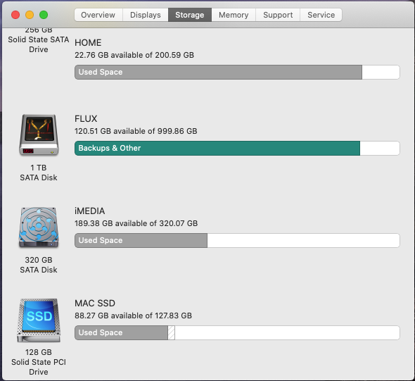

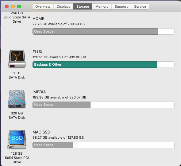

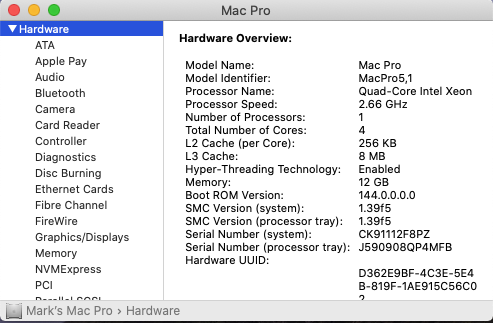

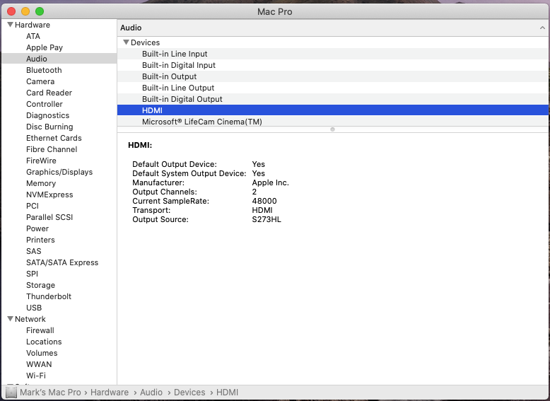

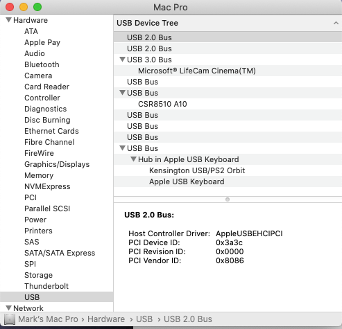

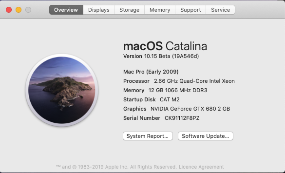

SUCCESS
after my initial problem with lilu, innie, appleALC and whatevergreen
I decided to install Catalina with no patches with Dosdudes Catalina patcher,
bingo it now works. My pci m.2 is now internal and I have HDMI sound,
there must be some kind of conflict going on. ?????
he said they were required as usb and sound would not work
well there not installed and they do work

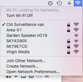

UPDATE. Now with WIFI
