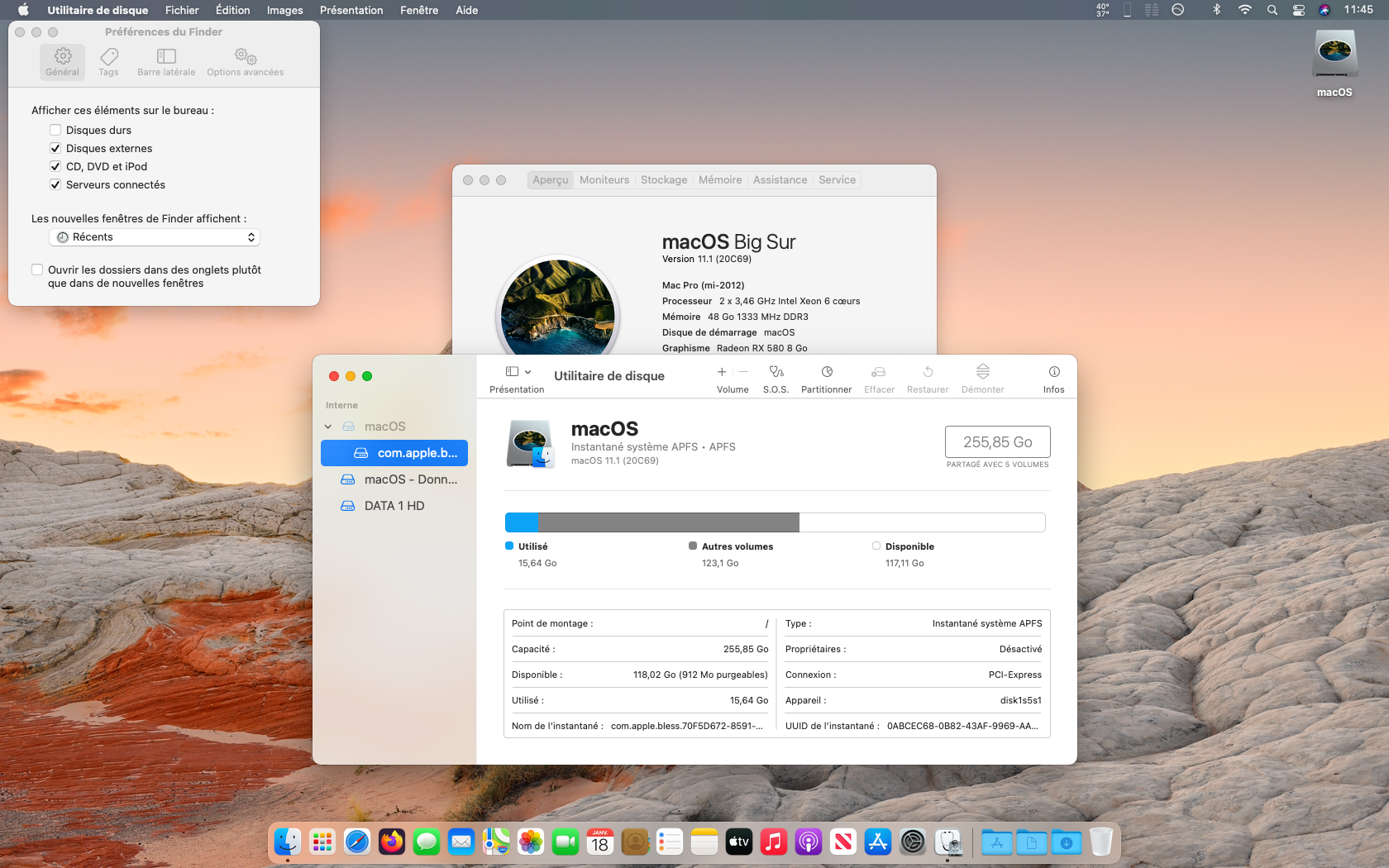

I think mounting the snapshot shouldn't be necessary but I had another change to make in /S/L/CoreServices/CoreTypes.bundle
Now my NVMe SSD (Big Sur 11.1 20C69) is seen internal in Disk Utility but it still appears on the desktop despite this option being disabled in the Finder preferences.
I ran maintenance with Onyx and also deleted "com.apple.finder.plist" in ~/Library/Preferences/ in order to reset Finder preferences but the system disk still appears on the desktop as shown in the screenshot below.
And disappears from the desktop when I turn off the external drive option in Finder preferences.
It seems the NVMe always seen extern by the Finder. How is that possible?
Have you any idea about this?

I'm really not sure. Did you also allow the kext in System Preferences > Security & Privacy? How did you install Big Sur?
Thanks for reply
Yes I Allowed the kext in System Preferences --> Security & Privacy.
I made a clean install of Big Sur 20B29 on 15th November (and migrated my data from Mojave) then updated to 20B50 on November 20th and finally updated to 20C69 on December 14th

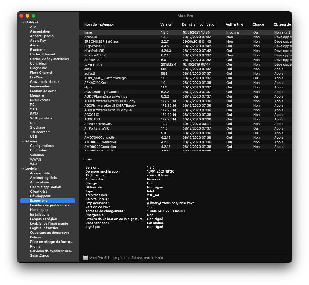

Innie.kext seems loaded by the system

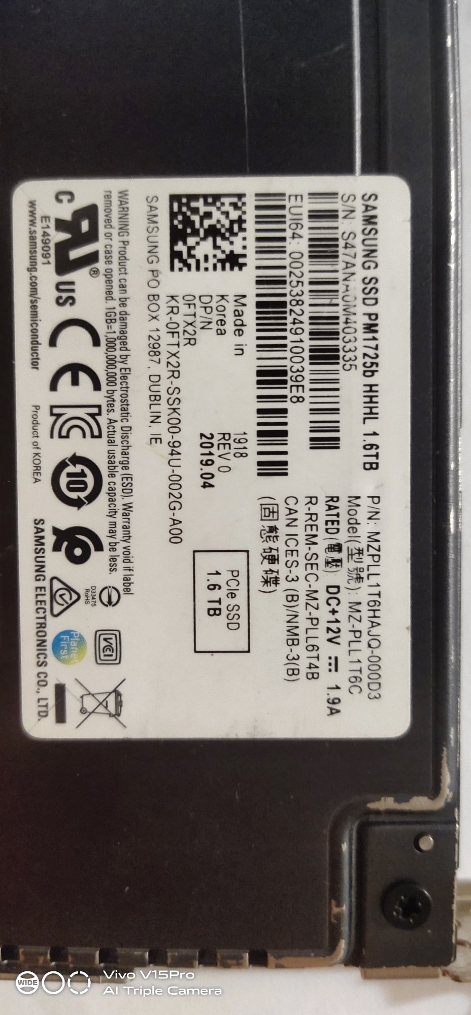

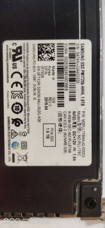

dear brother first of all I realy appreciate your hard work
Brother in my case i am not an expert in hackintosh
I have a MacPro mid 2010 I successfully upgrade my firmware to 144.0.0.0.0
I also install macos big sur on my PCIE NVMe drive with the help of micropatch

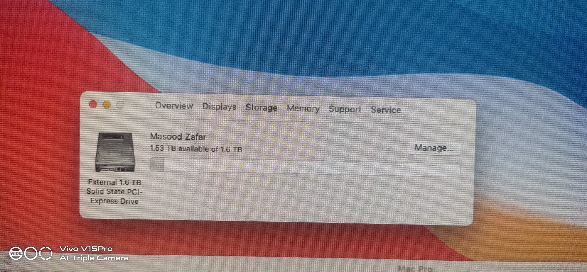

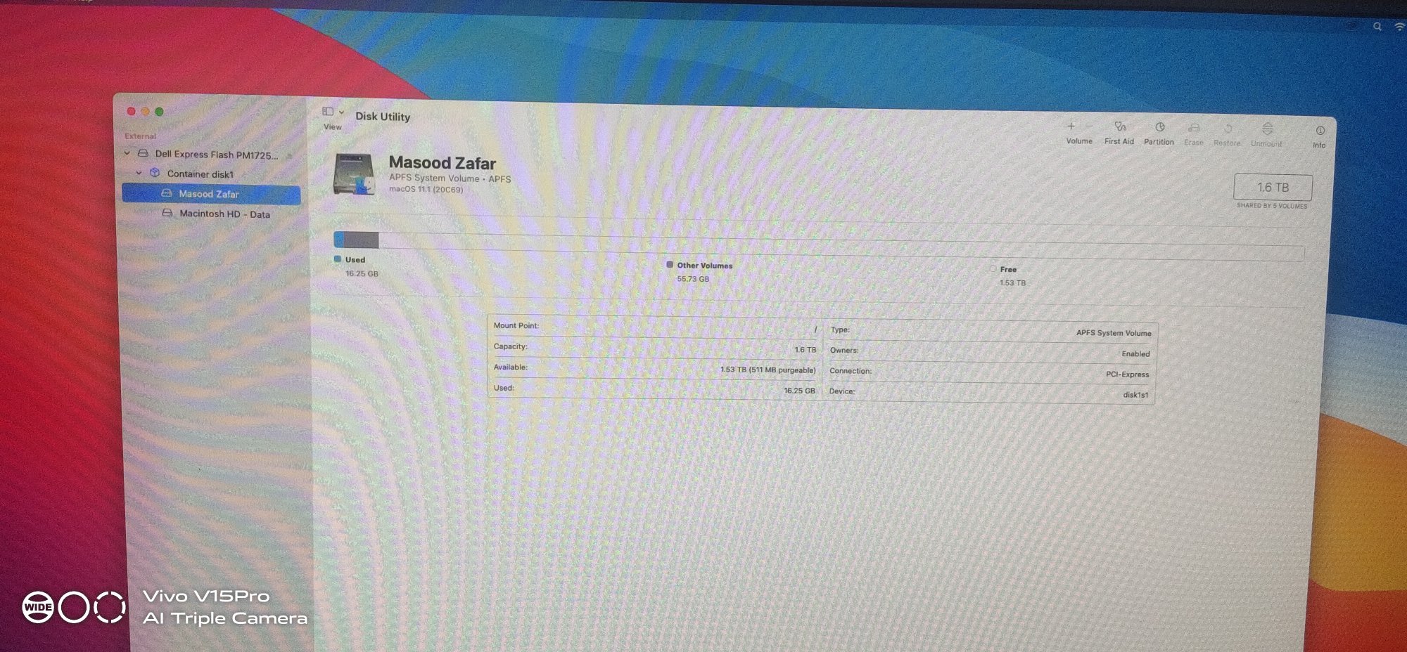

My porblem is that my PCEI drive shown as external i follow your post #9 instructions 3 time but after reboot my system crash and I reinstall again
Plz plz plz help me brother i am really in pain plzzz help me

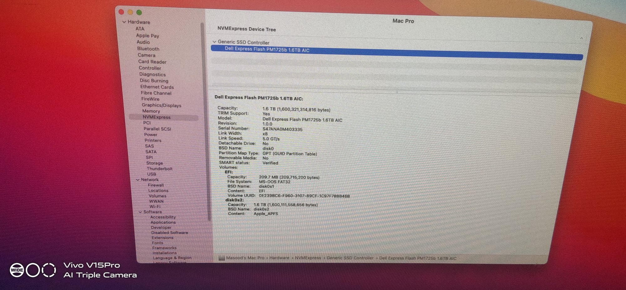

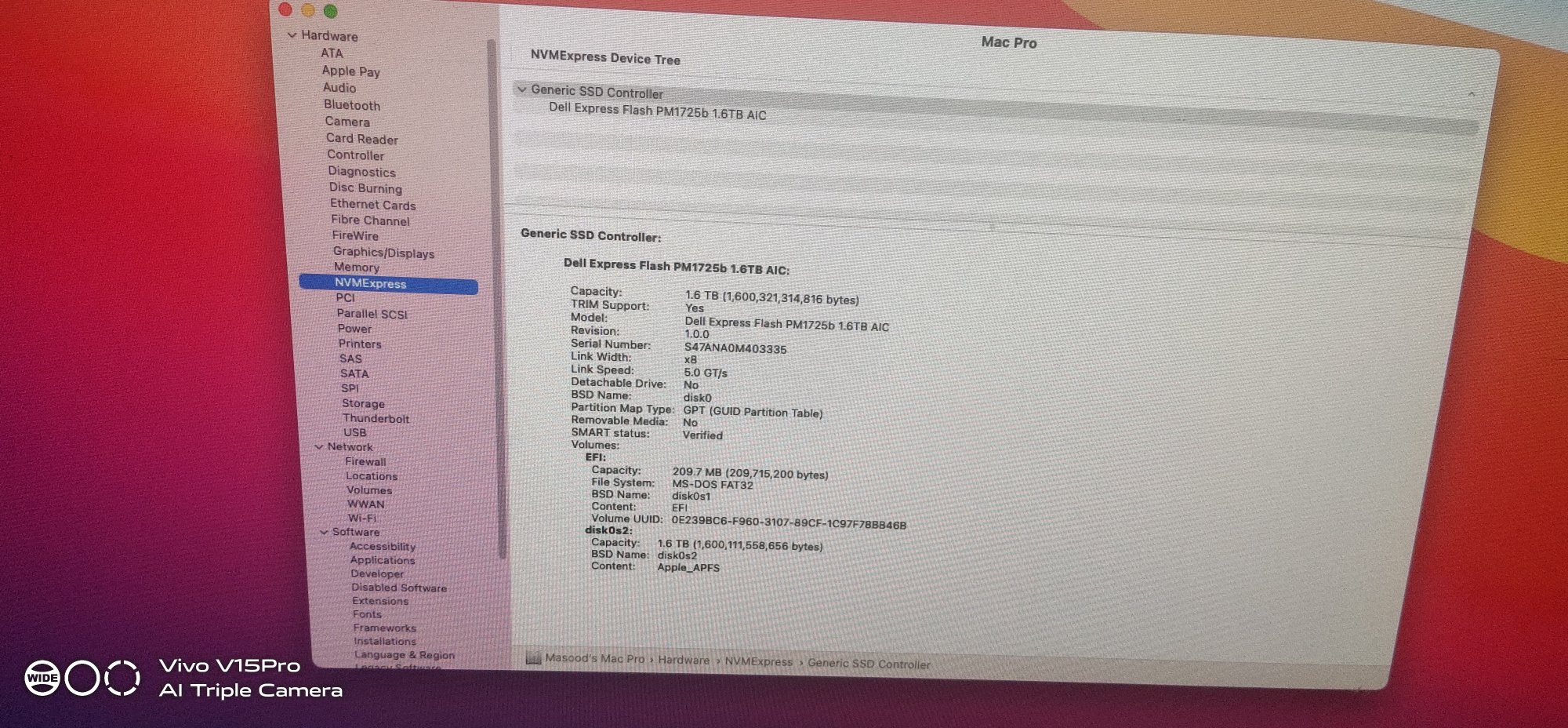

My ssd information is
Samsung PM1725b enterprised ssd (nvme) picture is also attached
I am very thankful to you brother plz help me

My porblem is that my PCEI drive shown as external i follow your post #19 instructions 3 time but after reboot my system crash and I reinstall again
The instructions have been updated for the latest version of Innie.
Please note that the solution here can be hit or miss with patched installations.

dear i am really thankful to you if you guide me step by step here or email me on masoodzafar7@gmail.com ....thanks thanks thank if my problem is solved i send you a gift
There are now.
Respected Sir i am still waiting for your step by step guid line ................
See post #9, which has been updated as mentioned above.
Thank you so much for your reply dear Cdf but i follow your post #9 instruction 3 time and the result was after reboot my system macOS not working so i reinstall again i think i miss some thing so that's why i need your more guideline a small video of post 9 will be best for us
