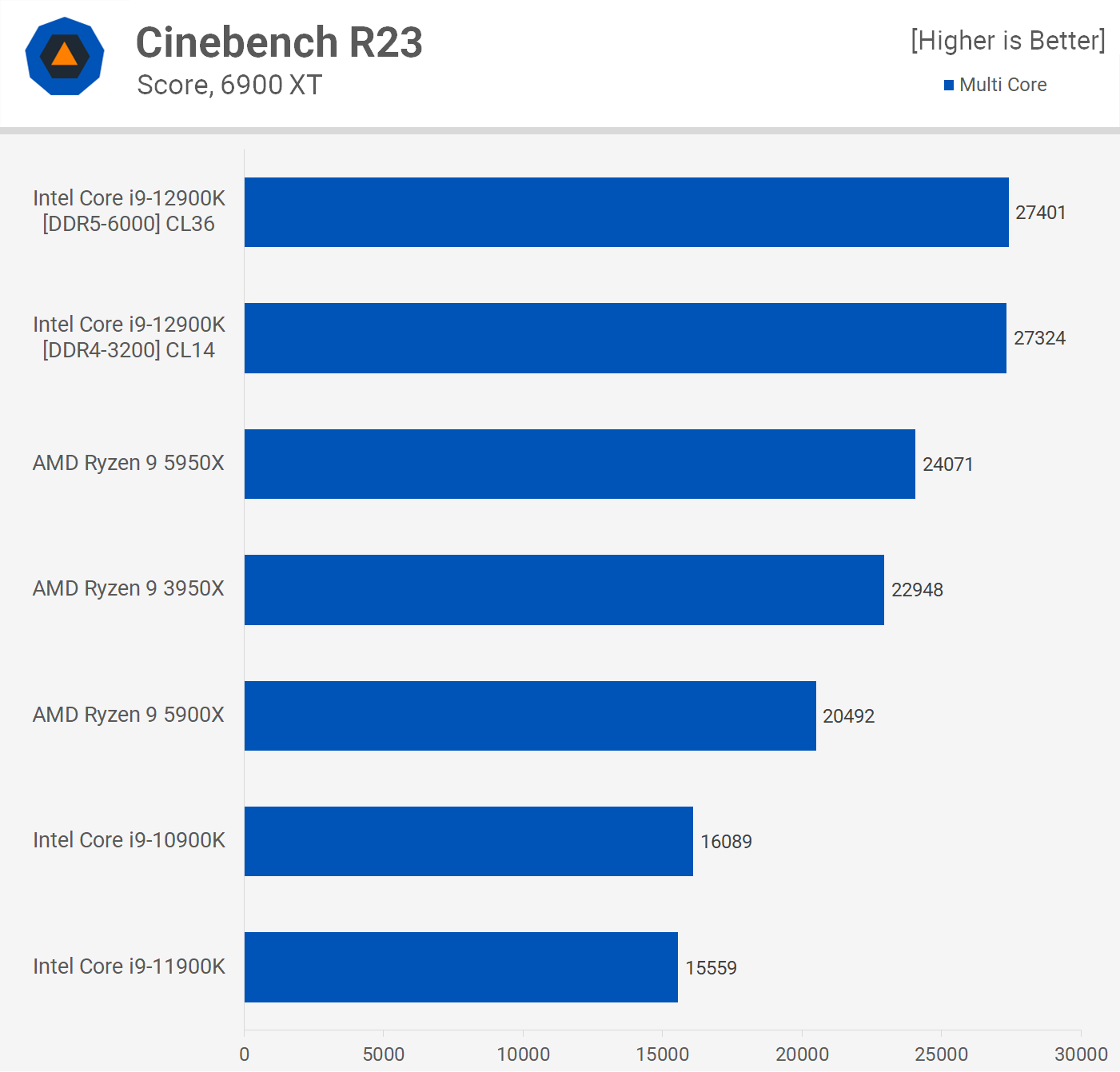

12900k scores 27401 on Cinebench R23 at peak 251W
5950x scores 24071 on Cinebench R23 (I also get 23794 to 24371 on air cooling at peak 123W)
So, 12900k is ~15% faster at 2x the wattage.
https://www.techspot.com/review/2351-intel-core-i9-12900k/
As @jeanlain said that’s because 5950X is simply a better, more efficient design and that Intel processor is being pushed waaay too far over on its power curve to compensate. Tests indicate that lowering wattage down to a about 150W makes only small losses in performance (like 10-15% I think, but past 150W it gets bad) and in many non-AVX that where the chip is hanging out anyway.
