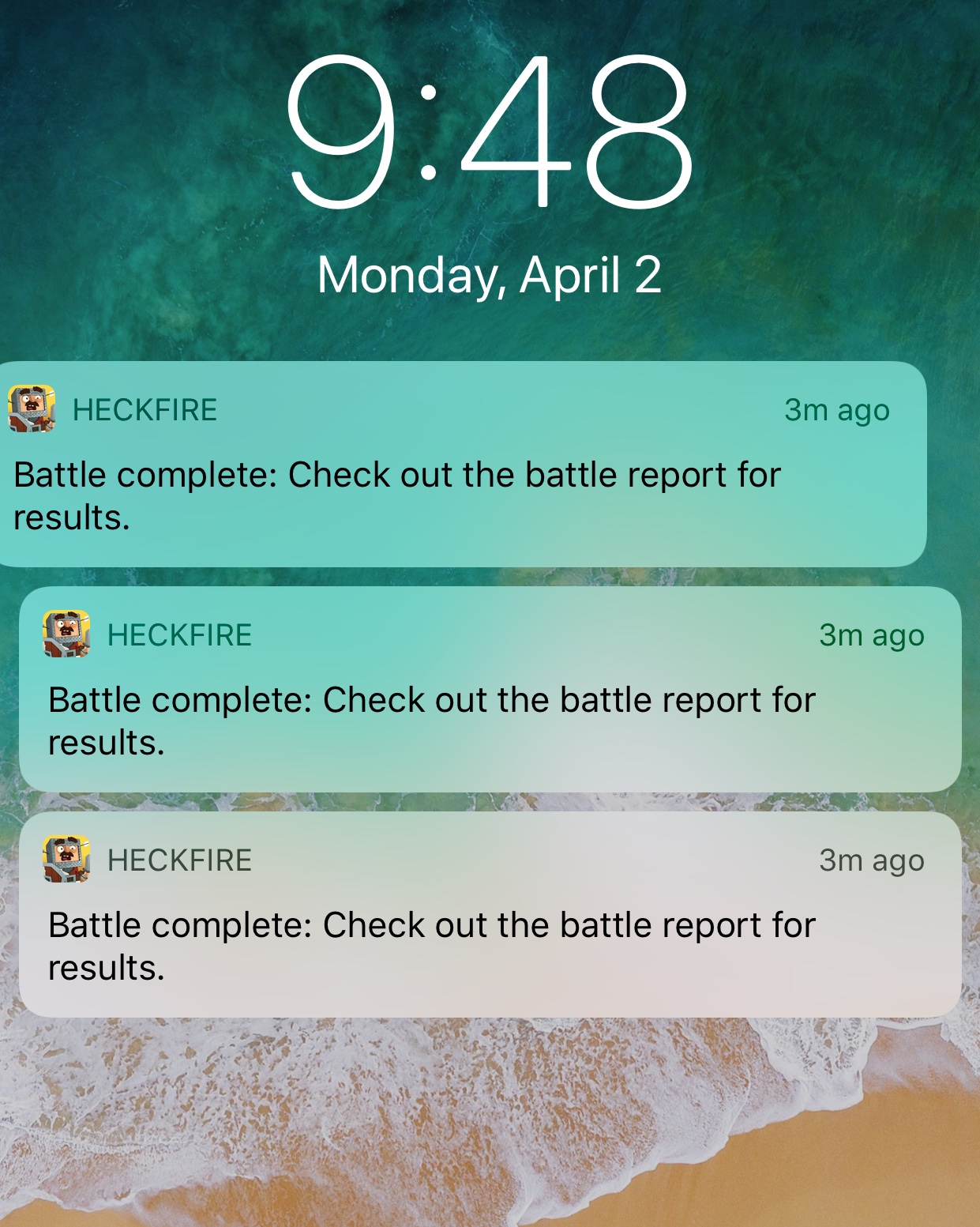

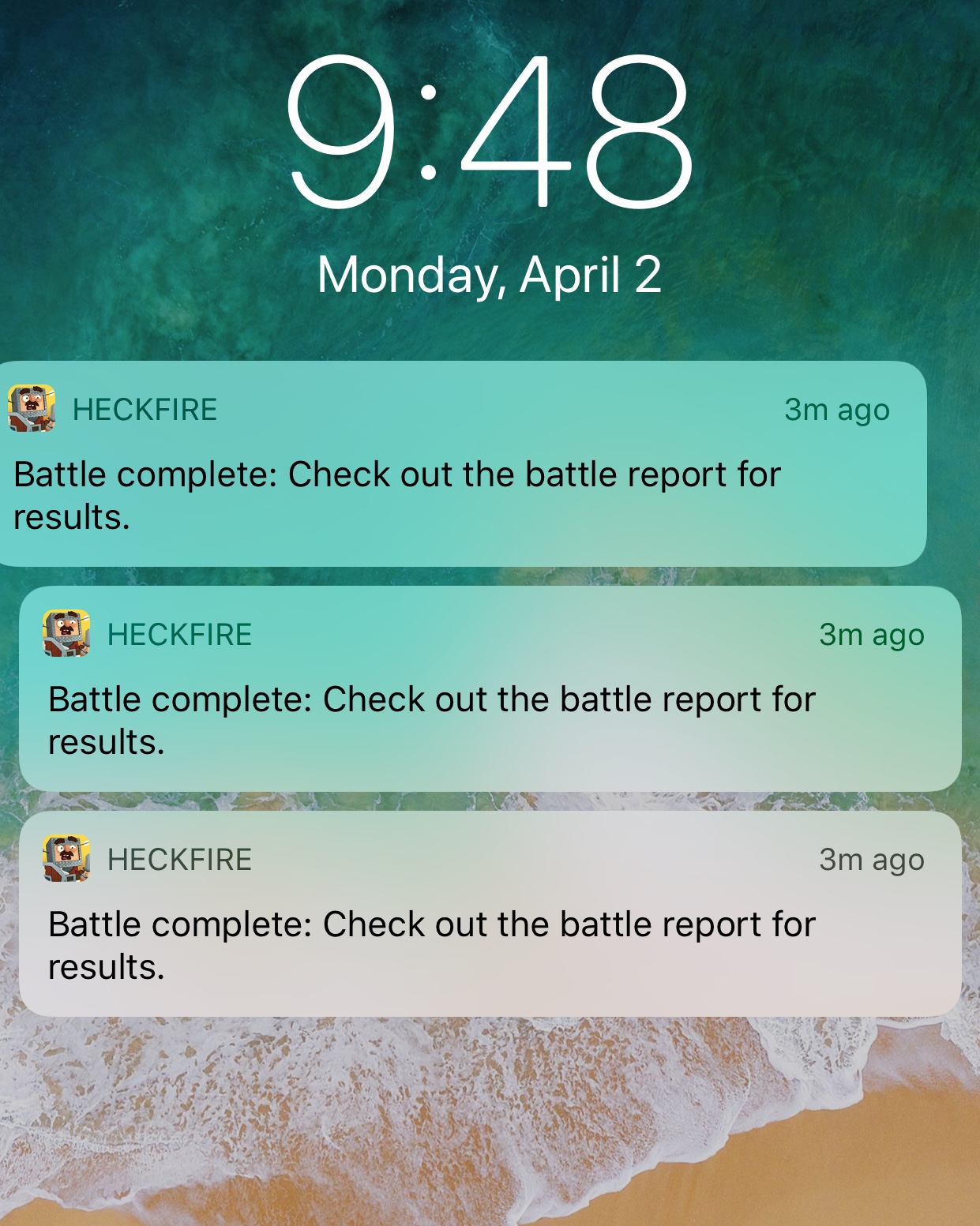

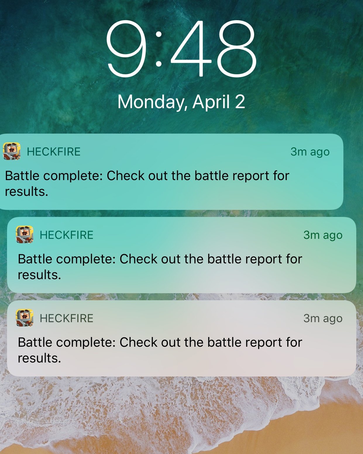

[doublepost=1522731492][/doublepost]Seeing this one my 7+ Lockscreen - comes and goes.
Notifications are out of line.

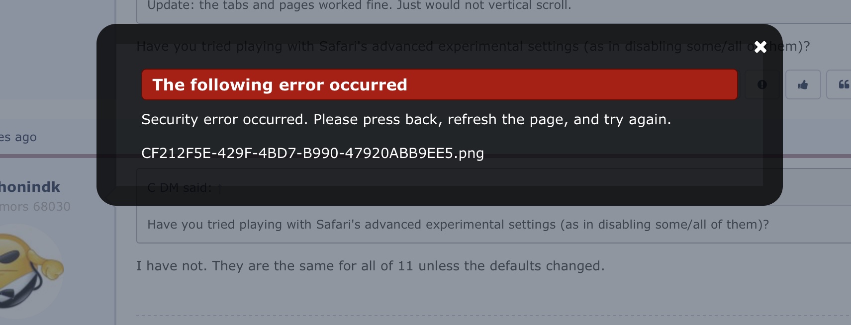

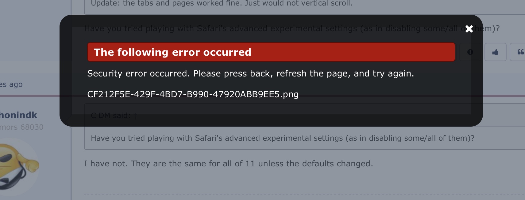

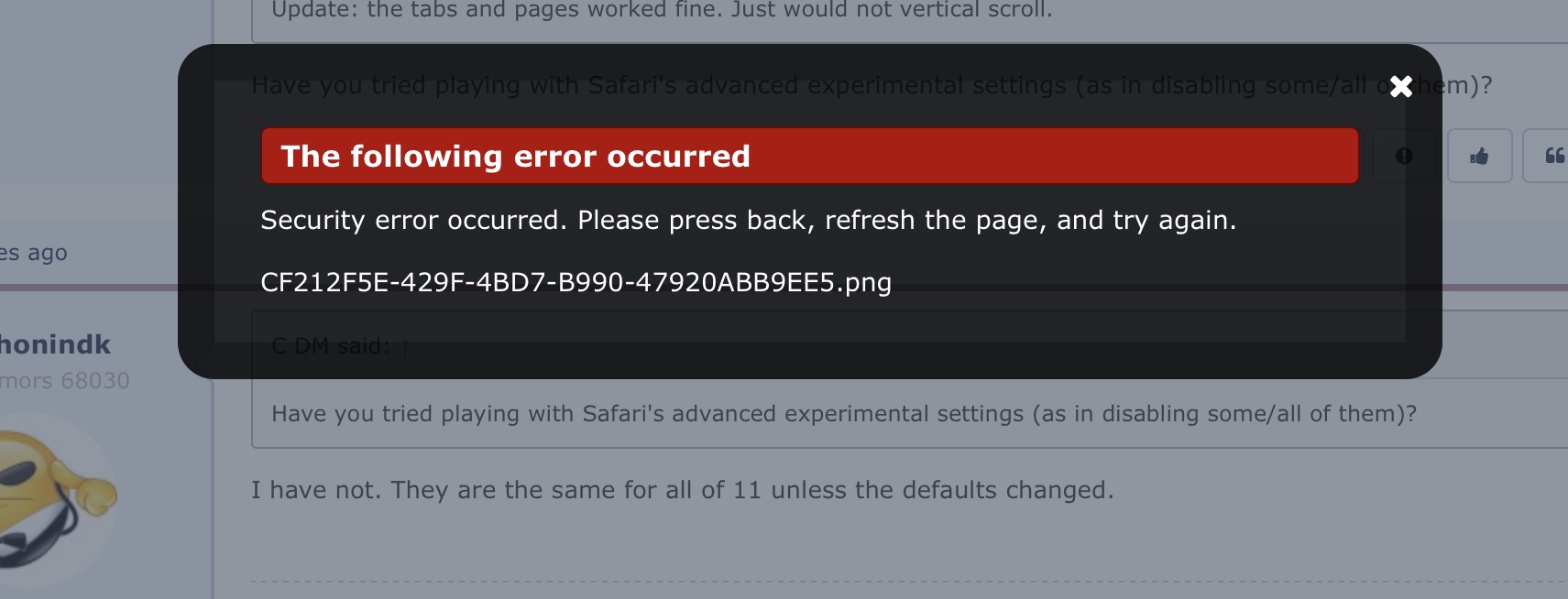

And seeing this at times when I go to upload to this site from my IPP in Safari

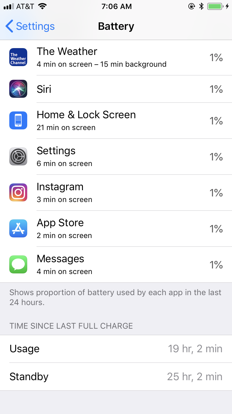

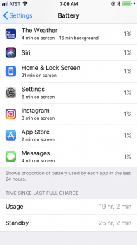

1% battery drain per hour.
