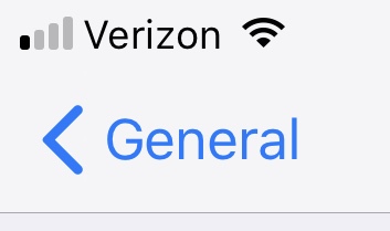

I don’t know if anybody noticed this small change yet, but the back arrows in the settings app are now rounded. They were more angular in iOS 10
