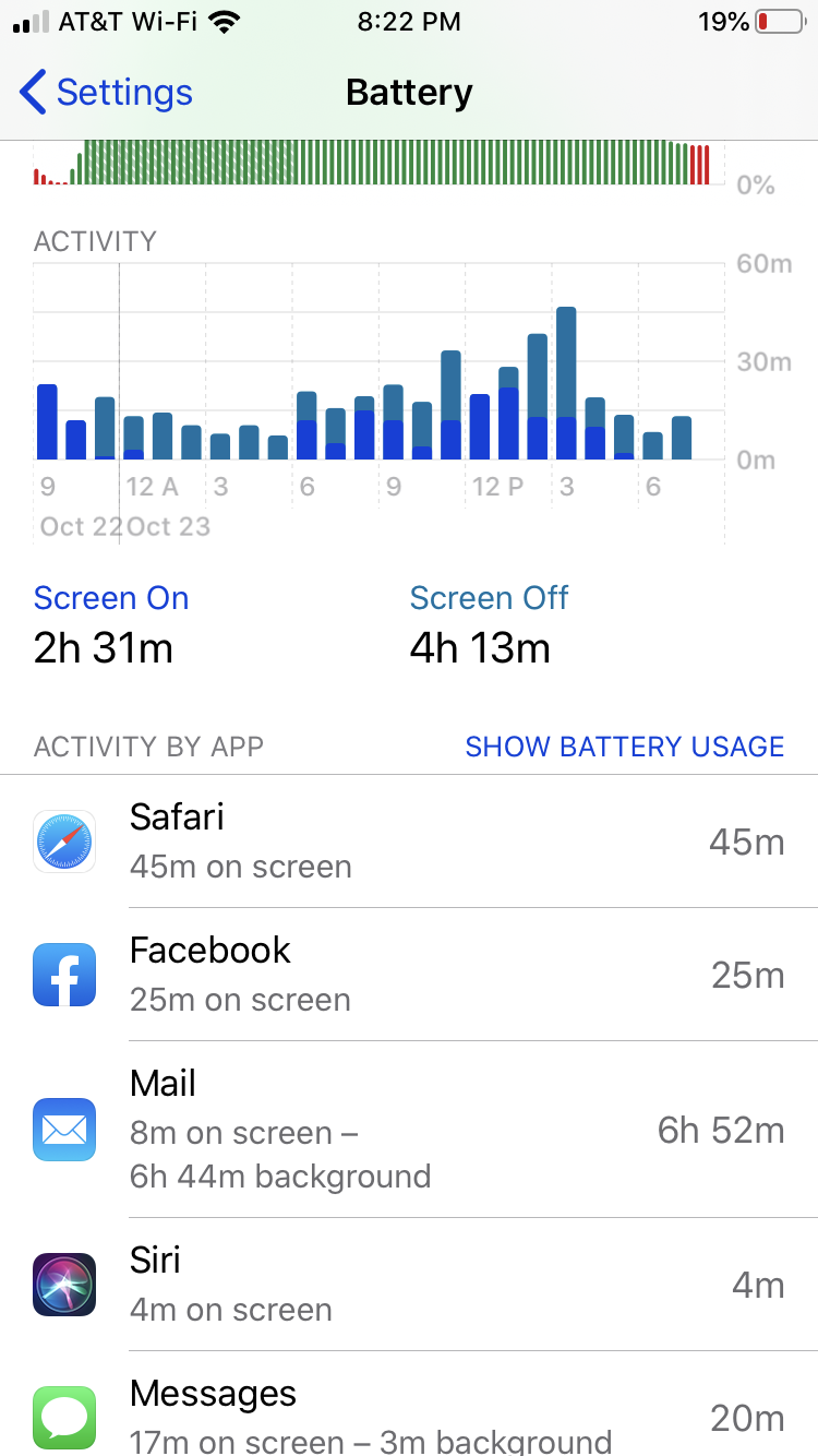

yup the native mail app is messed up alright. It spent hours doing something in the background last night while I was asleep. When I woke up this morning there were just 3 new mails. Who knows what it’s up to. It’s been churning in the background during work hours too. No wonder my battery life was shot today.

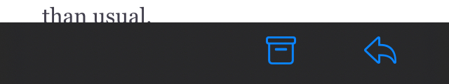

My mail app seems okay, but the bottom that just have 2 icon on the right side (not getting the center of it) and the animation when it archived, it’s not the style of Apple’s design.
