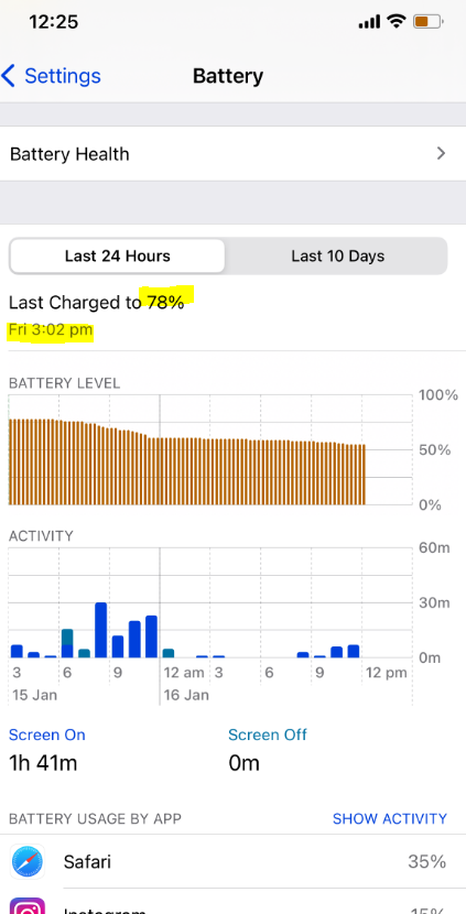

hi
In the screenshot that I charged the phone on friday at 3PM at 78%. I then switched to the physical EE Pay as you go Sim card.
The phone is behaving itself as if nothing is wrong.
You will notice that on the 15th i was using the O2 Sim and battery was draining.
There is something on the O2 network which is causing the battery to drain so much.
hi

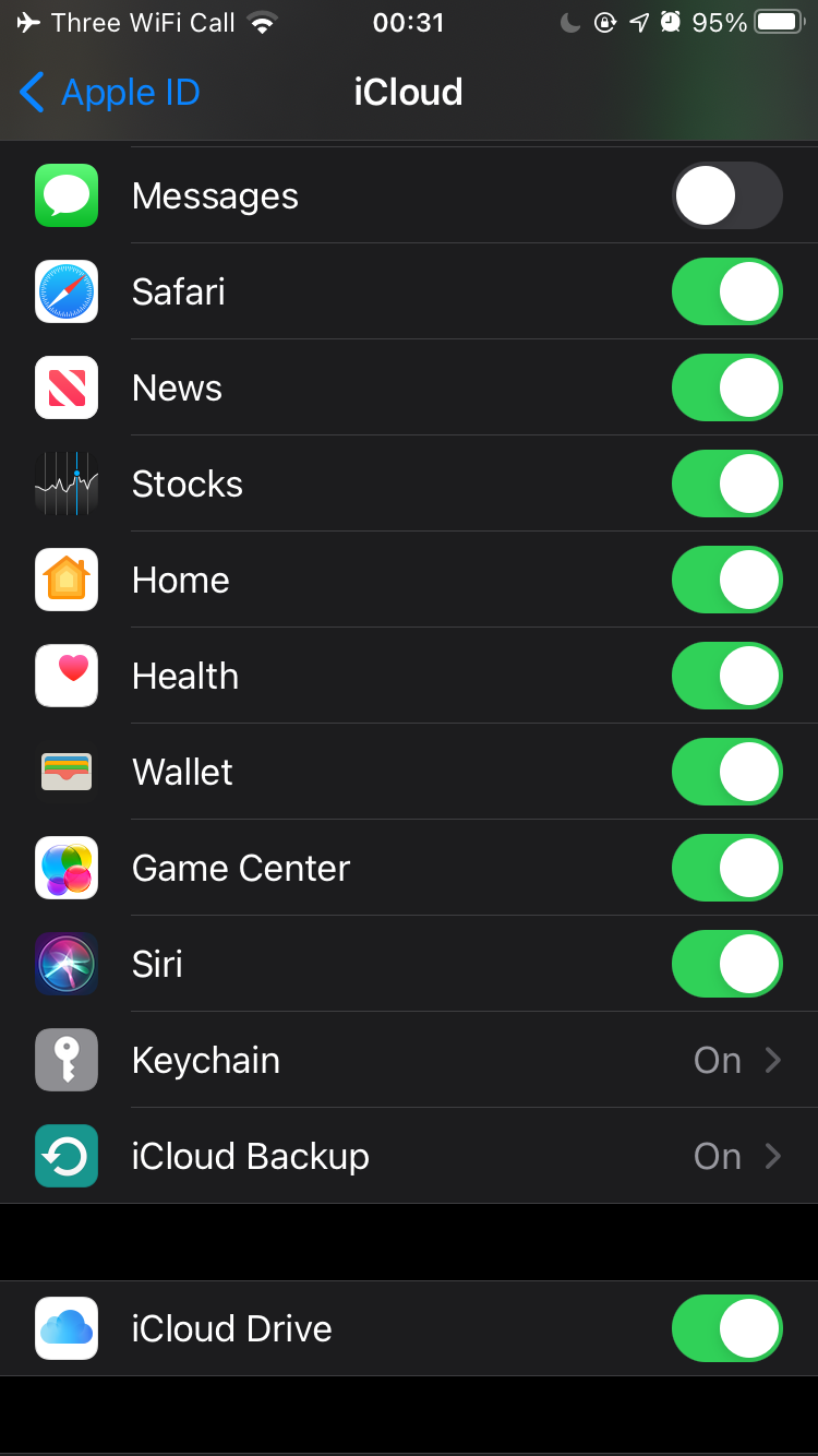

Hi everyone,
I have an iPhone 6S and a battery with 98% battery health.
I noticed since 14.2 / 14.3 there has been a battery drain. I tried many things, such as disabling SiRi, location services etc, but nothing worked.
Through must testing, I tried the following and the battery drain stopped (while the screen is off). I went to bed with 95% and woke up with 95% battery life.
Here are the settings I changed:
Let me know if this helps. It worked on my iPhone.
*update
It worked ok initially, then the drain appeared. I installed iOS14.4 public beta and was the same. I have reset the phone to factory settings and setup again without any apps installed. I suspect the issue is either:
- iOS14
- a third party app
- the phone battery (98% battery health, after resetting down to 96%)
Hi thank you. initially it didn’t work, until Raise to Wake was disabled as well (this morning). iPhone SE 2. Hope this fixed in 14.4
