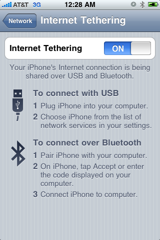

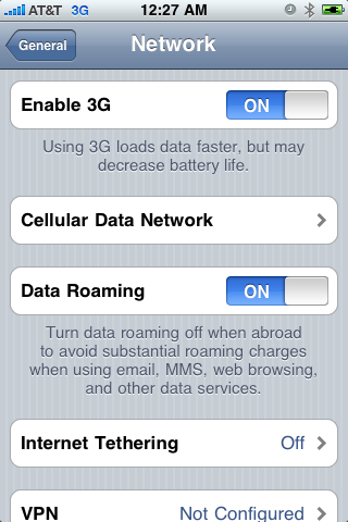

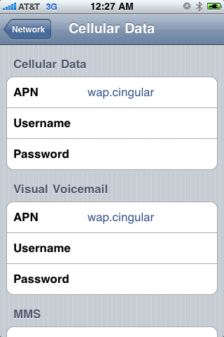

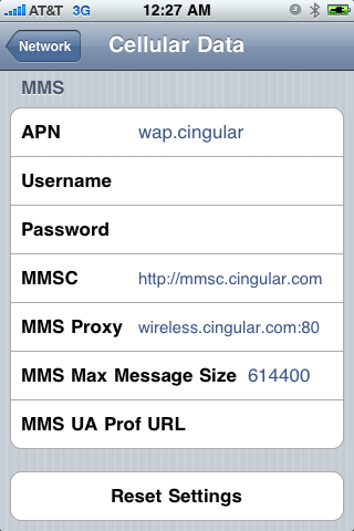

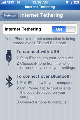

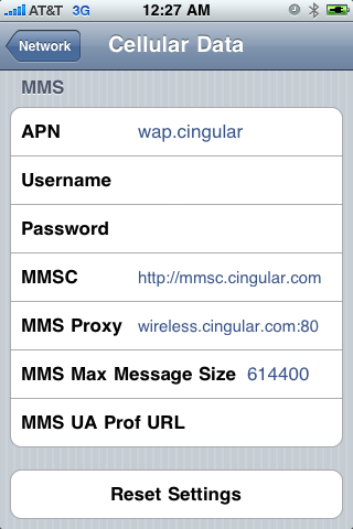

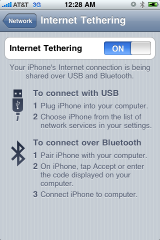

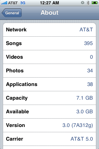

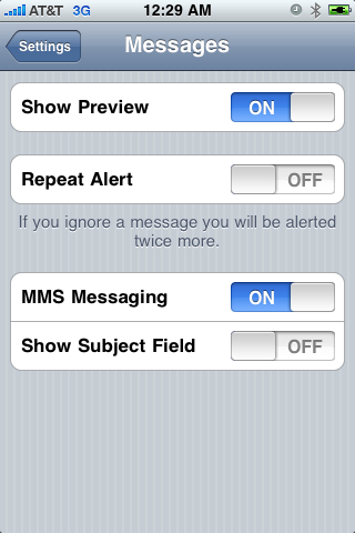

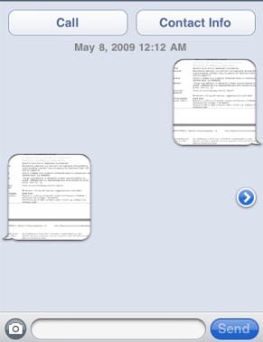

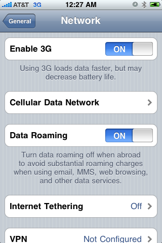

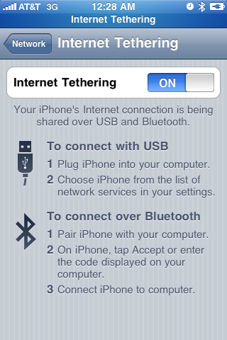

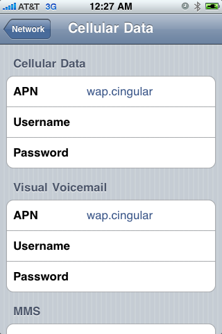

The Solution- Beta 5 working with MMS & Tether @ Same Time part1
Well i must say the early posts were very helpful to me so i'd like to return the favor.
BG: I had mms working without any modifications. When i enabled tethering i lost MMS. when i tried to edit files to get mms they were unsuccessfull. WHen i restored from a backup before i fuddled with carrier files mms came back.
Current situation: updated to beta 5. lost mms. lost tethering (it asked me to turn it on). SOlution: i did some backwards engineering. I jail broke into my beta 4...looked at the loaded carrier settings where my mms was working..lol then basically combined the two files.

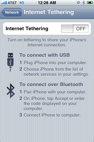

First load attempt: MMS did not show up, tethering option was there but could not be enabled.
Long story short, i was able to get a version working that allowed MMS & Tethering to work together.
My phone is loaded with beta 5, no jail break, and has working MMS & Tether on AT&T.
FYI: the mms settings on this site were not what was on my iphone.

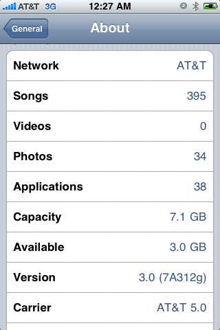

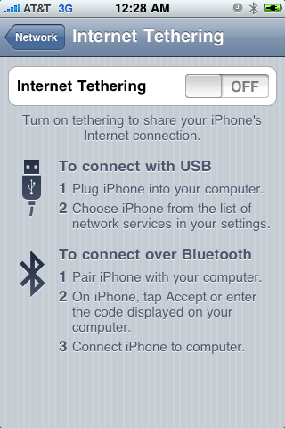

The Solution- Beta 5 working with MMS & Tether @ Same Time part2
There are the rest of the proof pictures. next post will have what to put in the file.
NOTE: i did not update to the LATEST itunes (so i have the itunes from the beta 4. carrier updates are allowed on this model).

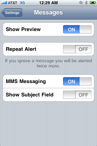

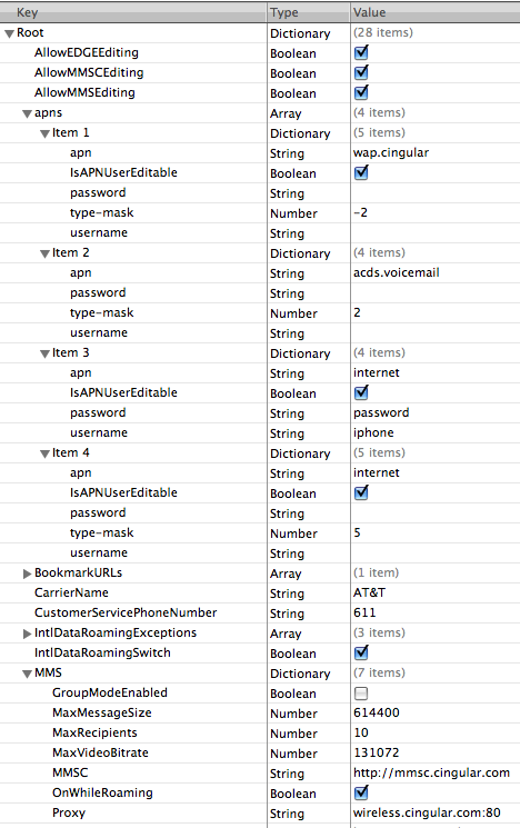

THe Solution- Beta 5 working with MMS & Tether @ Same Time part3

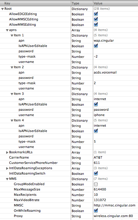

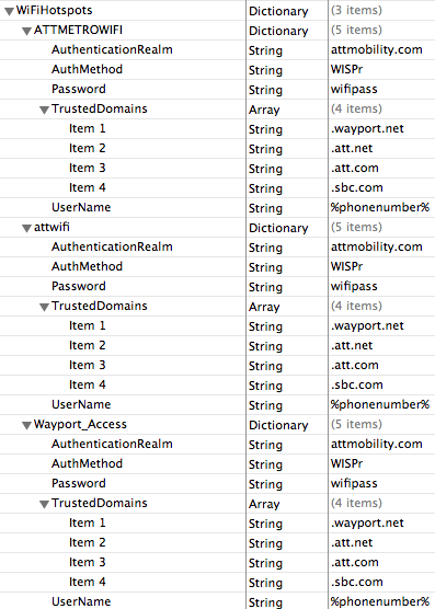

How i did it. Edit the files as noted in previous post re info & version changing that stuff to 5.0
Modify the carrier file to the specs attached.
Hope that works for you all!
And if anyone would like to say thank you, i'll accept donations via u telling ur friends about a website called ShareNotes.com (a place to buy/sell/share college lecture notes).

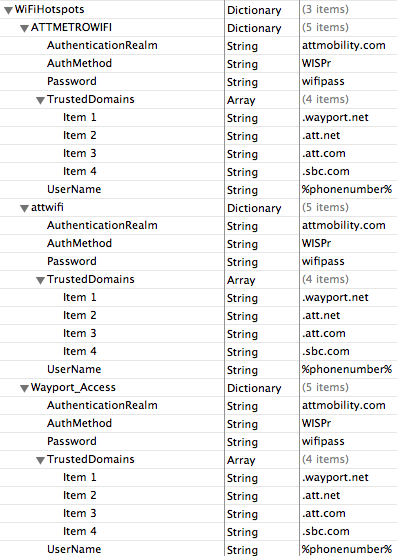

Summary: Only edit 1. info.plist 2. version.plist 3. carrier.plist (the info seen in the CDN area was imported automatically--i did not fill it out myself)
Final Note: i've attached the ipcc file i made..unzip it and load as you would normally load ur file.

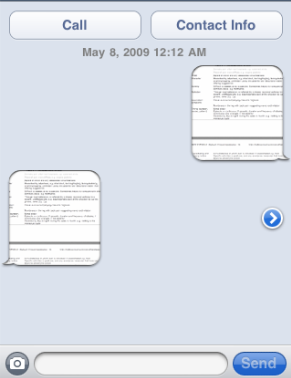

Regarding my MMS: i had an HTC TYTn2..family plan...added unlimited family text.. so i never had on my account iphone text plan.. then purchased iphone..upgraded data plan...then without anything...upgraded to beta 2 and mms worked.
When upgrading the carrier file seen on this forum for tethering, i lost mms. i then used the mms settings seen in the forum to get my mms back..did not work.. called AT&T ran the "i'm a developer" song and dance..they said 1. we didn't make any changes to your account 2. iphone is not ready for mms so we can't help you ..after restoring from an old back up from a day mms did work..i got my mms ability back. That makes me think its part settings and part ATT and your account settings.
If mms does not work for you with these settings, tethering will (as i write this it has been confirmed to work by 2 other people)
You will know this update worked IF you see mms preview feature under message settings in beta 5 (as they are missing from the menu after a stock beta 5 update)

I put in the settings just like the MMS attached picture you used and my MMS still does not work. Was there anything else that you did? I am using Beta 5 and the ATT_US.IPCC file. Can your file that you made be sent?
Didnt work for me
I updated my ipcc file that you attached and i still cannot send MMS. I have searched for what settings to use under the CDN but nothing seems to work. I have Beta 5 and am at a loss for what to do to get MMS when I can edit settings on CDN, and MMS did work for me on Beta 2 but not since...
