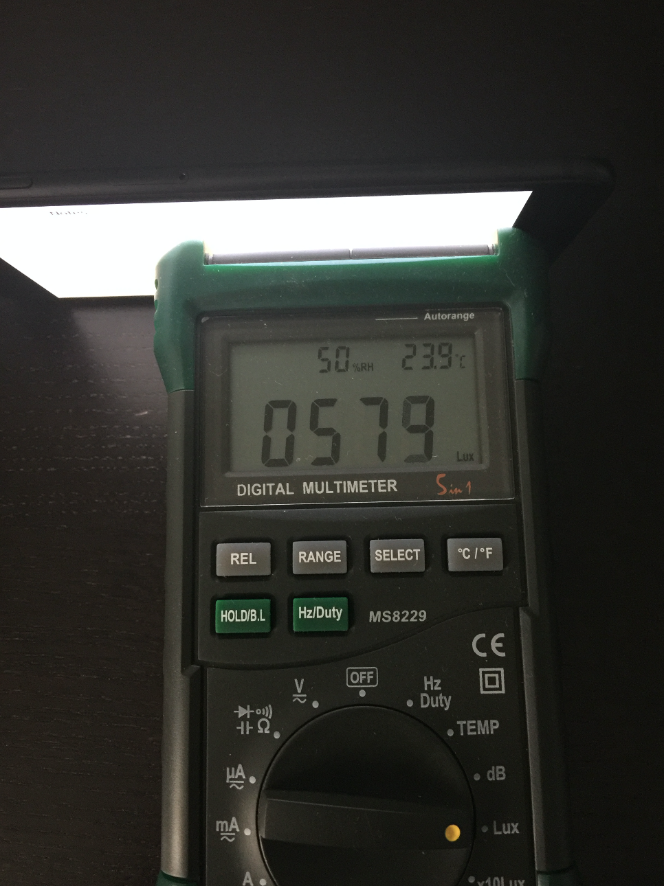

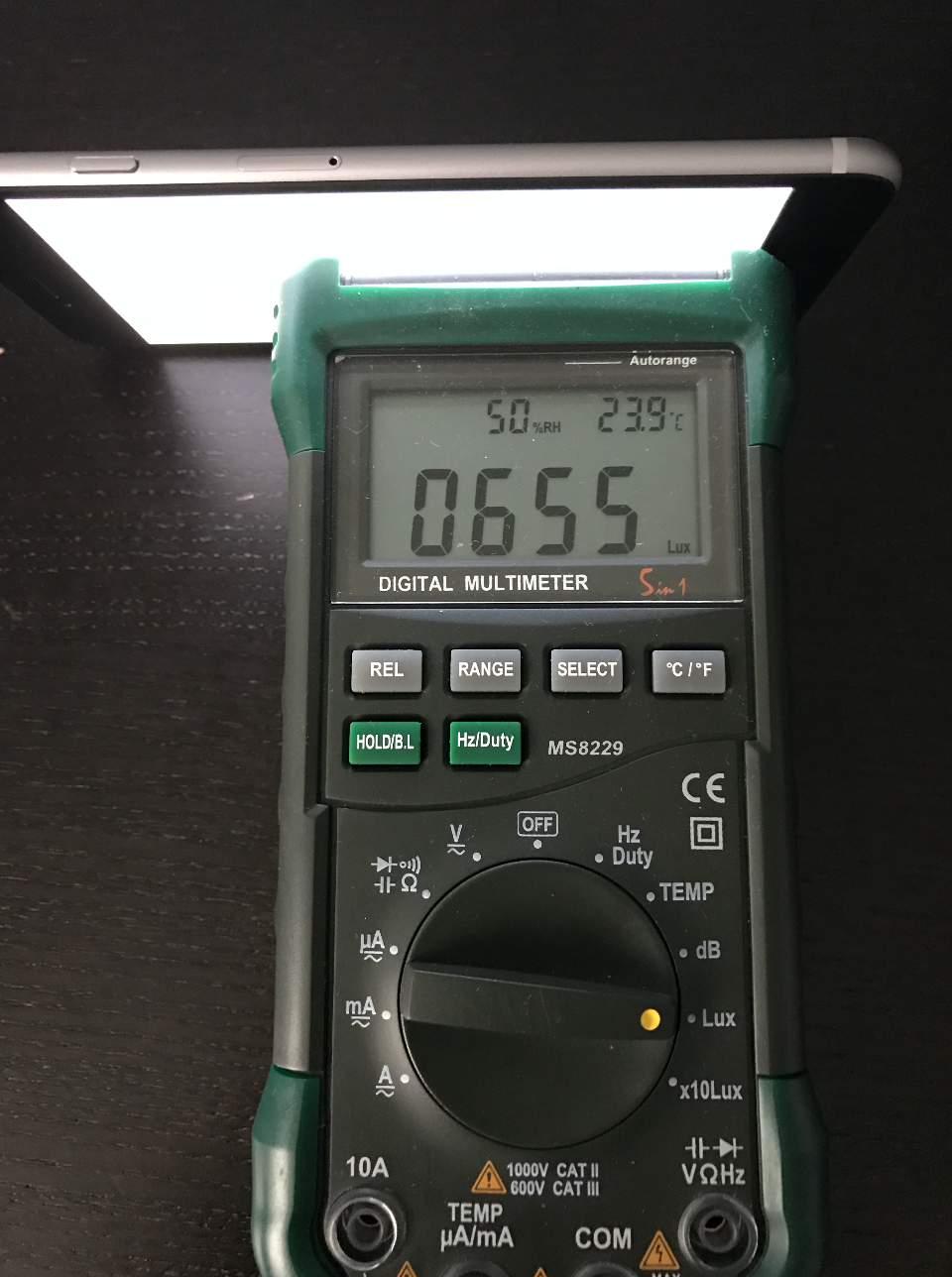

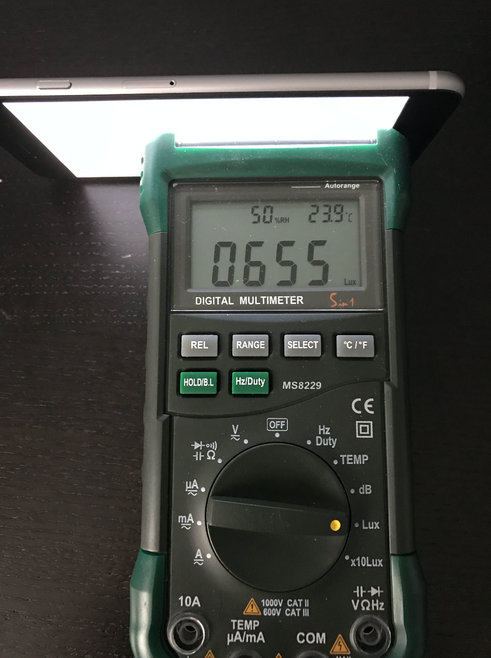

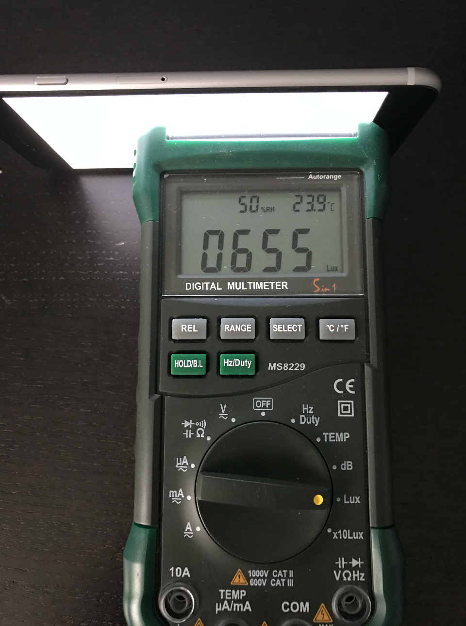

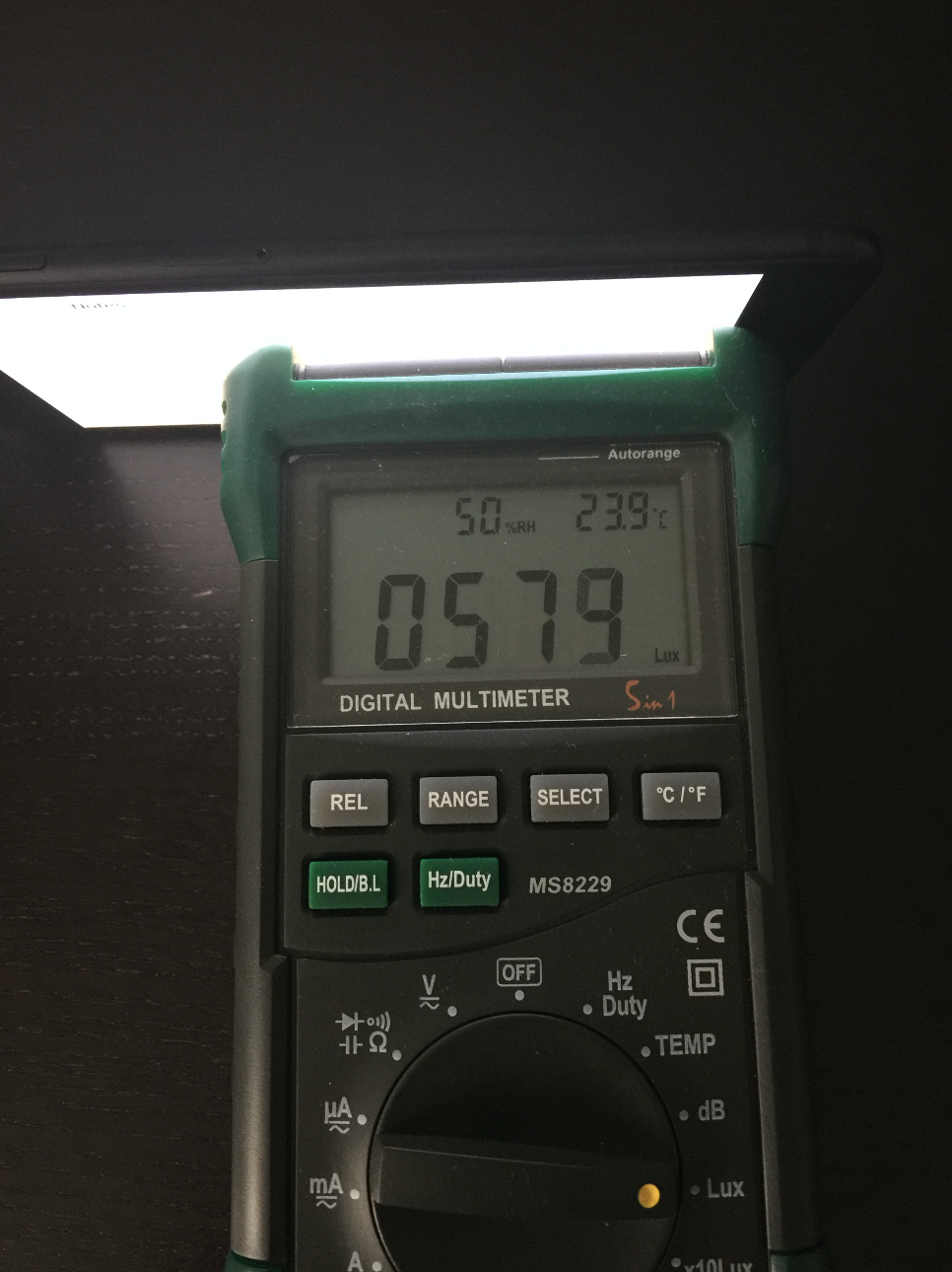

I got my 7+ on Friday and I have also been very disappointed with the maximum screen brightness. Visually, the brightest setting appears yellower and dimmer than my previous 6+. I could buy the argument that the wider color-gamut screen affects the display's natural white point, but I think the general consensus on this forum is that at least some of the 7 screens really are dimmer than previous phones.
People are right; 'brightness' is very difficult to qualitatively compare, so I pulled out a light meter and tested the screen brightness at 100%, auto-brightness off, night mode off, both on a blank notepad page. The 'silver' phone is my space gray 6+, and the black phone is my matte black 7+. You can't compare how bright the photos appear because they have different exposures, but I wanted to upload pictures of the results because I haven't seen anyone else post a quantitative comparison of the screen brightness.
Based on this somewhat scientific (but not very carefully controlled) test, the 7+ screen outputs about 12% *less* light than a 6+. I should point out that I did a test with auto brightness turned on and a very bright LED focused on the light sensor and the brightness of 7+ did not change.

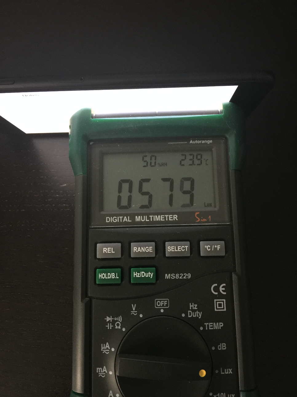

Thank you buddy, this is great work! Quantifiable data rather than just theories. I've noticed that my new iPhone 7 definitely does not have the 25% extra brightness apple claims.

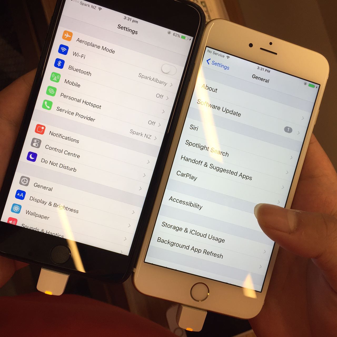

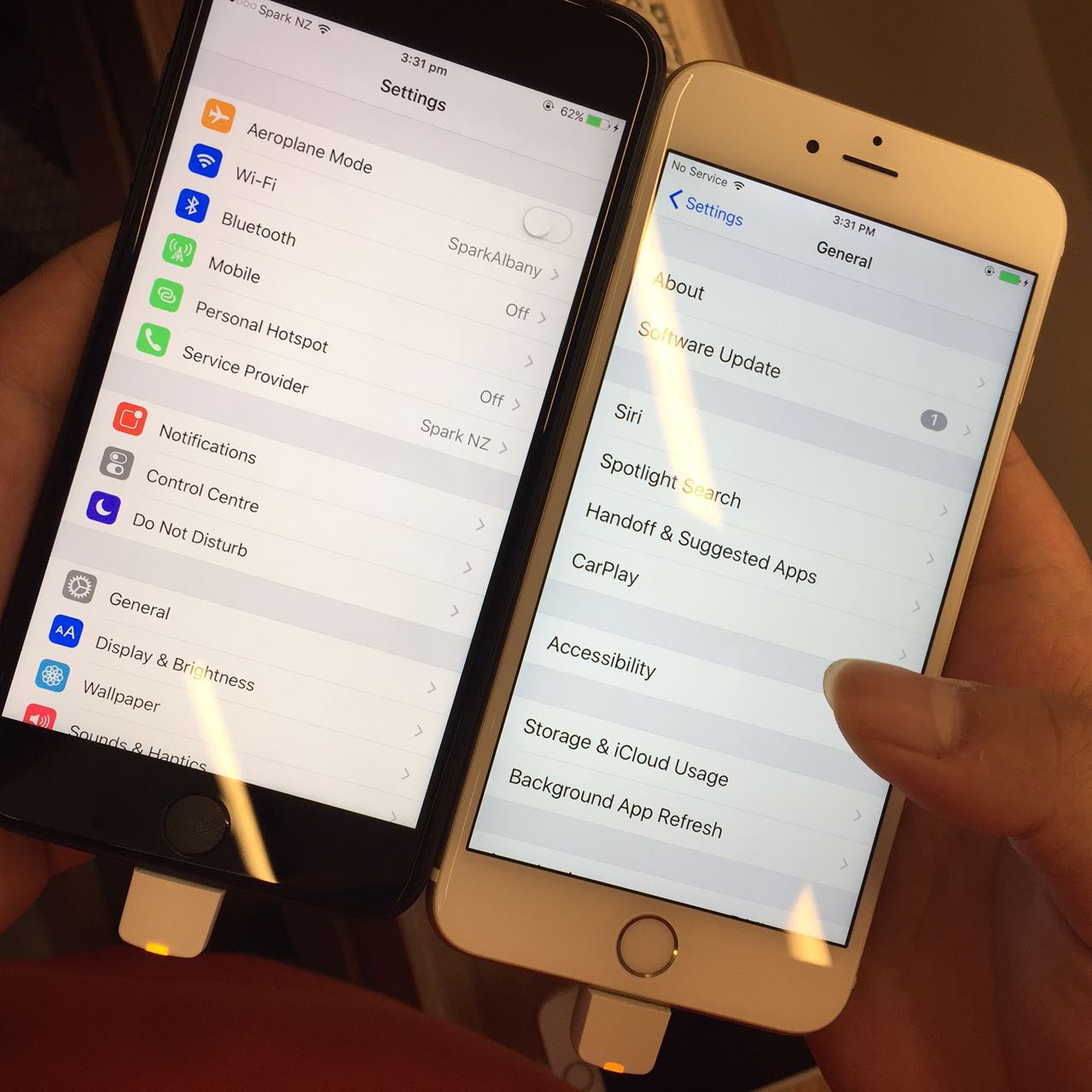

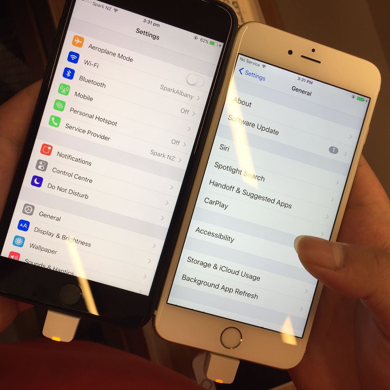

Just to add to the convo, here's my iPhone 7 next to the 6s:
http://imgur.com/a/kL2VN
There was a little sun, not bright, out for a moment so I put the 6S and 7 on auto brightness and took them outside. It does look like the 7 is a little brighter in minimal sun. I took a photo back inside but is too large to upload and I don't have time to mess with it any further now.

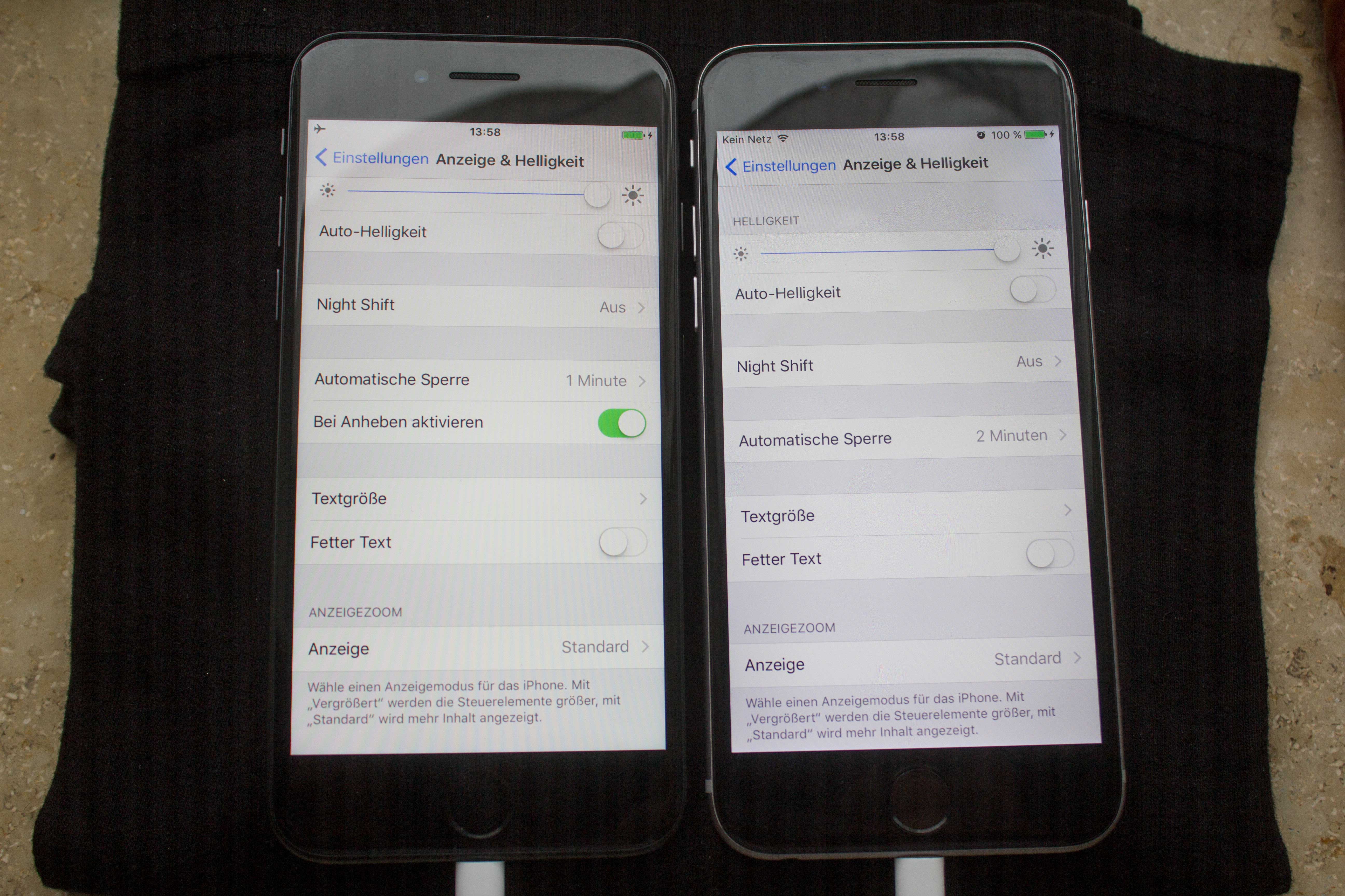

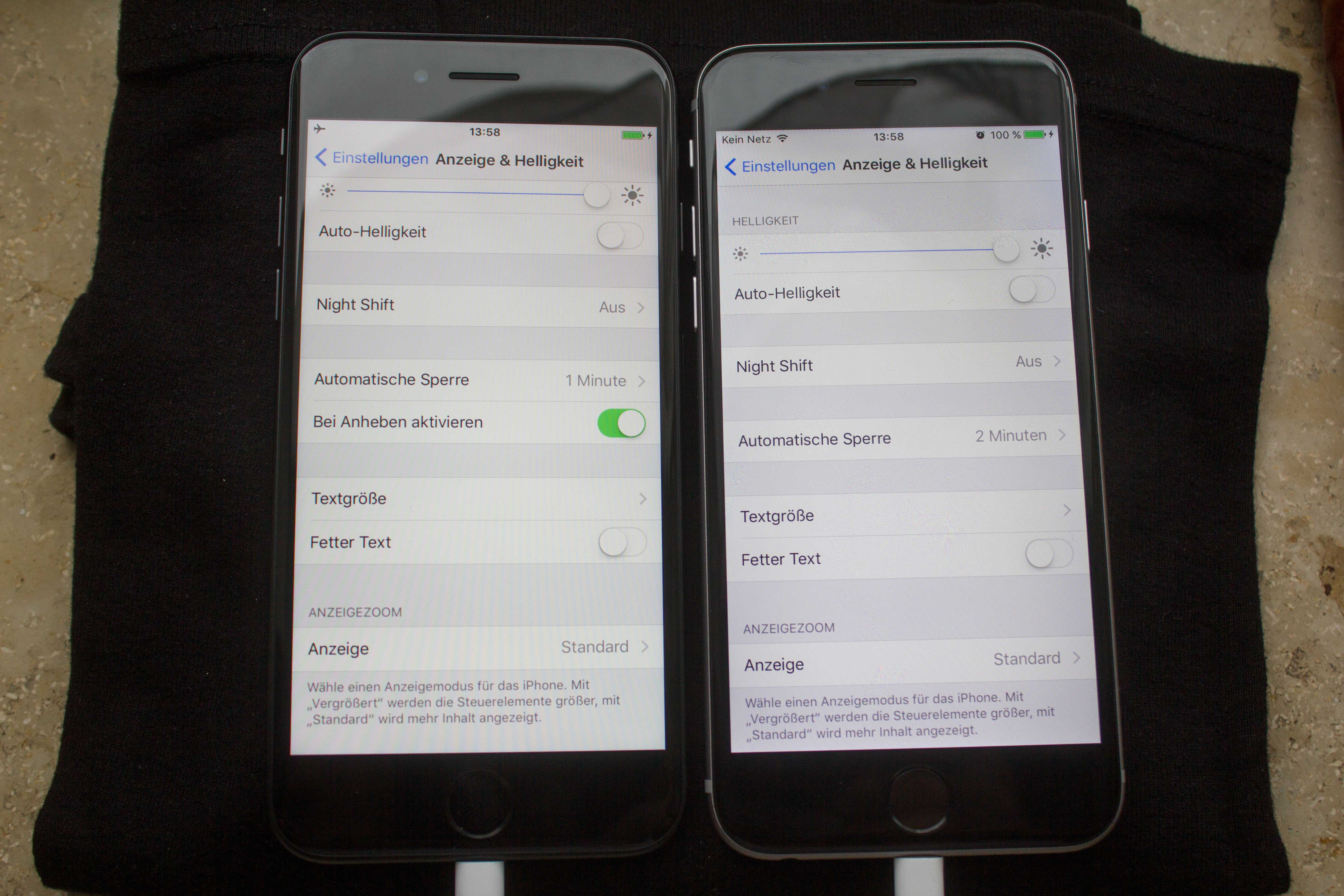

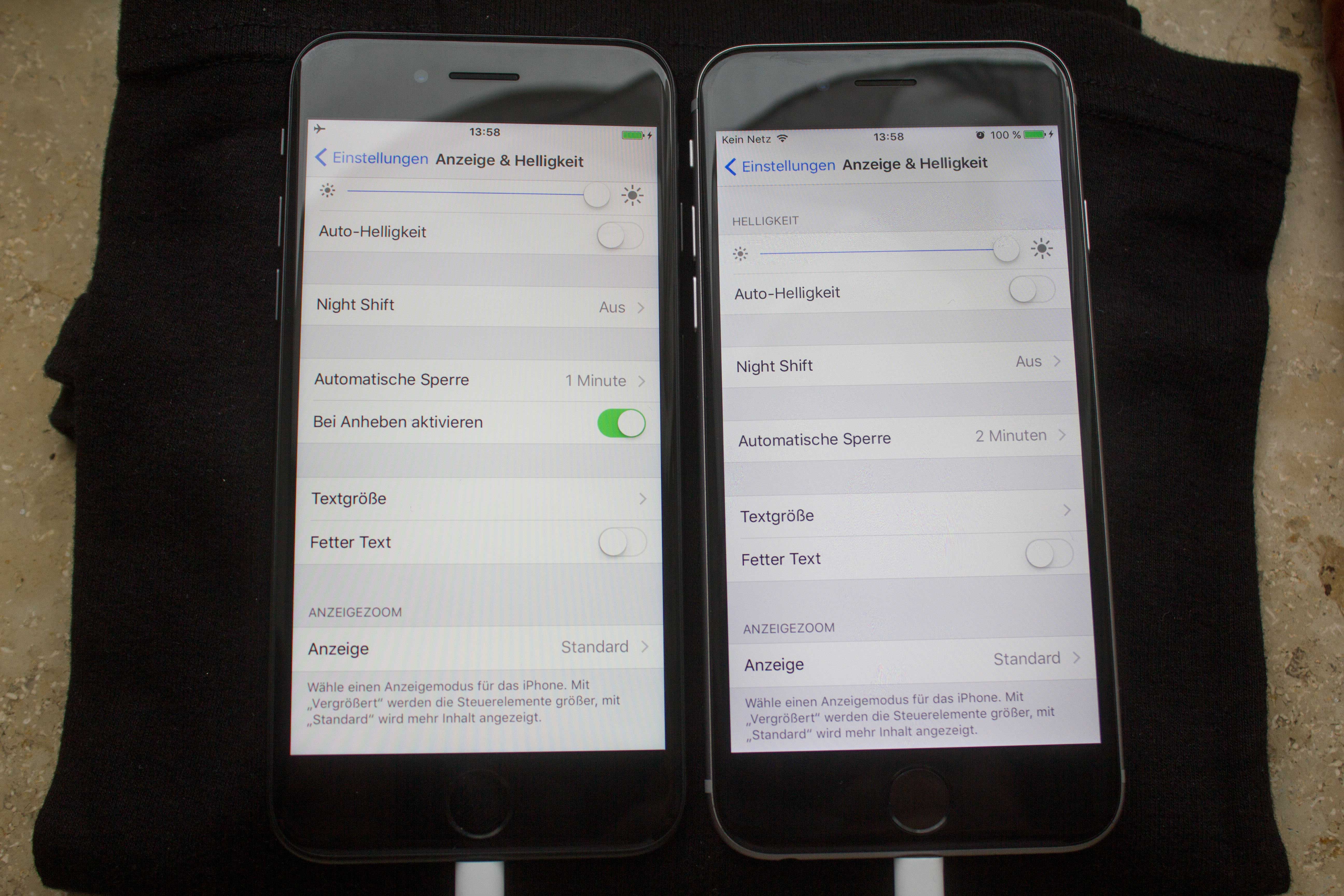

Hi guys,
German guy checking in. 🙂 I have just registered to post this.
Recieved my 7 on Saturday. At first everything seemed normal and fine, but when I compared it to my 2 year old 6 I saw the difference.
Its pretty much the same as I saw in this thread, and a other thread called Yellow Gate.
I made a picture of the 2 phones with my DSLR at max Resolution.
7 on the left, 6 on the right.
You can clearly see that the 7 is warmer tint to my eyes also a little bit darker. Also, I think the Contrast is also less.
Sad to say but for my eyes the Display of the 6 beats the 7.
Where is the 25% more light Apple announced?
I cant see it. After watching the keynote and listening what they said about the new display, I though this will be a real killer. This is really disappointing.
Tomorrow I will go to my mobile vendor store and check if they have 7s for testing and if yes, i will compare the screens of those to mine. If they are better, I will claim exchange.
Greetings
