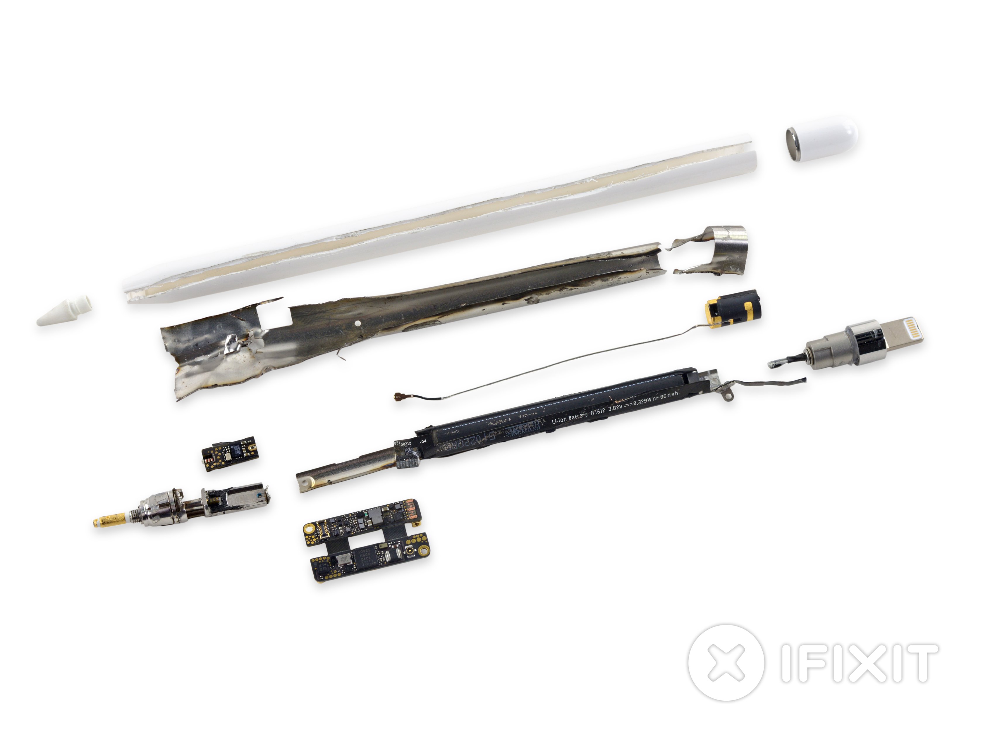

These pencils are poorly made. The tips come off way too easy and who in the engineering team thought it was a great idea to have a gap between the tip and pencil so dirt can get inside? Surface pen is how it should be made so that the tip can’t be removed and no gap or evem loosening of the tip. Apple just designed it this way so they could make extra money from us having to replace the tips every month?

There needs to be a gap between the tip and the pencil case so that the sensor can flex and thus better detect the pen pressure (for pressure-sensitive pen styles). One of the reasons the Apple Pencil is so good. Be careful torquing it too much, because you are torquing the sensor, not the pencil case, and may damage it.
I’ve got two Apple Pencils, one from both generations. I’ve used the first one for over three years, and I have yet to replace the tip. I also use it daily.
