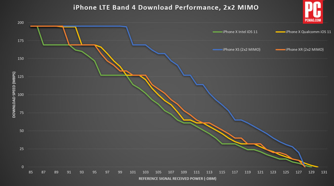

What is interesting is in this shot of the all 2x2 ... iOS 11 Intel outperformed iOS 12 based phones ... for REALLY low signal only.
Makes one wonder, well at least me, is it the new Intel chip, or iOS code in iOS 12?
Regardless however, I would still take the blue (orange too I suppose) line regardless. When the signal gets that low, you are standing on your chair (or climbing a nearby tree) with your arms waving to get signal anyway.

AFIAK, the modem in the XR and X are the same, so to me this demonstrates a difference between iOS 11 code and iOS 12 code. Cellular Insights had also previously stated that Intel vs Qualcomm differences had all but disappeared by iOS 11.4, and this graph tends to agree at most signal levels except for extremely high signal areas (at least not a difference most people would notice, and not the low signal fall-off that was occurring when the devices were first released).
To me, this is all the proof I need to see that these are software issues. The supposed “inferior” antenna in a controlled environment allows the new modem to blow away the old modem, including the old Qualcomm modem. I truly believe any issues with reception will be fixed in the next couple of updates, and we will be back to complaining again on next years devices.
So the question I have is about the XR, is it using a Qualcomm for the CDMA variant this year as well, or did Intel modify the old modem to allow CDMA reception? If there is a QC XR, where’s the tests between those? Also, why wasn’t the X tested on iOS 12 as well to show any differences in firmware?

No, the modem in the XS and XR are identical (not the X and XR). XS and XR use the identical Intel XMM 7560 modem. No Qualcomm variant is available. The difference is in the antenna design. 2x2 for the XR and 4x4 for the XS.
ETA: You may have been thinking of the antenna design which is the same 2x2 configuration for both the X and XR.
