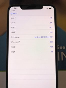

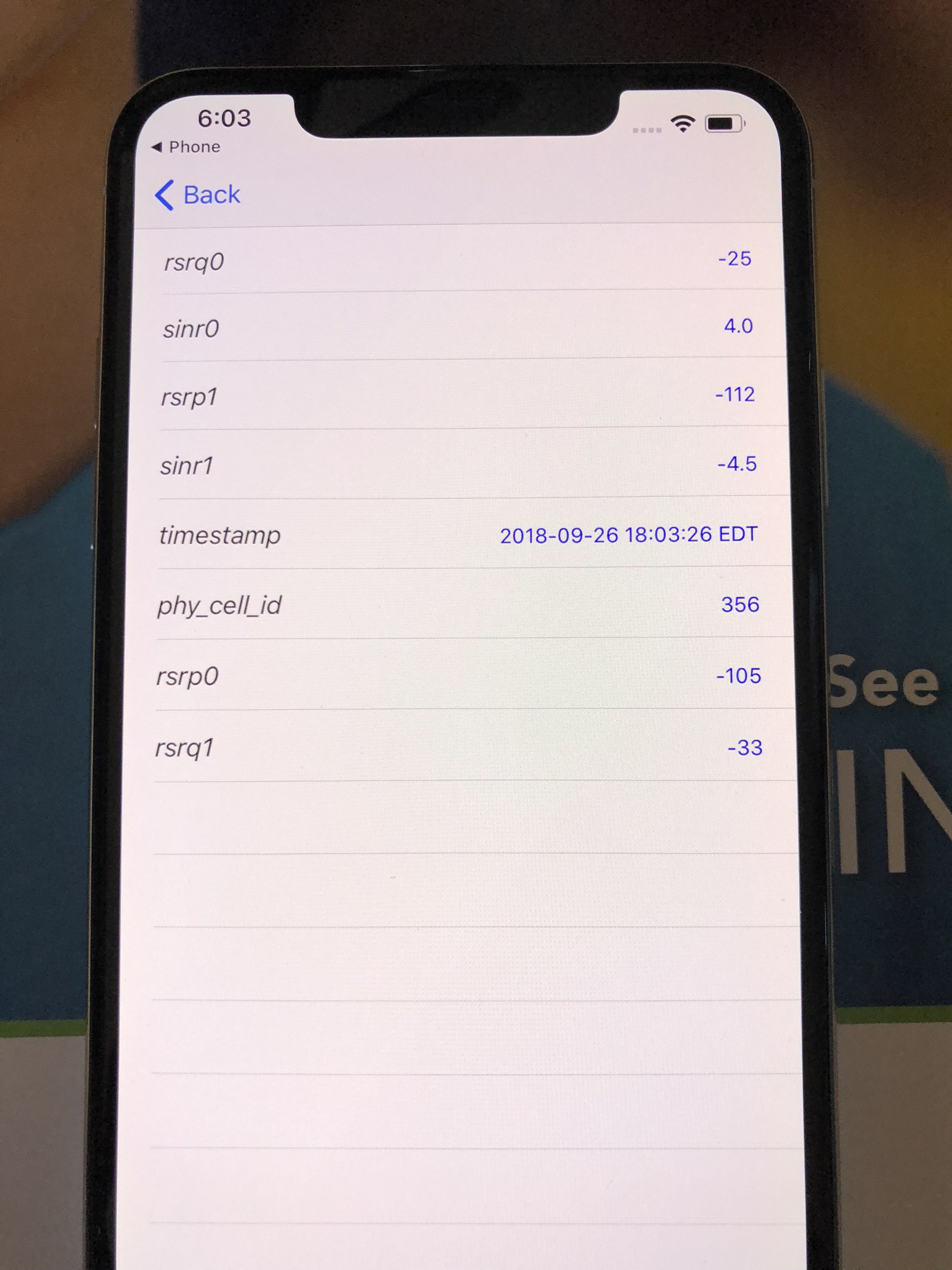

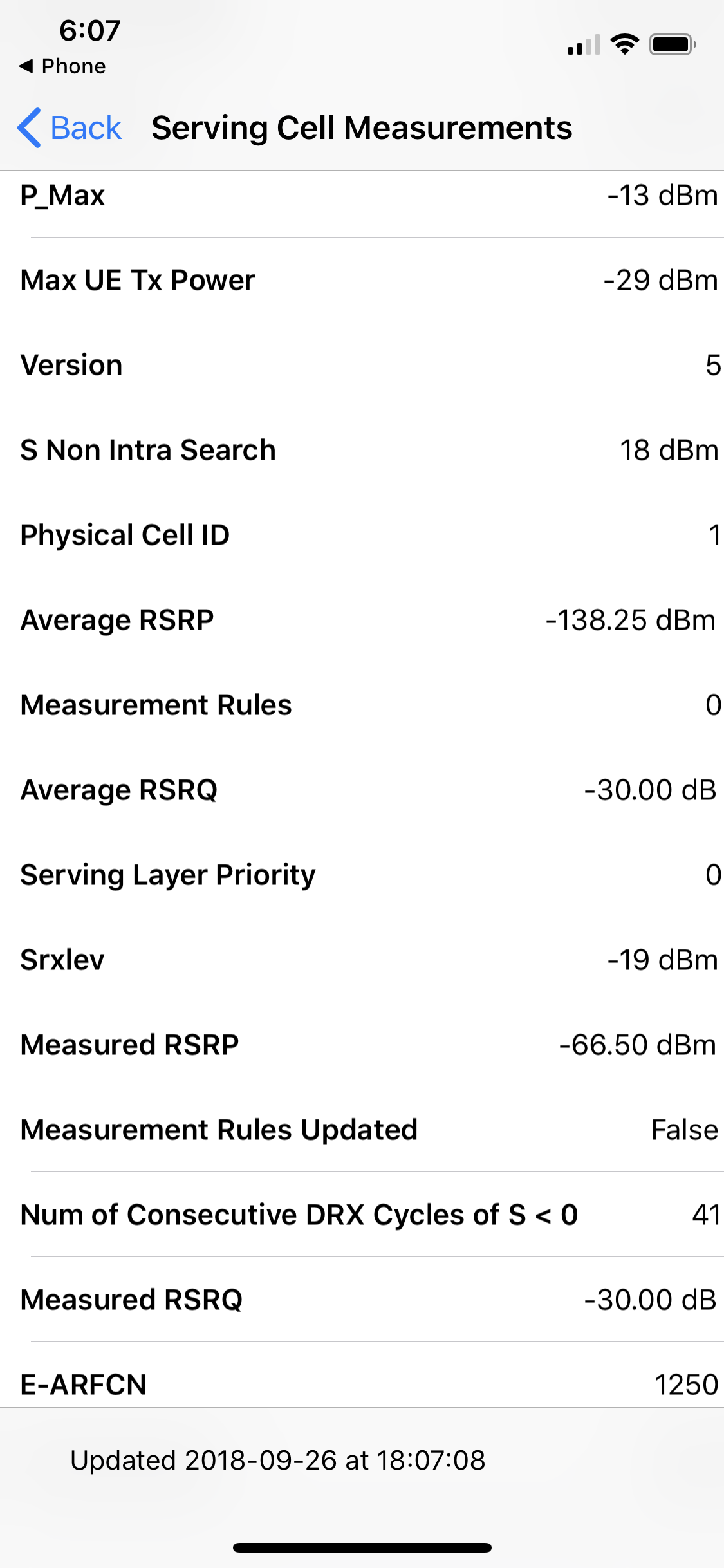

Curious what others think. Just tested this at home:
X was -66.5
XS Max was -105
Both in the same vicinity. Attached screen shots of the data. Would you return this? My concern is the vast difference between the X and X Max.
X was -66.5
XS Max was -105
It looks like. Your numbers are where the good numbers should be.

I tested on both X and XS Max and it's the exact same poor reception -105 rsrp0
So your phone isn't worse. It's same. That's good :)

View attachment 789295 View attachment 789296
X was -66.5
XS Max was -105
I would not try to compare the indicated rsrp values on the different modems in those different phones. There are no technical documents available that show the derivation and scaling of those values. Ignore them and use 1) whether you have a signal or not and if it is consistent, and 2) if you do have a signal use speed tests to compare the quality of the connection.
The field test menu on different phones can be useful to ensure you are on the same tower and band, but I would caution comparing any of the signal quality information across phone models.
Reactions: w_aldo
Thanks appreciate it. I guess I wasn’t overly focused on the numbers, per say. I was surprised at the difference. Someone else mentioned could be on a different band....
