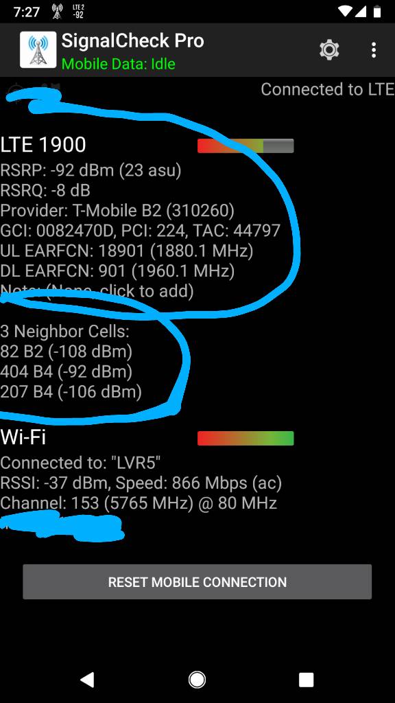

It's more than just speed tests. It's looking at signal "strength"
My Pixel 2 averages -95 dbm at home but the iPhone Xs I received averaged -110 dbm. I highly doubt the average consumer even knows how to check that. They just look at bars.
