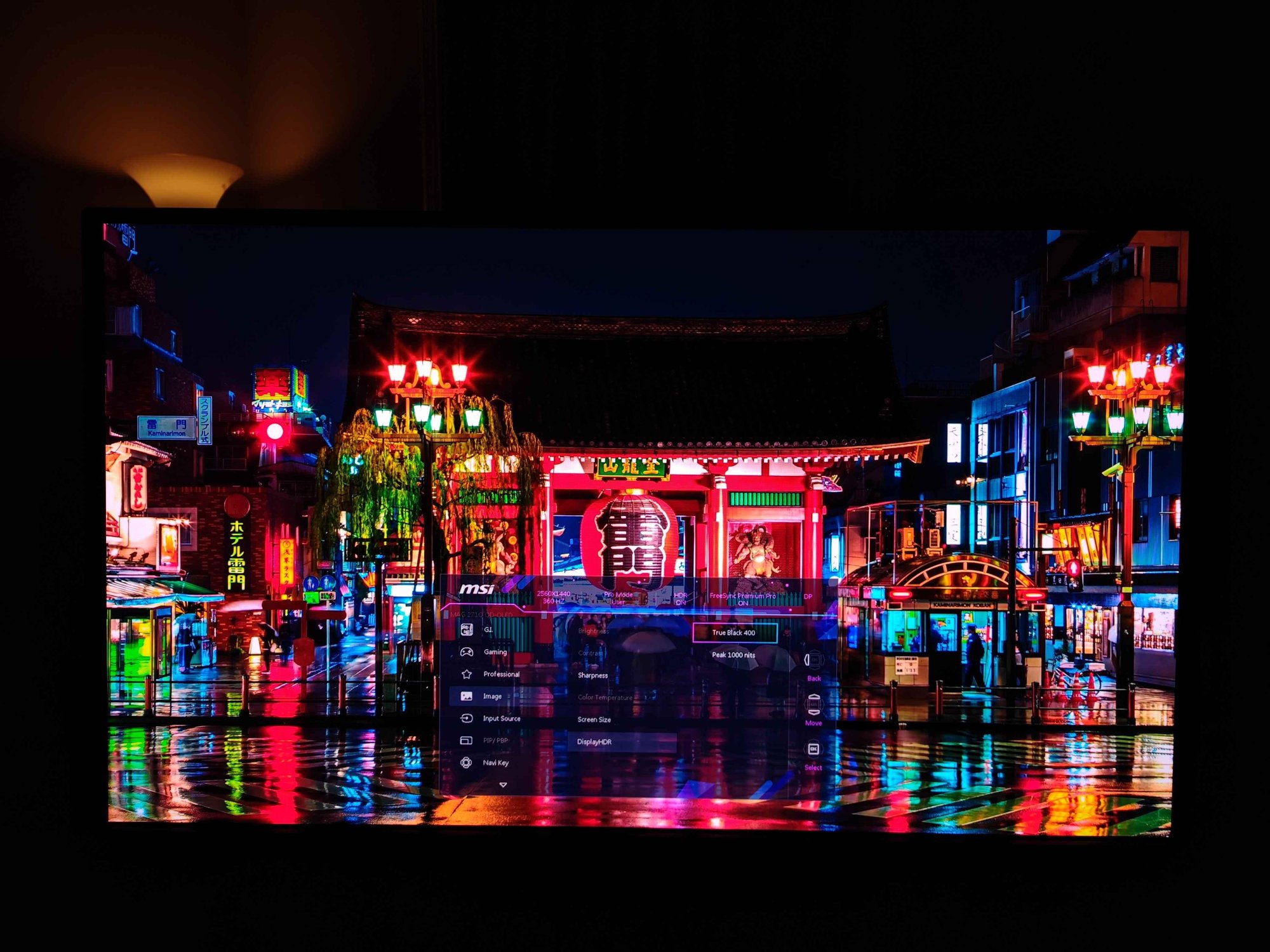

I have brightness to 39% and Gamma to 2.2
I can't understand users who complain about the NITS specification being too low in general, because if I set the Kuycon to 100 brightness, I would eventually lose my retina completely!
That's not how it works.
For example, take a look at this night scene. The lamps might be mastered to 1000 nits yet the average of the entire scene might be below 100 nits.
A 1000 nit display would be able to show those lamps as intended, and would also show the differences between lights and objects at say 1000 nits and 500 nits, whereas a 400 nits display should show them all the same and dimmer, with details missing.

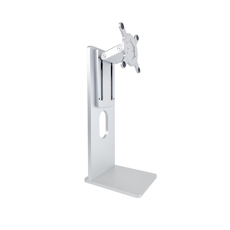

I wonder if the VESA stand from Kuycon would work on the LG 6K. They say it's built for the Pro Display XDR with VESA mount. I wonder if it needs a certain weight to work properly, because the LG is much lighter than the Pro Display XDR.
For those of you with the Kuycon, does the stand adjustment sprint to the top if not weighted? Also, how much height adjustability does it have?
No, it doesn't jump up on its own. You basically push the monitor to your preferred height and it stays there. Please correct me if I'm wrong, fellow Kuycon owners, but that's how I used the stand :)
The stand will be at the top before the monitor is installed. Most stands work that way to offset the monitor weight to or it would fall to the bottom
Reactions: P K and EugW
ClickClack says the stand is designed for the weight of the Pro Display XDR.
Eug:
For the 32" universal VESA stand with tilt and height adjustability, is it designed only for the weight of the Apple Pro Display XDR, or will it work with other lighter 32" displays as well?
ClickClack:
It is usually adapted according to the weight of Apple Pro Display XDR.

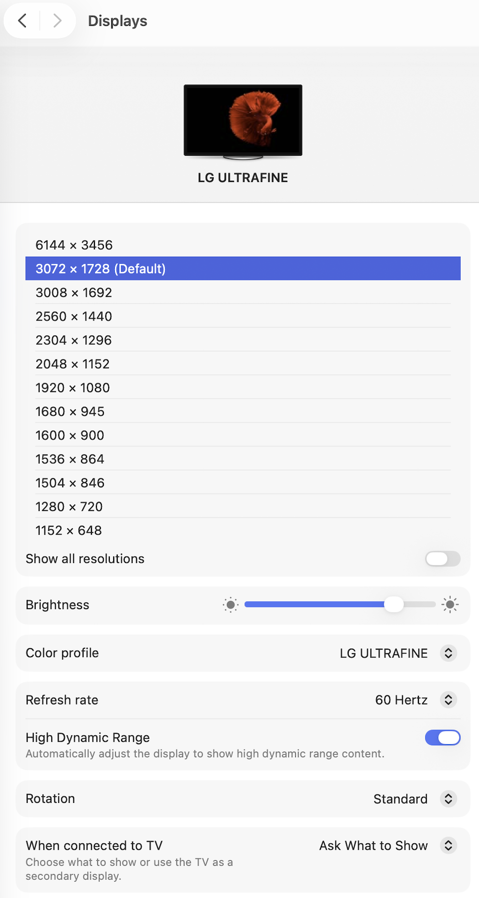

Unfortunately, my worst fear came true. Your result proves that DSC doesn't work with this exact resolution - 6144×3456 in macOS when connected via DP1.4 so it means that users get 4:2:2 chroma subsampling instead of full RGB 4:4:4 on the monitor.
Personally I cannot call 4:2:2 chroma subsampling image retina quality.
It's a good idea to compare DP1.4 connection and DP2.1 or HDMI when you have a chance, I'm sure you will see a difference on the test image.
there is well known bug in macOS when DSC is not working for DP1.4 and 6144×3456 resolution.
6144×3456 via DP2.1 (actually, in this mode there is enough bandwidth so DSC is not used) - RGB 4:4:4 works;
6144×3456 via HDMI - RGB 4:4:4 works with DSC;
6016×3384 via DP1.4 - RGB 4:4:4 also works with DSC;
6144×3456 via DP1.4 - DSC disabled, RGB 4:4:4 doesn't work, user has 4:2:2 instead.
This macOS bug was fixed some time ago but recently it came back as we can see in the Dell 6K thread.
You are already aware of this, but I just want to reiterate, it can be argued that this may not necessarily be a macOS bug per se, but a bug that exhibits itself on macOS only with specific 6144x3456 monitors and not others. People with the Kuycon and the Dell have this bug with DisplayPort 1.4 causing chroma being downgraded to 4:2:2, but on the LG 6K this is not the case. As posted in the LG 6K thread, I can report that DSC 4:4:4 chroma works fine both the M4 Mac mini and the M4 MacBook Air over Thunderbolt 4 / DisplayPort 1.4, even at 6144x3456. Interestingly though, 6016x3384 is also natively offered as a resolution option for the LG.
So at this point, we don't know if macOS is the culprit here, or the affected monitors are the culprits, or a combination of both. Whatever the case though, the LG 6K is not affected by this issue.
